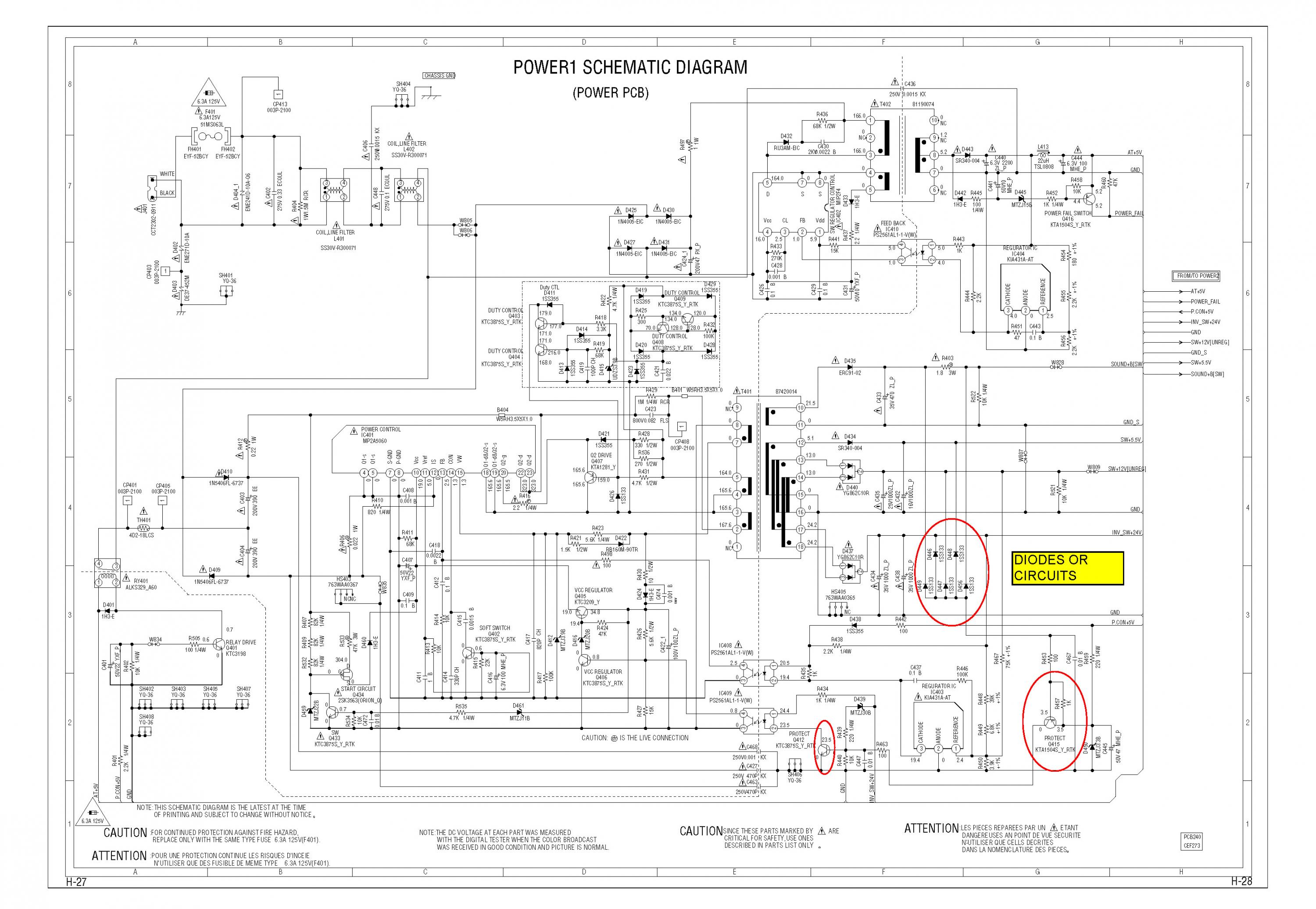

    OK, since you apply a kick start 12V to the Switched 24V output terminal then the power supply will start running. It may be seindinf 24V not present when the power supply try to start up then it goes into shutdown, or something else is not running 100% since you are getting only about 8V at the 24V output.
    I look at the circuits and see that it uses 'FAILED POWER DETECT' circuits (this method of monitoring the power supply circuits is used a lot in Sharp TV). If you look at the redlined diagram attached, you will see that it uses Diode OR GATE circuits setup to detect output voltage of the power supply.
    D449, D456 is for detecting Switch Sound B+
    D446 is for Switched +24V
    D447 is for Switched +12V
    D448 is for Switched +5.5V
    If the output voltage is not present at any one of those output, the Diode will go into Foward Bias mode and conduct (normally it will be off due to reverse Bias by the outputs of the power supplies), then it will turn on Q415 which will trigger protection circuits (Q412. OPTO, etc.).
    So it either that the Diode D446 is leaky or the power supply is not on long enough (takes too long for the output voltage to rise up to the point that turns of the pratection circuits, the detection circuits act faster than the build up of the output voltages) to produce high enough voltage to keep the Diodes in off stage.
    You can lift one end of D446 (Switched +24 detector Diode) and see if it will start up. Since I am not sure if your board part designators are the same as your board, you hsould verify that we lifting the correct Diode. Please note that it can be anyone of the outputs that trigger the shut down.
    I still think the problem is in the primary side that causes the output to rise up slower than the detection circuits.

        hi budm, I tried lifting D456 first and no change. I ended up lifting all the ones you suggested and still no change. Still the 8v. I was looking at the trouble shooting flowchart (pg 23) in the manual (attached) and it says if no voltage, check IC401, T401, D437 and peripheral circuit. What do you think?
          Re: 26" Sharp LC-26DV22U LCD power problem.
          Ok, so we verify that it is not protection circuit fault tripping, so as I indicate, some thing is in the primary side. At 8V output, it sounds like the IC401 is not fully driving the circuits to full output and some how when you apply the kick start, then it will run OK, and you have already replace the start up cap.
          So if you lift all the Diode, wil it start runnung with the 12V kick start?
          I will look furthe to see if the kick start at soem other point in the circuits will make it runs also.

                      You have it right, pin 1 is the Collector, 2 = Base, 3 = Emitter.
                      This reading is strange becuase BEFORE the kick, you have 0V at the Base which means the Transistor should be OFF so the Collector voltage should be high, but it is reading 4.6V. After kick start, the Collector voltage gose up to 25V which means the Transistor is turn off. What you are see ing does not make sense you you do not have 0.6V at the Base of the transistor, the Collector should always be high.
                      So that transistor should turn off when you turn on the power switch for the TV to function but some how it stuck partially on, if it is fully on the voltage would be less than 1 volt. if you kick start by short Base to Emitter (this will turn the Transistor off) temporary instead of using the kick start voltage, the TV should kick on also.

                                    If you are getting 2.06V at the Q415 Base and Emitter (which is connected ground), it means the Base-Emitter junction is open. Are you sure you had the Base-Emitter short together, not Base to Collector? It should show about 0.6 ~0.7V if the Base Emitter junction is OK.
                                    The Collector should go up to 24~25V for the TV to turn on again when using the kick start.
                                    When Base is shorted to the Emitter, it will turn off the transistor so the Collector Voltage will rise close to the VCC (in this case, its the 24V supply), this will turn off the LED inside the OPTO IC409 which will also turn off the Opto transistor, this opto transistor when it is on it will short Base/Emitter of transistor Q406 which causes Q406 to be off which control the regulator transistor Q405. Q406 has to be on to regulate the 19V power supply for IC401 VCC.
                                    You can also see a 30V zener diode D439 which will drive the Base of Q415 on if the 24V supply gets up to 30V which will be high enough to turn on D439 and provide bias to turn on Q415.
                                    So basically, if Q415 is on, the TV will be force off.
                                    There are so many protection circuits in this power supply section. If you replace Q415, it will work with kick start again. You can lift one end of R434 which provide the current for LED inside OPTO IC409, this will allow the 19V power supply to stay on.

                                          OK, I relented and put it back on the bench. Lifted R434 and got the kick start working again. I will rig something up with a little switch and see how long it works. Thanks for your help.
