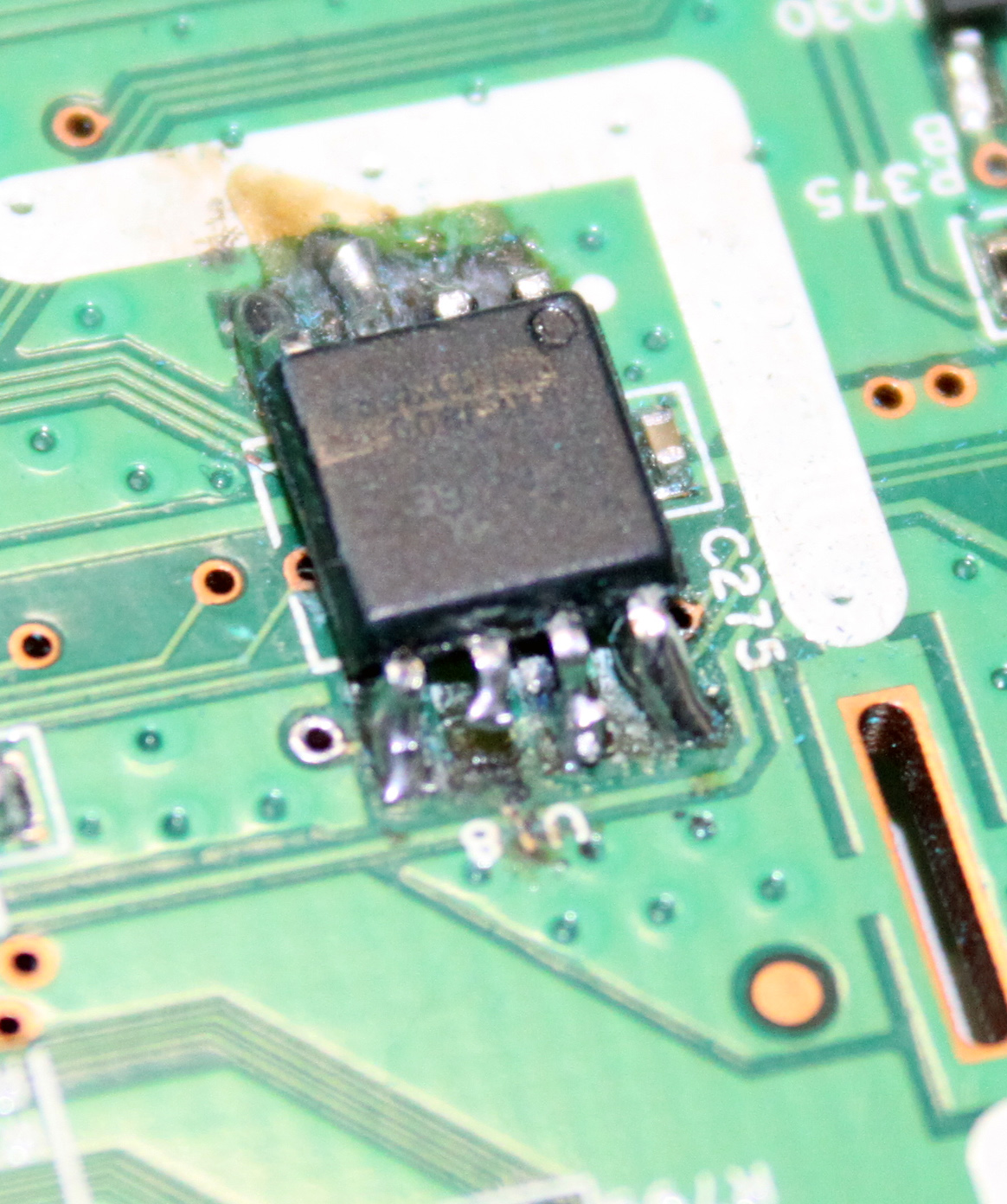

Vizio e320vl stuck on vizio logo
  • cheezeitz51

    I got this TV from someone who said it had this problem, and that it was just sitting around. I plugged it in and it worked fine, and so it sat there for a few weeks. Then I went to use it again and it worked a few times. Then it broke again. It turns on and it's just stuck there with the vizio logo. The power button doesn't do anything, and it has to be unplugged. So I would assume that it's a problem with the main board, but I don't see any bad caps or burnt things or anything bad. I attached a picture of it. So what should I do now?

      Re: Vizio e320vl stuck on vizio logo
      This a common problem with Vizio E-series model, the main-board eeprom is most likely is the problem.The epprom is mostly like is corrupt.
      you can try to re-set your TV by holding down the power button for 30 second with the power cord not plug in.
      You can try re-soldering the U18 the eeprom chip on the main board to see if its a bad solder joint and also check voltages on you main board. You buy an replacement program eeprom chip from
      http://www.ernestos-electronics.com/...vl-eeprom-fix/
      hope this help

        I can't do the first thing because I can't get to the menu. Resetting it didn't work either. When checking voltages on the main board what exactly am I looking for? I'll try re soldering it though.

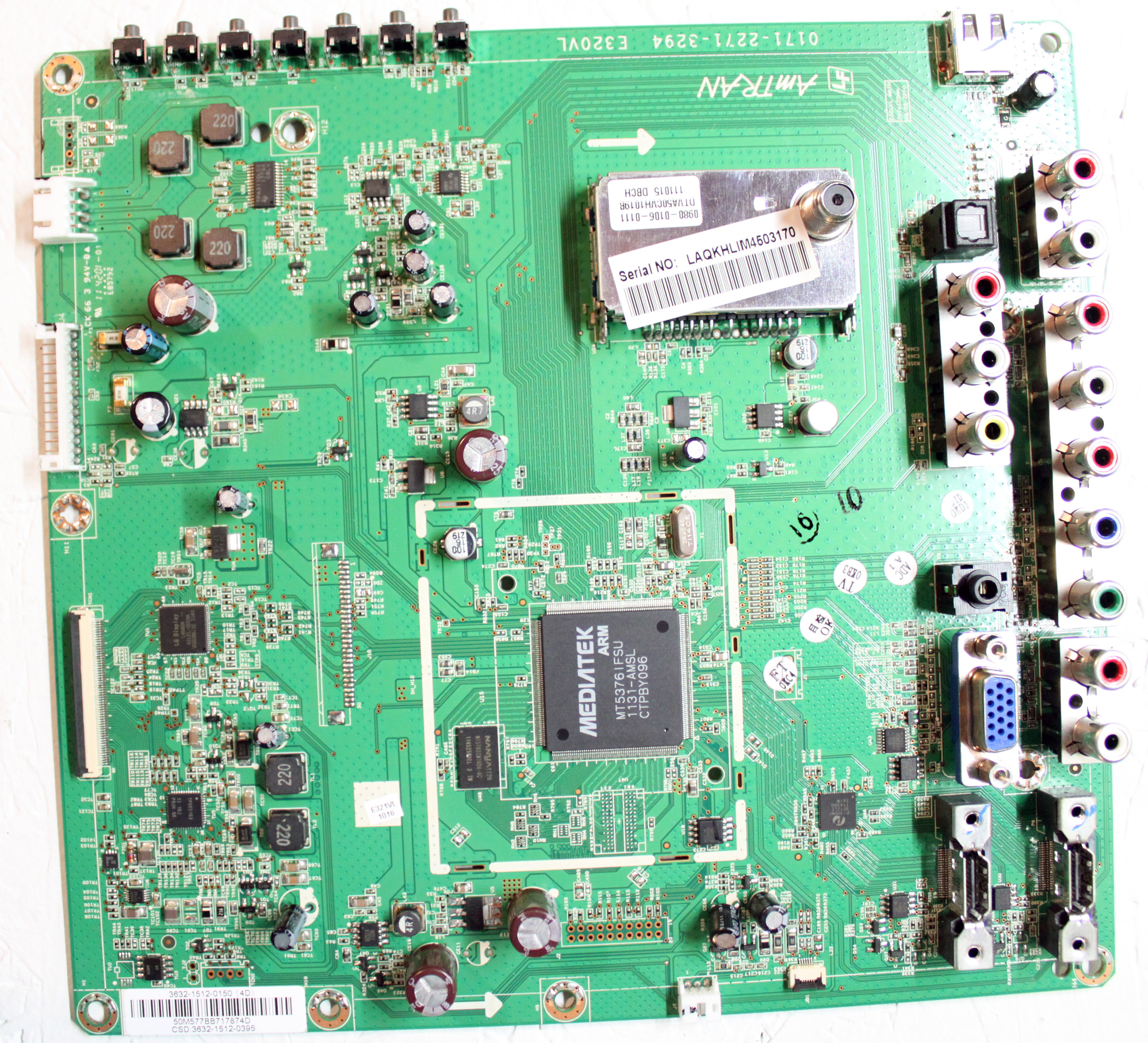

          You would need to start with the power supply and see what voltages you have there, then on the socket that goes to the main board there should be the voltages fed back from the main board to tell the power supply to
          switch on the higher voltages. Check all the fuses and say which you have checked and give the numeric value in ohms. Please post pictures of the PS
          front and back. and if labeled a close up of the connectors, showing the label.

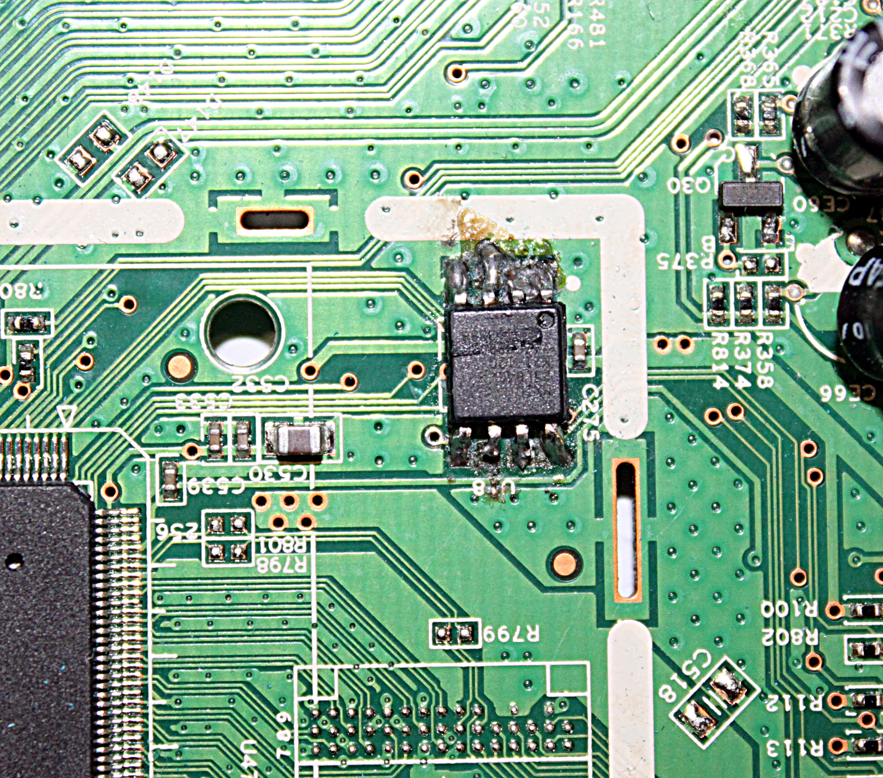

            Uhm well the whole resoldering thing didn't go so well, so now it wont turn on at all. Woops. I suppose the main board needs replaced now.
              Does the logo on the front change from amber to white? If so you are getting some power. Try reading on the E321VL under my name killian6pk. I went through quiet a bit before getting mine to run. It has been going great ever since. Remember to check the ribbon cable from the little IR board to the main board to make sure the contacts are all good. Mine the contacts were messed up some overlapping others etc. Also push and hold the power button down as you plug in the tv. This seemed to reset mine.
                The logo doesn't change now even. I completely ruined the board though. I managed to make some of the little metal things on the board fall off so there's no way to attach the u18 thing, so I think all I can do now is get a new board.
                  Sounds like it. But, before you do why not post pictures again of what you think you messed up. It could be fixable. Some of these guys have been doing this for years and have work arounds for things that you and I would think are beyond repair.

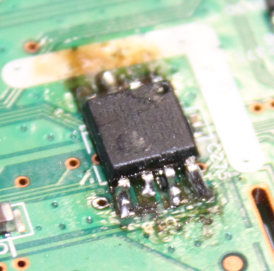

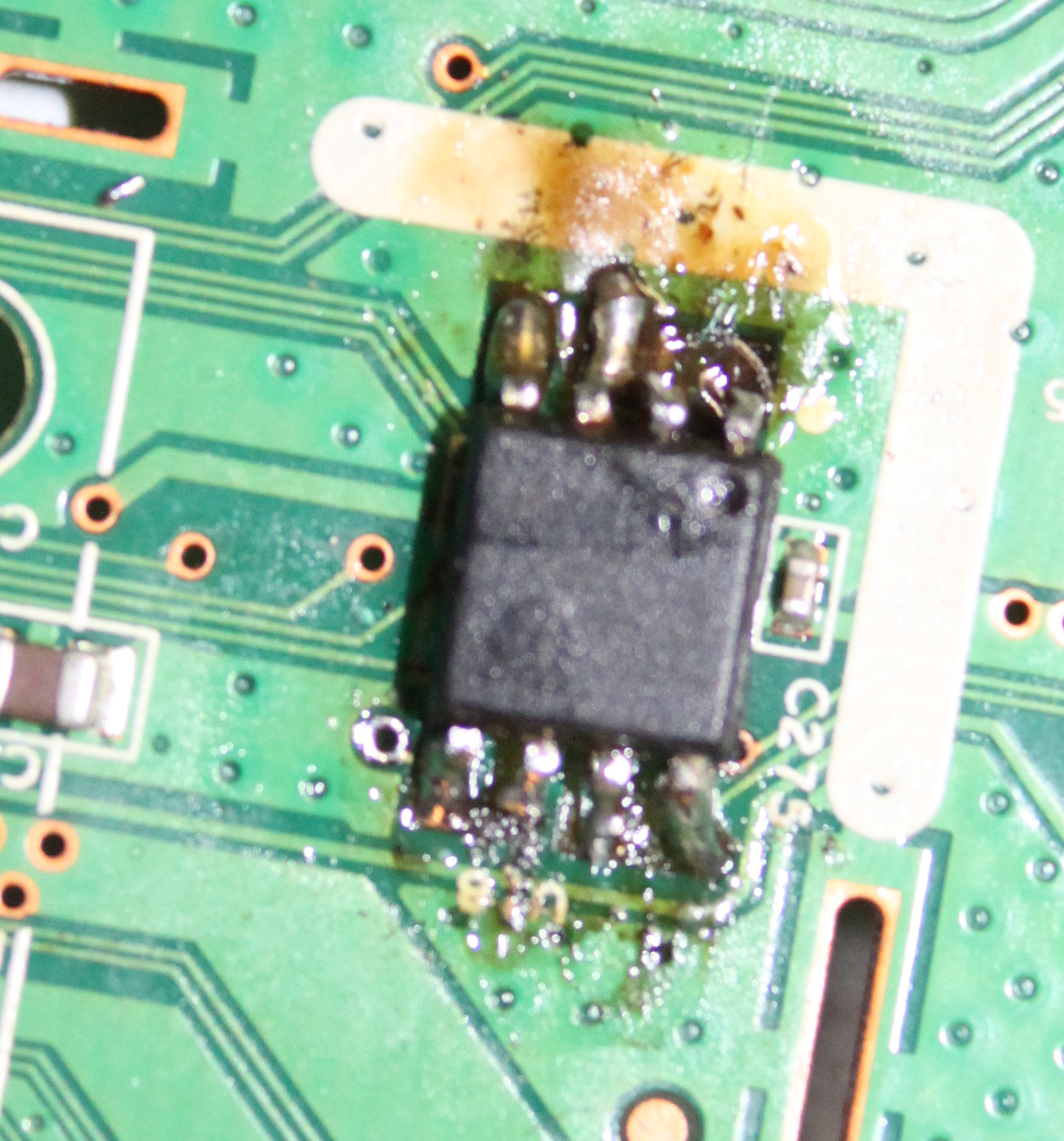

                    Okay, but don't make fun of my horrid job.
                      Gulp! First thing would be to get some isopropyl alcohol and clean off all the flux then take another picture
                        That's about as clean as I could get it, although I only had 70%.
                          Did all the solder pads lift when you removed the chip?
                          • cheezeitz51
                            • Aug 2012
                            • 10
                            Some did, and some didn't
                            • Mr Bill
                              • Nov 2011
                              • 648

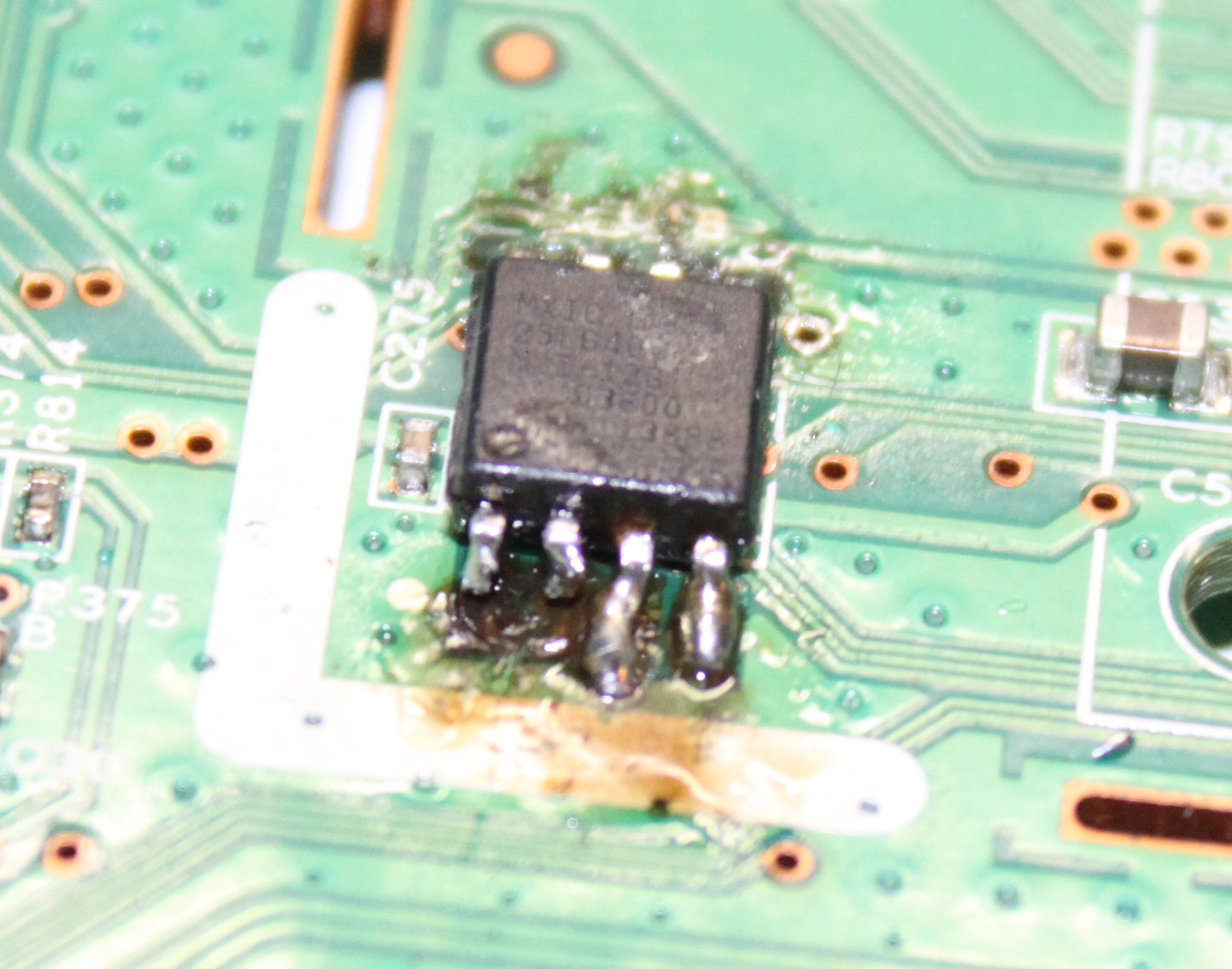

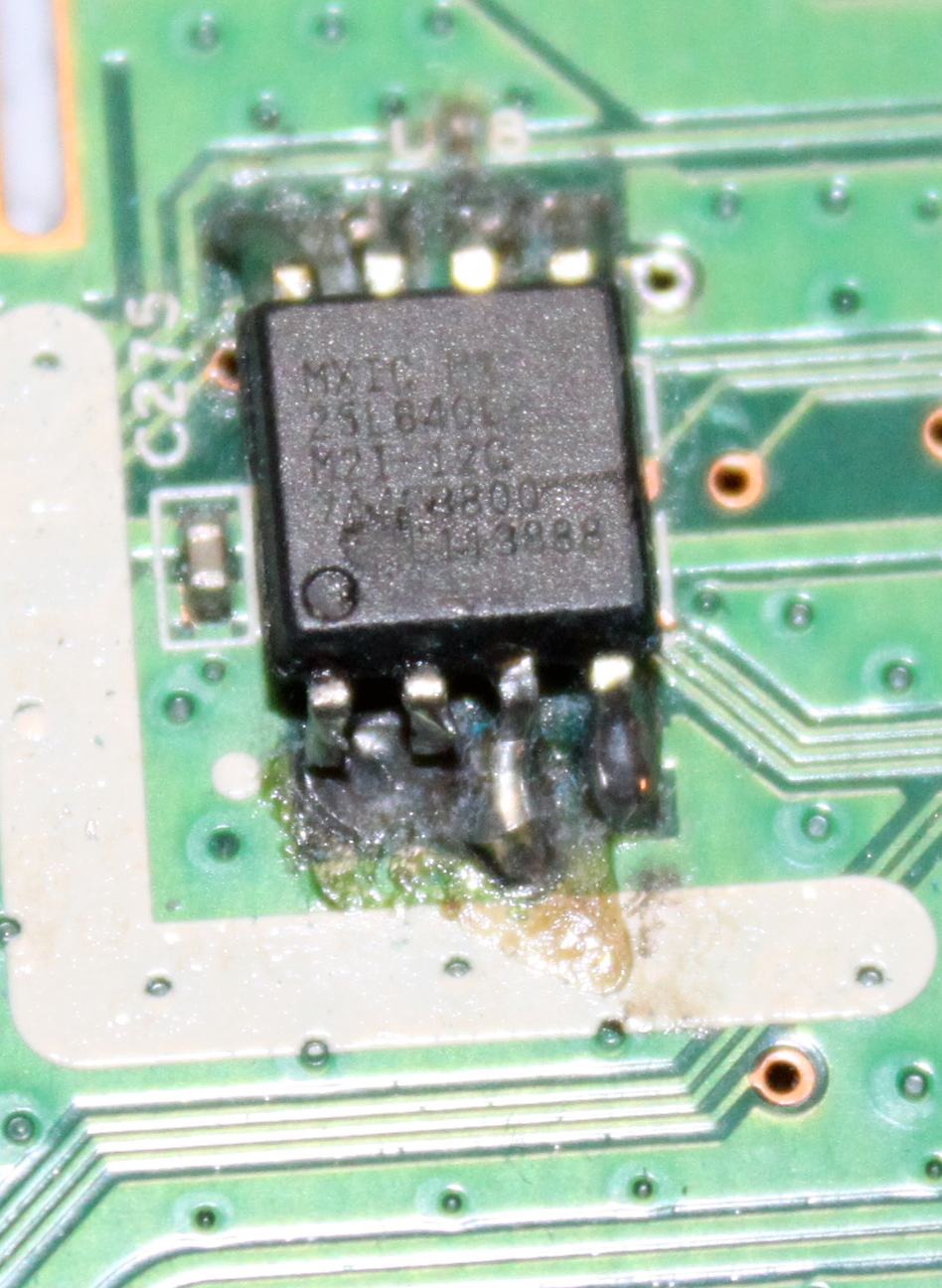

                              hmmm, Your right on that fine line whether it fixable or not. Can you get a super clear photo of the chip. I want to see if there are any places you could run jump wires from the points with "no pads".
                              • cheezeitz51
                                • Aug 2012
                                • 10
                                This is about as clear as it can get, because all I have is the stock lens which isn't very good.
                                  I have been looking for a pinout or "typical use "wiring but only came up with this
                                  http://html.alldatasheet.com/html-pd...5DM2I-12G.html
                                  It might help someone familiar with these boards
                                  Problem might be that if any of the pins have been connected when it was switched on it could have wiped the memory? These can be bought blank
                                  but would need programmed.
