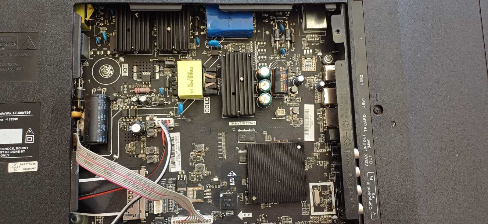

    Hi everyone,

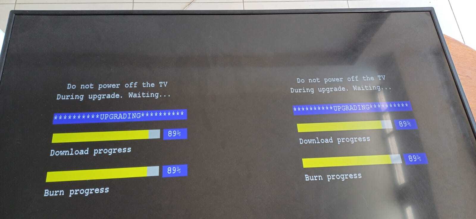

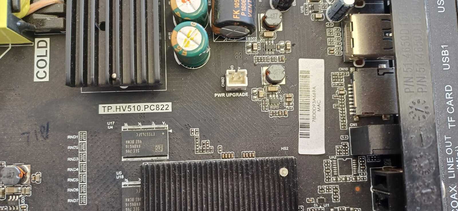

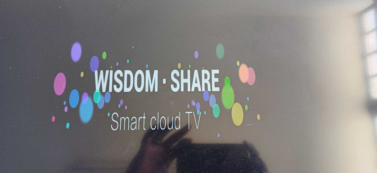

    I'm working on a JVC TV for a client that's stuck on the "Wisdom Share" logo screen.

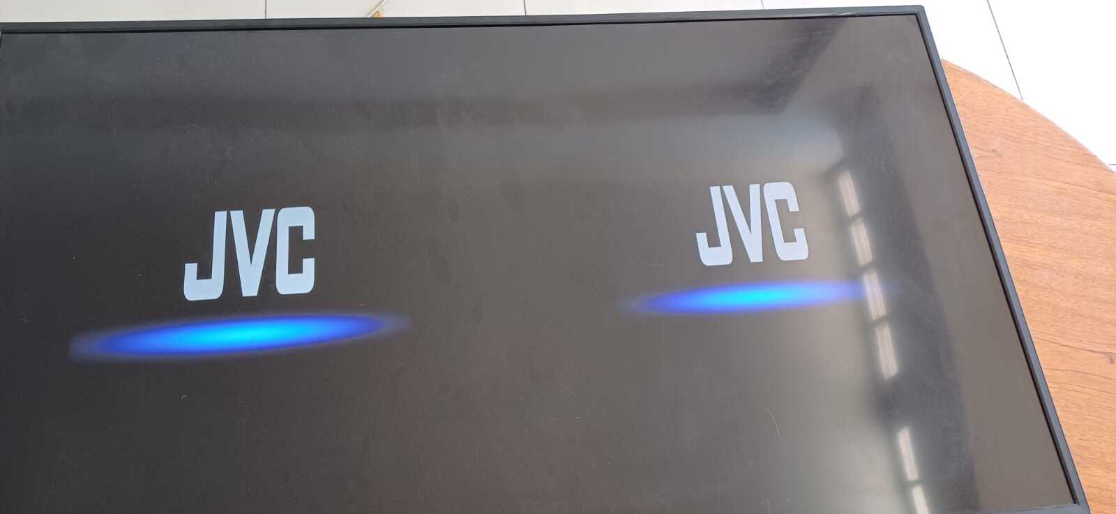

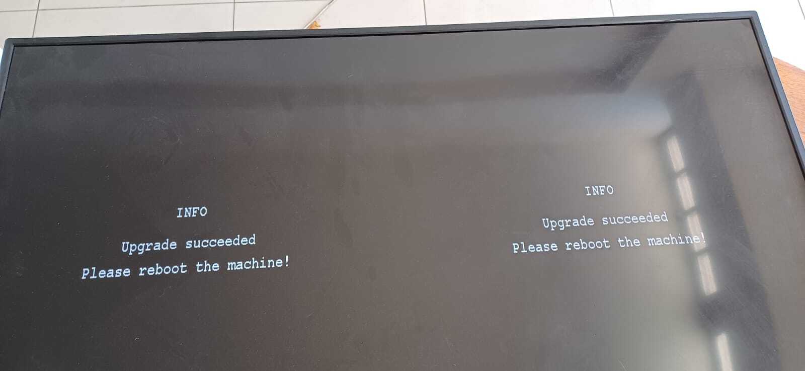

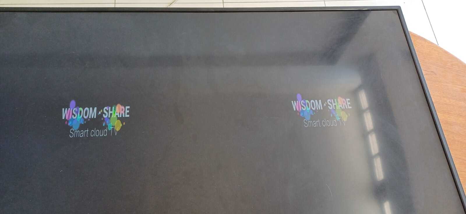

    It's a model LT-50N795 with a board number TP.HV510.PC822. I attempted a firmware update via USB, and while the upgrade was completed successfully, the TV is still stuck on the Wisdom Share screen on reboot.
    Has anyone encountered this issue before, or does anyone have any suggestions on possible solutions?
    Thanks in advance!
  • lotas
    • Jan 2016
    • 4698
    • Russia
    You downloaded the wrong firmware and got a split screen (the firmware does not match your panel), regarding freezing, try this method through the terminal...
    https://www.youtube.com/watch?v=SEtgqszcBMQ
