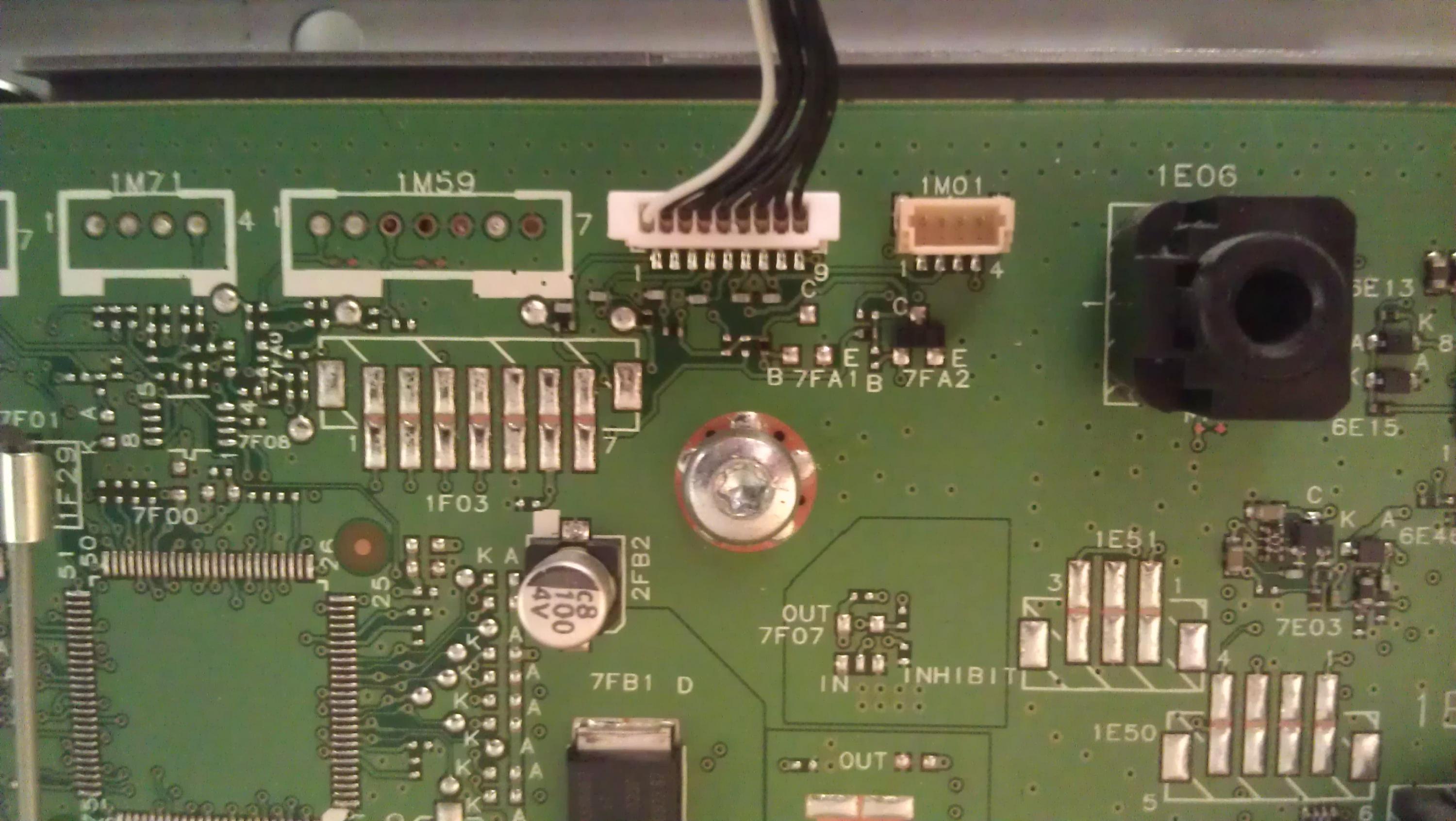

      Re: Philips 42PFL7403D Doesnt turn on
      @Budm - What about that transistor at 7FA2 if that is shorted might it cause this problem
      Pic on Post38

            #45
            Originally posted by selldoor View Post
            Its not on the Led panel control board its in the last picture.
            Ok sorry.
            It's a BC847B .
            I should probably desolder it when testing, or what do you say?
            I will test it tomorrow.

              Sorry, I dont know - that is why I was asking Budm if it might be relevant.

                    @ Budm - not sure we are talking about the same transistor - I mean the one under the 4 pin connector on the main board.

                            #53
                            Pic on Post38
                            I measured the voltage on this transistor.
                            When TV is shutdown (and PSU is not working) I have a stable
                            0.65 V on pin B of the transistor (measured to ground on TV-chassis)
                            Nothing on E and C.
                            When PSU starts working the voltage on B is pending between 0.30 - 0.60 V.
                            Still nothing on E and C.
                            When mains are disconnected i get about 880 ohms from B -> C and B -> E. Nothing else.

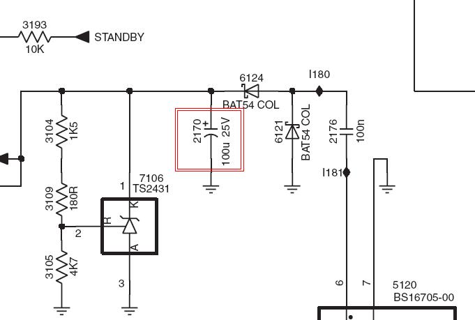

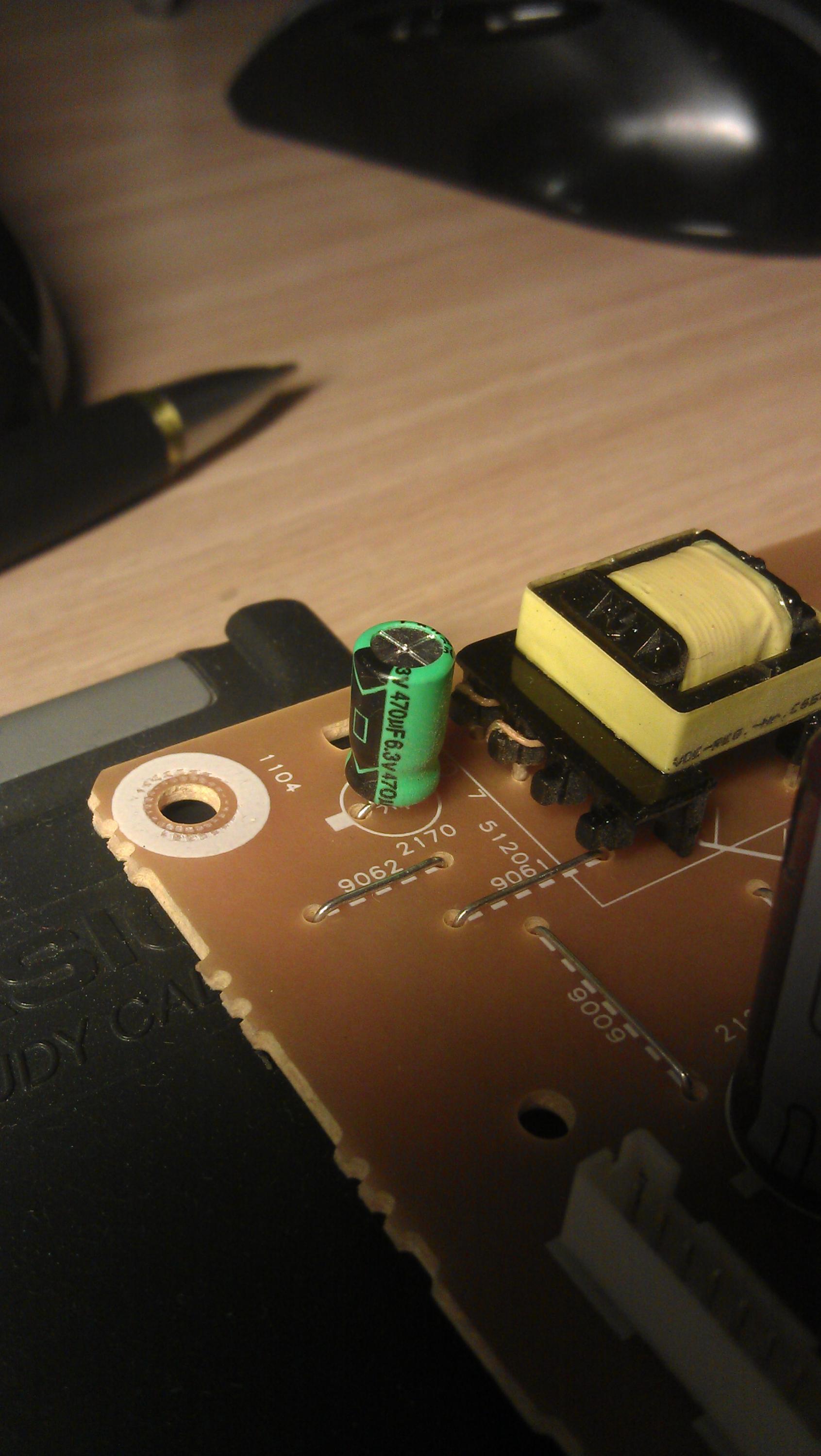

                                  #56
                                  Hi!
                                  Replace capacitor 2170 (100uF) with a 1000uF elko. On my TV set the voltage drop when pressing the power button of +3V3-STANDBY reduces to 200mV which seems to be sufficient. My TV set works well since this mod.
                                  Regards,
                                  STB
                                    #57

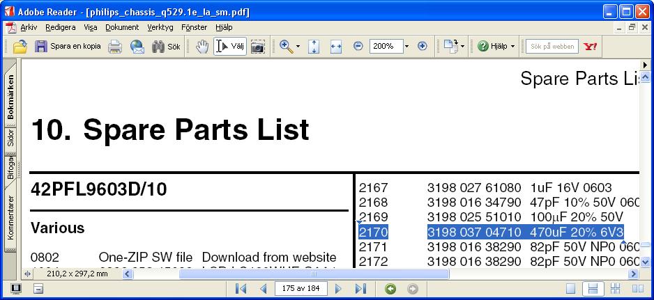

                                    Originally posted by STB View Post
                                    Hi!
                                    Regards,
                                    STB
                                    Something strange about this capacitor.
                                    According to service manual "philips_chassis_q529.1e_la_sm.pdf" it first claims that this cap is a 100 uF 25 V (in the drawing). But, in the Spare Parts List the same service manual says 470 uF 6.3 V. Which one should it be? On the board it is a 470 uF 6.3 V.
                                    If you still think that I should replace it, what voltage should it be?
                                      #58
                                      In my TV was a 470uF 6V3 elko, i think it is worth trying 1000uF. The voltage rating should be at least 6,3V.
                                      Check with the multimeter the voltage drop reduces significantly.
                                      Regards,
                                      STB
                                        #59
                                        Regards,
                                        STB
                                        OK. The only 1000 uF I've got is a 35 V.
                                        Is it allright to replace with this one?
                                          #60
                                          It should be ok to test but i would order the correct one if it works.
