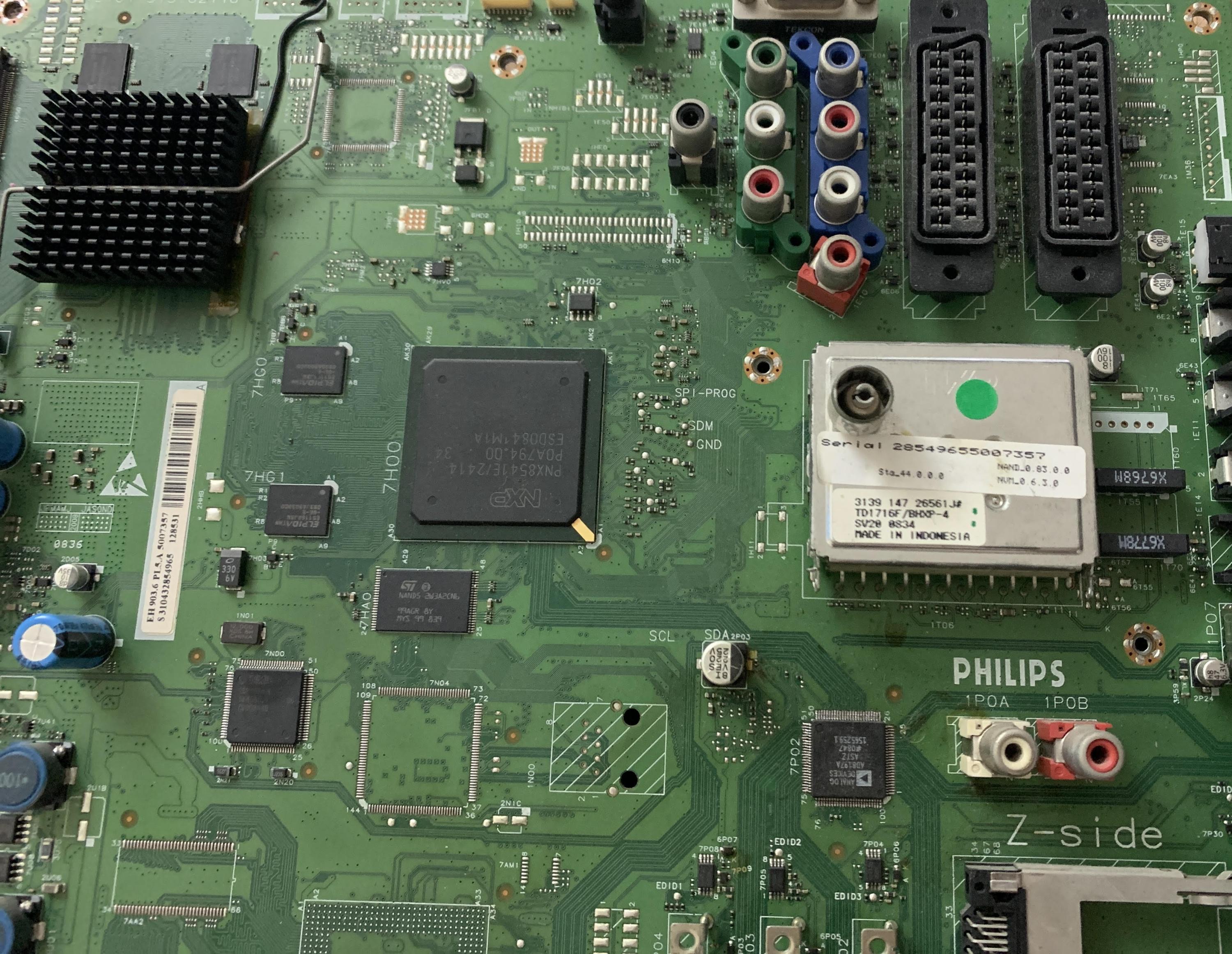

            Still nothing from me, the only findings are (dont remember where i read it) :
            Code:
            Fee Q529.1E SSB used in many LCD TVs PHILIPS, but, unfortunately,
            in the past, they have become massively fail. The cause of their damage
            are substandard planar transistors. The purpose of these field-effect
            transistors is stabilized power supply (1.2 V, 2.5 V and 3.3 V) for the
            different controllers. Most often burned transistors responsible for 3.3 volts,
            transistor after 95% of the crashes controller PNX. The repair of these boards
            complex and not always a positive result, and we urge you not to try to repair
            themselves. For the repair of this unit requires the IR station, stencils, balls ...
            So the problem is shown in LCD TVs PILIPS in case of failure of payment SSB Q529.1E
            1. TV does not turn on, blinks 3 or 2 times
            2. TV does not turn on the red light
            3. Stripes on the screen, the sound is normal
            The easy think is to find and change transistors, but i havent found PNX BGA on market yet..so i still searching..

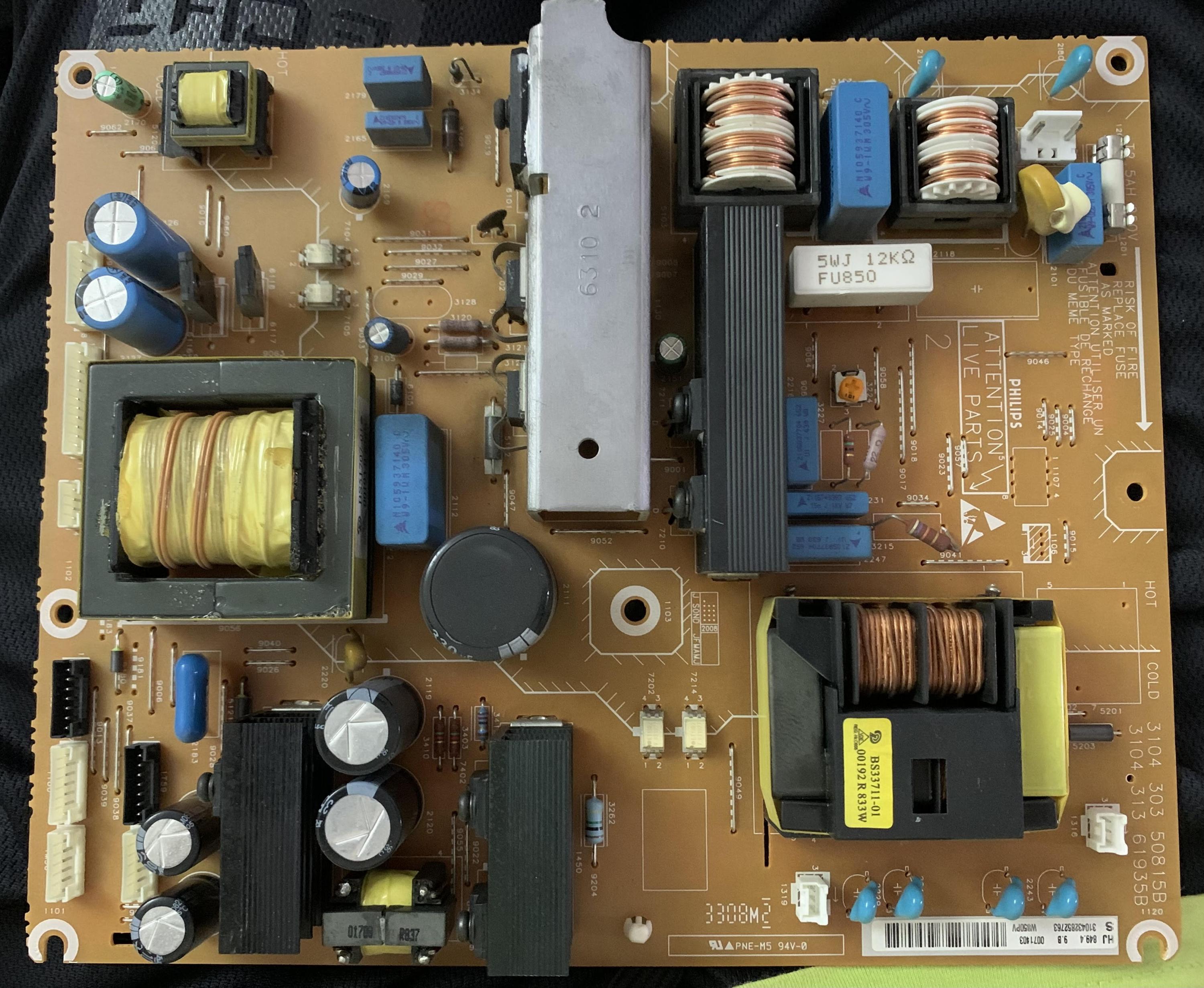

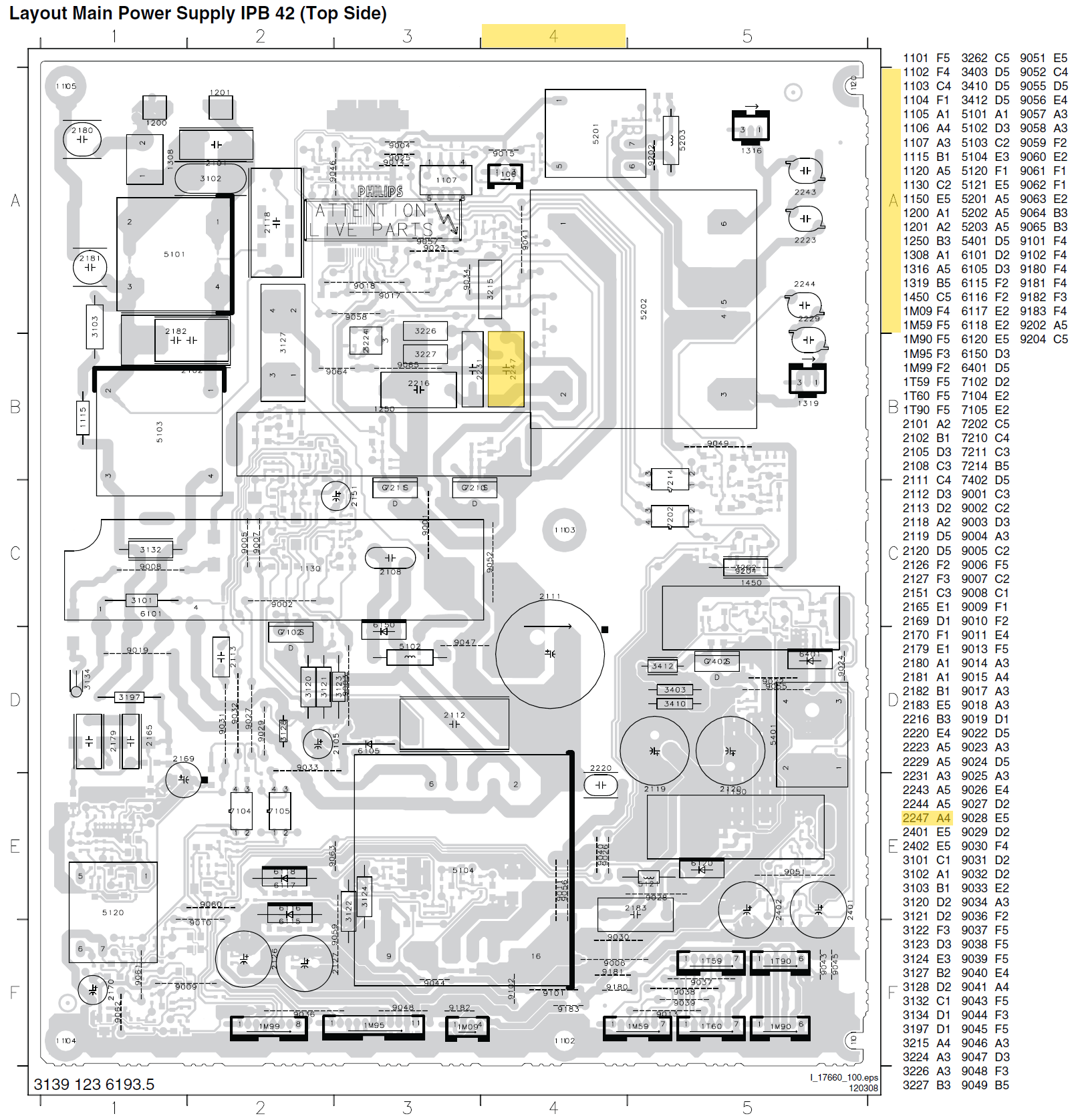

                            I got the TV running again! I had several film capacitors in suspicion. Namely, 2247, 2112, 2165, and 2179 since two of them (2165, 2179) are in the standby circuit. The other two I just exchanged with. And with success!
                            2247, 100nF 5% 630V
                            2112, 1uF 20% 305V
                            2165, 22nF 20% 305V
                            2179, 100nF 20% 305V
                              #74

                              Originally posted by schlickbert View Post
                              hi again,
                              maybe i should have read this thread more carefully. after measuring and experimenting, i finaly changed capacitor "2170" to 1000uF 25V on the main power supply.
                              until now everything seems to be working fine for me to ........ :-)
                              best regards
                              schlickbert
                              2247, 100nF 5% 630V
                              2112, 1uF 20% 305V
                              2165, 22nF 20% 305V
                              Please mark on the picture, which parts you replaced...
                              Thank you...
                                #75

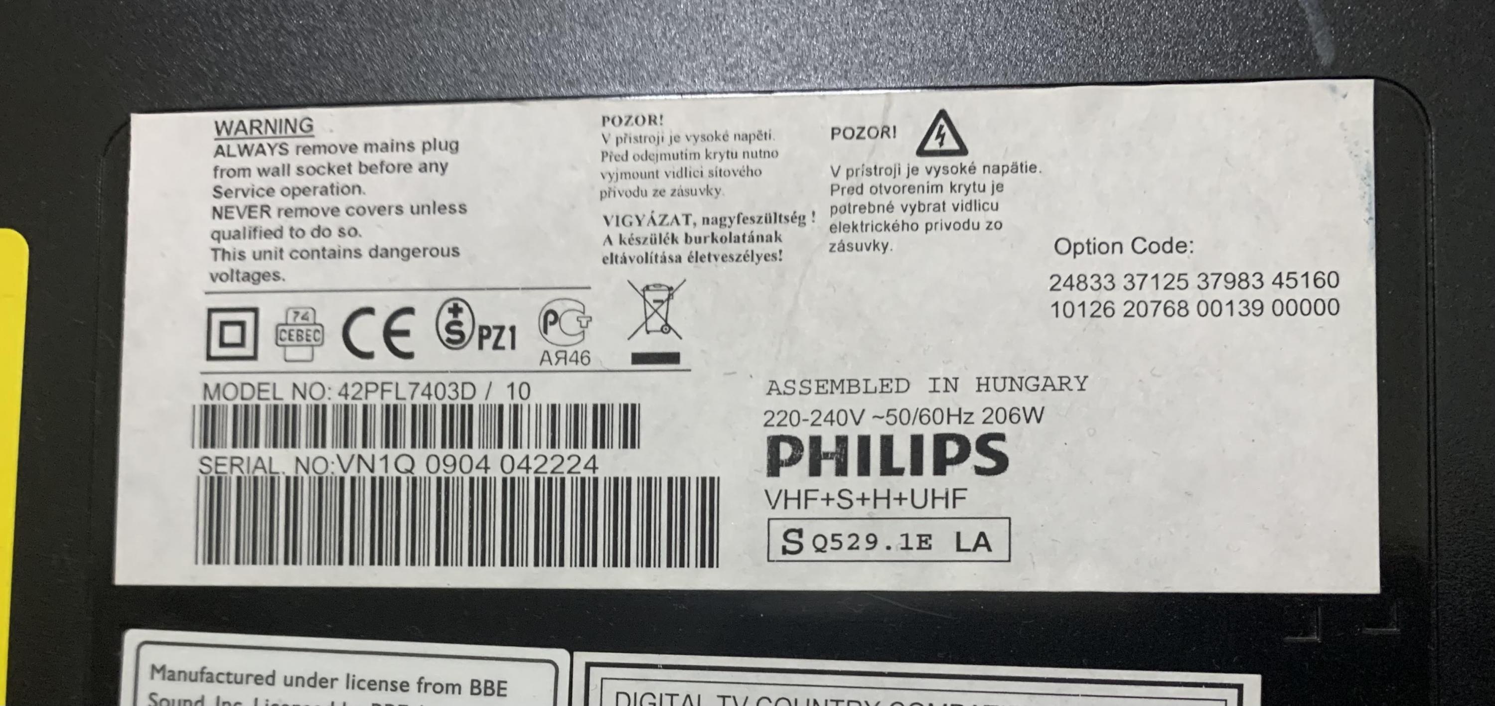

                                Re: Philips 42PFL7403D Doesnt turn on
                                Which chassis do you have?
                                Take a look at the sticker on the back of your device, it's specified there.
                                There seems to be either a Q529.1E LA or a Q529.1E LC chassis for this model, whatever the difference is.
                                That post you are replying to was from almost five years ago, good luck with that.
                                I think he was helpfully referring to the PCB layout index with his four-digit codes, because that's how they are listed in the Q529.1E LA service manual (instead of them being specified there as C2247 for example).
                                If you have that chassis too then you can download the service manual from this page and do a text-search on each of those codes.
                                If you get a hit on the circuit diagram index first, search again for the PCB layout index.

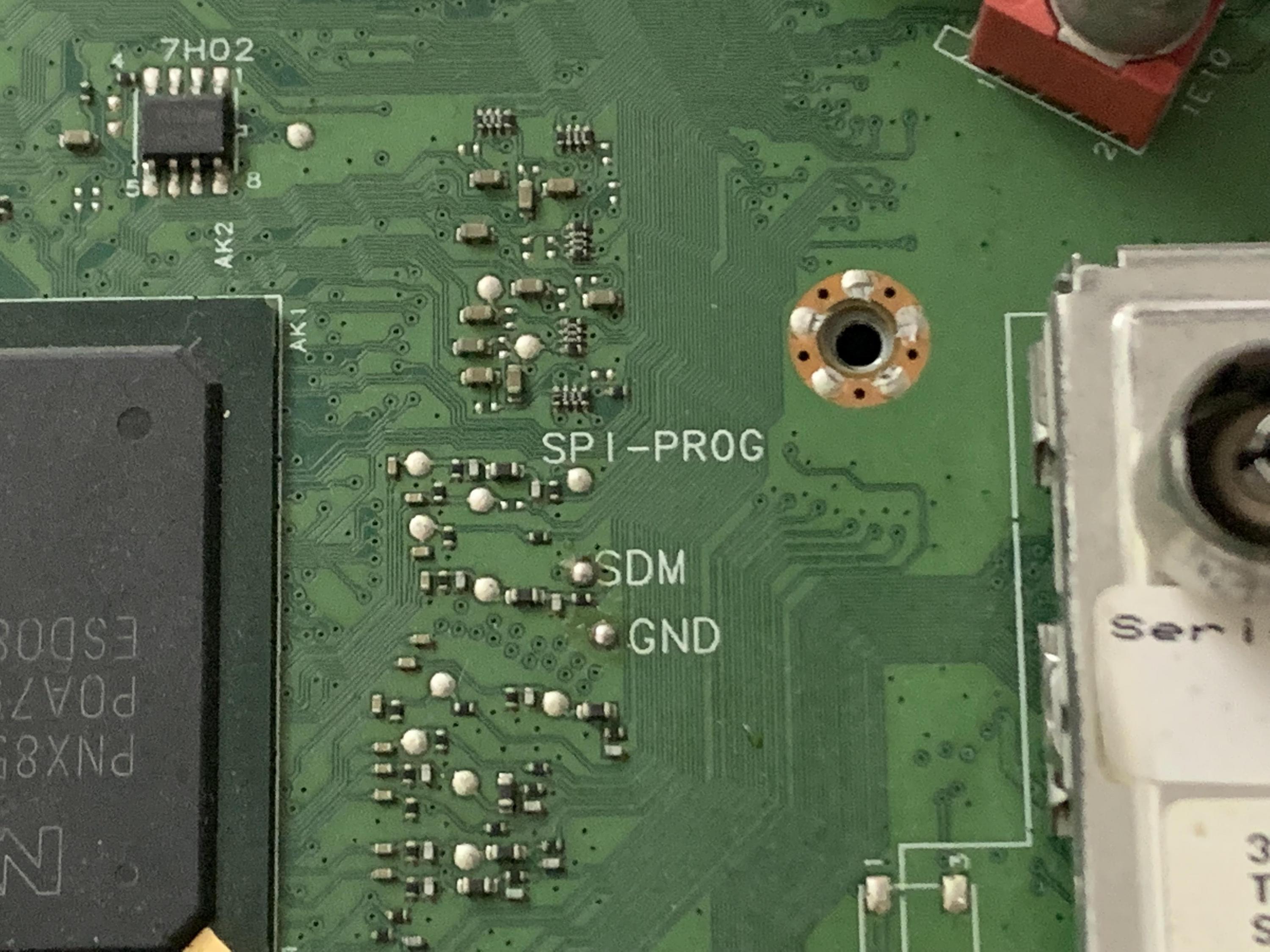

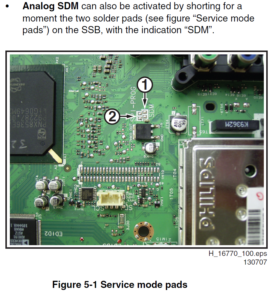

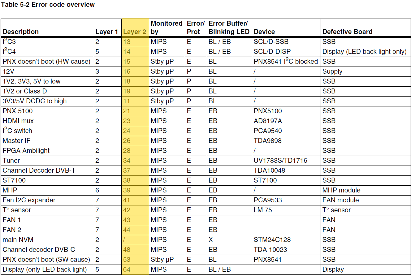

                                    In that case, download the service manual and press Ctrl-F in Adobe Reader to text-search for the component codes.
                                    You'll get a hit on the page below, here you can see that 2247 has a reference to grid location A4 on the PCB layout, and that is where you find the component, or at least the upper left corner of it.
                                    But before you start replacing components, you could investigate what the built-in diagnostic on the device can tell you.
                                    You are getting layer-1 error code 2 right now which is pretty broad.
                                    You can enable hardware SDM to see what layer-2 error code you'll get, which will be more specific.
                                    Take a look in section 5.2.1 in the service manual, it explains how you can enable SDM by hardware:
                                    I think it refers to the two vertically aligned pads on the right.
                                    Then you can skip ahead to section 5.5 that covers error codes, there you will find table 5-2 that describes the different error codes that you can receive, and there is also further informative descriptions about the different error codes in that section:
                                    Finally, section 5.6 describes how to interpret the blinking LED into the error codes.
                                    I hope this helps!
                                      #78
                                      hi.
                                      I have already ordered these capacitors, I have not received them yet.
                                      2247, 2112, 2165, 2179, 2170.
                                      I ordered with the same data listed on the capacitors that are on my TV.
                                      My board is different.
