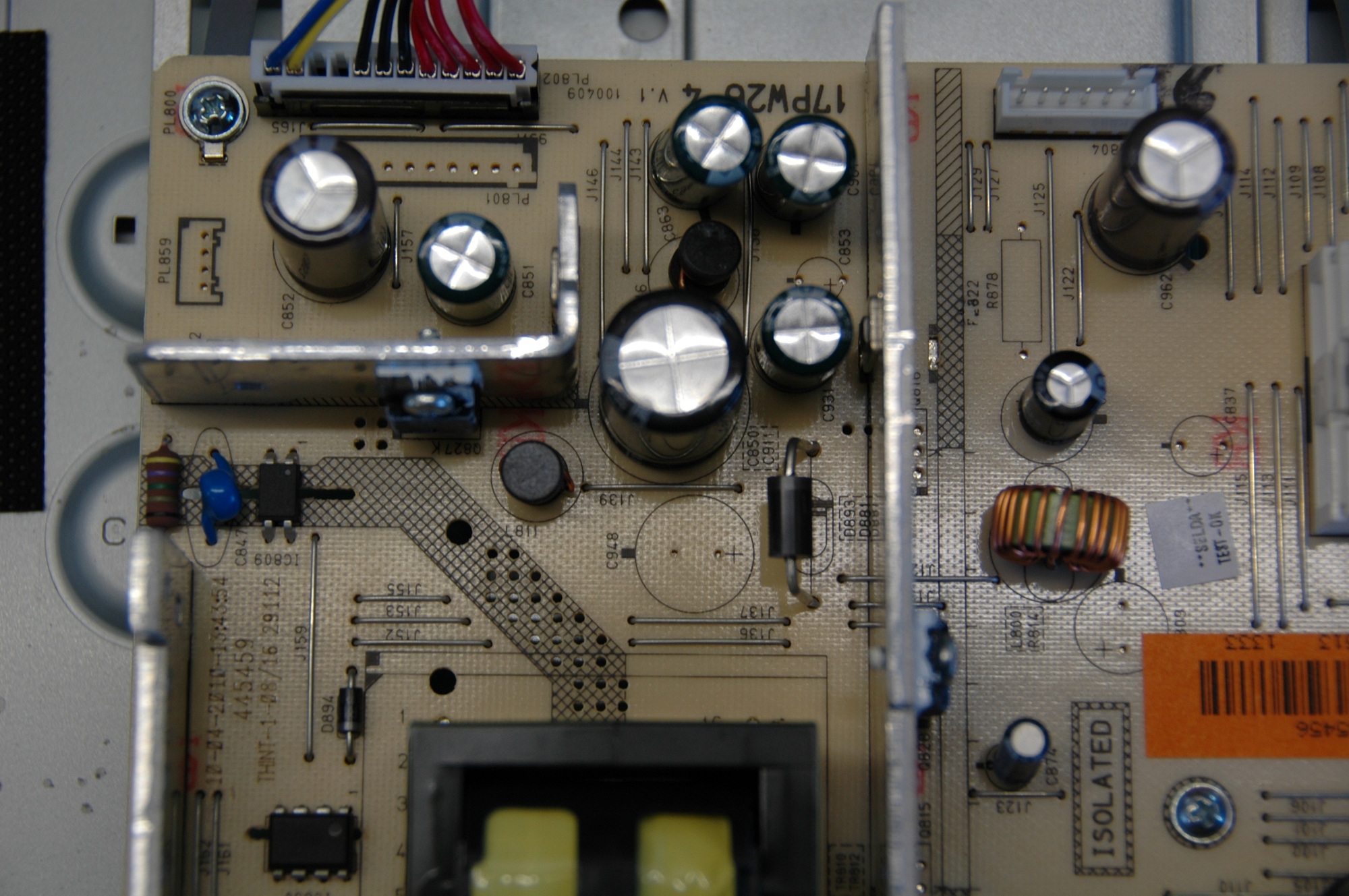

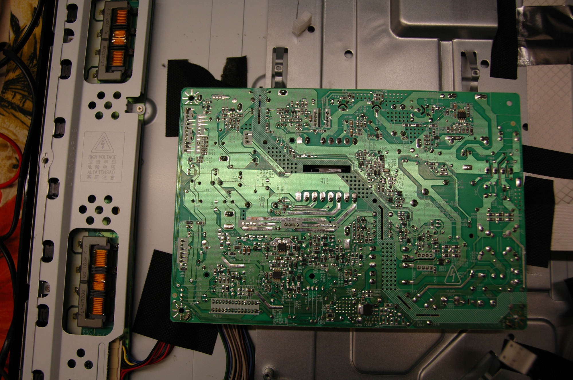

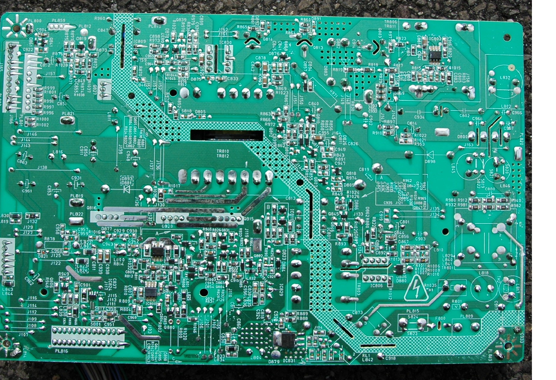

            Re: Sanyo CE32LD47-B flashing standby light
            Thanks for the replies.Pin 12 to ground is 8.9Kohms with inverter connected.I have found a short between pins 1 and 3 of IC831 with pin 3 disconneced but I cant identify the device.
            • selldoor
              Slow Learner
              • Dec 2010
              • 7870
              Picture is no good for us to help look for cold joints - perhaps tryagain in natural light tomorrow?.
              Looks like a Voltage regulator which is odd for an IC number I wonder if that relates to something missing off the board or on the other side ( have made that mistake before and it could be a mosfet) - do you mean you cant read the part number?
              Try and clean it with isopropyl alcohol and use a magnifier
                IC831 turned out to be a red herring.I lifted it off the board and i can see now its just a diode with only two pins connected to the pcb and it reads OK.Cant see any bad joints and posting a better picture of the print side.Bye the way back light does not flash at start up.
                Does any one know if this power supply will work in isolation and if not is there a way to test it? I still think it might be shutting down because of no voltage on pin 12 of PL802 which might be the back light on signal.Just dont want to get another power supply and find i have the same problem.
