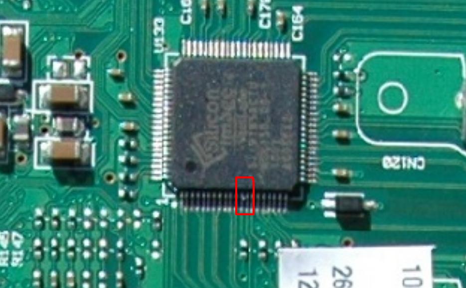

    Unlikely to be anything but check this for bridging.
