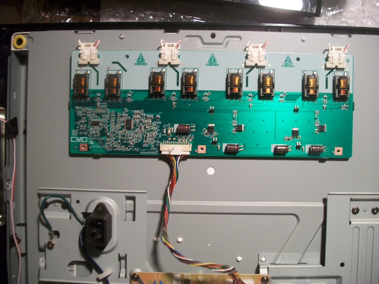

    On the main board there are two smd fuses. Both show 0.1ohm. On Inverter board there are two fuses. The first is small 0.75A / 63V. It reads 0.7ohms. The second is larger and is rated at 6.3A / 125V. It reads 0.1ohms.

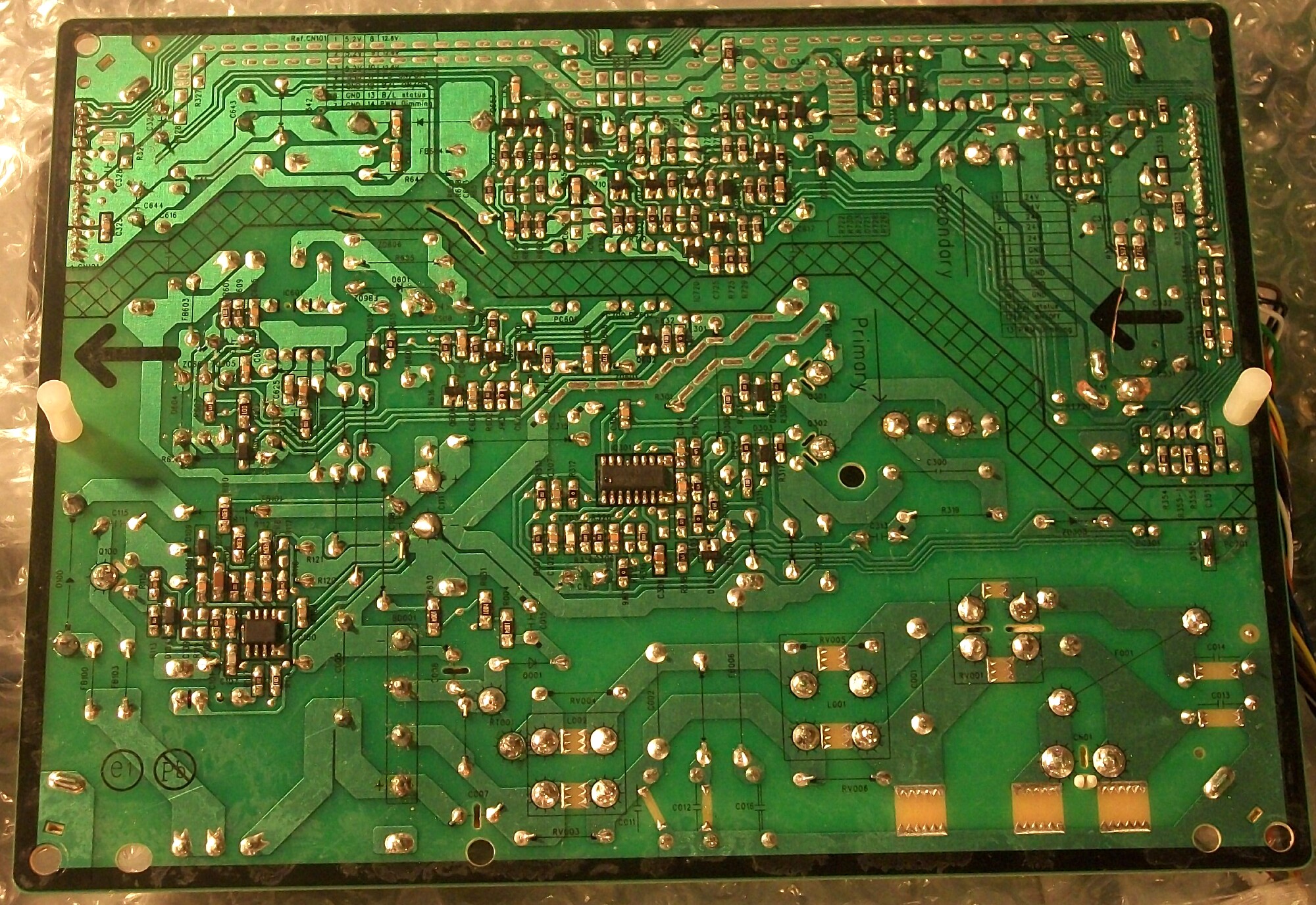

                          Can we see good picture of the bottom side of the power board?
                                    Here is the picture of the bottom of the board. There are two places where I messed up the pads when I removed components for testing. I scraped off the green carefully and soldered the legs to the copper trace on those two components. I think they are solid. There is also a scratch I made with my iron on the right side of the board. Check that out to see if that might be causing my problem.
