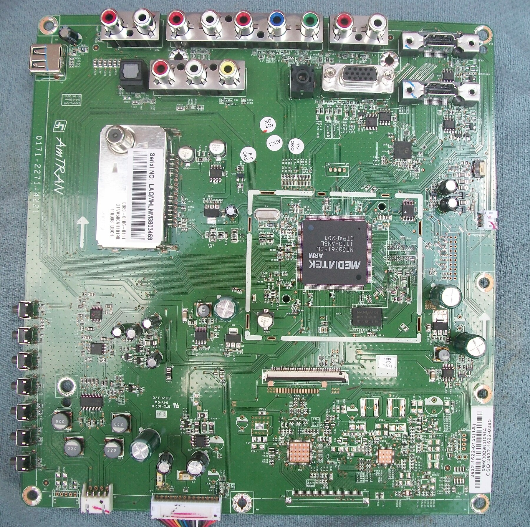

    OK, you do not have the PS_ON signal from the main baord when you trun on the TV, that is why the PFC and the 12/24 Vdc power supply do not turn on. So we need to find out where the fault is on the main board.
    Last night when I checked the PS-On voltage and found none I went over to the mainboard and checked the 3 AP117 Regulators that everyone seems to find bad. From reading all the threads on Vizio Tv's this seems to be a common issue. I am not sure what I should be finding for readings on these regulators. I just checked them again, Pins are left to right with top bar oriented at top for reading purposes. Readings did not changed when I pushed the power button.
    U4 = 2.05 3.29 OF
    U5 = 0.55 1.79 3.32
    U6 = 0.0 1.24 3.32

                        Not sure what you are seeing at pin 1 of U6, it looks (post #61) like it is fixed out put regulator with 3.3V input (pin3) and output (pin2) is 1.25V, pin 1 is ground (0v)

                            If there is resistor to ground at pin1 of U6, then you should be able to read the voltage drop across that resistor unless you did not set the meter to the lower voltage scale so it can show better resolution.
                              #74
                              Re: Vizio E321VL

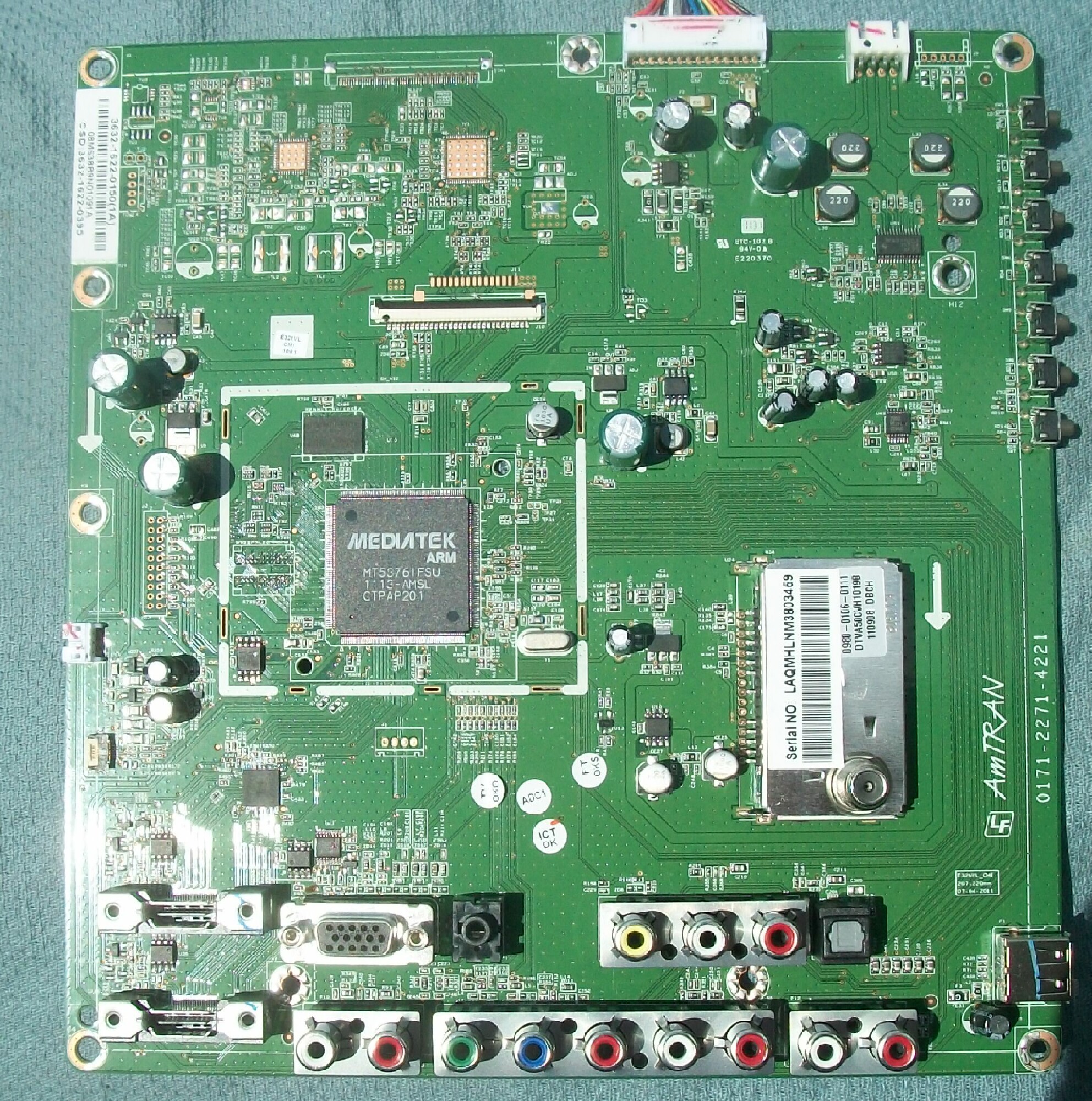

                              If I read it correctly then I got 1.239v across the resistor under pin 1. I am attaching photos of the top of the Main Board taken this morning. On U4 I got the same as U8 and on U5 I got 0.546v
                              I also rechecked the regulators and none of the three have a number like 1117-XX so how can I tell what the nonadjustable regulator should be.

                                I guess I just answered my own question from post #74. You use the same regulator it is just connected to ground on the 1st leg. So the U4 regulator will not be adjustable because it is not wired to be.

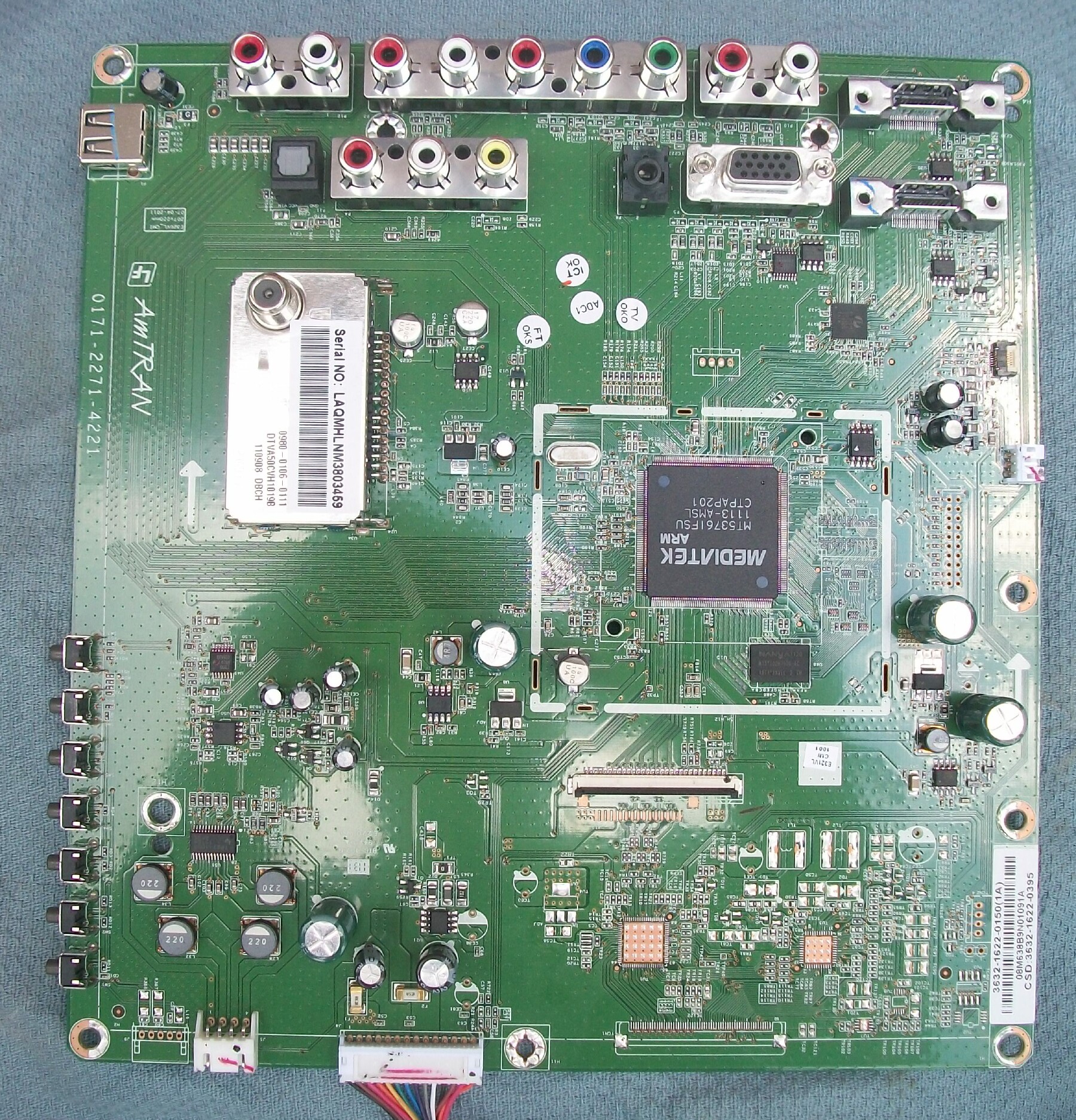

                                  Is this ok or as it got a hole in it?

                                    It looks to me like a ink stain. I can see a letter U under the whatever it is. It is not a hole for sure.
                                    On my post, I think is #74 am I correct in what I am saying that the regulator is the same it is just what pin 1 is connected to that determines if it is fixed or adjustable. Fixed is connected to ground, Adjustable to a voltage source.
