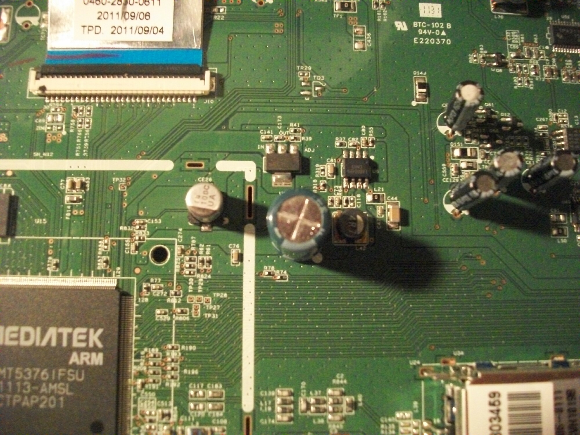

          Well things did not go well at the hospital. This was my wife's cousin and he passed away.
          I have done some reading in the other threads on Vizio's as I have had time over the last few days. According to one post you wanted the values of the two resistors under the legs of the U4 LDO AMC1117 to help calculate the Vout and Vin. The two readings I got were:
          R1 = 179.9ohms R2 = 109.8ohms. However, that only appeared to be applicable to the Adjustable regulators.
          Another formula I found in the data sheet was Vin = Vout + 2V using the voltage readings I took on U4 Vout is 3.3V so Vin is 5.3V. Is this correct?
          In another thread I read that there should be continuity between the first leg of the regulator and ground. I get continuity on the first leg of U8 and U5, but I don't get it on U4. Does this indicate that U4 needs to be replaced and if so is the 3.3V fixed version the correct regulator to use? None of these 3 regulators have anything printed on them but 1117. The U8 & U5 I believe to be adjustable regulators since that is printed on the board. Just for info's sake the readings I got on U4 are Pin1 = 2.04v; Pin2 = 3.29v and Pin 3 = 5.23v. Reading left to right with tab at top. U8 was Pin 1 = 0.00, Pin 2 = 1.24 and Pin 3 = 3.32v. U5 was Pin 1 = 0.549, Pin 2 = 1.79 and Pin 3 = 3.32v.

                  I am pretty sure that the regulator that I am talking about is fixed. The numbers on all the regulators only say 1117 not 1117-XX, however on the other two regulators U8 & U5, silk screened on the board at pin 1 it says (adj.). Pin 2 says (out) and Pin 3 says (in) . That is not printed on U4. If in fact U4 is fixed like I think it is then I have to determine the output so that I can get the correct regulator and install it. I may be totally wet thinking that this regulator is bad, but everything I have read so far about Vizio's they have had at least one bad regulator. The two adjustable reg. seem to be ok from what I am reading in the data sheet Bud supplied.
                  Since on U4 I am getting a voltage reading on Pin 1 (2.05v) and no continuity to ground on that pin it makes me think that it is faulty. From the looks of the board U4 Pin 1 should go to ground and not have a voltage to my way of thinking at least. I hope this makes sense.

                    If you are getting 2.05 on pin 1 of u4, then it is not FIXED output regulator since pin 1 is not at ground potential.
                    What voltage do you get when you put the probes on PiN 1 & 2 of U4. It should be 1.25V.

                      I am getting 1.243v between Pin 1 & Pin 2. I wonder why they would print the adj. on the board on the other two regulators and not on this one? So if U4 is adjustable then are all three regulators operating correctly?
                      Reading left to right with tab on top
                      U4 = 2.05 3.29 5.23
                      U5 = 0.549 1.79 3.32
                      U8 = 0.0 1.24 3.32
                      On the connector between the power board and main board on Pin 1-3 I am reading 5.24v as is printed on the label for that connector. The only other pin that I get any reading from is #13 which reads 0.430v the rest of the pins I get some kind of negative reading in the MV range.

                        They do not always print everything on the PCB.
                        So U4 PIN 1 is 2.05V, pin 2 is 3.29V, PIN 1 and PIN 2 is 1.243V
                        then 2.05V + 1.243V = 3.293V, so it is OK.
                        The key point for checking the Adjustable regulator is to measure pin 1 and pin 2 voltage, it should ALWAYS be 1.25V (+/-3%), if not, then it is bad. Then you add this 1.25V reading to the pin 1 reading, that will become your output voltage at pin 2.
                        U5 looks like Adjustable also and the voltage looks OK if PIN1 and PIN 2 reads 1.25V, then 1.25V + 0.549V = 1.799V. U5 is good.
                        U8 it looks like it is a fixed regulator, pin 1 should read less than 1 Ohm to Ground, and the number as printed on the body should be some thing like 1117-1.25. Post the picture of this U8 so I can see how it is hooked up.

                          I checked the voltage between pin 1 & pin 2 for U8 and U5 and both are 1.24v. Also I checked the ohms between pin 1 and ground for u8 and it is 2.01ohms. On all three regulators there is nothing but 1117 written on the regulator.

                            U8 is fine, it is Adjustable to put out very low limit of the regulator, 1.25V.

                              Well if all the regulators are good then what is causing the lack of 12v back to the power board to turn everything on? I have checked the fuses, and the two on the main board and the one on the power board read 0.1ohms. There are two smd fuses on the inverter board. The large one reads 0.1ohms, but the small one (0.75amp) reads 0.9ohms.
                              If I understand correctly there is a small voltage signal constantly from the power board to the main board, then the main board sends back a signal for the power board to send out the 12 and 24volt to the inverter and LCD control board.
                              I have not done anything other than measurements on the main board or the inverter board. Checking for voltage across the two fuses on the inverter board there is a 0 voltage reading so it does not appear that board is getting any power from the power board.

                                There is 5V standby voltage to run the processor, when power switch is activated, the processor will send out PS_ON signal to turn on the Main power supply 12V/24V section.
                                We will need the diagram of the main board to find out where the PS_ON is at which IC.

                                      Re: Vizio E321VL
                                      Can we have a close up picture of the two areas where I thought the traces were broken.
                                        #99
                                        Re: Vizio E321VL
                                        This is the best picture I can get tonight. I hope it is good enough for what you need. I looked these areas over pretty good and did the continuity test you suggested and could not find any broken traces.
