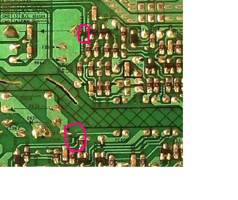

                    if we are now looking for smaller errors Killian6pk You did say you had resoldered some traces - I have been looking but could only see what I thought was one and it looked ok but of you want us to check you will have to mark where to look.
                    Anyway whilst looking I did find what appeared to be two broken traces. it may be the picture or shadow but please can you check where marked in attached.

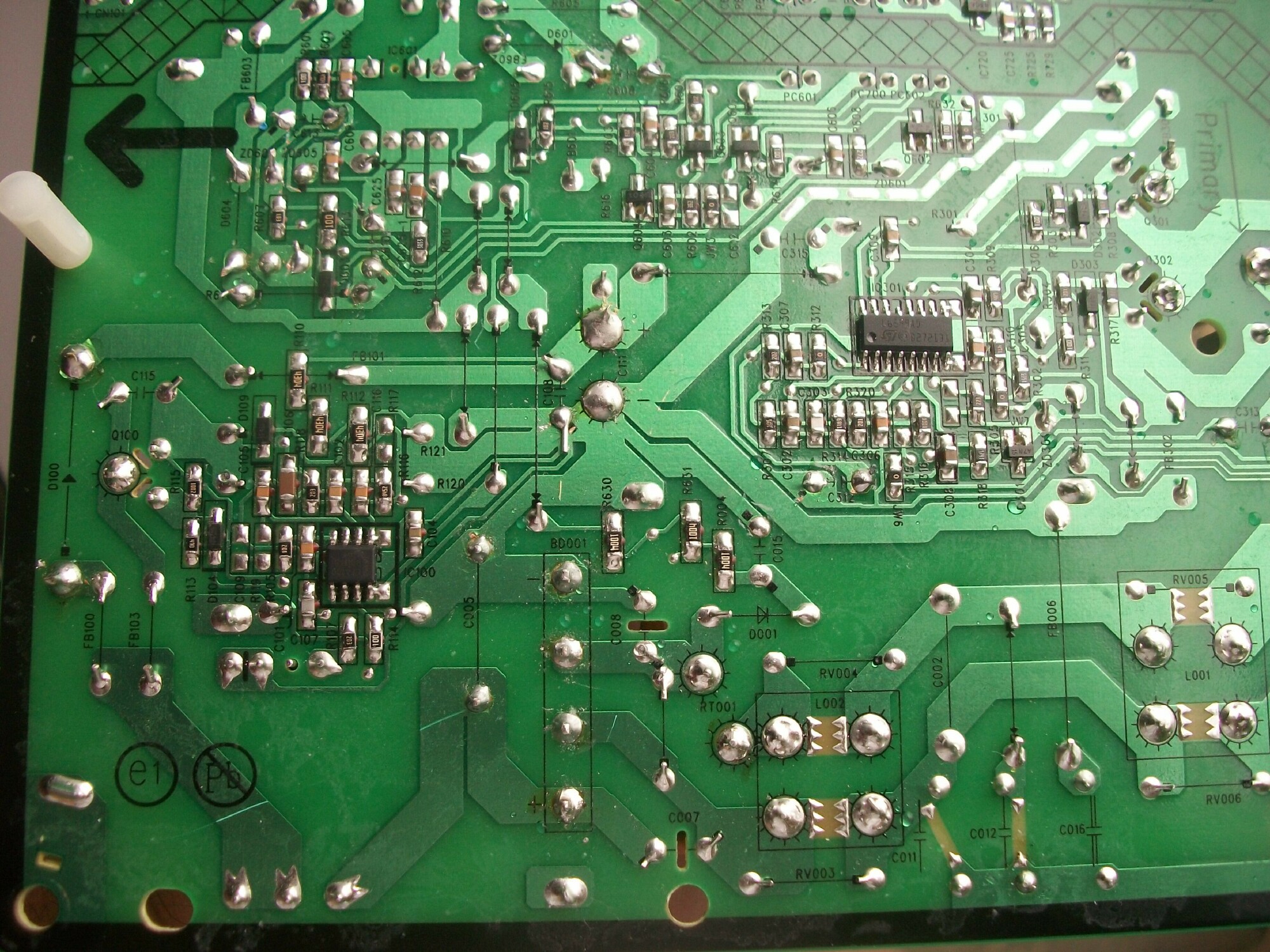

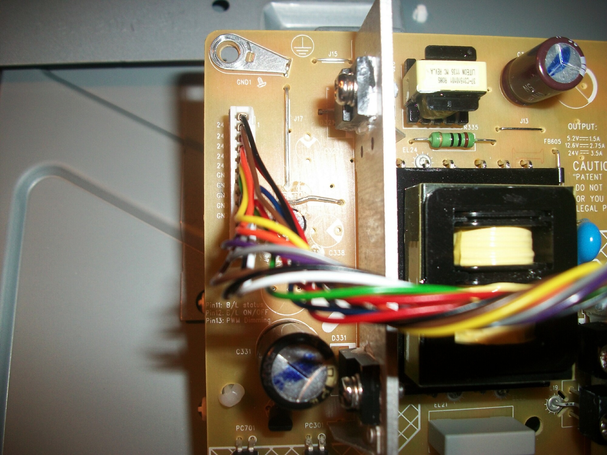

                      Re: Vizio E321VL
                      I need closed up pictures of the bottom side of the board acround the pfc ic and the SMPS IC so I can trace out the connections, also need the cloased up pictures of the connector on the power supply board so i can see the lables on them, I need to find ot which pin is PS_ON pin, this will be the next step.

                        #51
                        Re: Vizio E321VL
                          If you keep the board oriented in the direction of the picture and look at C608 in the upper left of the board. Go to Buds redline of the picture and look above the number 4 that he placed on the picture. The second location is on the far middle right of the board next to a large black arrow at D331 also look at the scratch across the black arrow to see if that could be a problem. Copper is showing thru.
                              Attached are the pictures you wanted. Kind of gloomy outside today so I hope this is clear enough.
                              On the Inverter Connector picture Pin one is at the top.
                              On the Main Board Connector Pin one is at the bottom.

                                OK, I will look at the pictures tonight, I cannot find any info on that PFC IC P/N L100 either, it may be difficuit to figure out the VCC pin of that IC, will see after I look at the pictures.
                                OK, picture#3 post 54, CN101 Pin 11 is PS_ON PIN, please check the voltage onthat pin, it should be around 3VDC or higher when TV is switched on.
                                  The repairs look ok and the scratch is not a problem. Its getting late here now, Im off to bed. If you get a chance check out the trace damage if there is any, by doing an ohms test between joints along the trace.
                                    It is 0.0V using common to ground pin on that connector and also to the ground screw by the AC Input.

                                      OK, you do not have the PS_ON signal from the main baord when you trun on the TV, that is why the PFC and the 12/24 Vdc power supply do not turn on. So we need to find out where the fault is on the main board.
