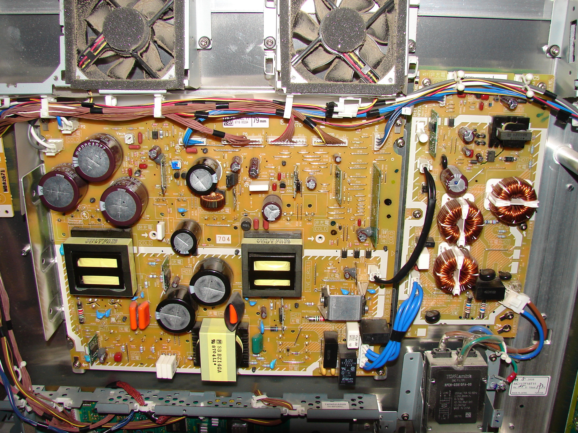

    I have a Panasonic plasma that has the error code of 2-blinks.
    I have downloaded the service manual and troubleshooting guide.
    It is a 15v SOS issue.
    There are three causes for this; Missing 15v, a short, or wrong diagnosis by D-board.
    I have tested for a short at pin 1 at P7 and I have 1.6 kohms. (it does drain though)
    Then there is 15v present (at all locations) before the relay clicks off.
    I have replaced both the D and P board (except P(AC)).
    I am still having the 2-blink issue.
    I am suspecting another bad D-Board maybe?
    Any suggestions?

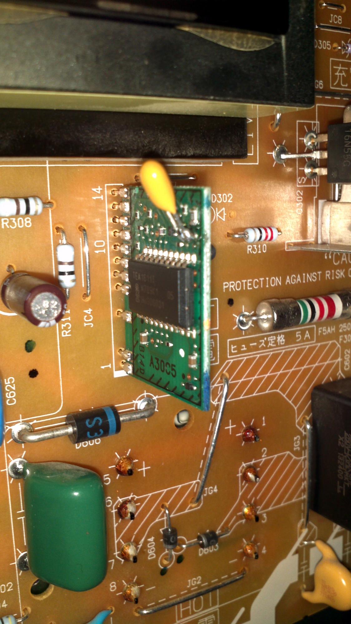

    If you go to this AVSForum thread you'll find lots of info.
    http://www.avsforum.com/avs-vb/showt...ighlight=mc301
    Start about 4 post from the bottom of page 33. Sounds like you may a power control module MC301, MC201 cap problem. Hope this helps.

      I see in the forum where it could be that module issue with the cap but I have already replace the entire board, you wouldn't think it would have that issue would you?
      I guess I could always check to be safe but I'm leaning towards an A board.

        I'd try and do the 2 blink checks.
        http://www.scribd.com/doc/46124232/T...GPH11DU-Chasis
        This is the one I used for a 42pz80u and a 50pz80u. The 42 was the A board.
        The 50 I replaced the cap on the MC301. You could try the cap fix on the old board. The caps are only about $2 each at Radio Shack.

          Well, I bought the same model with a cracked screen for $50 and replaced all the power boards, A board, and D board and...........7 blinks lol.....well at least it was something new lol so I replaced the Y sustain and IT WORKS.
          2 blinks can be the SC board but their troubleshooting guide kinda threw me for a loop.
          But it works

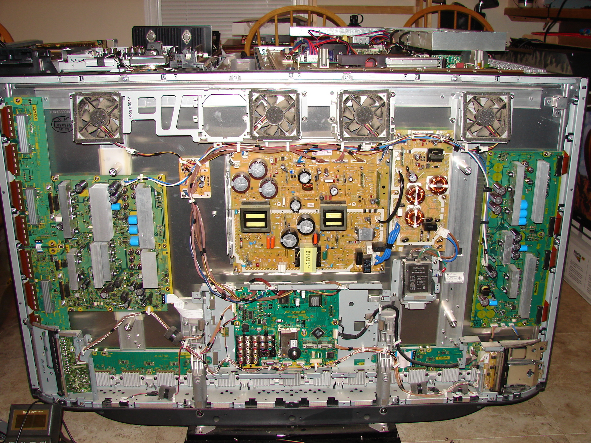

                  1. Reseating the connector P25 may solve the problem. If it does not.
                  2.Right before the unit shuts down, check the VSUS voltage at connector P2 of the power supply. If VSUS voltage measures zero volt, disconnect the connector P2 and SS11. Check the VSUS level at socket P2. If it is still low, replace the P board.
                  3. Unplug the unit and disconnect the connectors A5, A6, and A7. Apply power to the TV. If a White screen comes up and all voltages check normal, replace the P board.
                  4. If the TV stays on after isolating the SC board, then replace the SC board and the D board; it is likely that the fuse on the D board is blown
                  I see replacing the Y-Sustain fixed it late night didn't read down enough Congrats on saving your set

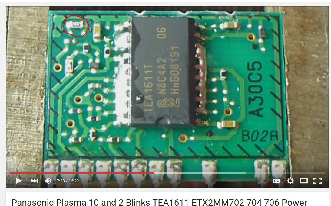

                                      hello, i attempted the mc201 replacement and there a little resistor next to it thats gone missing.
                                      can any one help me with the value of this so i can replace it?
                                      https://www.youtube.com/watch?v=LjpGKaBt8hg
                                      in this video half way thru you can see the resistor on the left.
                                      he even warns you to watch out for it lol
                                      thanks
                                      • diif
                                        • Feb 2014
                                        • 6978
                                        • England
                                        Re: Panasonic TH-46PZ85U Power Issue
                                        This one ?
                                        I have a board here from a 42" and it seems the values are different depending if its the MC301 or MC201.
                                        MC201 is 101 (100ohms) MC301 is 201 (1kohm)
