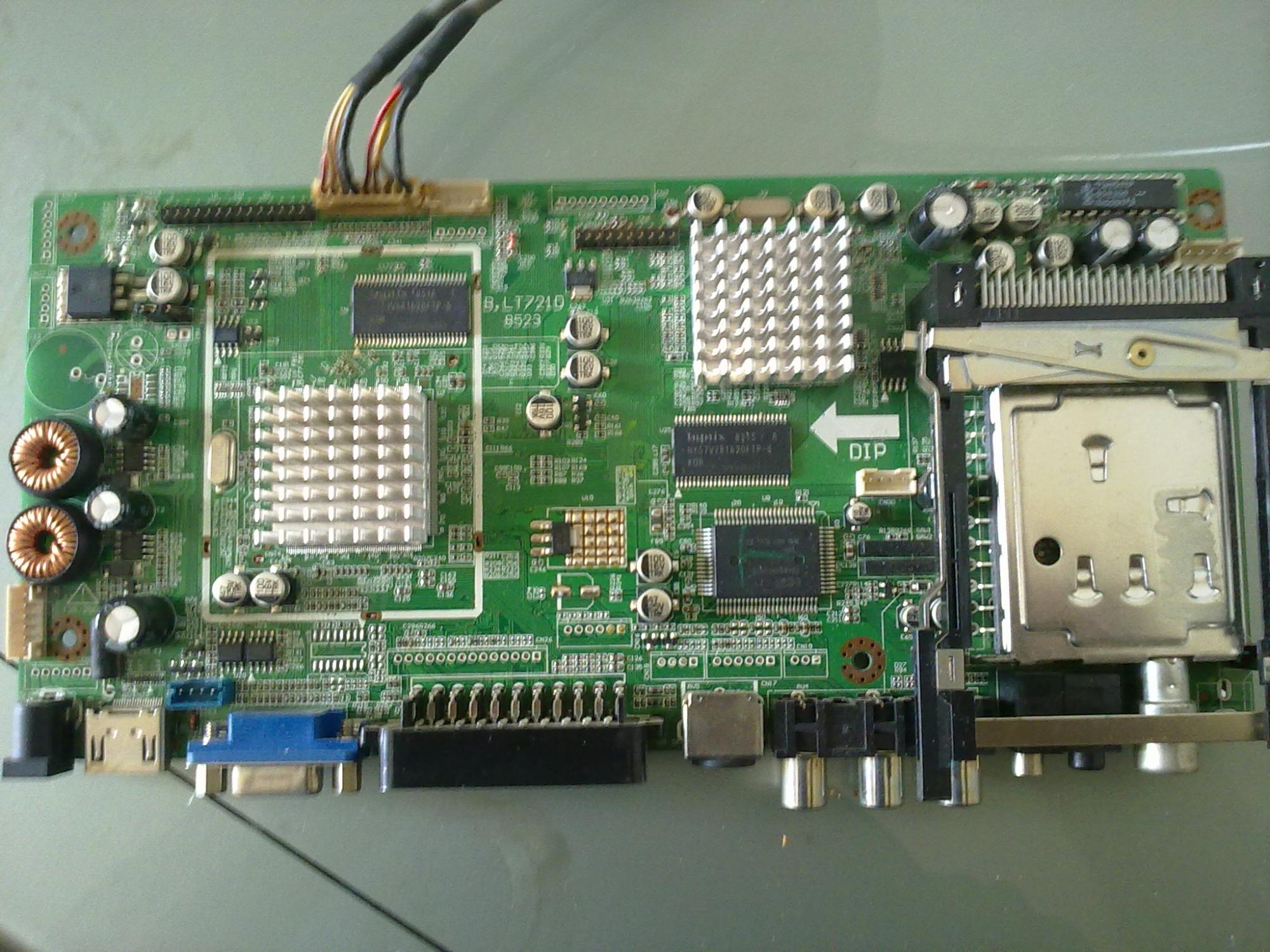

    Found this TV last week that I've never heard of before, brought home since panel would also be nice as PC monitor 'for the wife', anyways it runs on a
    12V external power supply that did not come with the TV but I have a few around the house.

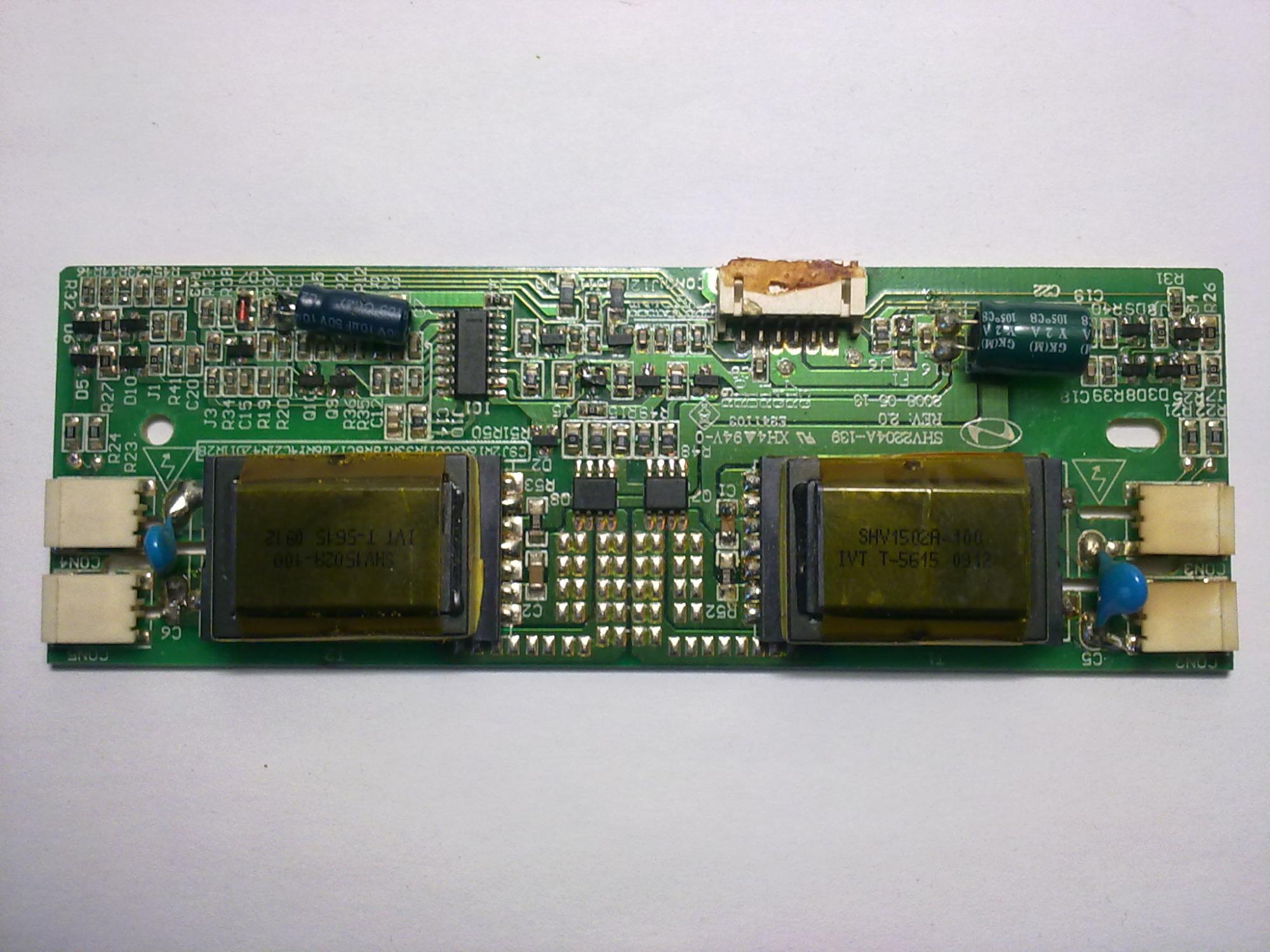

    So the problem here I believe is the inverter as the TV comes on with menu for about 3 seconds and then shuts down, the standby light remains green.
    I tested the back lights with another PSU/inverter and it seems they are working, I might utilize this panel with another PC video card but it seems the harness to the T-con socket will require a relocation of some wires as the PC desktop did not show only colors, red to green as if it was calibrating?
    I changed out one cap C13 which was reading fairly low as you can probably see in the pic 'sh*t' soldering but no change in operation, the ceramic caps
    C1 & C2 near the transformers also have an odd reading 6.5 Ohms both ways, is this normal?

    C5 and C6 could cause this fault. Looks like something got quite hot around there.

      The 2 resistors next to these caps also read 6,6 Ohms both ways!

        Maybe they're in parallel?

          Change all the electrolytics... Two on the inverter and three on the logic...
          You'll also need to re-cap the brick... If you can't pry it apart, use a dremel. Don't cut too deep though.

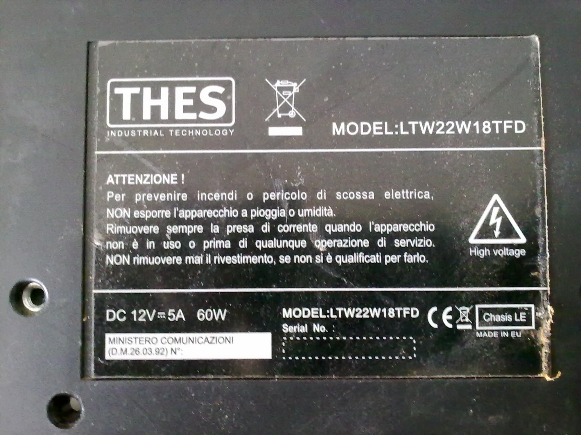

            I believe its 5A-12v and I think I will try to install a internal PSU as I don't have 5A bricks.

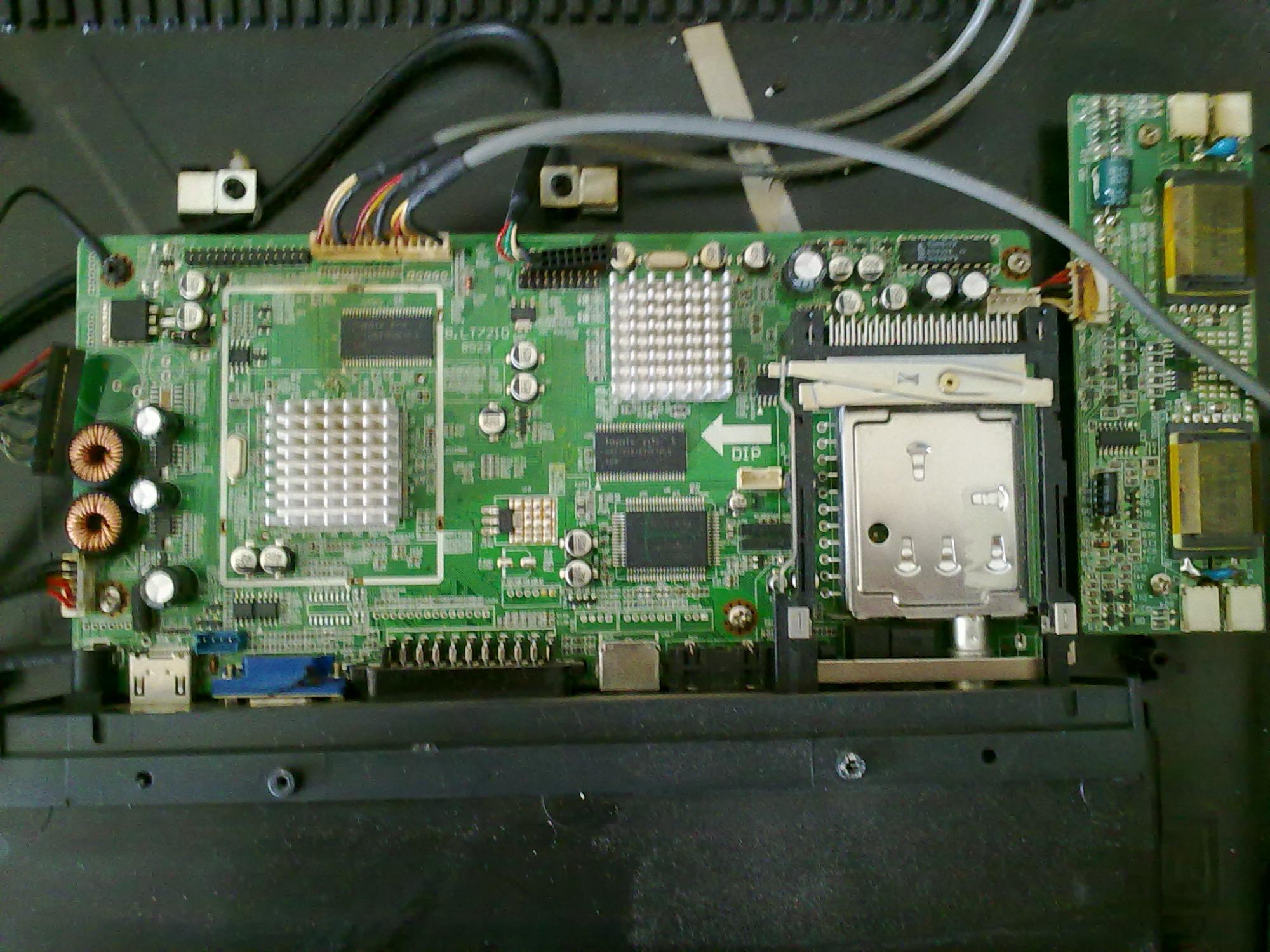

                I hooked up the other video board with its PSU which tested fine on the back light test but with video hooked up same scenario, shuts down within 3 seconds and led remains green! I did move 1 ground wire to match the original harness and I could see the desk top on boot etc.
                I'm suspecting that this could also be a T-con related problem now??

                          Well done with the wiring! My panel is OK no busted wires or shorts, tested the lamps and they work perfectly, the panel is a http://www.digitalview.com and is well made, the video/TV board and inverter are a pos.
                          I'm in the process of changing the caps that I bought today but I don't think the caps are the solution I think there could be a problem with MP1410 2A Step Down DC to DC Converter, I will know more after fitting the caps!

                            Check D1 on the inverter board (located above J5 in the first picture). It looks like its plastic case has melted.

                              Well as I mentioned before the readings on MP1410 were just the same after recapping most of board with 12V, that led me back to the PSU question?? Tried 5 different bricks all 12V and no ways would it start then as a last alternative I rigged it up to my test computer's PSU and bingo the panel works great. I manage to fined a manual and will look for another brick or mounted PSU tomorrow so suspend will work.

                                Are the bricks you tRIED rated at least 5A?

                                  One brick was rated for 6A but the voltage was higher than 12V around 12.7V the suspend light would come on but no amber to green, the 2A would start it up but the inverter would shut down, strangely the Hannstar PSU would run the CCFL's but the video card was not supported and would also shut down.
