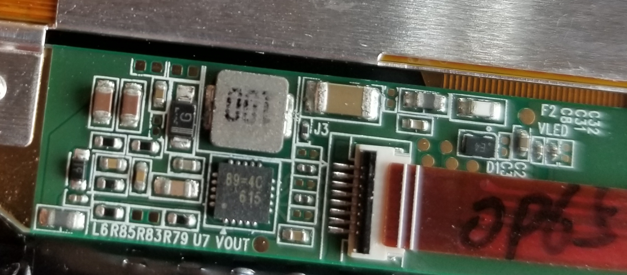

    Hi guys could anyone identify replacement for this chip marked 89=4c 615
    It is LCD inverter driver I believe
    Thank you

    89=xx - RT8532

      Wow thank you !
      I couldn't find that earlier.
      Ordering it now...
