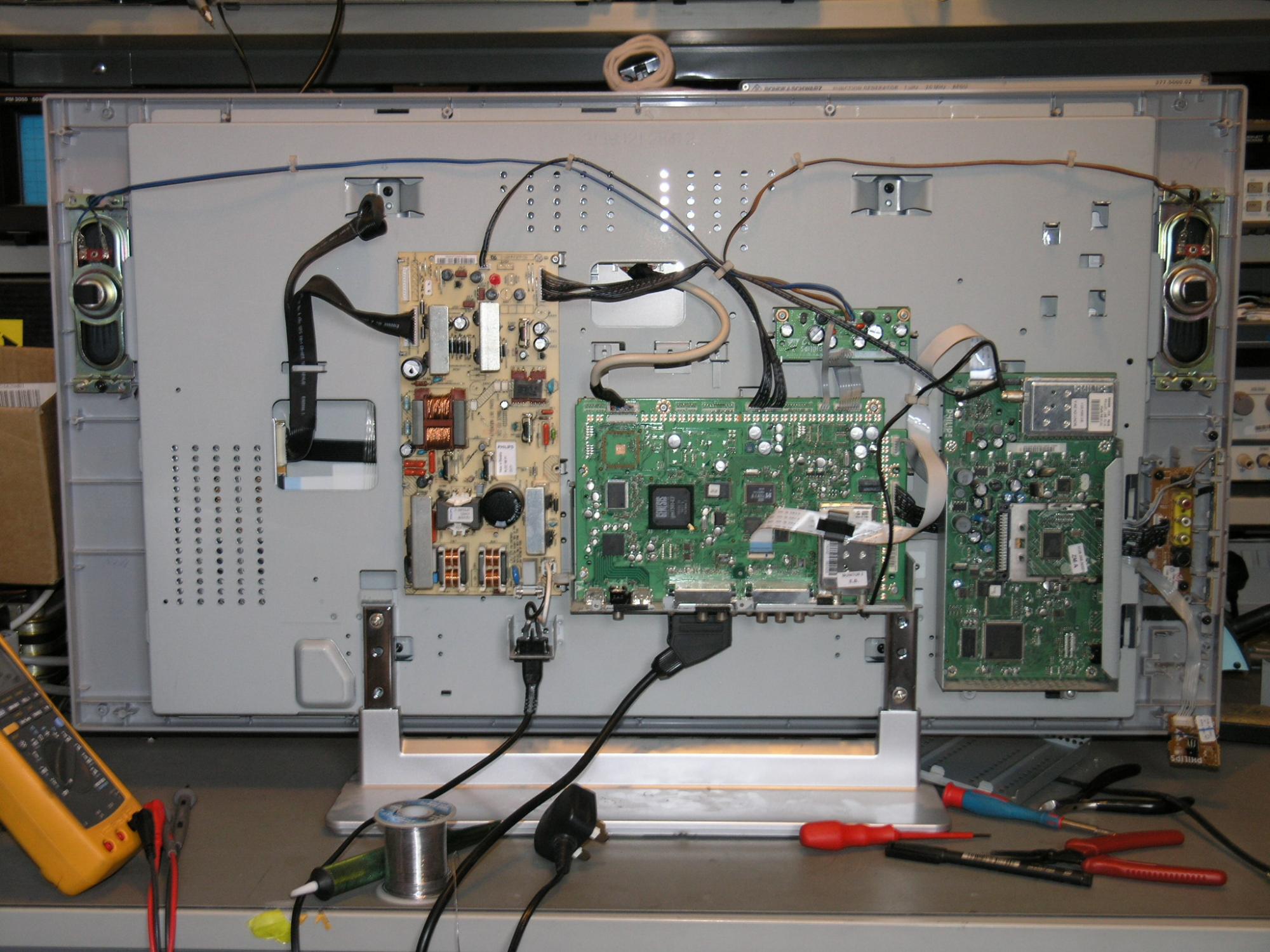

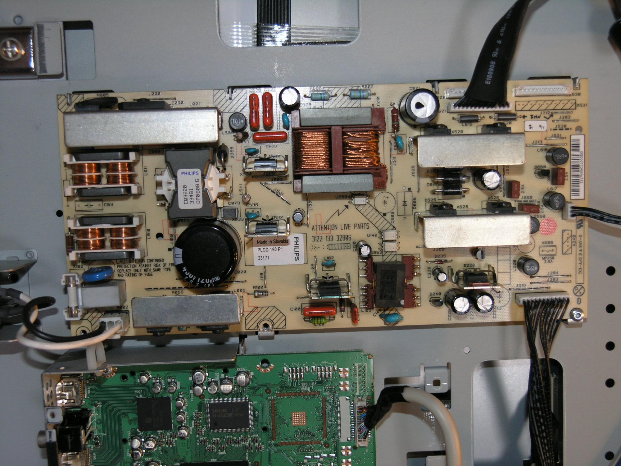

    I've just saved this TV from a journey to a skip (or possibly just delayed it a bit?) .
    The fault in simple terms is - no picture, no sound except slight audible whistle from a switcher somewhere and the status led goes between Red (standby) and off - should be green for on i believe.
    So far I've checked all the caps (except for some real tiny ones), all the diodes and all the transisters on the psu board - which is a PLCD 190 C1 type.
    I have the service manual for it (LC4.31E AB) though it's a bit lacking in info for the 32" version and some bit are innacurate like the block diagram - it's close but no cigar.
    the outputs of the psu board seem OK. and 'some' of the other supplies generated on the SSB & IBO Zapper board again seem OK. ]#
    Short of measuring everything i'm a bit stuck.
    Anyone had any dealings with this set?

      Re: Philips 32PF5521D/10 Stuck in Standby Sortof
      Hi again Tom66
      Attached a couple of pics of the set.
      I think i'll investigate the inverter board today. i had been hoping it wasn't them as as you will know their behind the metal chassis the rest of the boards are attached to.
      "a broken screen"? i had noticed a lot of comments about sound but no picture relating to this set. i believe that was the reported fault. now it seems to do nothing at all though and suspiciously no visible signs of backlight
        Hey QuantumCheese
        sorry for the dumb question, what is the monster cable going into the inputs, never seen one like that
          Is 5V standby steady and present on the power board and the other boards?
          PS. Nice multimeter, I'm jealous.
            Originally posted by uberplasma
            Hey QuantumCheese
            Do you mean the SCART cable?
            I know it's a bit old-skool but i was hoping it would auto switch from tv to that i/p and i could see if anything was working. as it is, the tv channels in my region are now all digital (no analogue) and it needs re-tuning......tricky thing to do without a picture
                Sort of.... According to the manual i have Vstby = 3.3?
                anyway, i looked at with a scope, the following and they are all 'clean' and measured as follows-
                Vp = 24V, Vstby = 3.3, 12V = 12V.
                I think 5v is generated on the SSB board (green one bottom middle in picture) and when the set is'on' it measures at 5V and looks clean.
                And thanks, I couldn't resist a nice Fluke having been stuck with Maplin-esk rubbish for so long!
                    Update
                    I've prodded my way round the "IBO Zapper" board (to the right of picture) and all of the supplies generated on that board measure OK
                    I think i've found all the supplies generated on the "SSB" board and they look fine & dandy too.
                    Hmmmmm.
                        Is there a "blink" code or time that it goes from red to off? For example, does the red led come on for 20 seconds and then go off? Or does it blink 8 times and then go off?
                            I don't think so, it's not a pattern that repeats.
                            1 blink would equate to "Mis-match of TV (Hercules) SW and Scaler SW", however that should also be available via the on-screen error readout so the screen not working would indicate otherwise?
