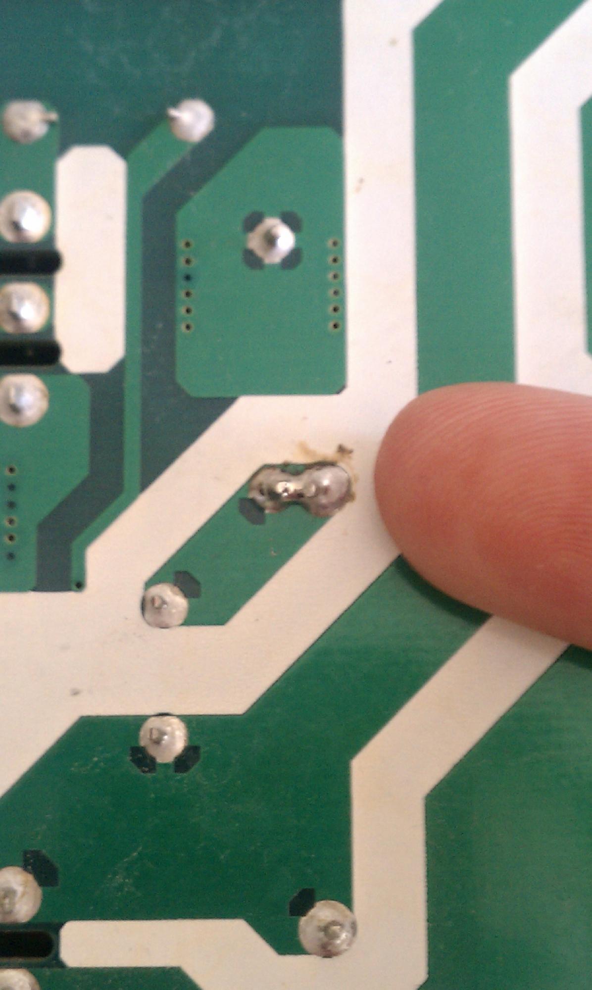

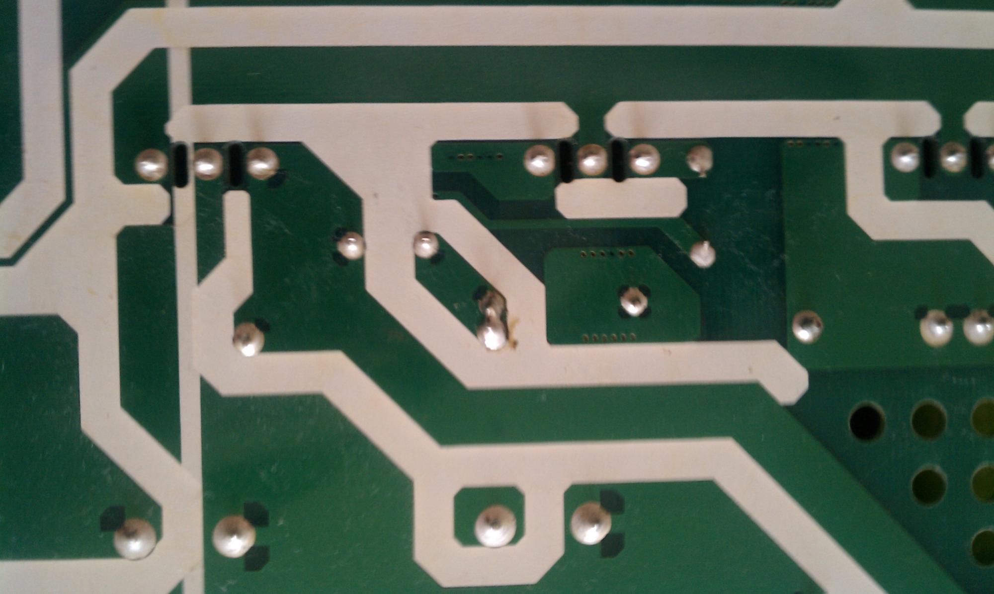

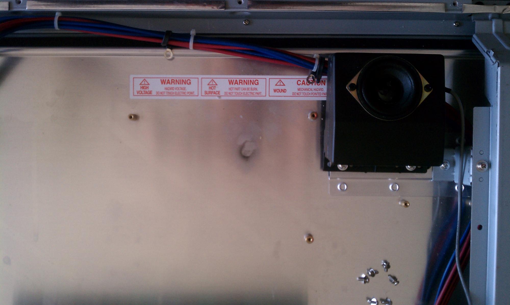

              I have a soldering iron but no meter i think the boards fryed because in the picture with my finger im pointing at 2 objects that have the solder touching and under the board theres a black mark on the back of tv screen.

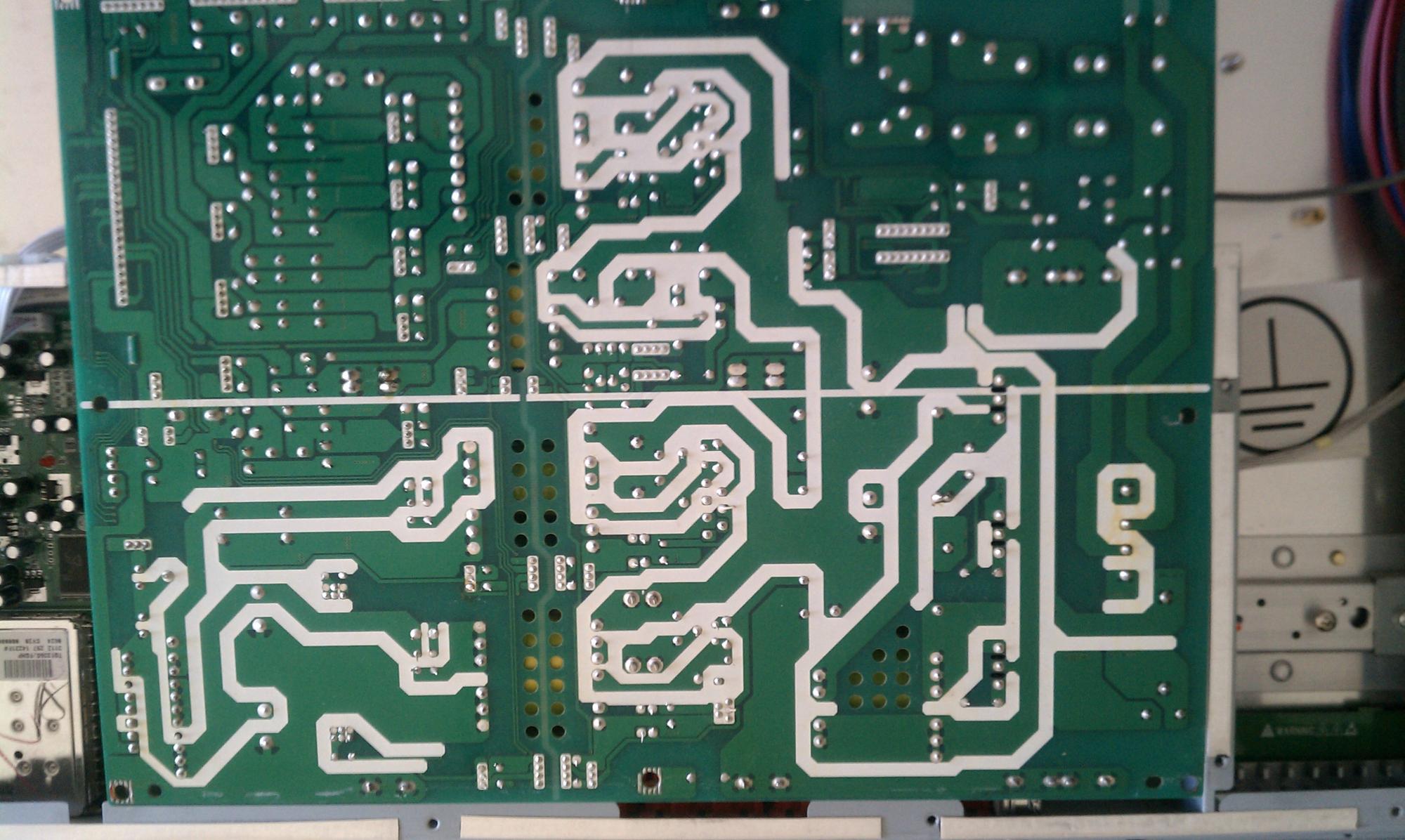

                  Re: Viore power issues!
                  is this big enough just click on the pics
                  the one with the finger is pointing at a bad solder job where its soldered there are two completly different components touching and theirs others on there touching in the same fashion as well with little "fryed" black marks around them the picture with the metal is the back of the screen theres a black mark that came from the pic where my fingers pointing.
                        A little burn mark on the bottom of the board is not necessarily your problem. It could have been, e.g. a "dust bunny" connecting between Vs and GND. You should post pictures of the top side of your PSU where all the components are.
