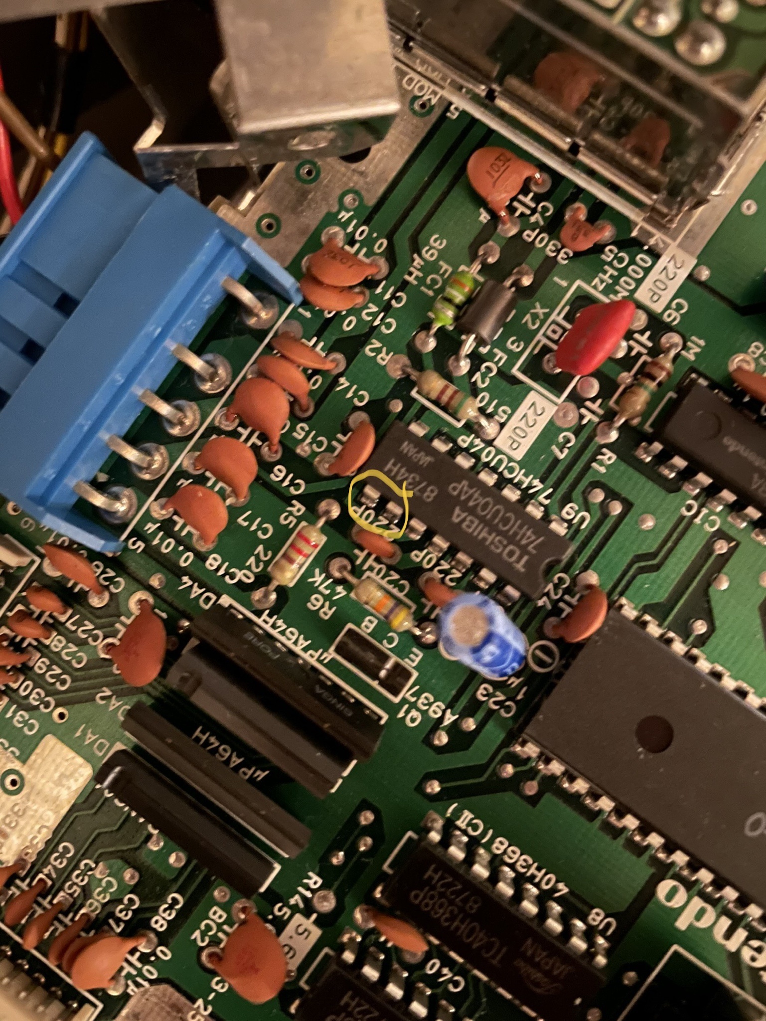

    I recently turned on my old NES to find the red light won't go on at all. When powered on it shows black bars on the tv and a loud buzz through the tv speakers. Powering it off, the buzz goes away and tv goes back to normal (white snow).

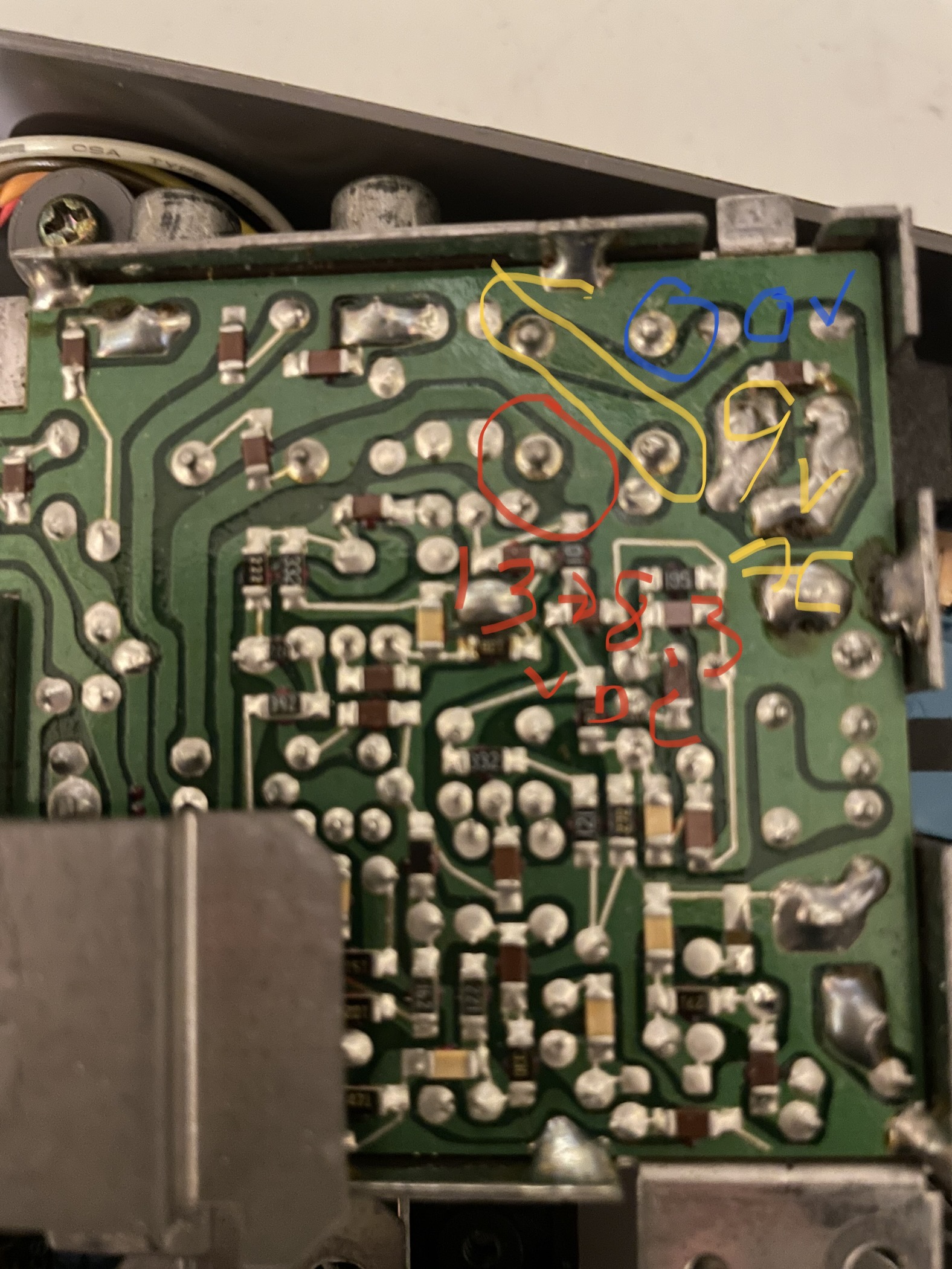

    I tested the power supply itself and it is outputting 9V as it should - first two solder joints on the board at the power port show the same.
    Here's where it starts getting funky - When powered on, one side of the 7805 voltage regulator is showing 18V and the other is about 8.7V (center 0).
    On the big blue connector I get 29V on the Brown (to power button) cable when it's off and 0V on the Red (power button return) cable. Pressing power on, the brown drops to 18V and the red goes up to 18v while the orange (voltage to reset button) goes from 0 to 8.7V, Yellow (power to LED) goes from 0 to 1.8V and the white (Reset button return) goes from 0 to 8.7V. If I hold down the reset button while it's powered on the Yellow (power to LED) goes up from 1.8V to 8.7V. I recall under normal operation the red led light goes off when you press the reset button which probably accounts for the increase in voltage from 1.8 to 8.7 there....
    Both leads connected at the LED read 8.7V when powered on.
    The 7805 should be dropping it down to 5V but I'm not seeing that anywhere. And I can't figure out where the 18V or 29V is coming from - so this doesn't seem right.
    All of this was tested as AC on my multimeter as the power supply is a 9V AC power supply.
    Any ideas?
    One thing I can rule out is a dead LED as well. When I touch the two pins circled in yellow in the attached photo together the light goes on solid. The first circled pin is 8.7V second is 0v​

    Chit... wrong NES... hang on. You should have 2 voltages. 9VAC coming in, going through the bridge rectifier, then your get 13VDC and it goes to the 7805 regulator, 13VDC in and 5VDC out. Set your DMM to DC after the bridge rectifer!

            Yeah, but your second voltage wouldn’t be right. 9VAC x 1.414 = ~13VDC. If you put in 9VDC, then you have to subtract the bridge rectifier voltage drop and you get 8.3VDC. Look at the schematic, it needs 2 voltages, one 13VDC and a 5VDC from the 7805 regulator. That means you’d need a 14VDC PSU, not a 9VDC PSU. An AC voltage through a rectifier is always times 1.414 more on DC.

                  The rectifier is doing not much, because you feed it with DC!
                  So either you feed the NES with a 9VAC power supply or you need a 14VDC power supply. The diodes in the rectifier have a 0.7VDC loss, so you should get 13.3VDC, just like when you feed it with 9VAC.

                      Yeah, me too. You need that 9VAC 1.3A supply. Like I said, 9VAC x1.414 = ~12.8VDC. You can't have 8.7VDC there with the AC PSU, unless you are using a 6VAC supply
                      Put your DMM in AC mode, plug the PSU in and check the AC voltage in the barrel. If that is o.k, well maybe there is a problem with the bridge rectifier.

                                      I wanted to ask about some new findings before I started ripping apart the power/rf box.
                                      When the NES is powered off and I plug in the 9VAC power supply the bridge rectifier seems to be doing its job. I get 9VAC at the two diagonal AC pins, and I get 13VDC at one of the other pins that I'm assuming is the negative pin. I get 0 volts at the what I assume is the positive pin though. Picture attached.
                                      When I press the power button that 13VDC drops to 8.3VDC
                                      So does that mean the rectifier is working and something else is causing the voltage drop? Or does that mean it is NOT working since that one pin has 0V whether it's on or off.
                                      this seems to be the main problem. Whatever is causing that voltage drop is putting the input voltage to the 7805 lower than its working threshold. So the 7805 is spitting out under 5 volts which does not seem enough to fully power the NES.
                                        • 31157
                                        does the 7805 cook?
                                        it could be a bad 7805, or it could be a part downstream overloading the 5v
                                        also it could be a problem with the caps after the rectifier, but as you tried with dc thats probably fine.
