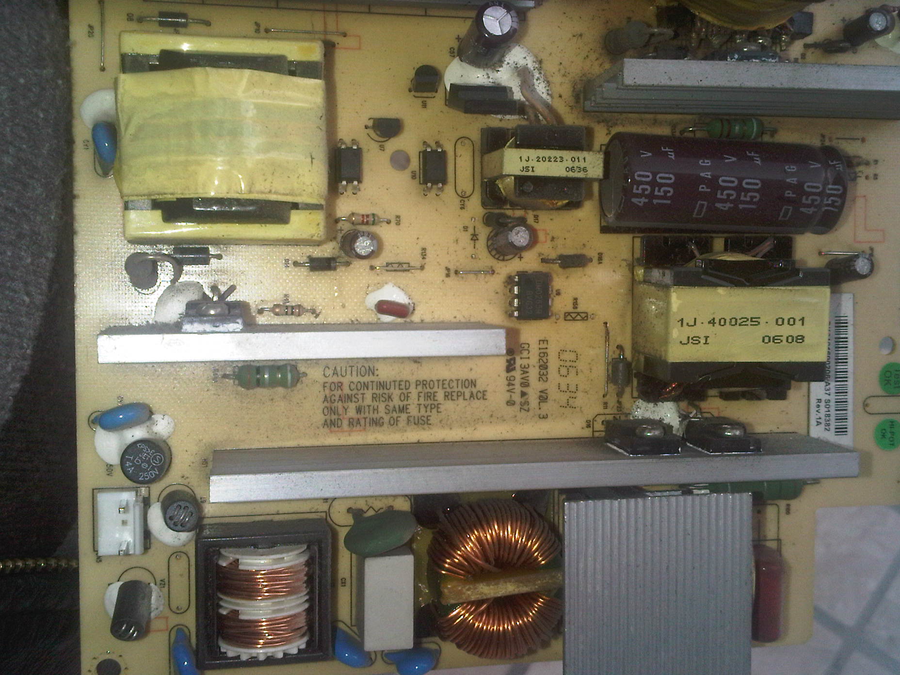

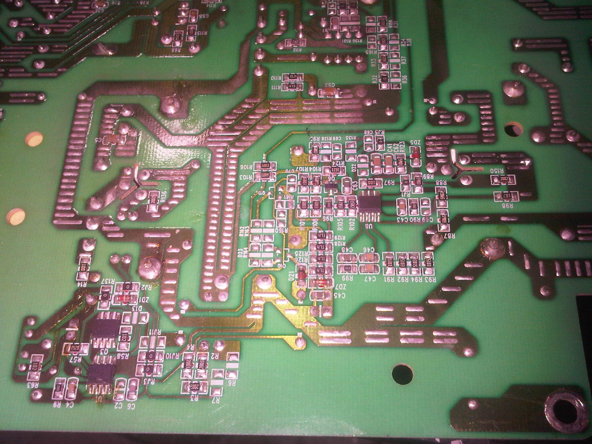

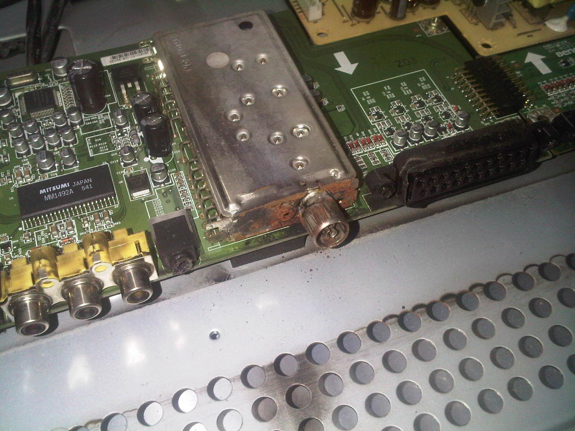

    this is my first effort to repair a lcd tv. i have managed to repair several pc displays, everything thank to you.
    this tv has the known "2sec to black" issue. i have read the FAQs and i know the basics but since im new to TVs i would need some advice, tips and tricks.
    this tv has been opened before because it had caught fire due to external factors. (a candle fired the antenna cable which burned the 75ohm connector). but the 2sec to black came months later.

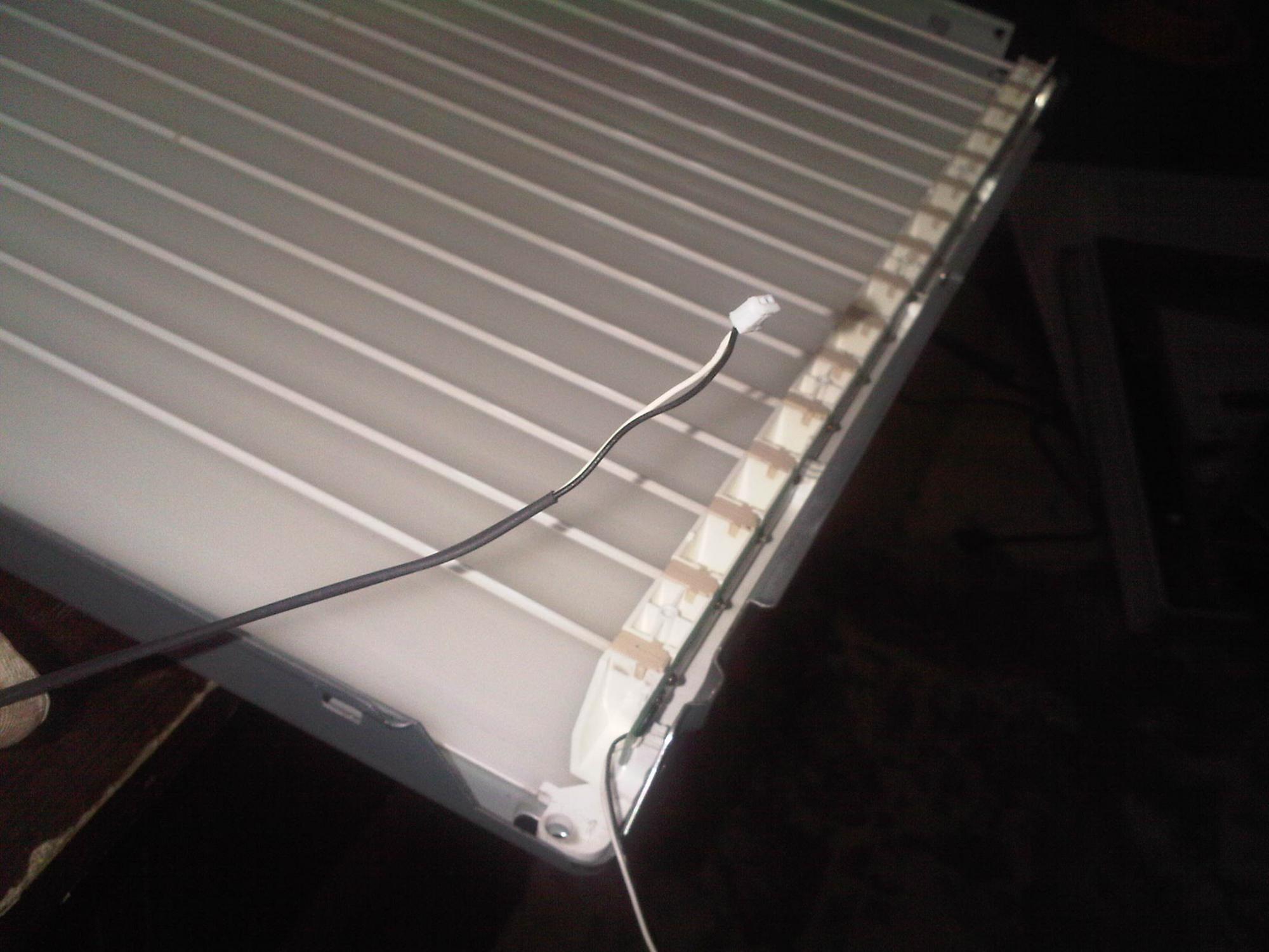

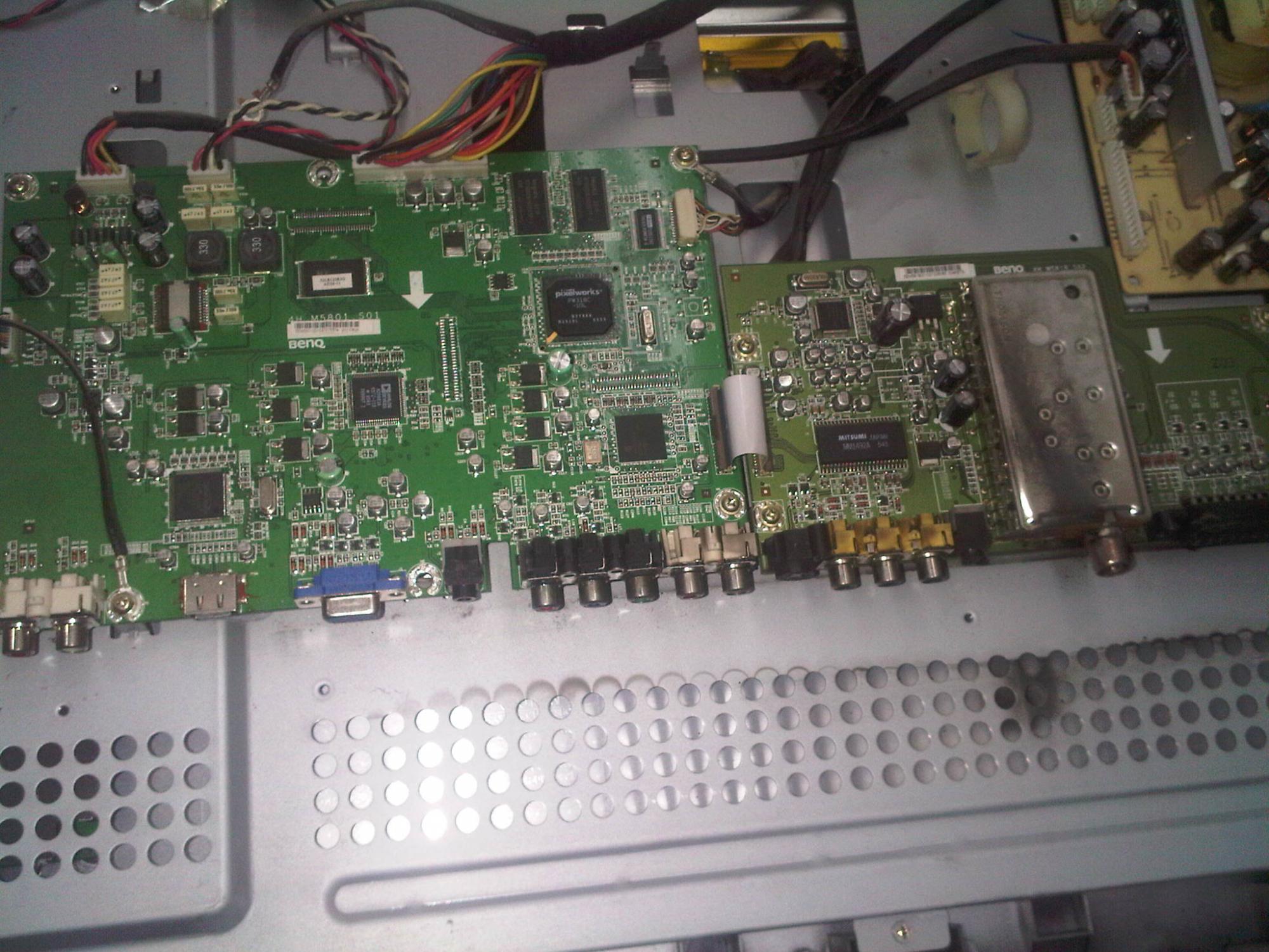

    you can see the pics and first thing, the CCFL and inverter test is a bit "difficult" to do, cos i think ill have to dismantle all the tv structure, process which i want to postpone as much as i can. (as i am not used dealing with huge panels)

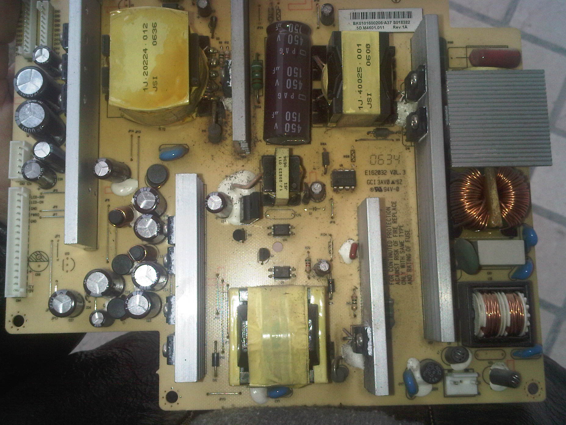

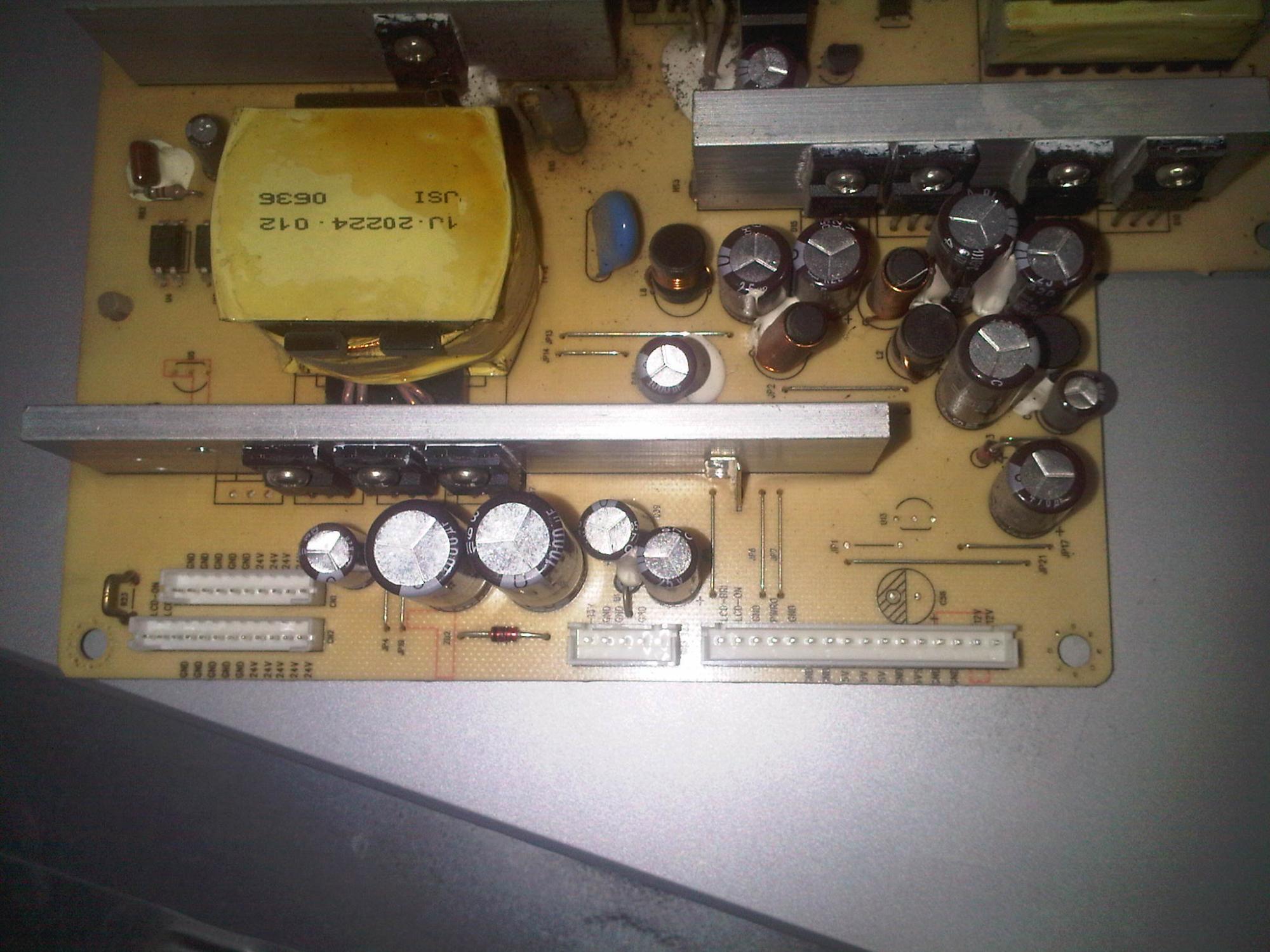

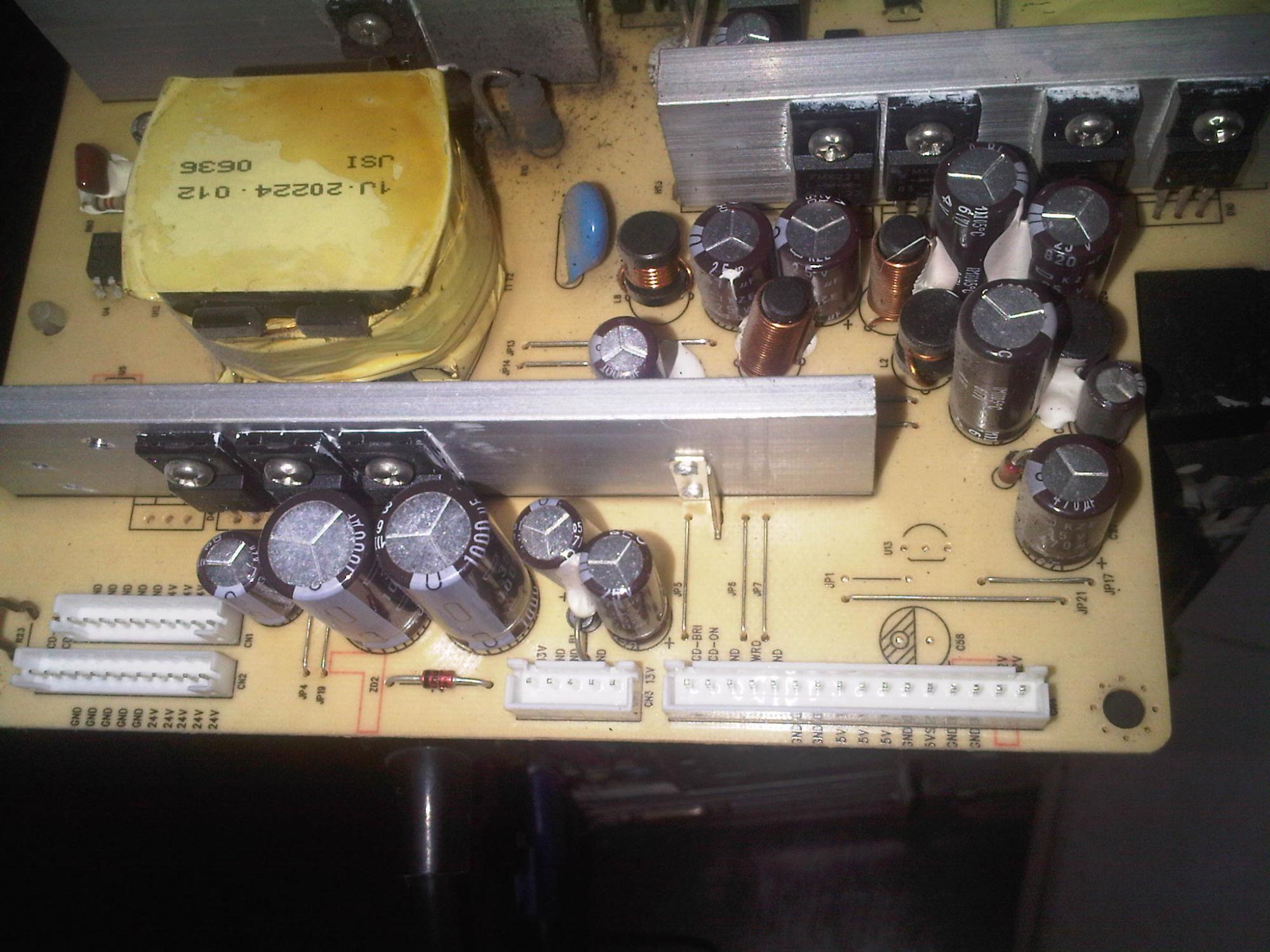

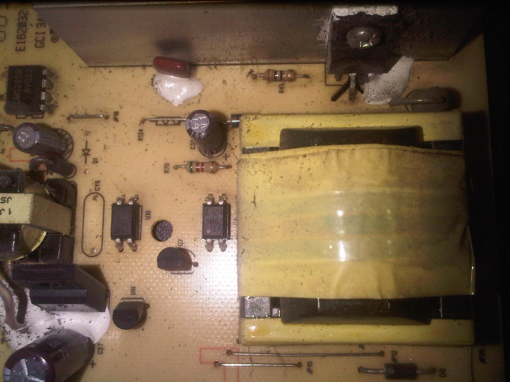

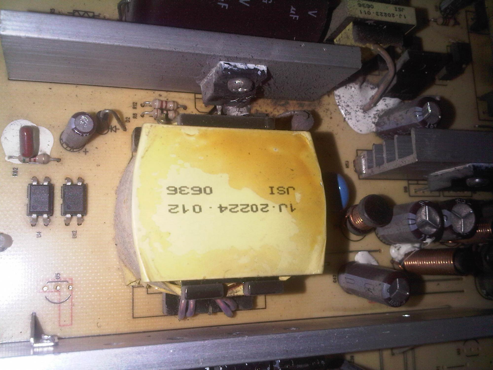

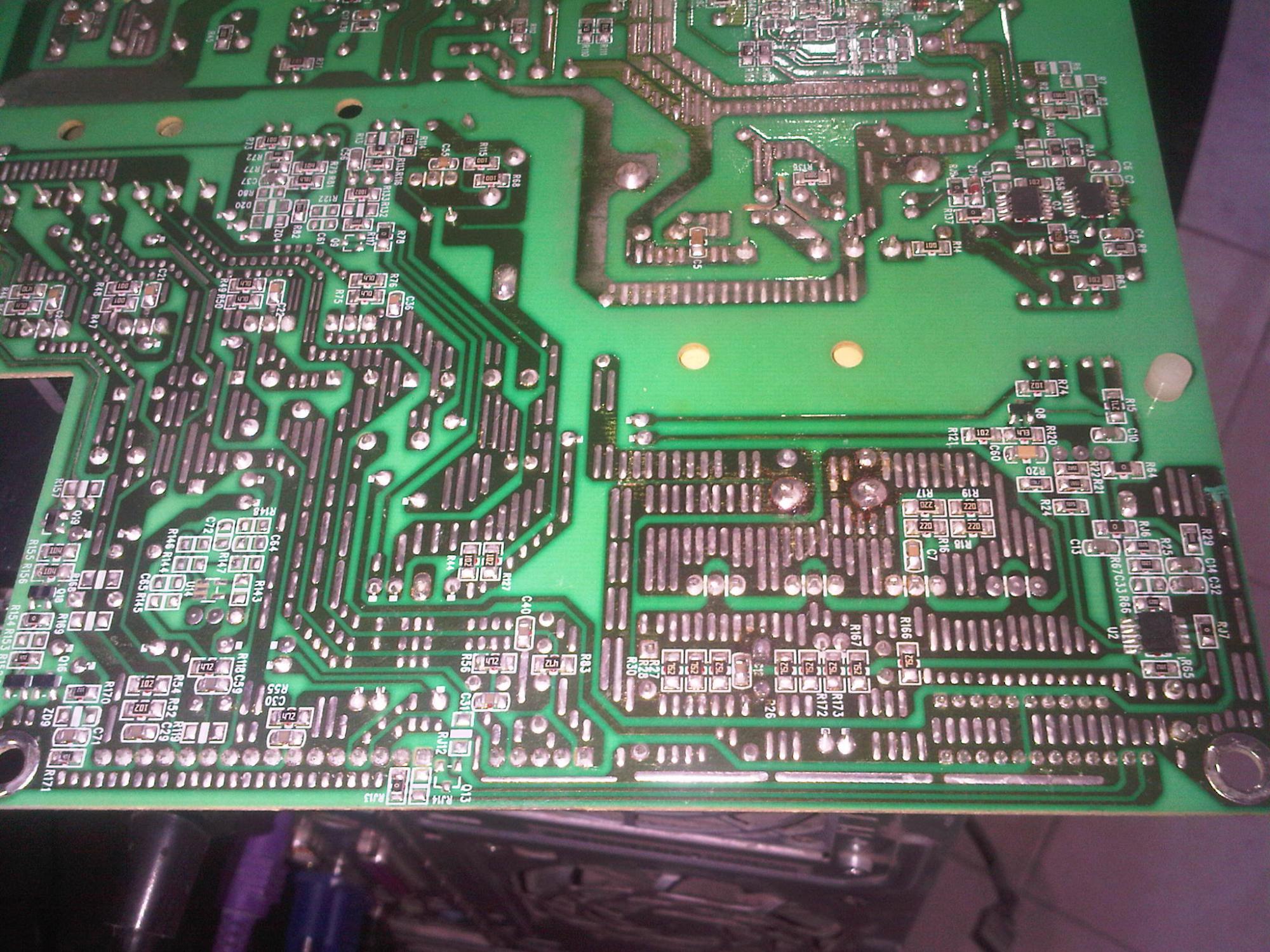

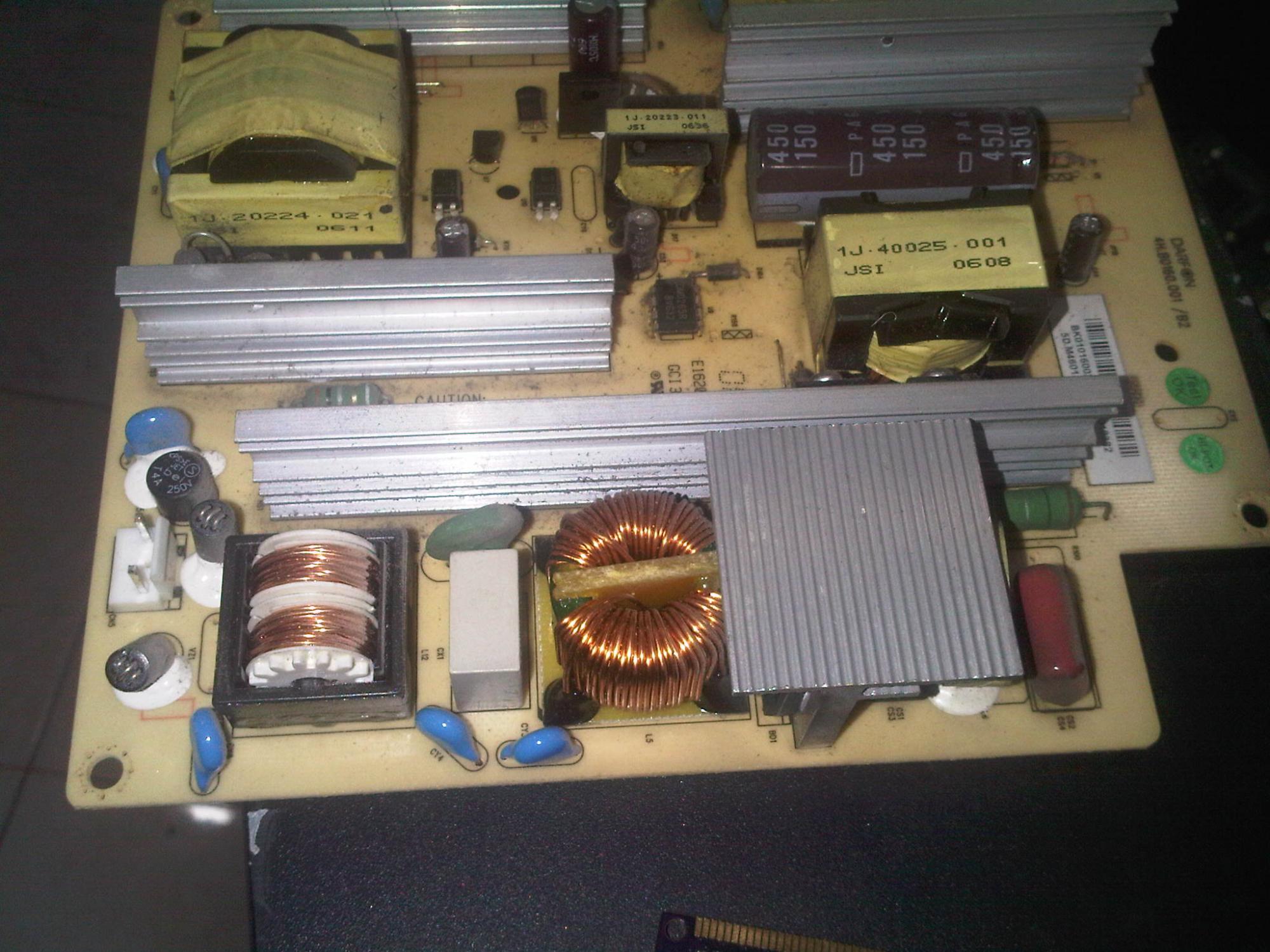

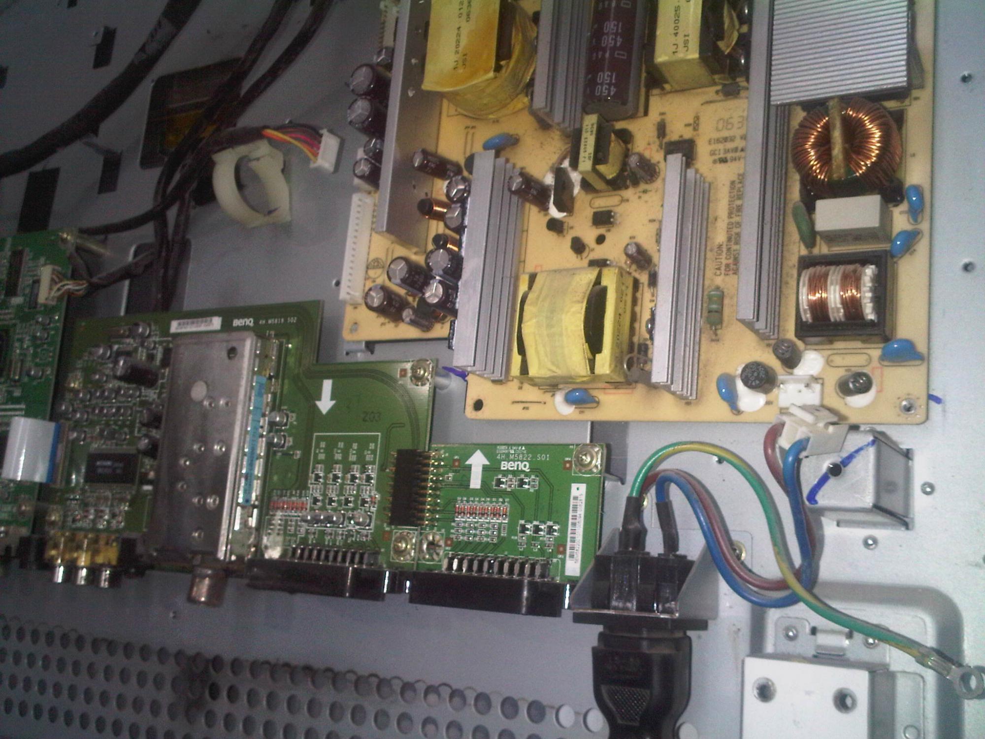

    first thing in my hand is the power board. steady 24V and 12V. when power button is pressed a 3,3V is shown at the pin "LCD ON". even when i unplug the inverter connector, 3,3V is there when i press the power button. should i go further and dismantle to go to the inverter board and CCFLs or it can be power board related?
    some pics of what can i actually capture.

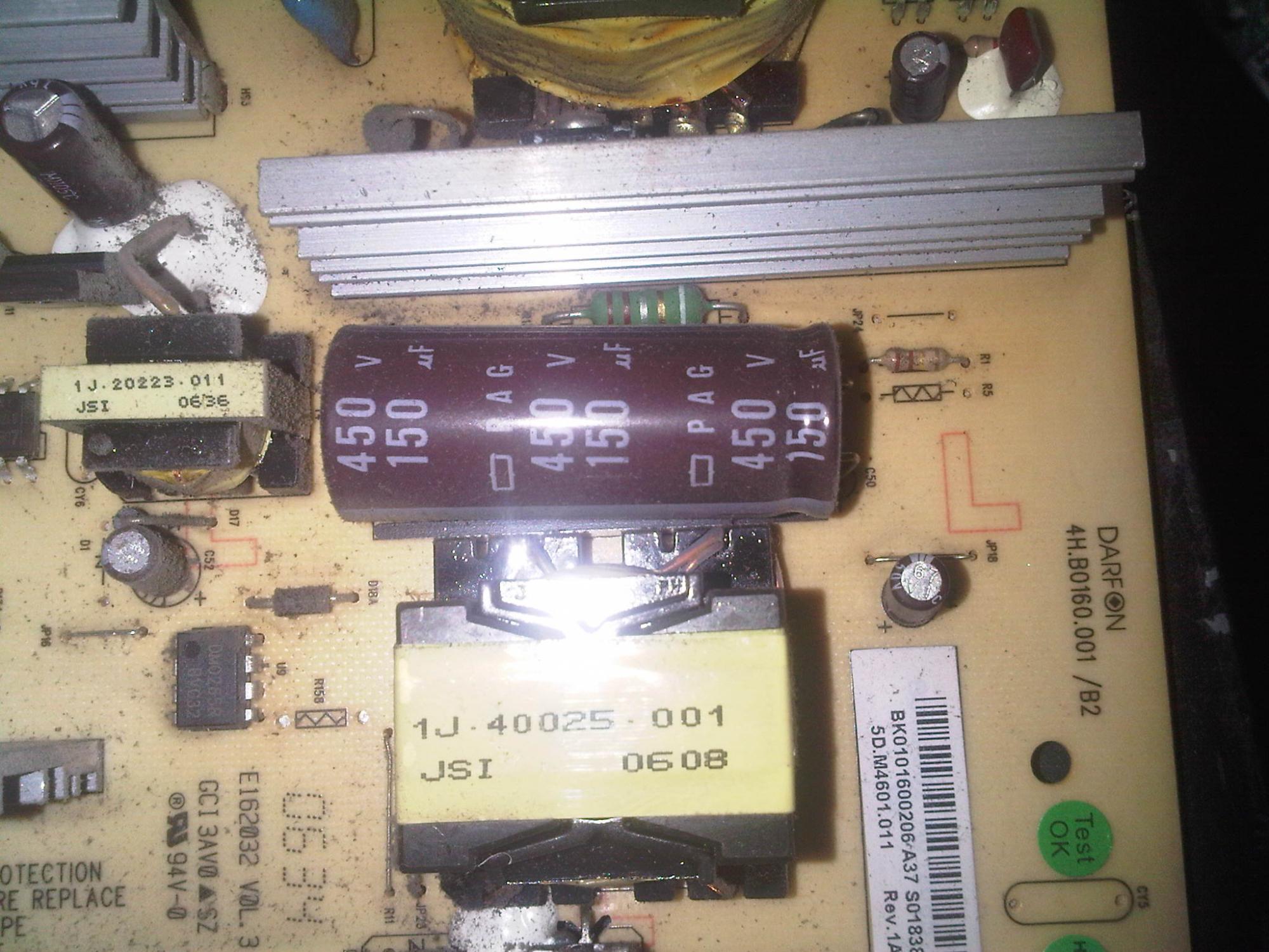

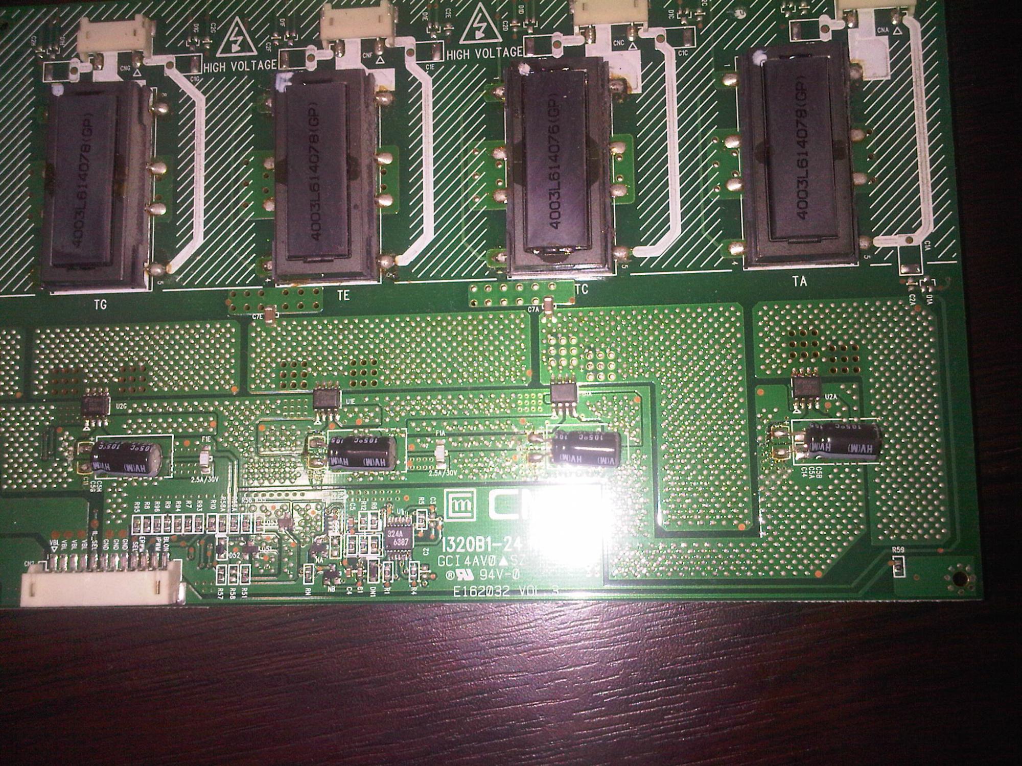

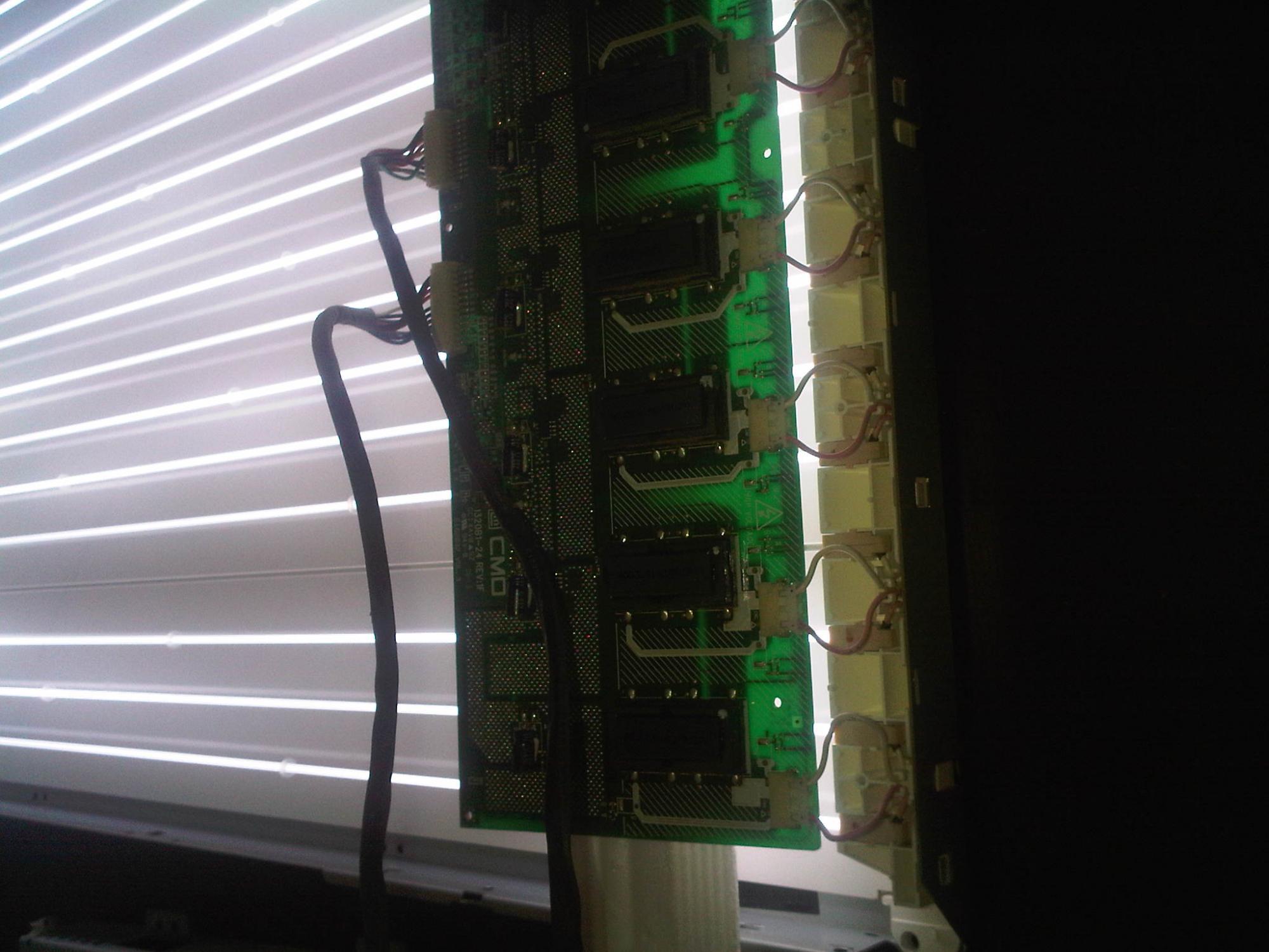

    You would need a picture of the inverter boards. There are usually one or two, on each side of the TV. The part # on some of the boards looks a lot like Darfon, and those inverters have very high failure rates (and are easy to repair.)

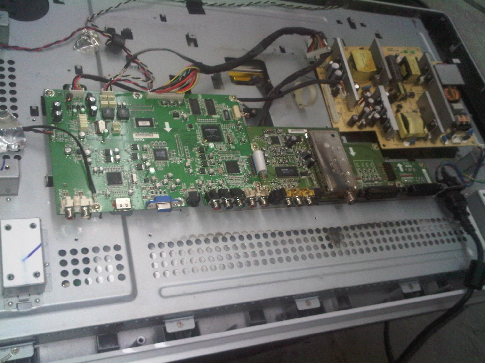

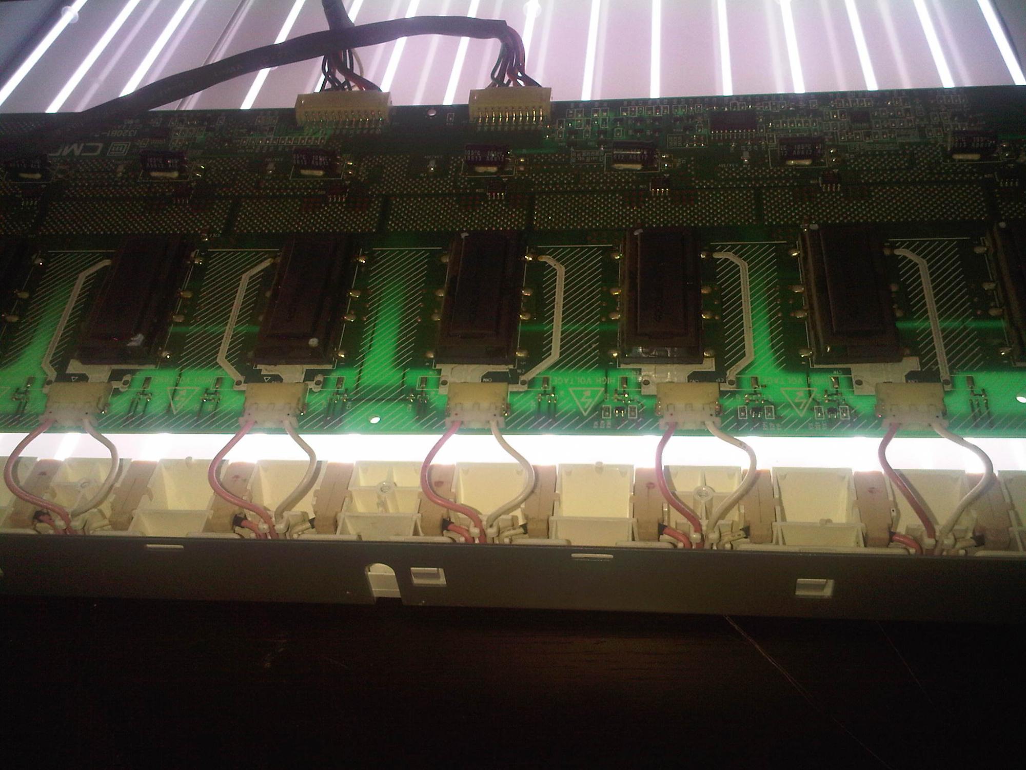

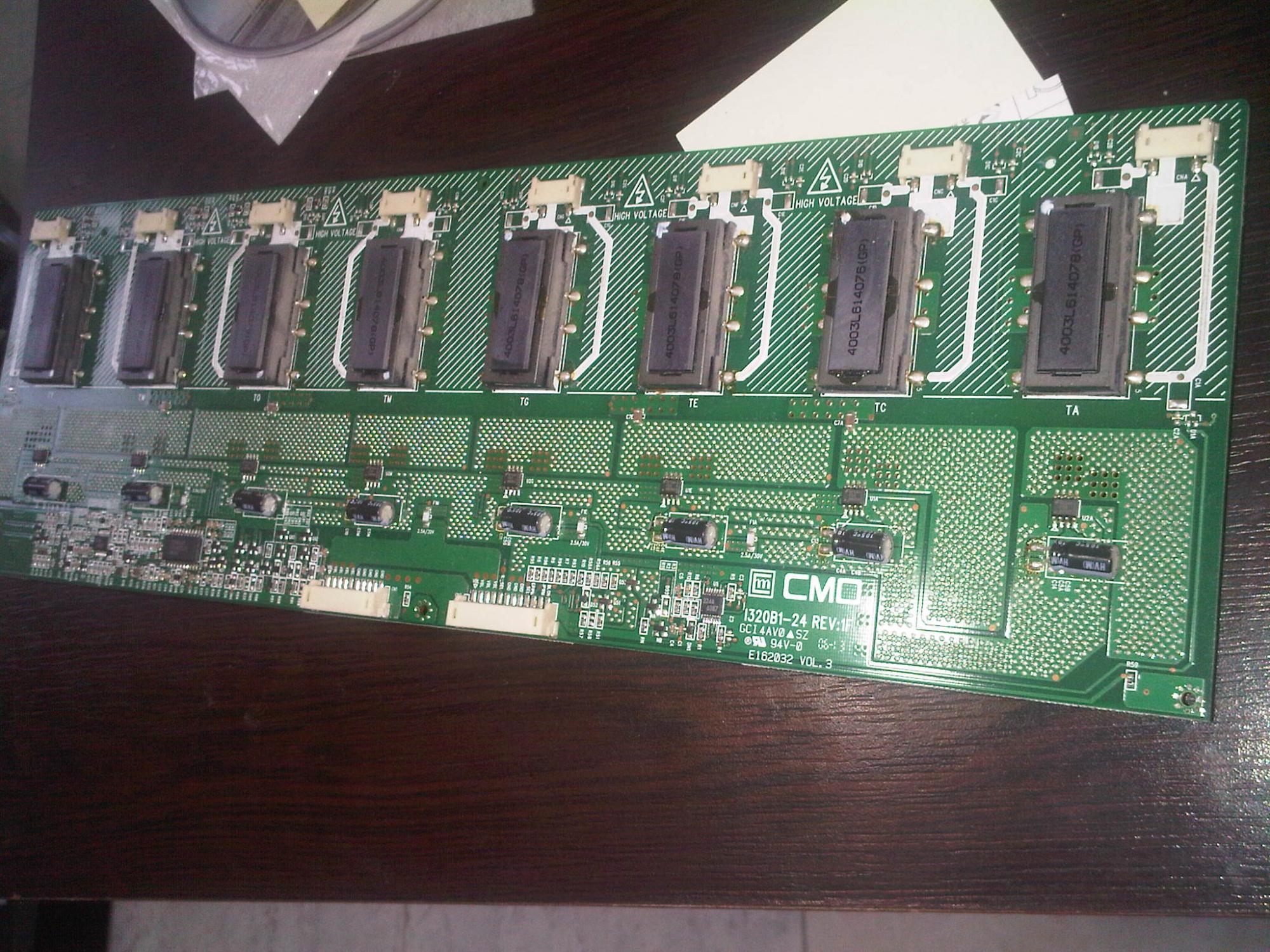

      god saved this tv for not breaking anything.... i cautinously (but blindly) took all pieces apart. now i have access to everything.

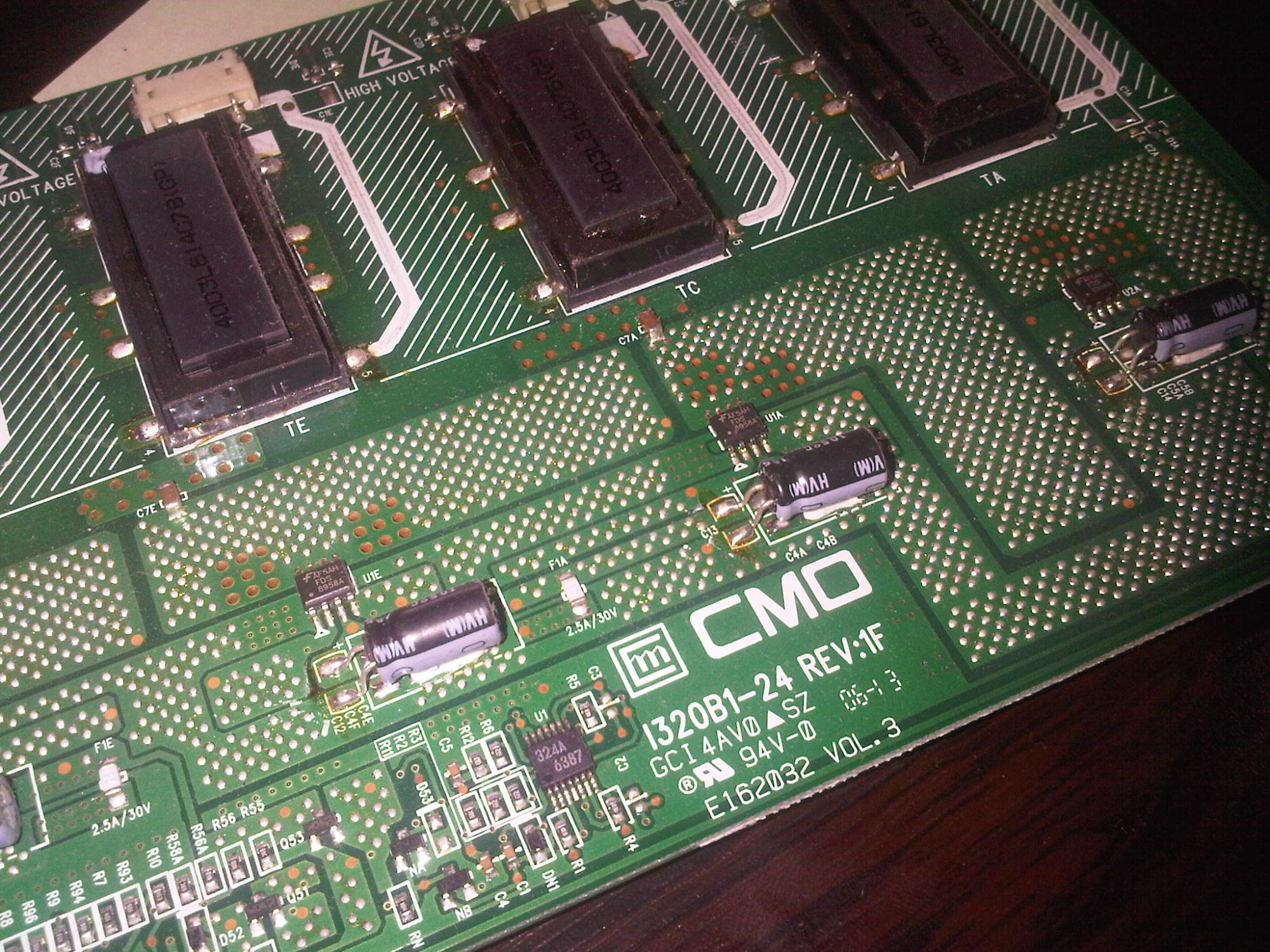

      this is the inverter board, all inverters show 2.15 kOhms except the seventh which shows 2.55 kOhms. after some minutes im gonna plug everything and see how many CCFLs do light.

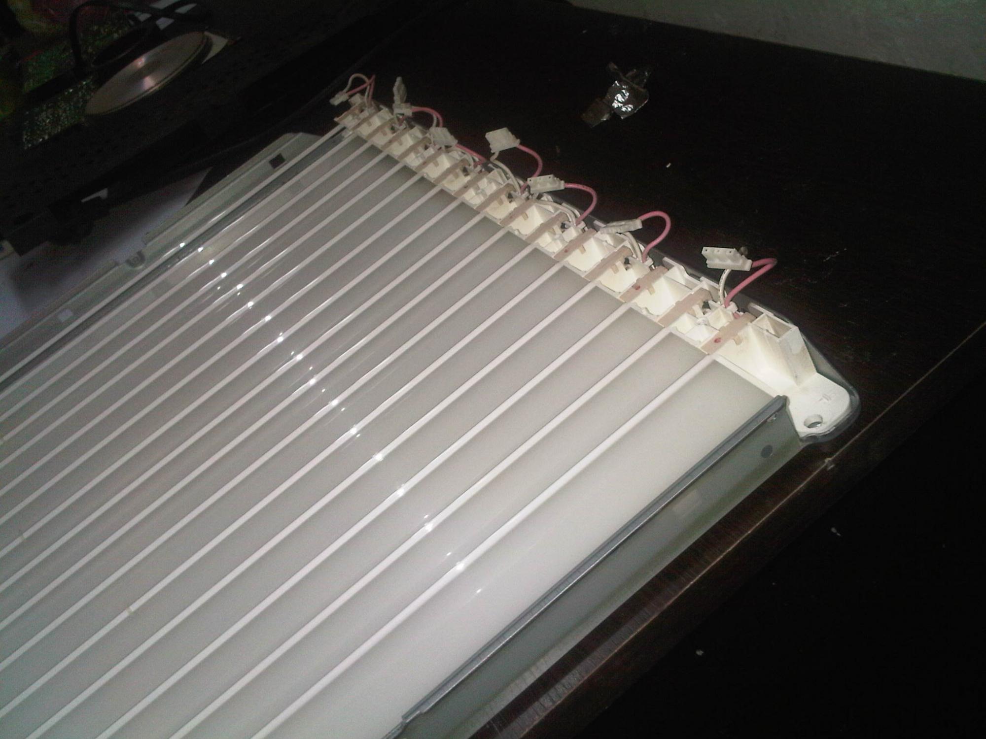

      another question, what is this 2pin connector which goes to the inverter board? some kind of sensor?
      anyway, im gonna let you know.
        Re: technosonic lcd3201s
        The Connector with the black and white wires are the lamp return wires.
        Please also look and see if the lamp assembly has any ballast caps in it also and see if they are bad. Example:
        http://s807.photobucket.com/albums/y...nt%20FLX-3210/

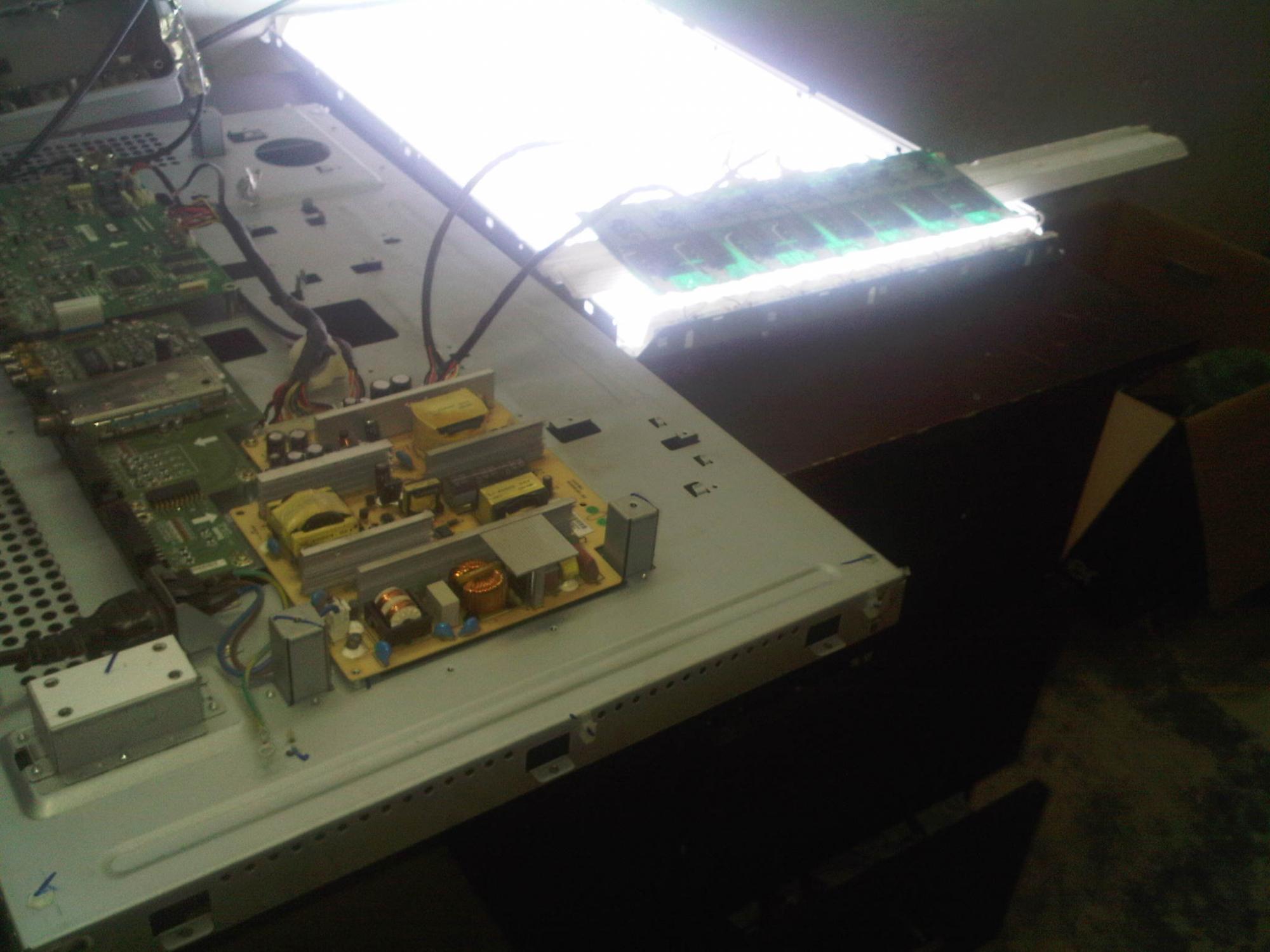

          at the moment no more 2sec to black, but as you can see one CCFL which is fed by the seventh inverter doesnt lit.
          next step?
            Swap the connectors for the seventh and eighth tubes around and see if the tube lights. If the tube lights and now the eighth tube doesn't then the inverter is at fault and most likely it's that transformer.
            The 2.55k definitely sounds like a faulty transformer but that test will confirm it.
            It looks like you've got a Chi-Mei inverter but it has Darfon parts on it - I recognise those transformers.
            Be -extremely- careful with the LCD as it is very easy to damage.
              thanx tom. i followed my logic and just did it.
              the tube lights when connected to other another inverter and the couple of CCFLs connected to the "faulty" seventh inverter, lights only one of two.
              solved: inverter no 7 faulty!
