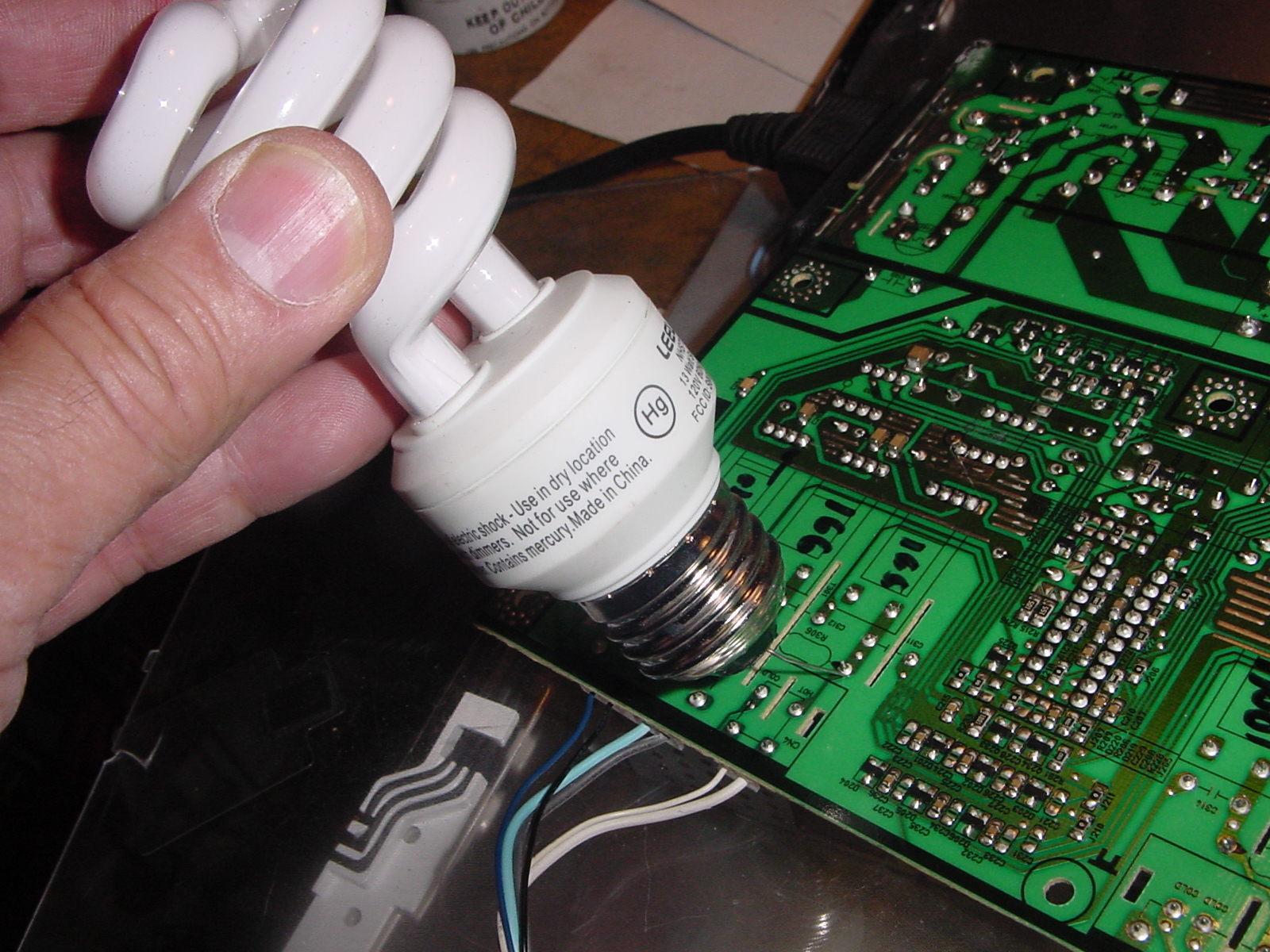

        OK, I would like to find out if all the high voltage Inverter transformers are putting out the high voltage, you will need a Fluorescent lamp, solder a small solid wire to the bottom of the base to use it as a high voltage probe.
        Remove one lamp connector at a time, with the TV off, hold the Fluorescent lamp in your hand then stick the probe to the socket just enough to touch the pin on the socket, then turn on the TV, you should see the Fluorescent should flash on to indicate that it is putting out high voltage. Turn the TV off and then do the next lamp sockets to see if all of them will flash on the Fluorescent.
            well i am certain that it does i already had this set apart and it will light all of its tubes for a good 1 1/2 seconds and very bright 1 1/2 second..... it has the u tube type come to find out....
