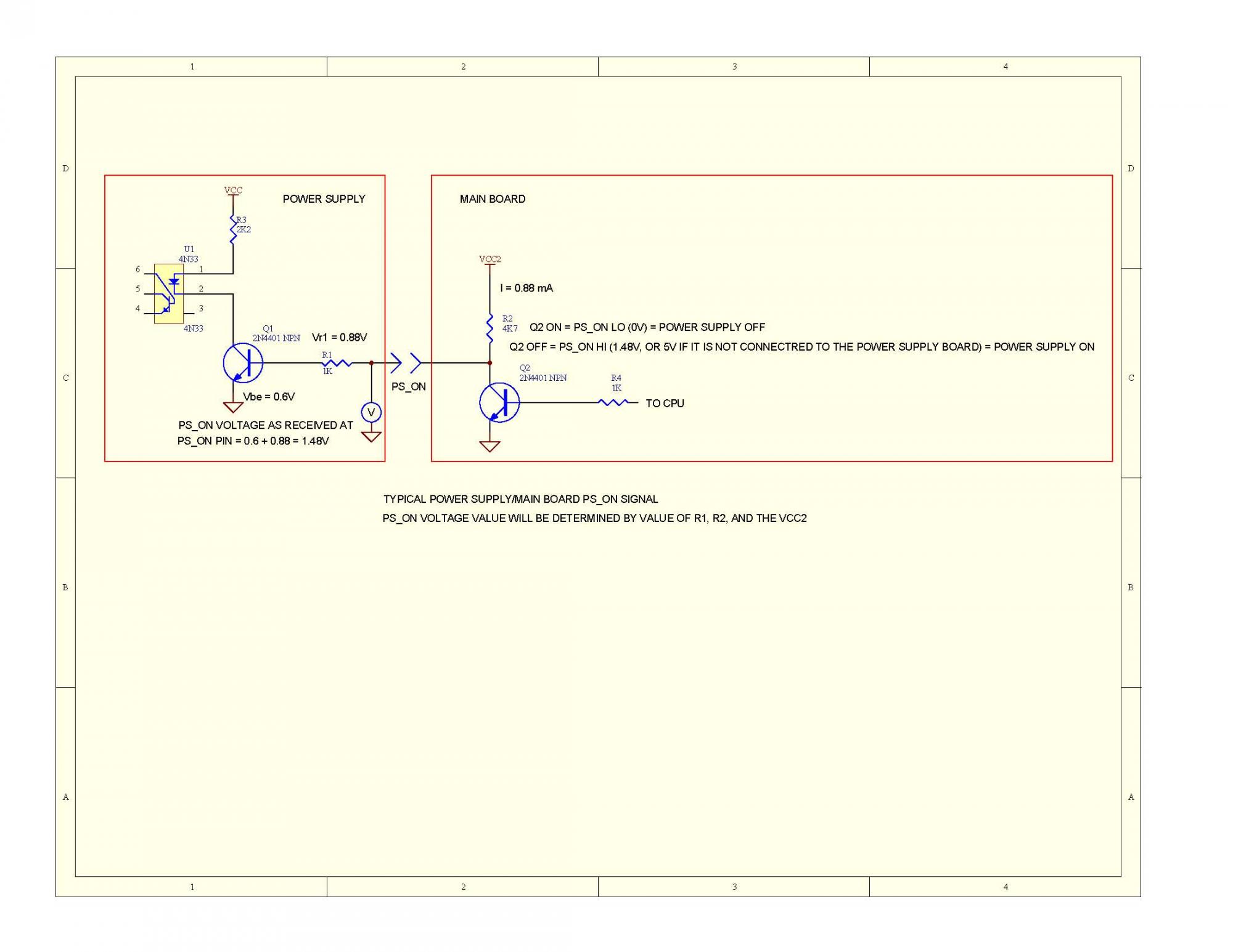

                                    #57
                                    Re: Sharp lc-42sb45u no response... at all.
                                    I have just picked up almost the same TV, it's just a T at the end of the model number.
                                    Green LED is on when the TV it's turned on, I have all the voltages, except the PS_ON it's 1.75V. How is that possible with this low voltage to have the 5V, 12V and 24V?
                                    My standby voltage is the same 4.4V.
                                    I will go through the suggestions above, but I don't understand how come I have all the voltages with this low voltage at PS_ON?

                                        #59
                                        @tibimakai: Please see the attached picture. The PS_ON signal only have to be high enough voltage to supply the Base current to turn on the transistor in the power supply PS_ON signal detector in the power supply board.
                                        As you can see, the PS_ON voltage level will not be 5V when the Power supply board is connected to the Mian board due to the resistor values.

                                          #60
                                          Thank you for helping me. I'm about to start again on this TV, so it comes in time your comment.
                                          I'm not expecting to get 5V, but at least 3.1-3.3V.
                                          So what are you saying that there is no power supply issue if I get 1.75V for PS_ON and I'm getting all the voltages? Power LED is Green. Anything else is dead. No back light turns on at all, no picture at all, I don't know about sound since I can change anything.
