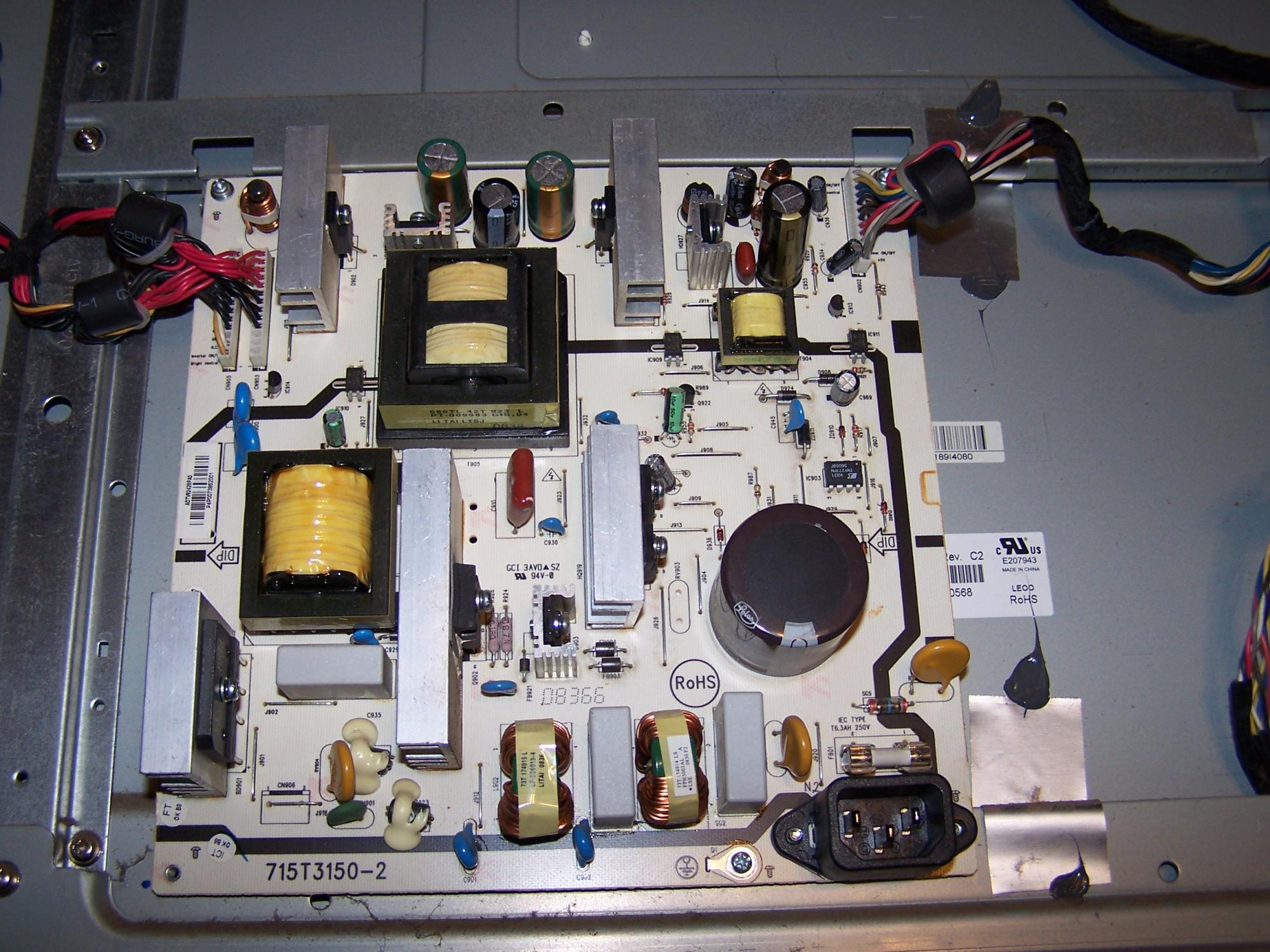

    Re: Sharp lc-42sb45u no response... at all.
    Here's the power board -

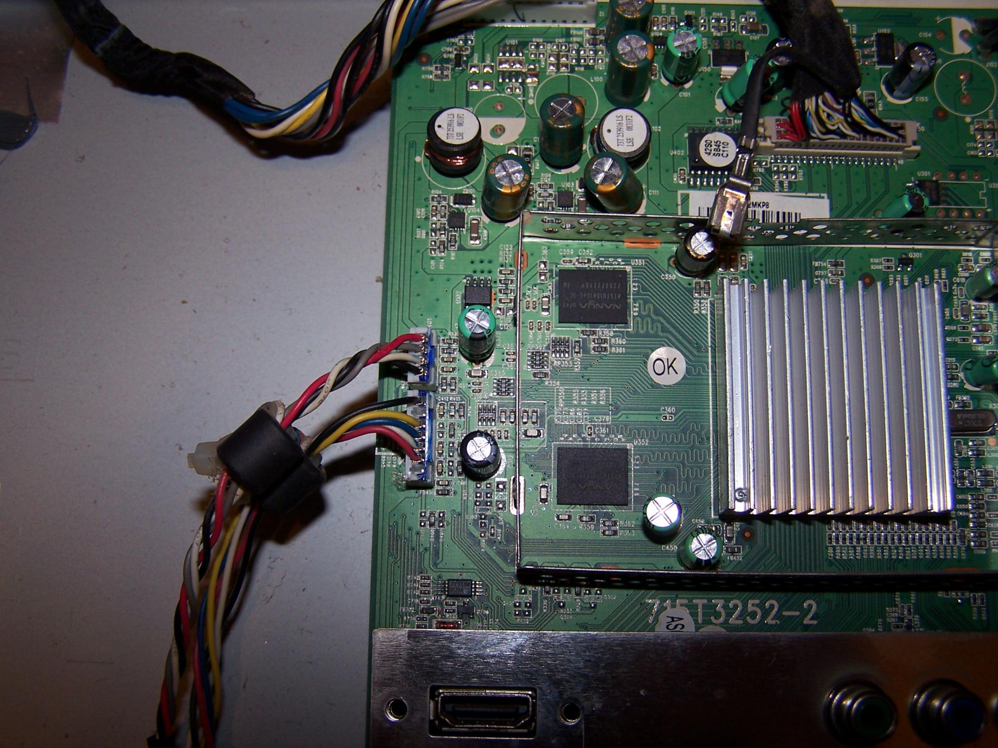

      I've got high-res shots if anyone thinks looking at them would help. I'm not the best at diagnosing circuits... I generally just replace caps and hope for the best.
            For now, here's cell phone pics on smugmug - http://nadams.smugmug.com/Other/Sharp-TV/
            I'll grab my digi now and get some better shots. I'll upload those here.

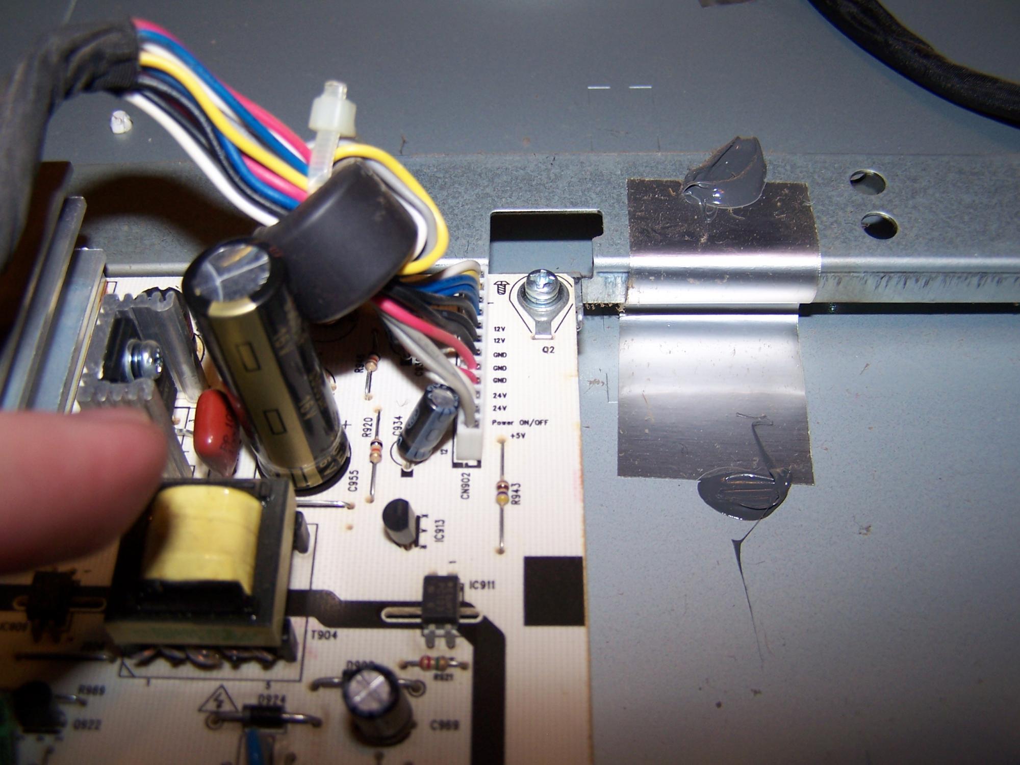

              Main power board -
              The output of the power board is labeled as such. Both Power On/Off and +5v measure 4.4v
              The 4-pin connector goes to the switch board-
                Sorry, Power on/off doesn't have any voltage on it. The two lower grey lines do. Is the switch supposed to pass voltage, or short to ground?

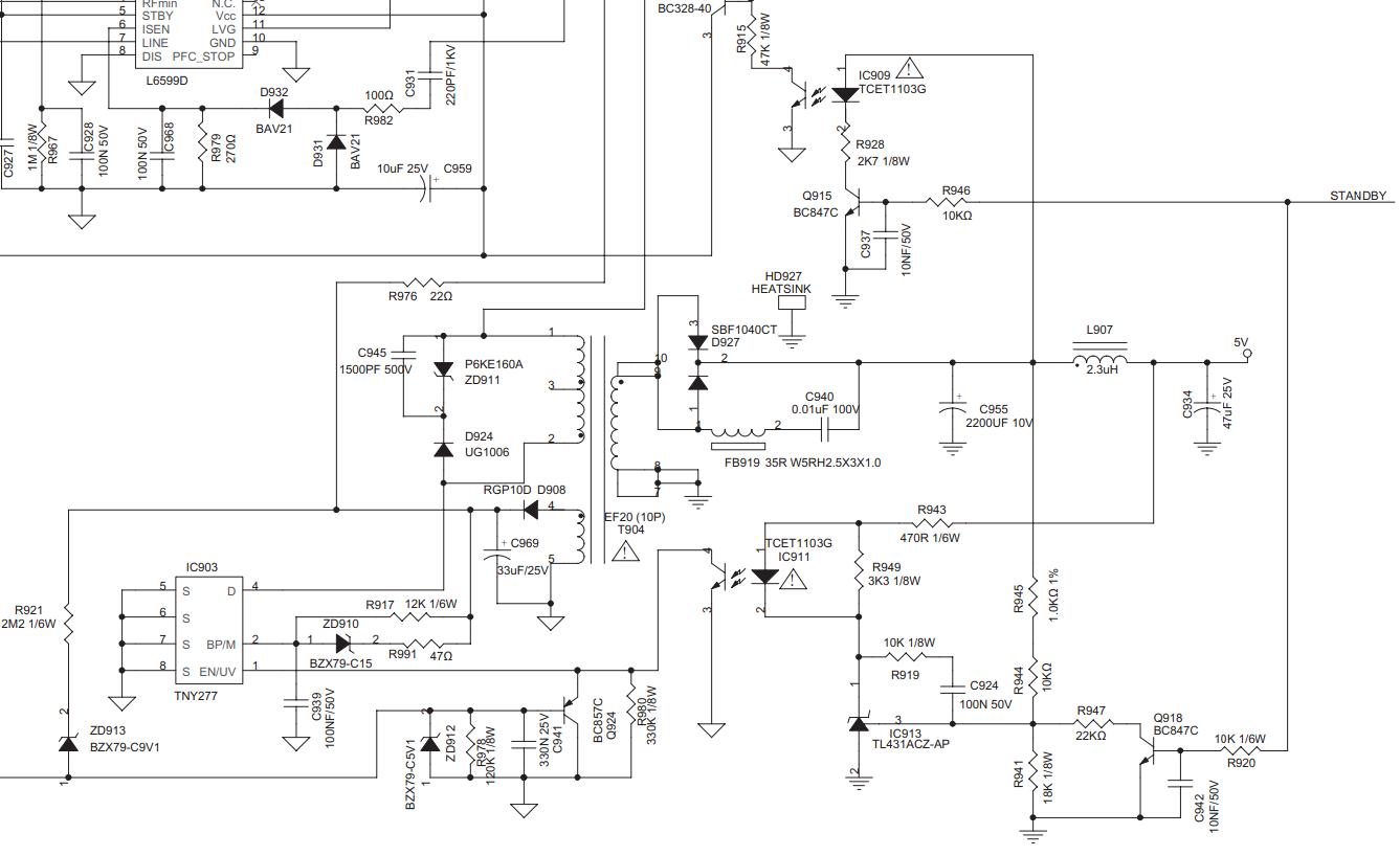

                  5) The service manual and power board schematic is on page 79. (22MB).
                  6) I snipped out the portion that relates to 5V. Refer to diagram.
                  7) With the main board disconnected, I would check D927 (middle pin or pin 2) and see what the DC voltage is. This should be 5V or more.
                  8) Check the DC voltage across C955 (the new Panasonic cap).
                  9) Check the DC voltage across C934 (47uF 25V) cap.
                  10) Remeasure 5V connector pin.
                  11) Report readings for 7, 8, 9, and 10.

                    Something strange here. R941, R944, R945 form a voltage divider that sets the output voltage of the supply. Q918 and R947 'tweek' that setting. With Q918 off the outpit voltage should be 2.50 * (1+ 11K/18K) With Q918 on the output voltage should be 2.50 * (1+ 11K/9.9K). You do the math.
                              One last thought before I retire for the night.
                              If Q918 (a NPN) isn't turning on, then there are two possibilites.
                              One, R920, a 10K ohm resistor is open. Voltage never gets to the base.
                              Two, Q918, is non functional. It could be shorted? Test all combinations for shorts. That is, base-collector, base-emitter, emitter-collector. Any reading less than 30 ohms suggests it might be shorted and should be desoldered and verified out of circuit.
                              tiredcaps

                                R920 measures at 9991ohms
                                Q918 has 2.47v at what I'm assuming is base (the single pin on one side)
                                IC911 has 4.16v at pin 1 and 3.14v at pin 2.
                                IC909 appears to be where the 4.44v is coming from... I get 4.44v on pin 1 and 3.78v on pin 2.
                                What setting should my DMM be on to test the resistance of Q918? Also, if I'm looking at Q918 with two pins at the top and one pin down, Which is base/collector/emitter?
                                Ludicrous gibs!

                                        1) Okay, let's assume Q918 is working fine. I neglected to see/spot C942 last night just before the base of Q918.
                                        2) For the standby line, I can't see a test point on the connector so I would suggest measuring on the right side of the R920 or R946 resistor (as per schematic). I suspect that will be 4.4V DC as well.
                                        3) I'm curious, what is the voltage reading on the collector (top) of Q918?
                                        4) What is the voltage reading on the emitter (bottom) of Q918? I suspect I know the answer, but would like confirmation because my schematic interpretation skills aren't the best.
