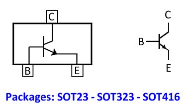

      1) Okay, let's assume Q918 is working fine. I neglected to see/spot C942 last night just before the base of Q918.
      2) For the standby line, I can't see a test point on the connector so I would suggest measuring on the right side of the R920 or R946 resistor (as per schematic). I suspect that will be 4.4V DC as well.
      3) I'm curious, what is the voltage reading on the collector (top) of Q918?
      4) What is the voltage reading on the emitter (bottom) of Q918? I suspect I know the answer, but would like confirmation because my schematic interpretation skills aren't the best.
      5) What is the resistance measurement of R944 (10k) and R945 (1k)?
      6) What is the resistance measurement of R947 (22k) and R941 (18k)?
      2) I have no voltage on either side of R920 or R946
      3) and 4) Only one pin on Q918 has any voltage, and that's the pin that connects to R947 in the diagram, with 2.46v. I'm having some difficulty understanding that part of the diagram, since it shows that pin being top left, but it's actually the single pin on the one side.
      5) and 6) When I probe these out, the numbers immediately start to climb. Is that normal?
      I'm really horrible at this type of troubleshooting because I can't understand circuit diagrams and apply them to real life to save my own life... With my current level of frustration, an eBay power supply is looking more and more likely

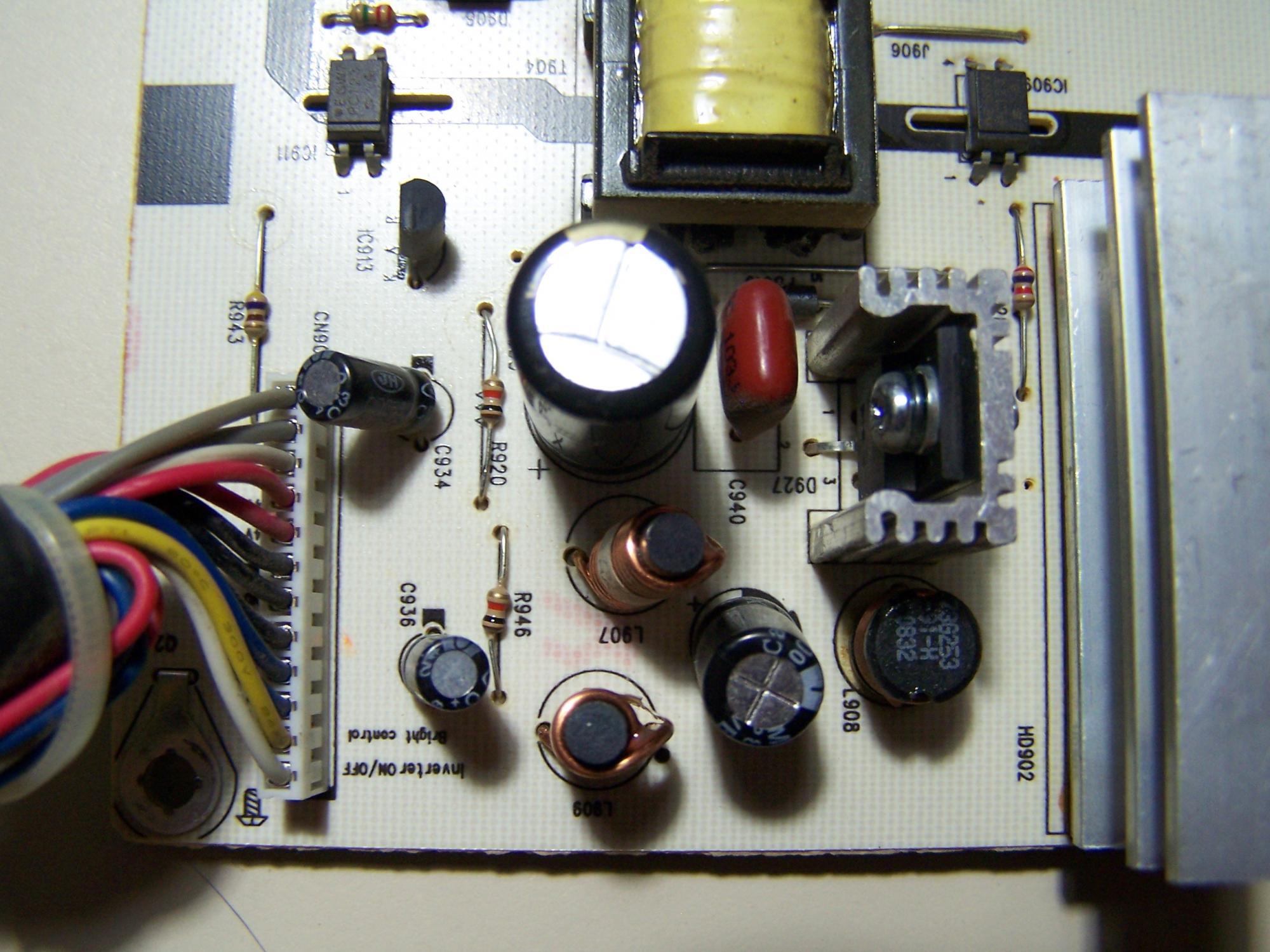

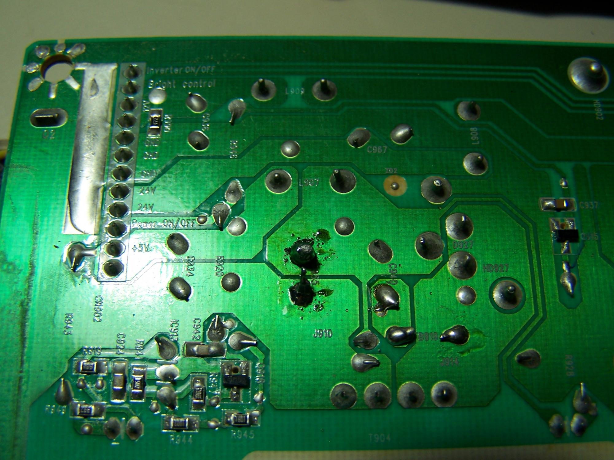

        2) Can we get a close photo of the area in question (both sides of the board)? The closeup will help and then I can markup the pins to test.

          Here's some closer pics. Lemme know if they're crap.

            I use the 'arm waving' approach to analyzing this circuit. All components EXCEPT Q918, R920 and R947 are straight out of the TL431 application note. The simple explanation is until the voltage at pin 3 of IC913 gets up to 2.5 volts no current flows through the emitter of IC911, so the SMPS controller is driving to output full power. As soon as IC913, pin 3 reaches 2.5 volts current flows, and the SMPS controller throttles back. It's the electronic equivalent used in the first steam engine Edison used when he the Pearl Street generating plant.
            Q918 and associated resistors is an unusual addition. When STANDBY is low Q918 is turned off, so R947 has no effect. When STANDBY is high, R947 results in a boosted output voltage.
