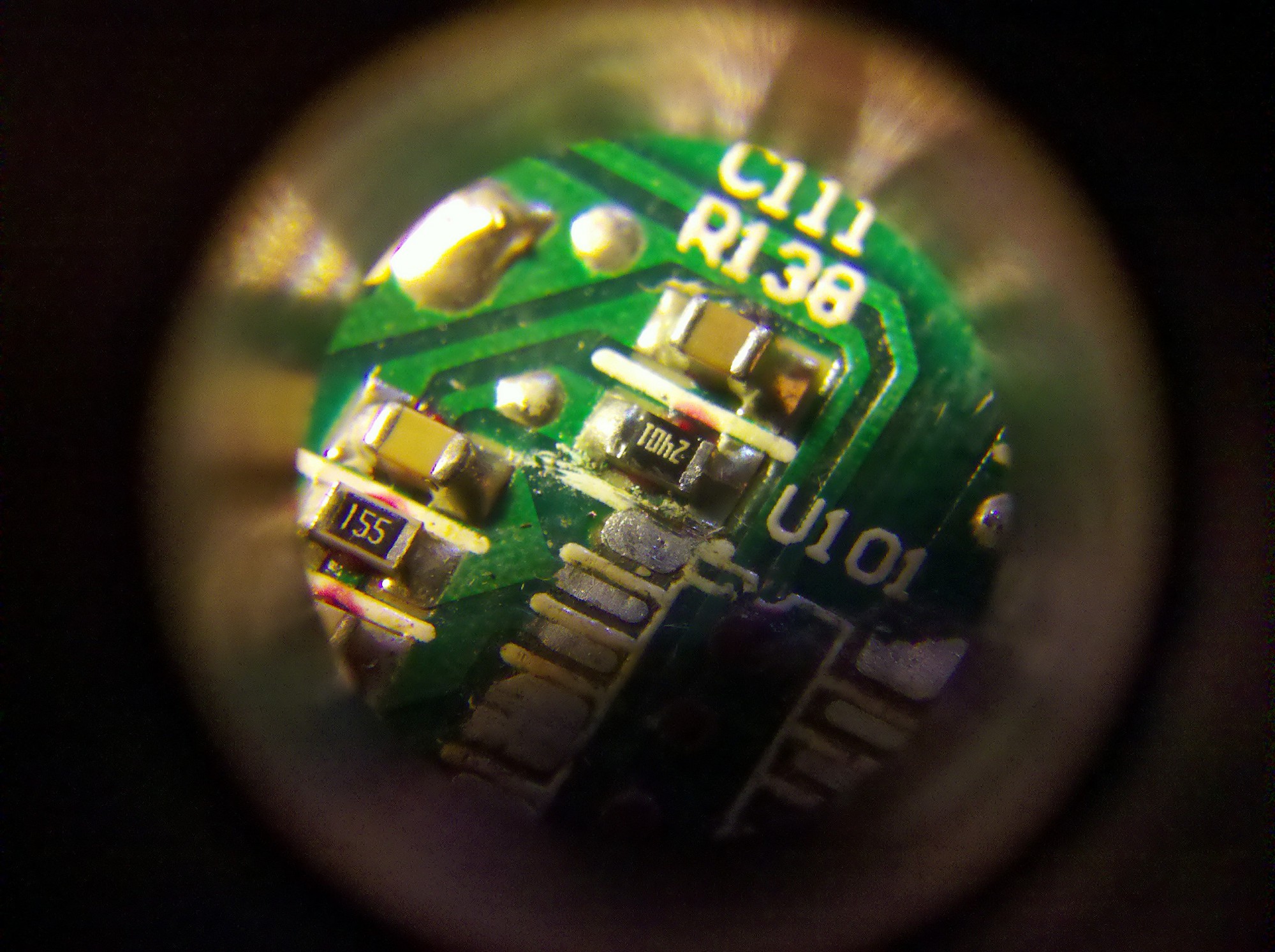

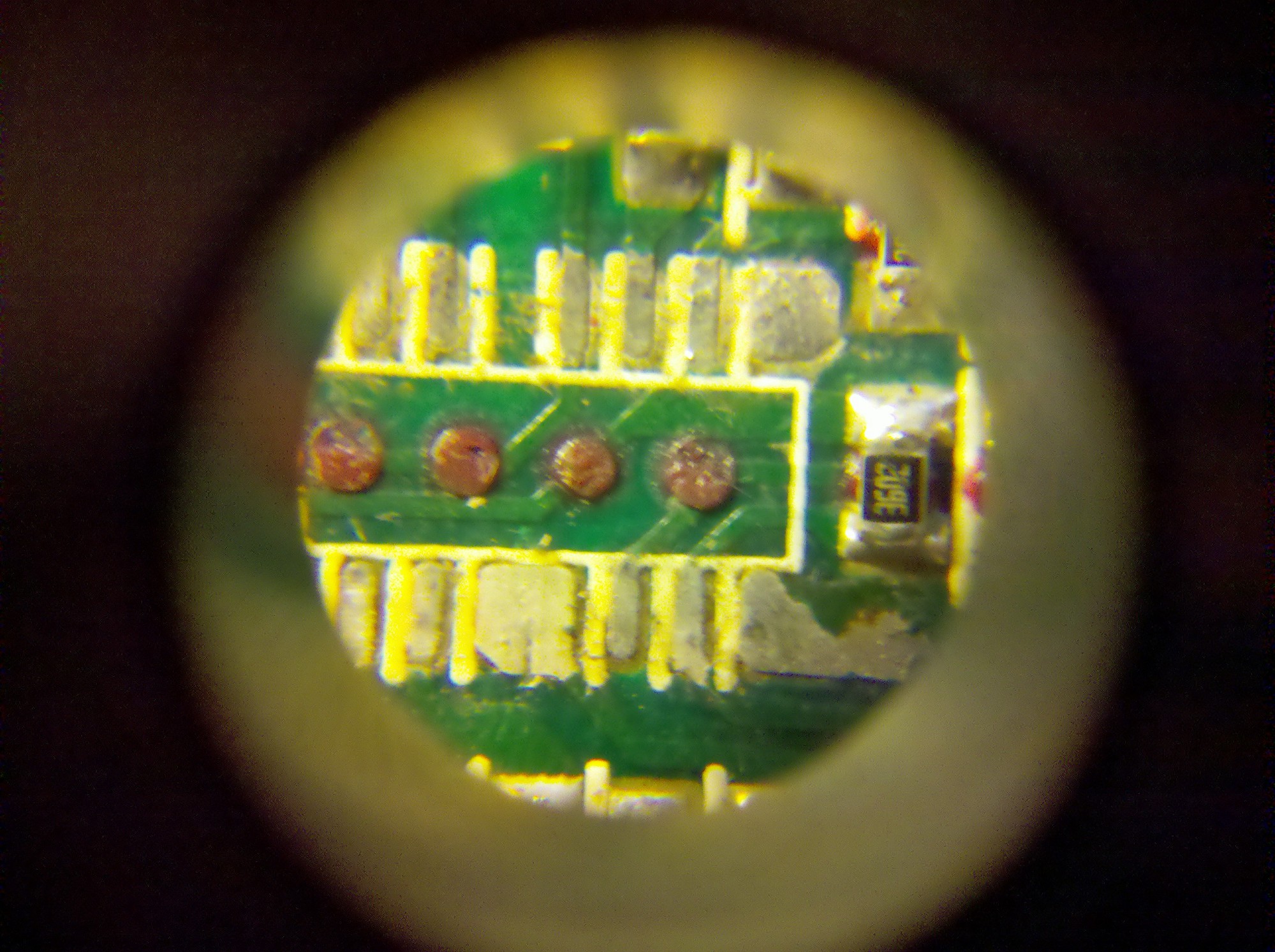

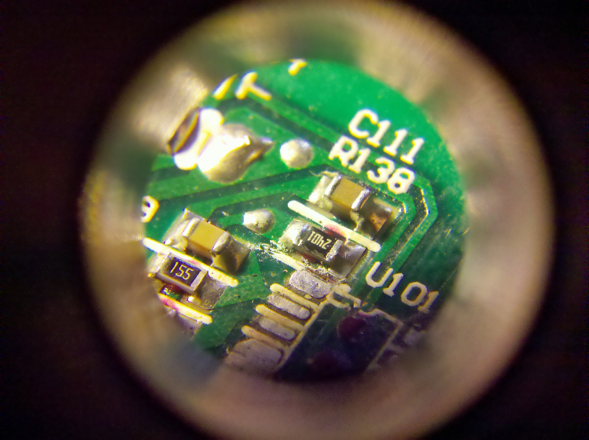

      OK I have a problem,
      I have two spots that have become bridged on the board. Pin1 to the Small SmD Cap? next to it. And Pins 4 and 5 Together.
      Now For Pin 1 as I don't see any traces around it I believe that a trace ran to the cap under the white material? Also on the Data sheet this pin is tied to "Gnd via a Cap" or something like that. So does my assertion seem right?
      https://cdn.badcaps-static.com/pdfs/...d758189067.pdf
      And for Pin 4, I see no traces leaving from it on any side so I am asumming that it is tied to pin 5 under the White separator that is no longer there. Also on the data sheet is says "Tie the pin to pin 4 if burst-mode is not used." which would seem to indicate that they can be tied together.
      Does all this seems right? Sorry I tried to get the best pictures possible, but it is rather difficult because my camera does not do macro well.
      Thanks!
        #143
        Re: Toshibia 40rv525u Green Blinking light and questions about Caps!!
        Bridges are normal when removing and replacing... Do you have solder wick? This can be used to remove bridges.

          #144
          That just it I tried to remove the bridges with the wick, and the solder gets very thin but does not disappear. The bridges actually happened when I was cleaning the board with the desoldering wick.
          I think that those pins that I mentioned above are connected under the white pin isolator that was there and got scraped off when I was using the desoldering wick.
          ^^^ Does my logic in the post above check with the data sheet or not? It seems like the solder bridge is on copper that's why I can't remove it.
            #145
            The green colour of the boards is known as soldermask or solder resist. The soldermask is what stops the pads from shorting to each other and it is what allows the PCB to have those individually metal plated areas.
            It's generally difficult to remove the solder mask by accident as it's a strong layer. Very high temperatures and sharp objects can break it. Try adding a little solder to the pads. Seems counter-intuitive but it can help remove the existing solder.
            If you still can't remove it, get an good sharp knife and cut the pad and track. It's okay to do this as long as you are careful.

              #146
              Hmm, I already tried more solder. It won't come off.
              I had someone else look at it and it seems like both of these pads/components are supposed to be connected. I don't really know how to read datasheets, But would it make sense for pin 4 and 5 to be connected according to the datasheet? Also doesn't pin 1 have to be connected for this chip to function?
                #147
                You may be right about the intentional connection:
                Originally posted by L6599 datasheet referring to pin 5
                Tie the pin to RFmin (pin 4) if burst-mode is not used.
                Burst mode is an energy saving mode which might be used if the TV used the same chip for both standby and main power, but it doesn't. So it would make sense that they would disable the feature.
                It doesn't look like there are any other traces going away from it, so most likely the connection is intentional.

                  #148
                  Ok and pin one needs to be used for it to function correct? Because I don't see any traces leading away from pin 1 other than possibly to the smd cap.
                    #149
                    Yes. It handles the soft start of the power supply.
