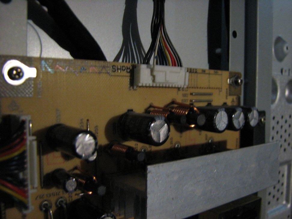

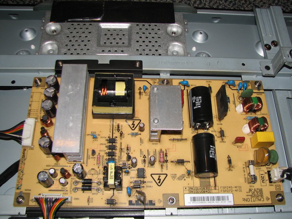

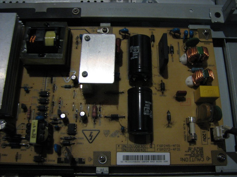

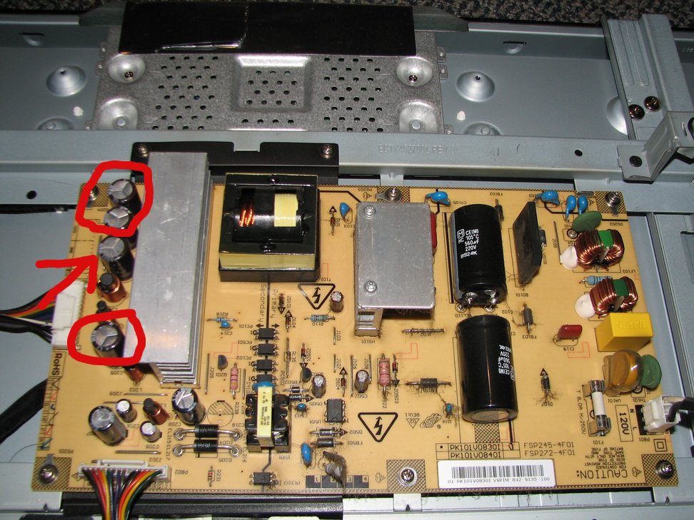

    Hello, I Need a little help with a problem i am having with a Toshiba 40rv525u Lcd Tv. When I hit the power button the Green light on the front flashes, I did not see any order with the flashes, just pretty much on 2 seconds, off 2 seconds. so I pulled it all apart and took a look around. I did really notice any thing strange except the possibly of a couple caps being slightly raised on the main power board. I was going to replace those and I just wanted a second opinion if I should Replace any others.
    I also, had a couple Capacitors Questions,
    Someone said I had to Use low ESR Caps for this, Is this True? Someone Else, said that they just need to be High Tempature. Who's Right?
    What is the Difference Between Low ESR and Regular Caps? And how do I tell them apart? When would you need to use one over the other?
    And, Finally since the shipping cost a bit for getting these here I would like to know some of the common sizes that I should buy to keep on hand to Fix things with? I relize that this varies greatly but just what you guys have experienced.
    P.S. Sorry for the Fair Pictures my good digital broke so I was using a backup, let me know and I'll get some better one's if you need them.

            The application dictates what you use? In general, a SMPS requires low ESR caps. Some applications use general purpose because low ESR caps are not required.
            The cap's temperature rating has nothing do with how the circuit works.

            Also, I am assuming that I don't need to change the two big caps on the Primary Side? What about the Film one's?
            The big caps rarely, but not never, fail. The film caps rarely fail.
            I see a couple of caps are Rubycon's, not sure about the rest is there somewhere you know of that has the logo's of the different Cap Company's?
            You can post pictures and we can try to id them.

                      OK only two of the 1000uf 35v and the one 1000uf 25v seems like they might be slightly raised.

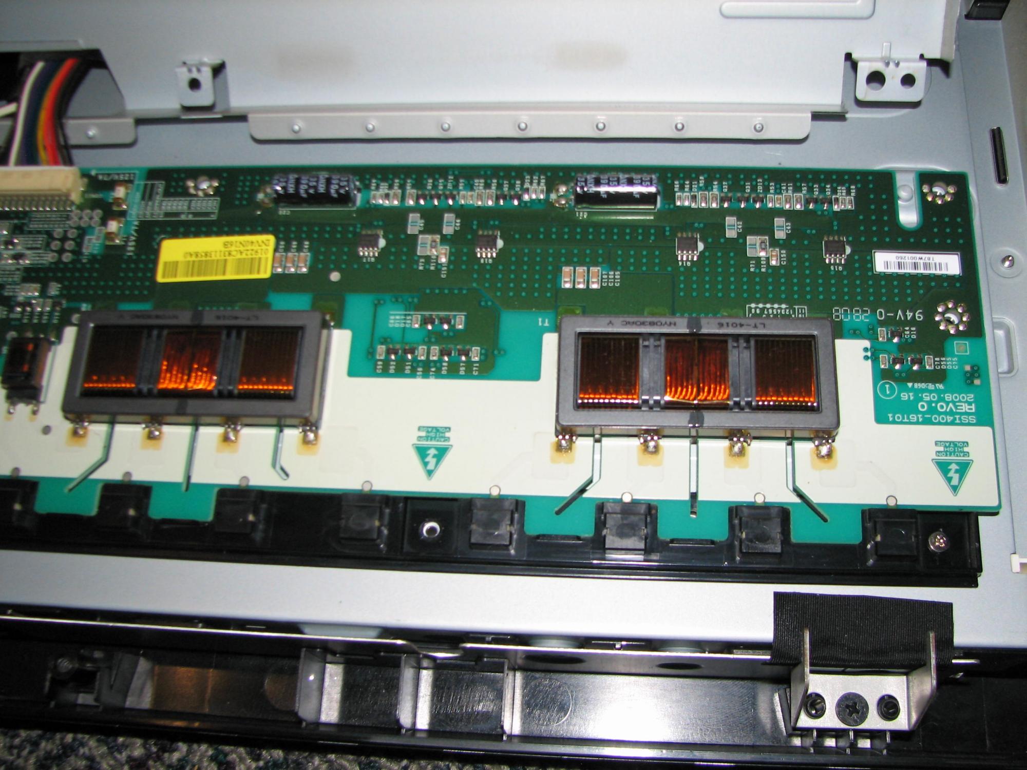

                      Ok next the legend p803 goes out to the Inverter board. Pin out starting with one is as follows.
                      1,2,3,4,5 +24v
                      6,7,8,9,10 GND
                        Mark up your power picture and circle which ones you think are bloated. Use this pic.
                        https://www.badcaps.net/forum/attach...7&d=1325986760
                            Okay, now use your multimeter to measure each pin on p802 and p803 (don't need p801) and report the results. If you have a manual range multimeter, you may need to switch to a higher DC V setting to measure 24 VDC.
                            OK getting the Pic Circled

                                Re: Toshibia 40rv525u Green Blinking light and questions about Caps!!
                                Ok the one with the Arrow looks fine, and I was using that as a reference for the others.
                                • retiredcaps
                                  • Apr 2010
                                  • 9271
                                  They look fine to me.
                                    1,2,3,4,5 +24v --- nothing maybe a pulse?
                                    6,7,8,9,10 GND --- 0.00
                                    11 N. C nothing
                                    12 INV a pulse not measurable
                                    13 D1 M a pulse not measurable
                                    14 N. C nothing
                                    Also bear in mind that pins 11 an 14 on p803 are not connected to the inverted board. And pin 10 is not connected to the video board on p802
                                      Well they fell slightly rasied when you run your finger across them.
                                      • ComputerGeek
                                        • Oct 2011
                                        • 262
                                        Do you want me to disconnect the Inverter so there is not a load and ReTest?
