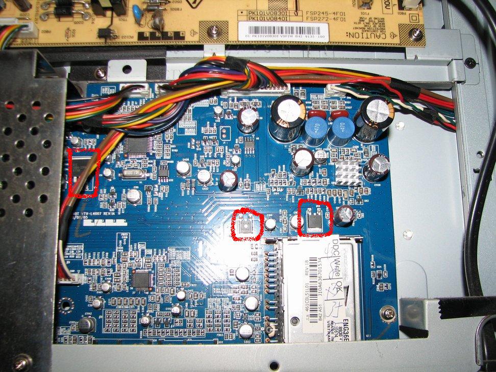

    I circled 3 voltage regulators on the main board.
    1) List each part number.
    2) Measure each pin (except the tab) with respect to ground.
    3) Report all readings like the following.
    U101 - AS1117-33
    pin 1 - 0.0 V
    pin 2 - 3.3 V
    pin 3 - 5.0 V
    If the voltage regulators check out, we need to check other things on the power board.

      Re: Toshibia 40rv525u Green Blinking light and questions about Caps!!
      Okay, 5V is good. This might be your standby voltage. Normally, the legend is marked as 5VSB or something like that.
      Pin 13 is probably your power on signal from the main board. Normally it is > 3V, and if it is pulsing, then something isn't quite right.
      U101 - AS1117-33
      pin 1 - 0.0 V
      pin 2 - 3.3 V
      pin 3 - 5.0 V
      Hmm, I don't see a picture, maybe something happened?
      What do you mean (except the tab) are you Referring to the Tab on a Mosfet Like Device?

          • ComputerGeek
            • Oct 2011
            • 262
            OK Here they are Also the Middle legs is not connected to the board. Pins numbers are from left to right when facing the Tab.
            Legend U13
            78m096
            RA837
            Pin #1 0.05
            Pin #2 0.00
            Pin #3 0.50 However, That is the Spike the Curent Jump Up for and then starts to drop off.
            Legend U14
            7805A
            J8 1A
            Pin #1 0.50 However, That is the Spike the Curent Jump Up for and then starts to drop off. This seems Identical to Pin #3 of U13
            Pin #2 0.00
            Pin #3 0.00
            Legend U7
            AIC
            1084-33PM
            877H8
            Pin #1 0.00
            Pin #2 Seeing a spike around 0.71 then start to drop back off, till it spikes again.
            Pin #3 Same as Pin # 2 but a Higher Voltage 1.35 or So.

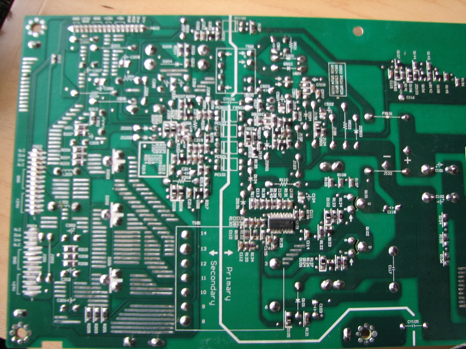

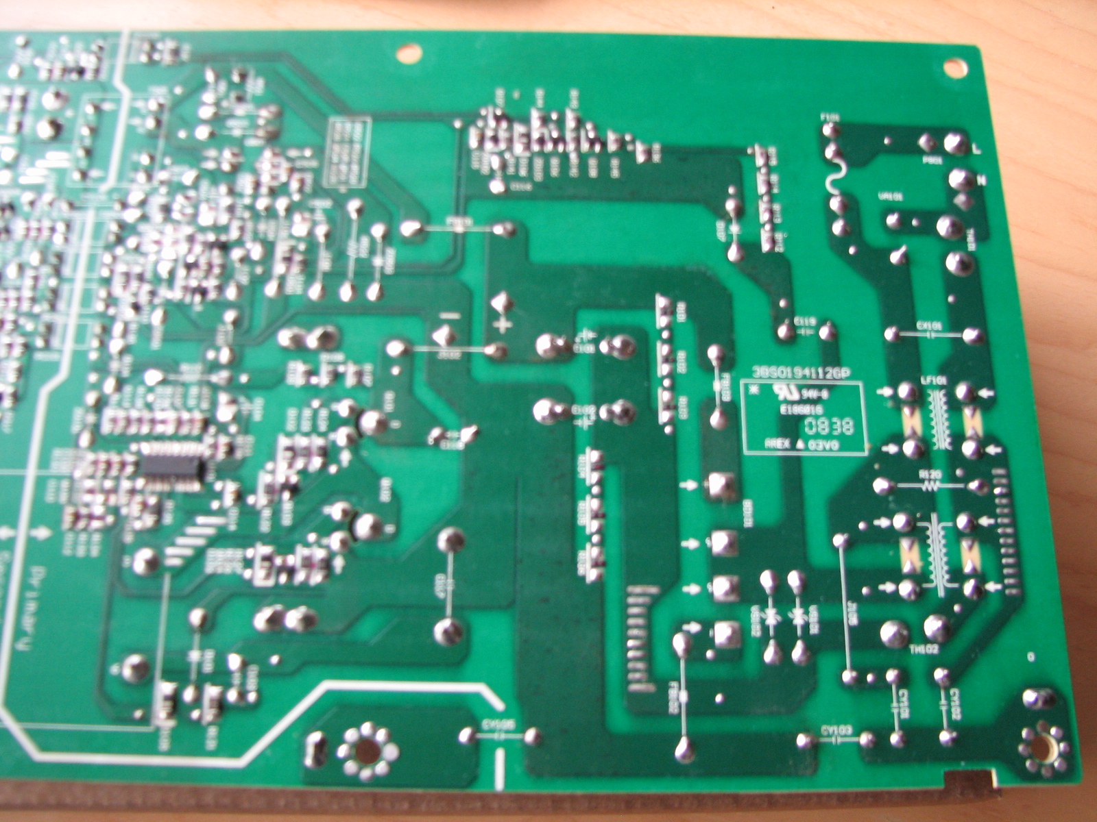

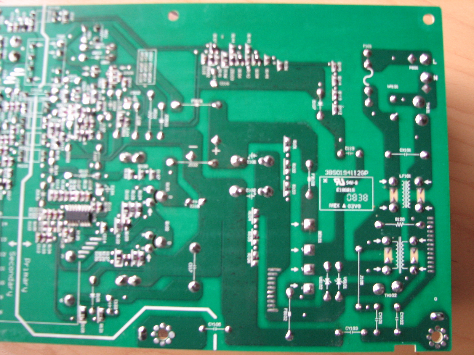

                • ComputerGeek
                  • Oct 2011
                  • 262
                  Here are the Pictures I Took them next to a window thinking that It wouldn't create glare like the Flash but they still have it.
                    #29
                    Looking at the layout of this power supply, it's clear that there is no startup cap for the main rails (as the primary of the main transformer has just one winding); the Vcc for the main controller (5V/12V/24V) is developed from the standby supply and as that is working, it's unlikely to be the problem.
                    Testing diodes:
                    Turn the TV off & wait 1 minute for the main bulk caps to discharge (these might carry 200V DC each, so can give a nasty shock!)
                    Flip the board upside down so you can see the solder side.
                    Get out your multimeter, and set it to the diode test mode. It looks like this: ->|-
                    If you do not have a diode test use the 2000 ohm / 2k ohm range - this is often the same or combined onto one range.
                    Initially, do not probe anything, and note the reading you get. It should be either " OL " or a single left-hand 1. This is your "open circuit" reading.
                    For each highlighted diode (red), test all six combinations of pins. Counting from the top: 1-2, 1-3, 2-1, 3-1, 2-3, 3-2. Typically, we are expecting around 120 - 800 from 1-2 and 2-3, and all of the other readings to report open circuit as above.

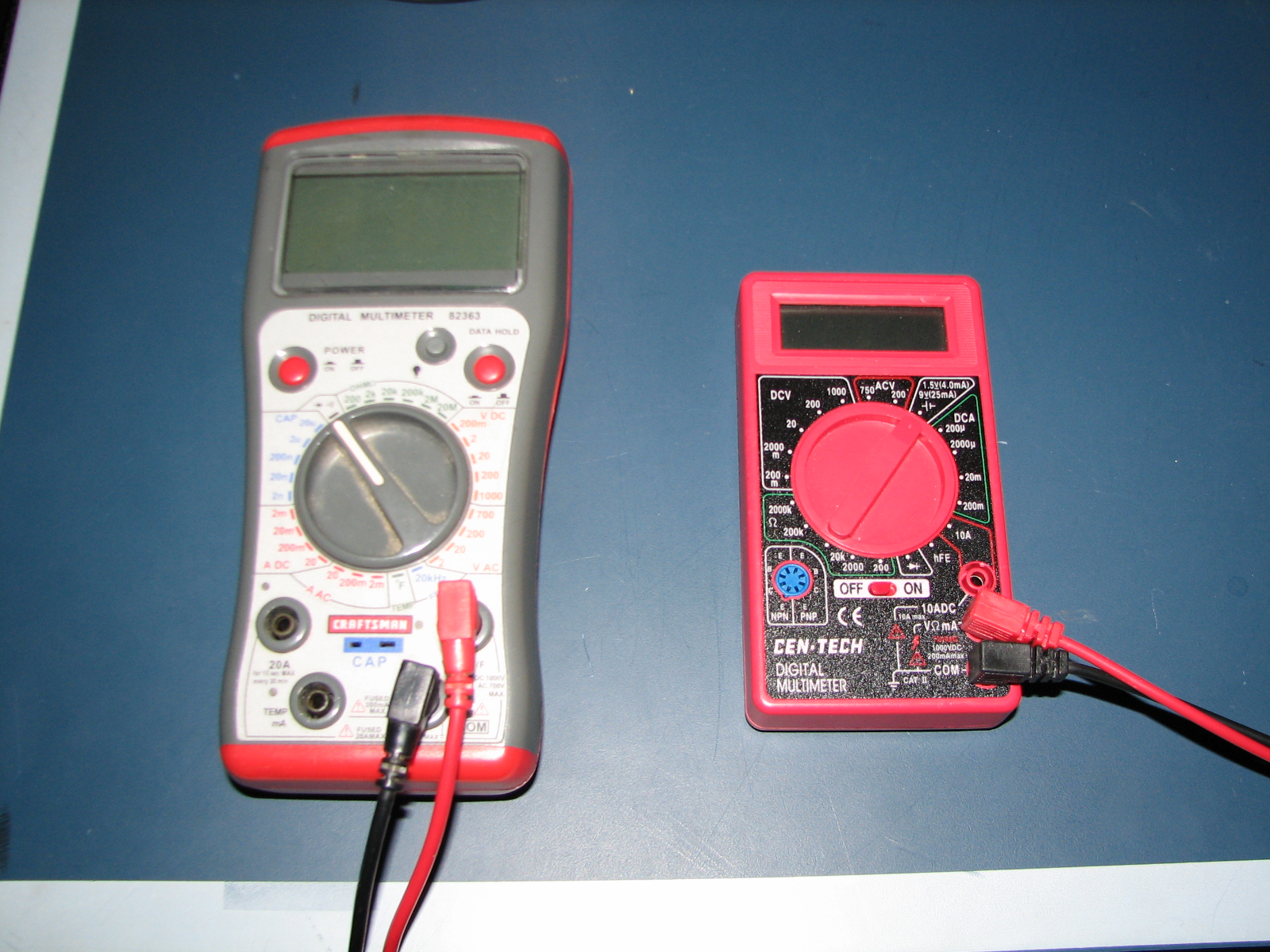

                                  OK Also, I was getting different readings on D203 but just rounded since I thought it was the meter. Now I see why though, its not the same as the other two D202 and D201 are different than D203.
                                  • retiredcaps
                                    • Apr 2010
                                    • 9271
                                    #37
                                    Originally posted by ComputerGeek
                                    Also I am having trouble getting a good reading I have another meter with a diode test should I use that?
                                    Post a picture of your multimeter that you will be using from this point forward.

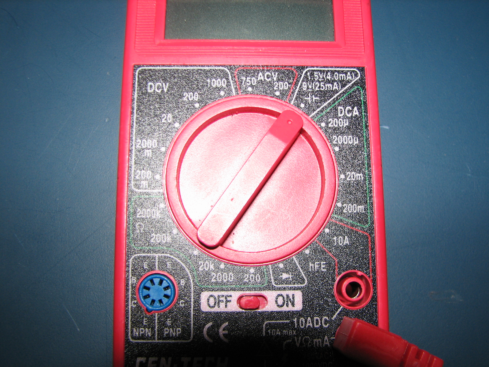

                                      #38
                                      Here I was using both of them for the First test but the Craftsman Battery Died, I am going out in a 30min to get a new one though. So I will have the option to use either one. Whatever, you think I got the Cen-Tech mostly to check DC AMPs so I don't fry my good one.
                                      Thanks!
                                      P.S. Both of the Readings have been the Same in all of the test I did with both of them.

                                        #39
                                        99.99% of the measurements we ask for are DC voltage, diode, and resistance. We usually never ask for amps measurement.
                                        I'm very explicit when directing people to take measurements as I was once a newbie not that long ago and was unsure how to use a multimeter correctly.

                                          #40
                                          Ok I am not sure how to measure ohms properly, I thought I recall younot being able to hold in onthere for too long
