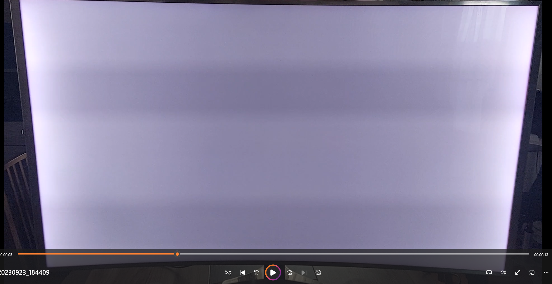

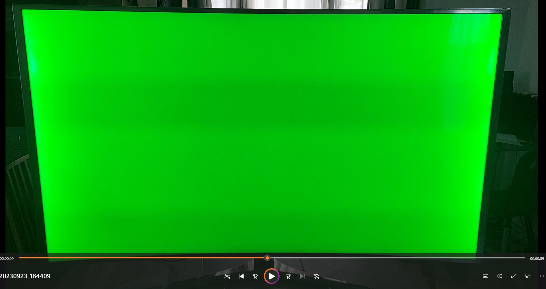

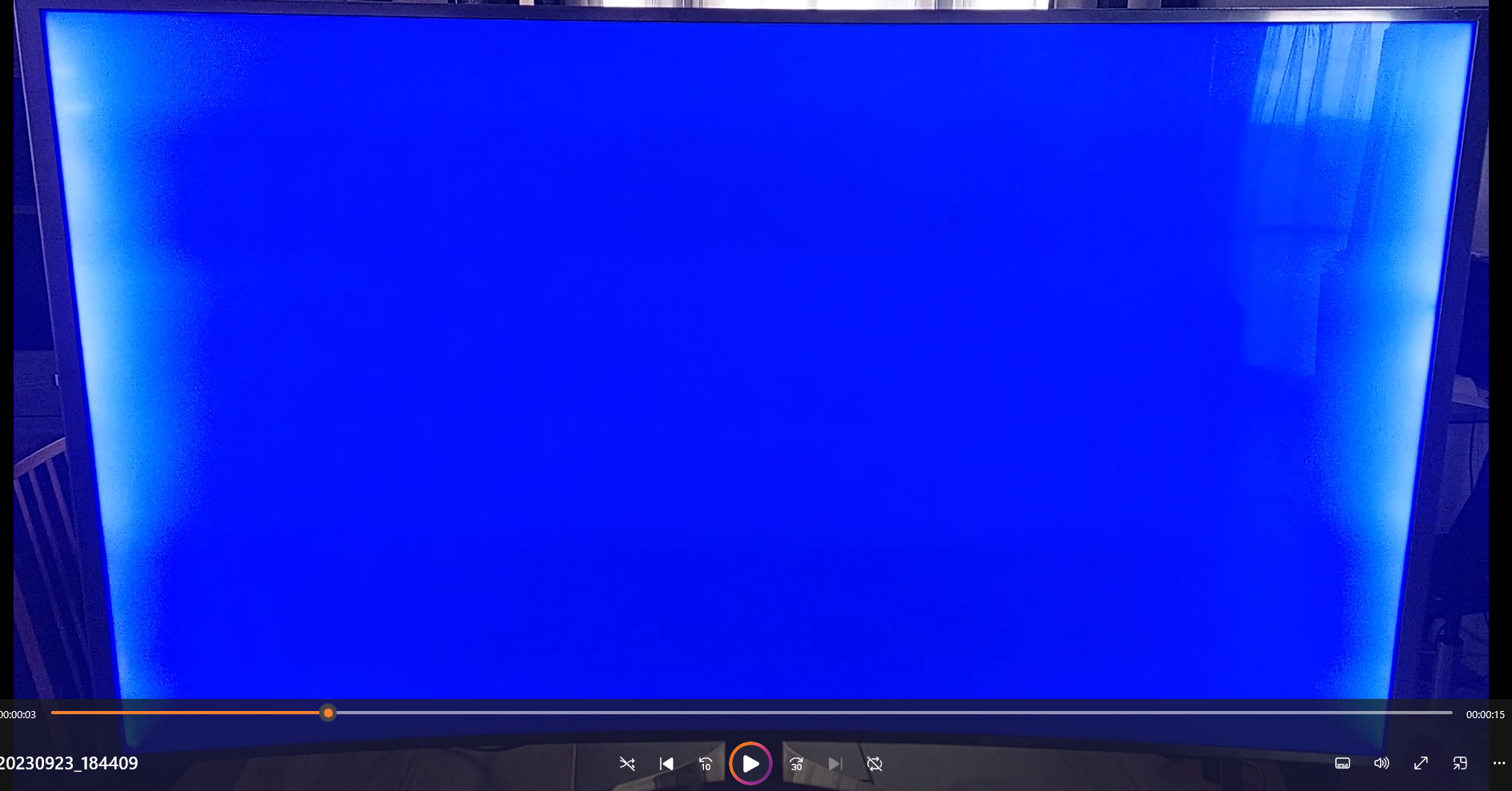

      Re: EU55JS9000T black screen and sound good

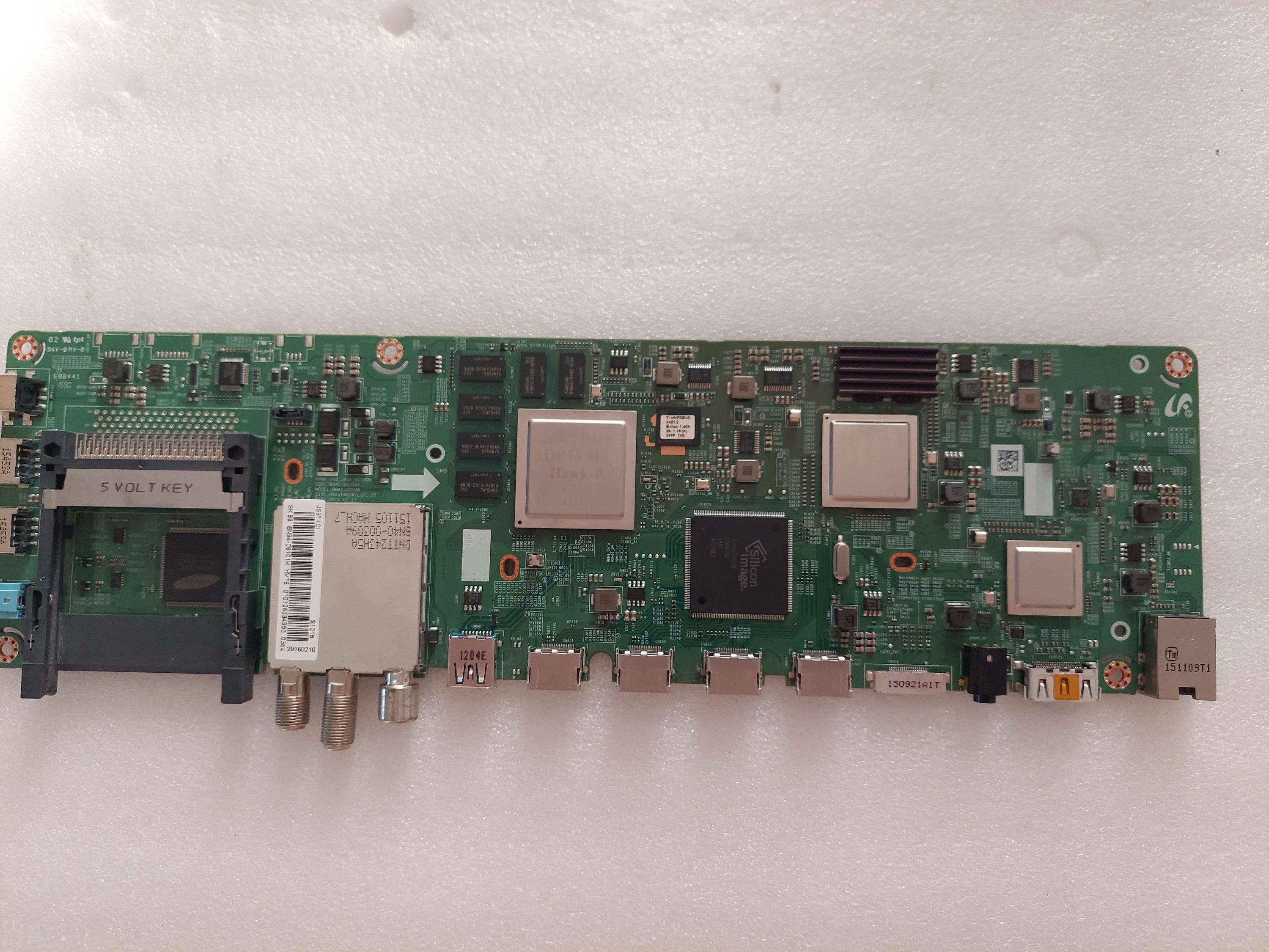

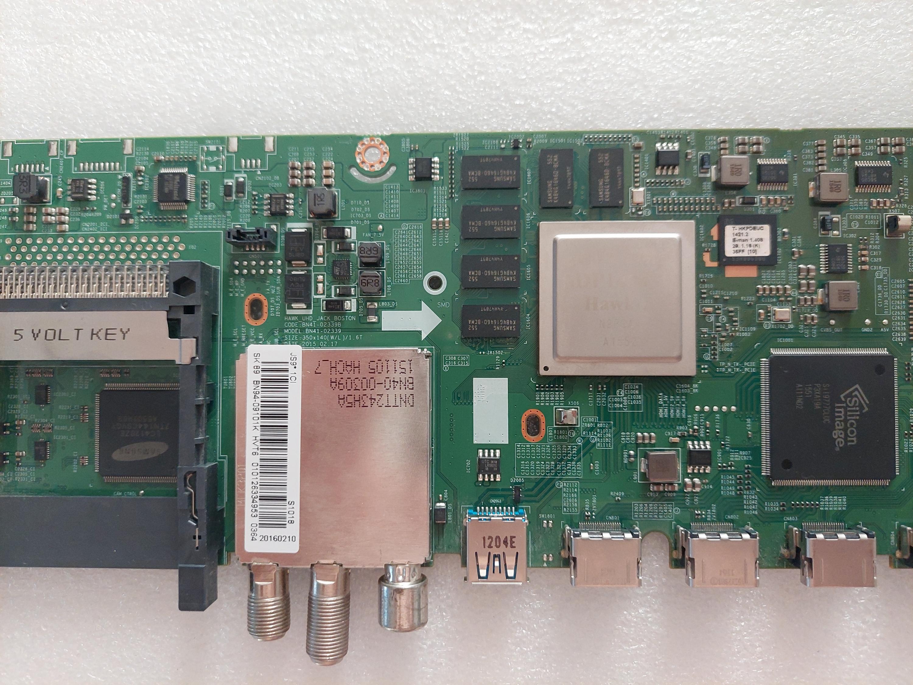

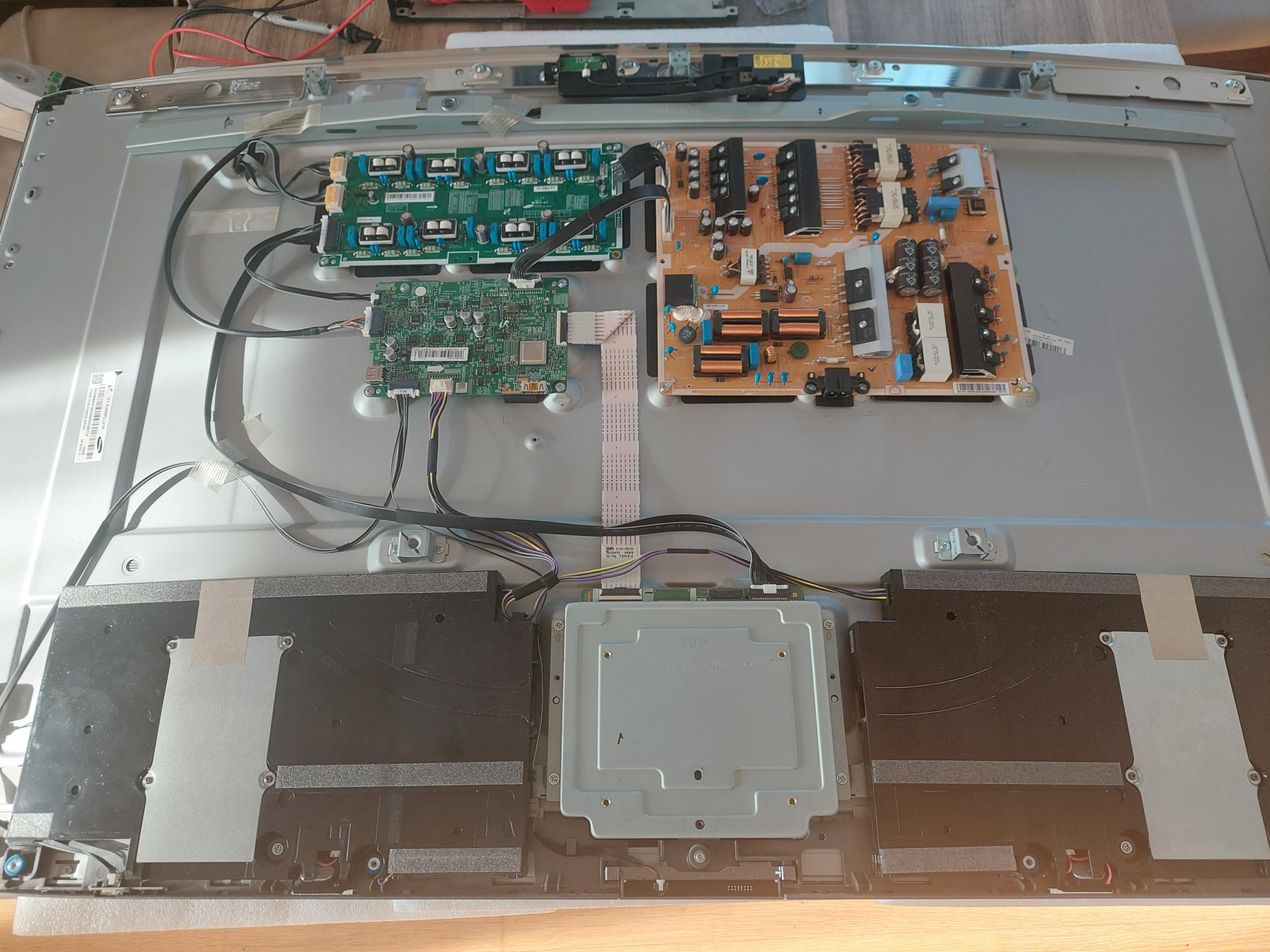

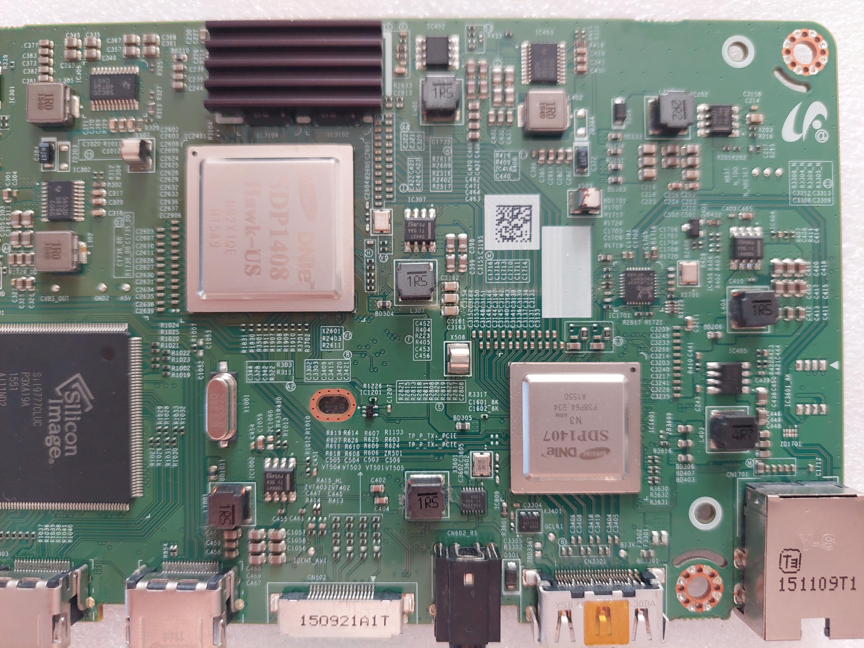

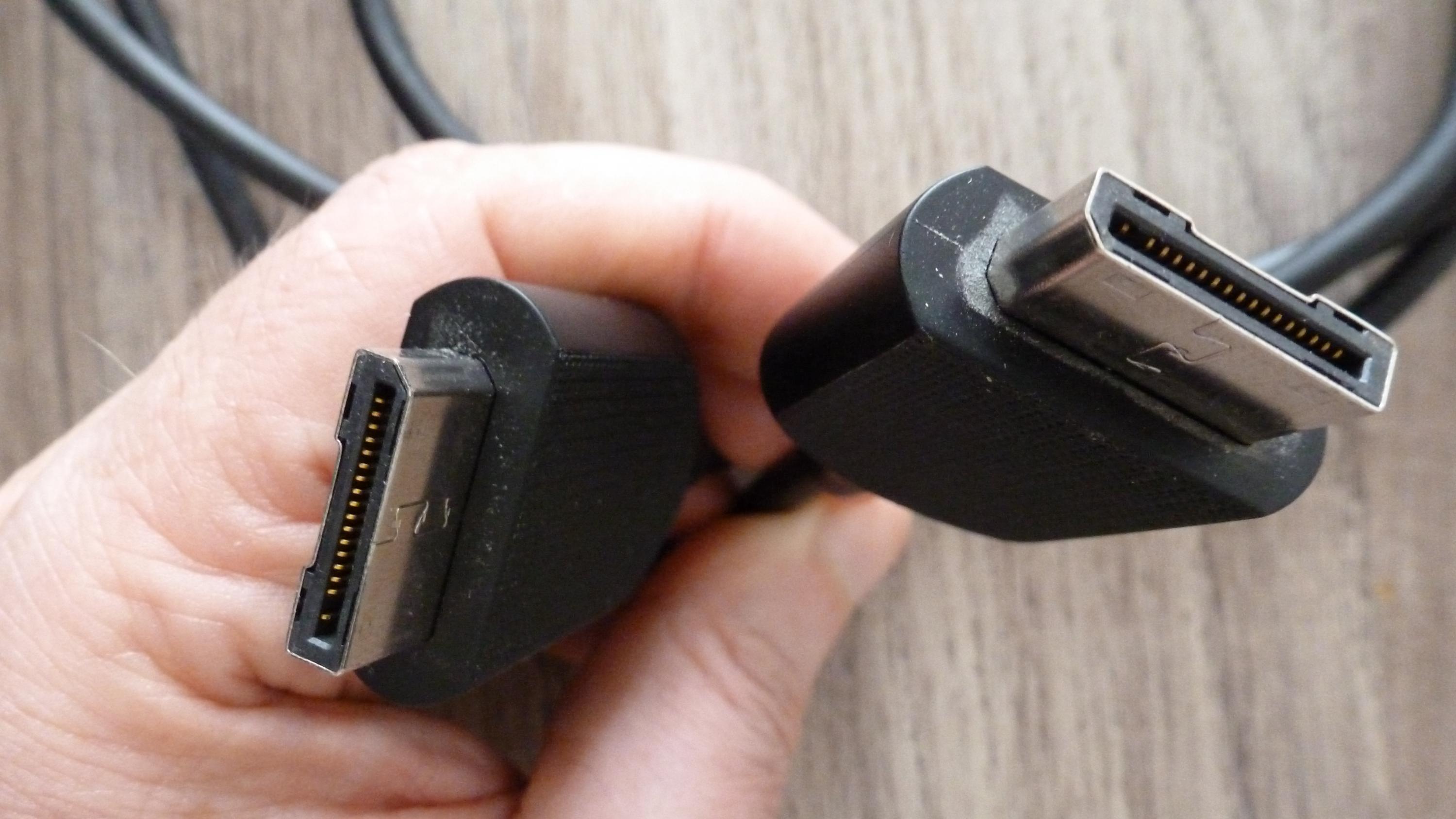

      I make the tcon test with a service RC (it's a RC bought by my colleague, the tv is his).
      Some photos of the tv during the test.
      A photo of the one connect cable.

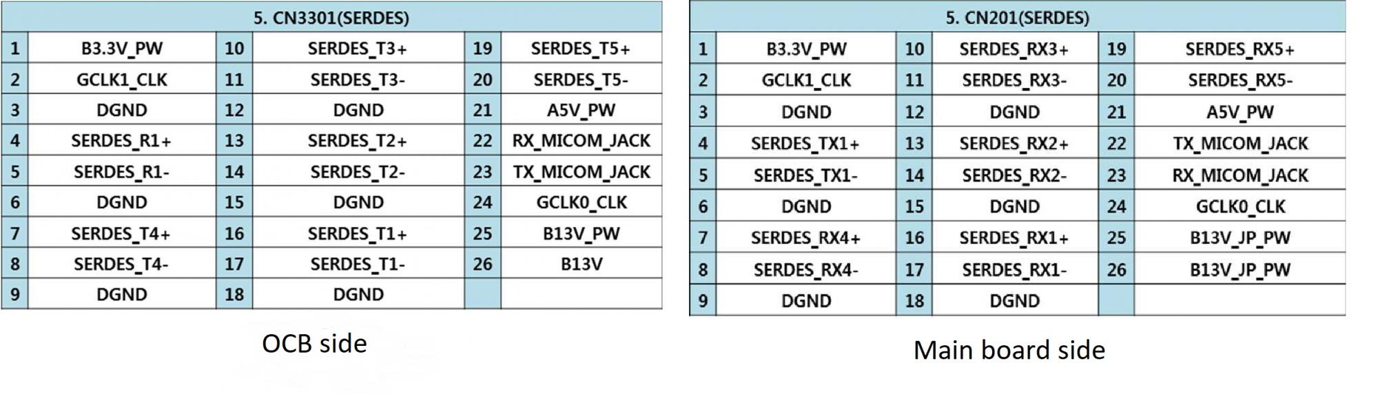

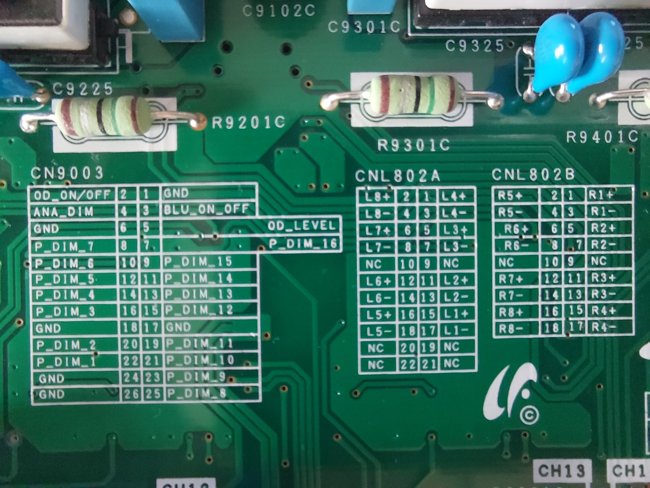

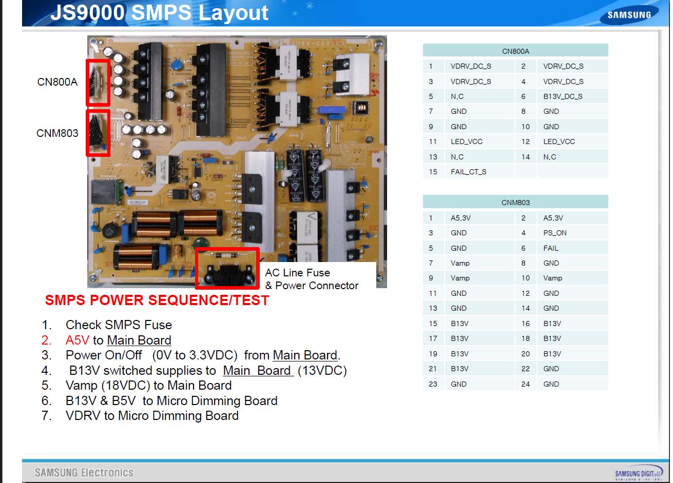

        you must show the tables of the main power board, the orange one..
        • totof
          • Feb 2017
          • 169
          • france

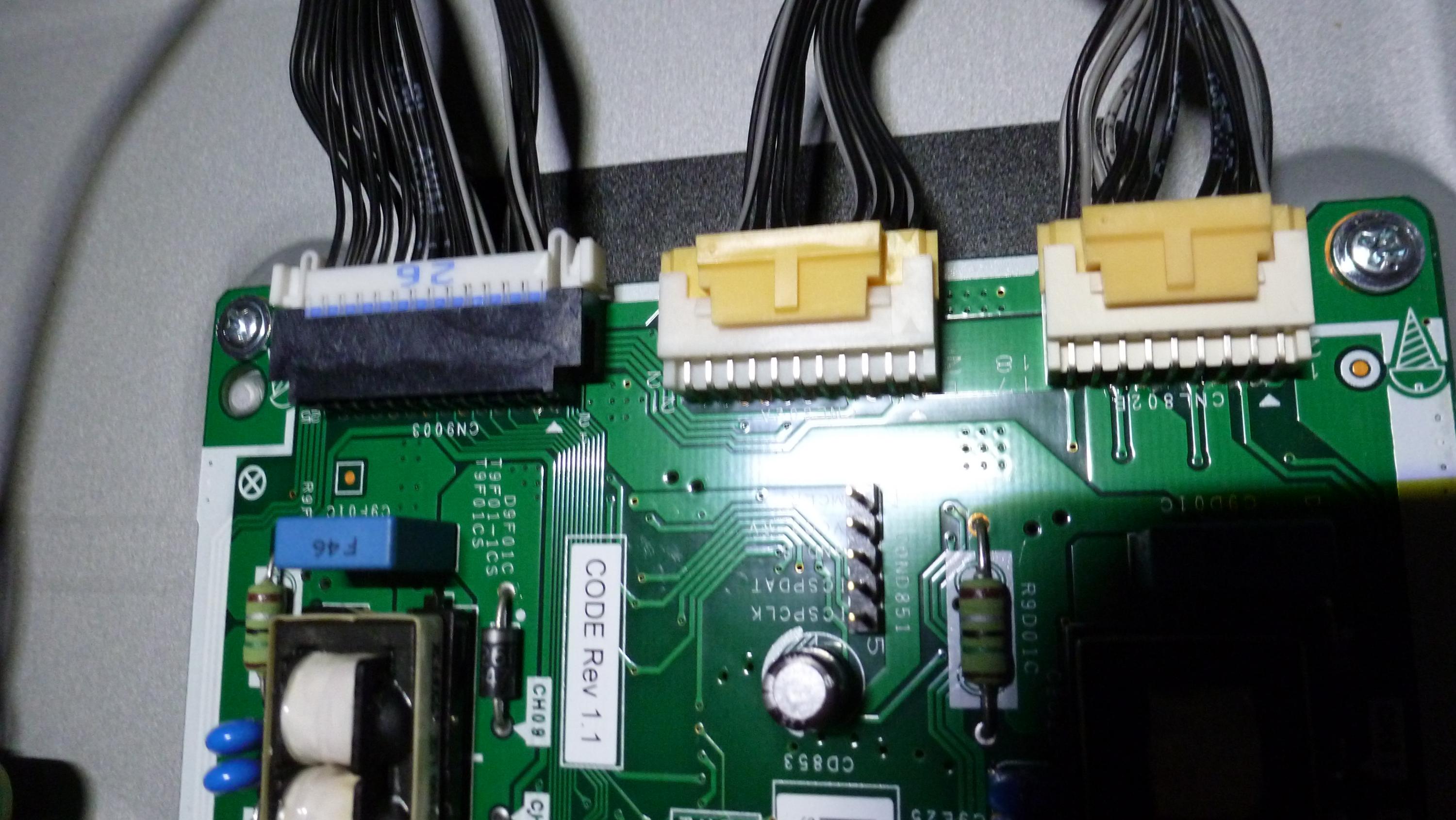

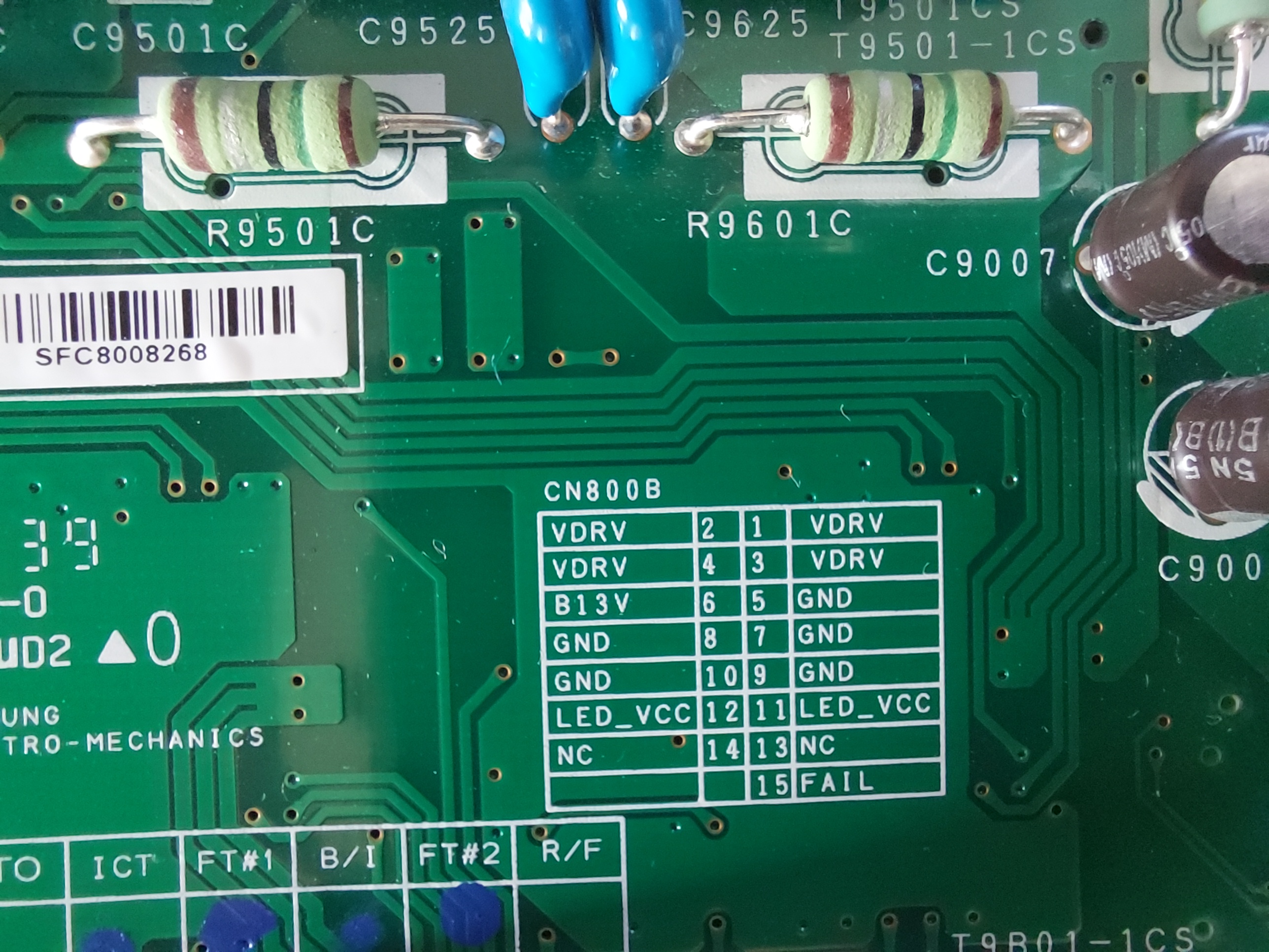

          The connector pin of power board
            OCB has a short circuit that disables the screen (12v off> tcon off) that disables the dim signal to the led driver board (backlight off).. since you are not a technician you have to get a replacement ocb.. 12v on MB maybe remains on because of a protection circuit at valley of the screen switcher mosfet..

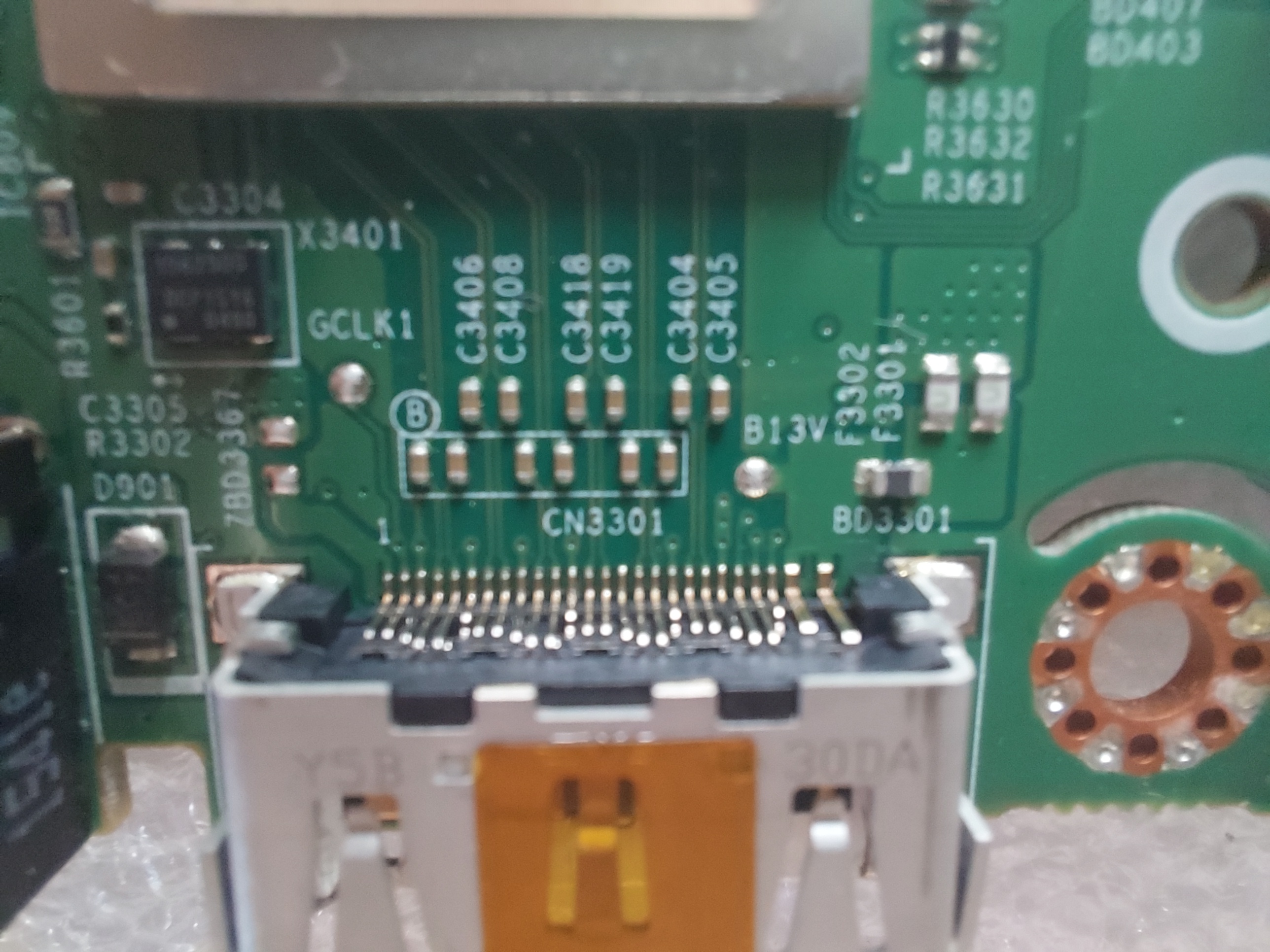

                    Whether the OCB is connected or not I measure 12V on pins 25 and 26 of CN201

                      Yesterday I had the opportunity to try another one connect cable and the result is the same, namely that the backlighting turns off immediately as soon as the OCB is connected. So it is not a cable issue.
                      I checked the B13V signal on CN201 (pin 25,26 on main board side) and I see 12,73V when OCB is not connected and 12,67V when OCB is connected.
                      It's a little below 13V but it might still be normal, I don't know.
                      I'm following up on any leads that could help me find the origin of the problem.
                      I have been looking for the OCB card diagram for several days but it is nowhere to be found.

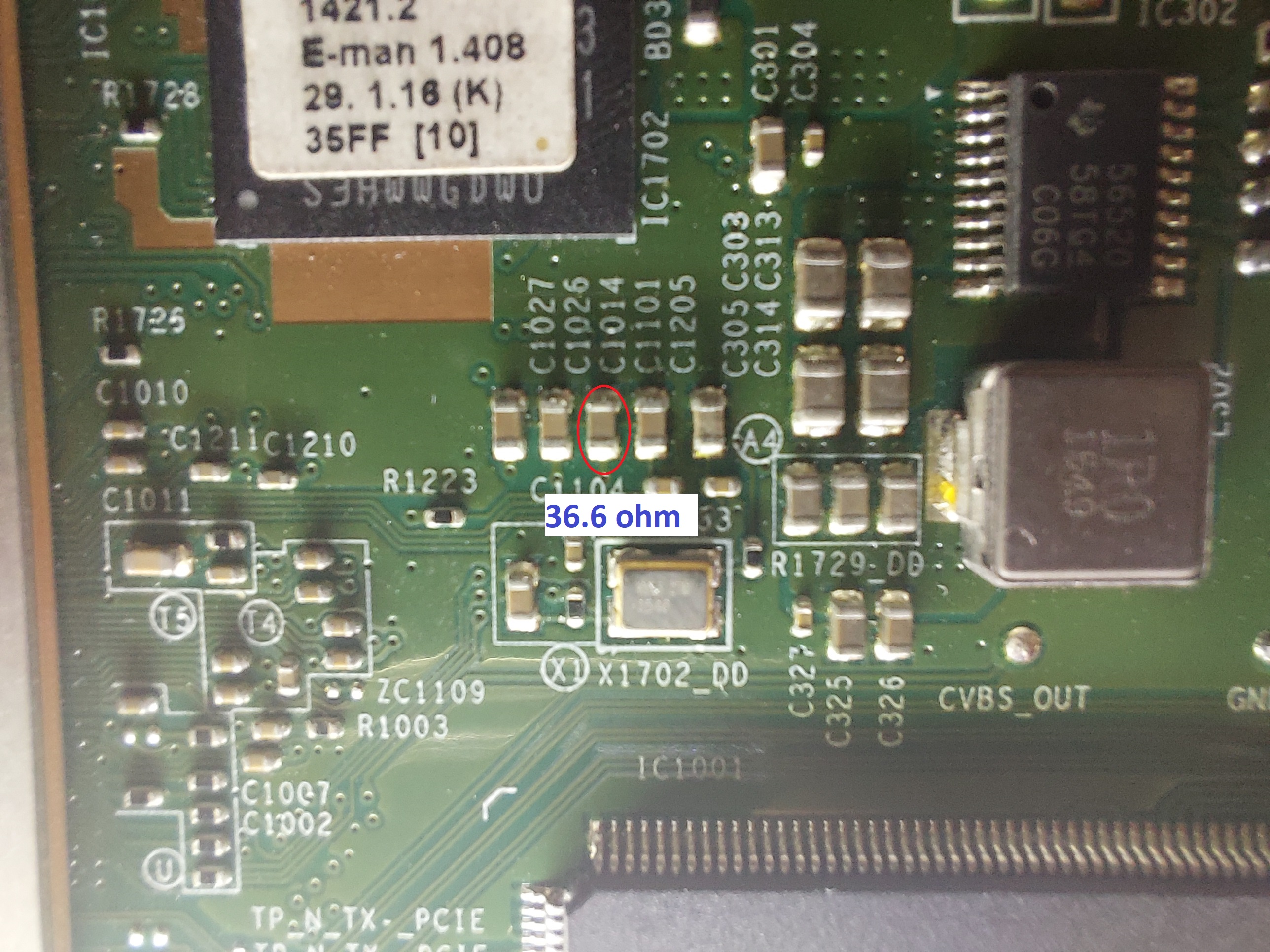

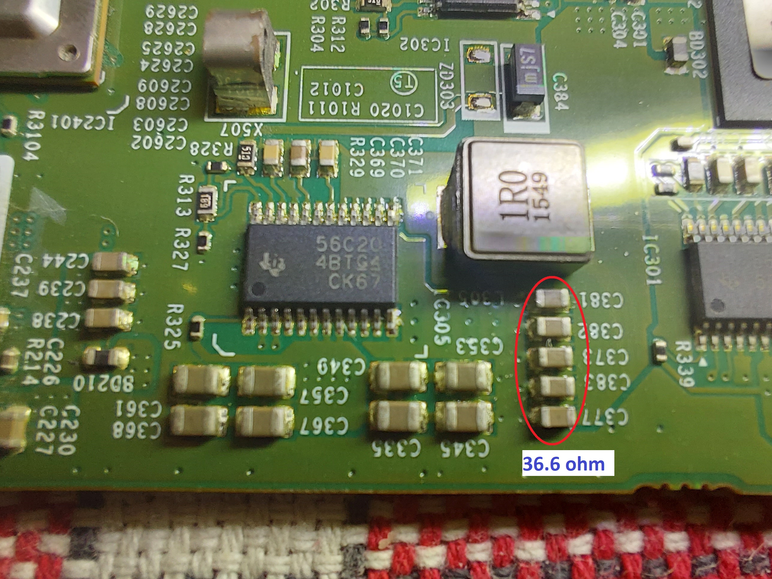

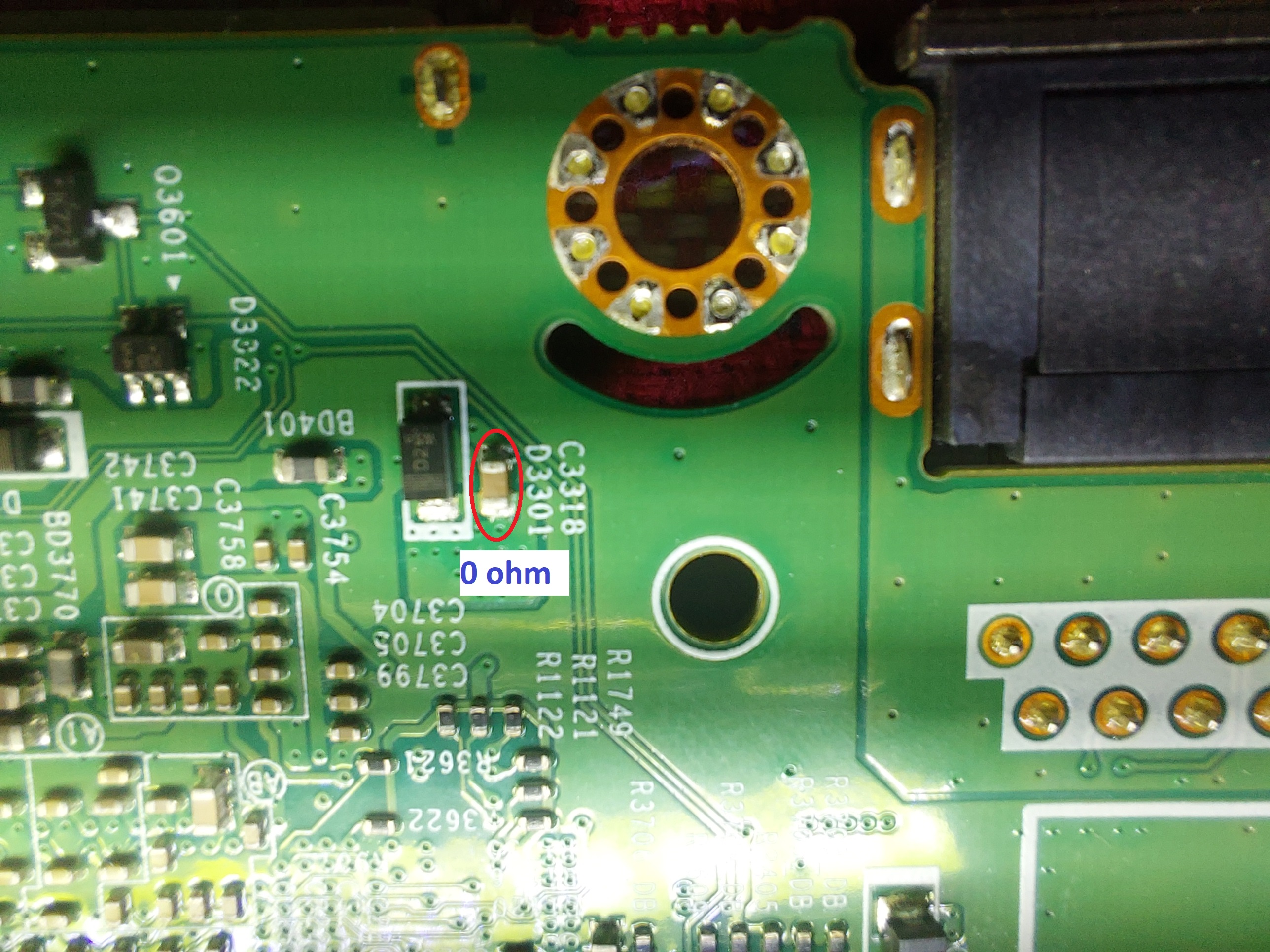

                              I checked the capacitors for short circuits and found several with low resistance:
                              - C373, C377, C381, C382, C383: 36.6 ohm
                              - C3318: 0 ohm
                              - C1014: 36 ohm
                              • nomoresonys
                                Ok, that's part of the battle, now to just find someone with a properly functioning ocb to compare with, I have no idea what those voltages should be, have always stayed away from those ocb tvs.
