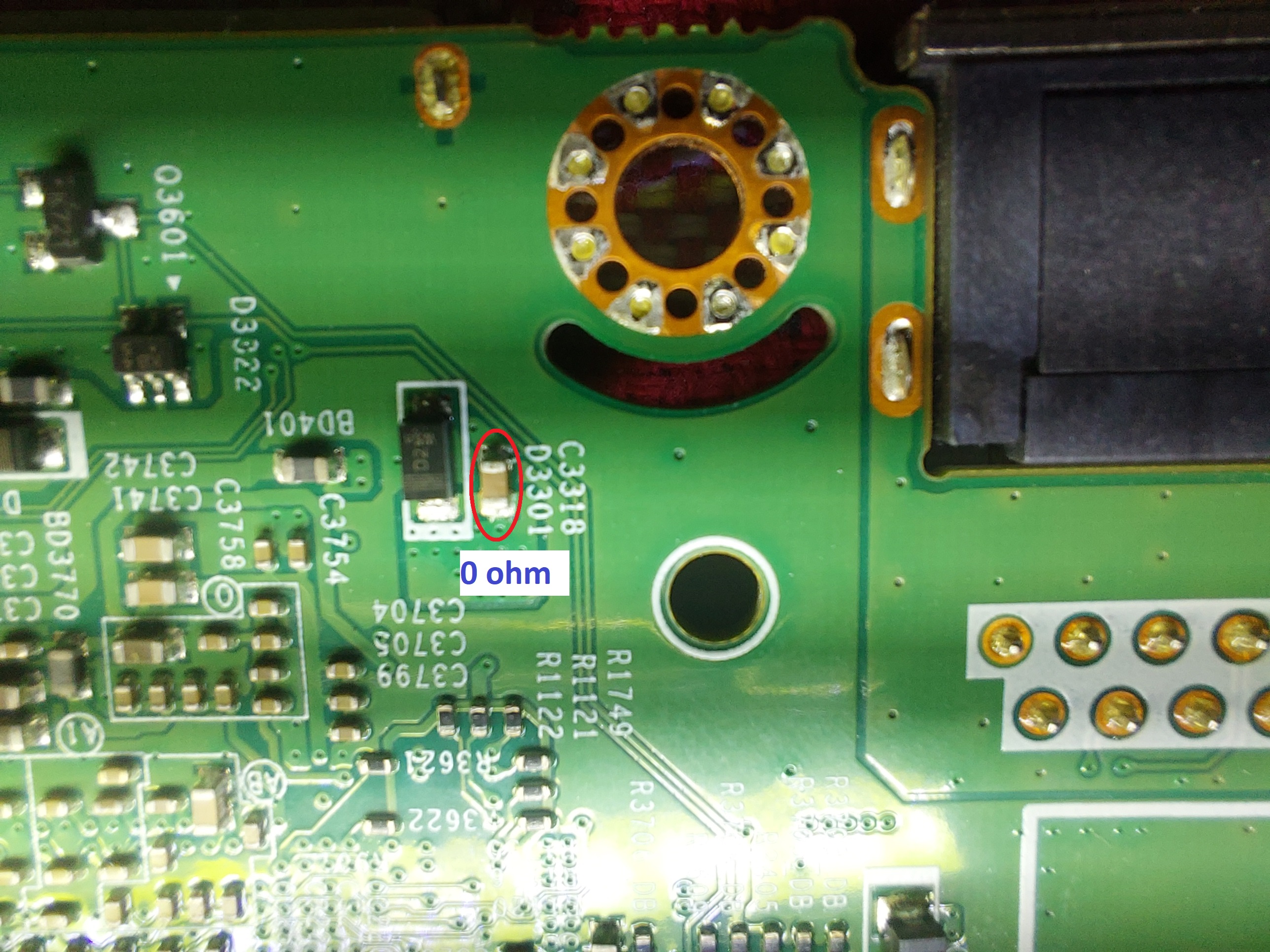

              Originally posted by totof
              I checked the capacitors for short circuits and found several with low resistance:
              - C373, C377, C381, C382, C383: 36.6 ohm
              - C3318: 0 ohm
              - C1014: 36 ohm
              I'm tracking the shorted C3318 capacitor because it's located just below the OCB connector. I removed it but it's not the one that's shorted.
                I did not understand what C3318 is for in any case there is 12.3V at its terminals and it is connected to the VIN pins of several ICs: Z3013PI, TPS54427 (x2) and TPS106041 (x2)
                This is not the right way.
                Complicated, very complicated (for me)
                  415 euros.
                  Much too expensive for my colleague especially for a used card.
                  Check that diode right beside it, go ahead and check it in circuit, see what it reads.

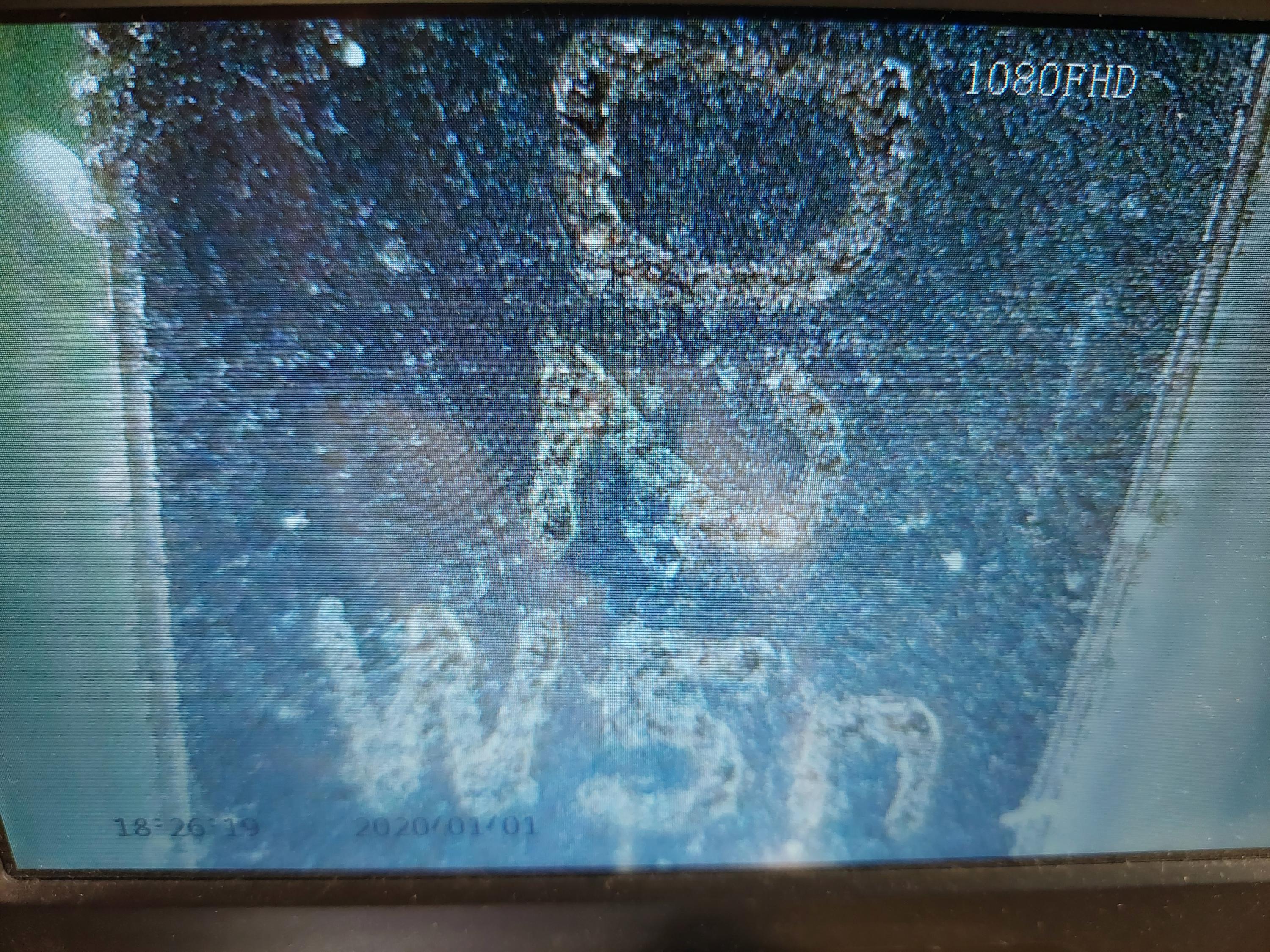

                    Re: EU55JS9000T black screen and sound good
                    The diode D3301 is one side connected to GND and other side to B13V from OCB connector.
                    Marking code on the diode is D2 W5n. It is a zener diode but I don't know if it is the good voltage.
                    It seems D2 code is for 3,6V zener diode. I don't know what is W5n.
                    I desoldered the diode and it is identified as a diode with my tester.
                          Use a multimeter. Diode mode meter connected in one direction get a voltage drop zeners are usually about .6 volts, meter leads switched and you get OL, 1.
                            Yes, I had done this test. 0.74V in one direction and OL in the other direction
                              Ok, now hopefully the capacitor is still off the board, check the pads it came off of, does it read short? maybe also check it in ohm mode.
                                The pads of the capacitor is still shorted.
                                With the multimeter I read OL for this capacitor, she is not dead.
                                Alas, I would have loved it if she was the one to be hs
                                  Read the cap in ohm mode, make sure you have good connection with the probes.
                                    If your meter is not auto-ranging you will probably need to adjust the ohm mode to the different settings and see if you get a reading, OL can just mean that your meter isn't set right.
