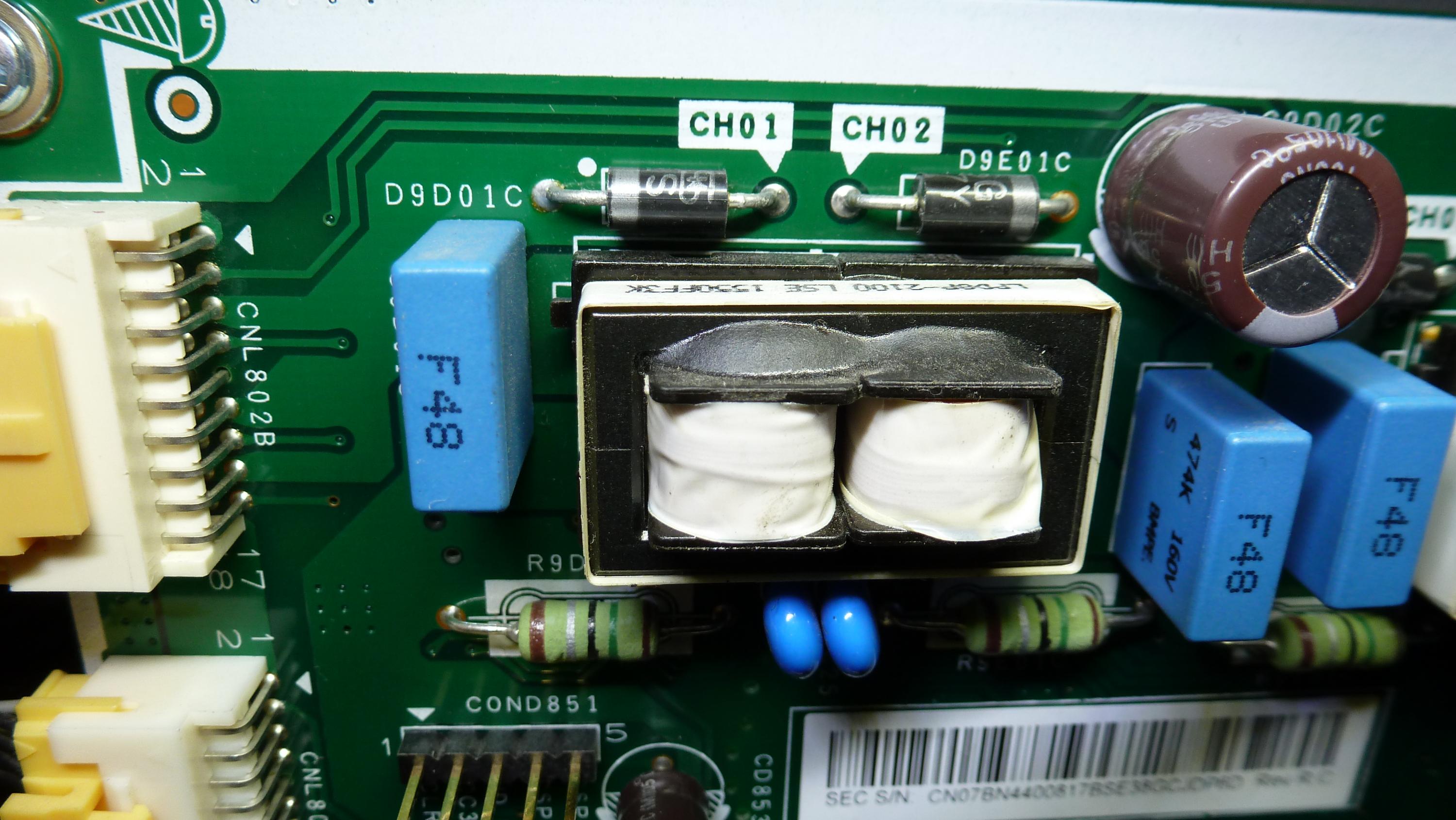

          Re: EU55JS9000T black screen and sound good
          Sometimes it can be the components in a circuit that can make things seem shorted, like if there's a resistor in circuit across it, it may read short and be ok, that's why you get the best results off the board.
          I agree with you.
          This short circuit capacitor is suspicious but I don't know where the origin is. There are definitely voltages on all the inductors, however I don't know if they are all correct.
          To check if there is an image I planned to disconnect the PWM signals from the TCON board to inject a voltage of 1V directly onto the backlight control board. What do you think about this test and should a DC voltage be injected?

            Did you get a reading on that cap in ohm mode? test as in post #57.

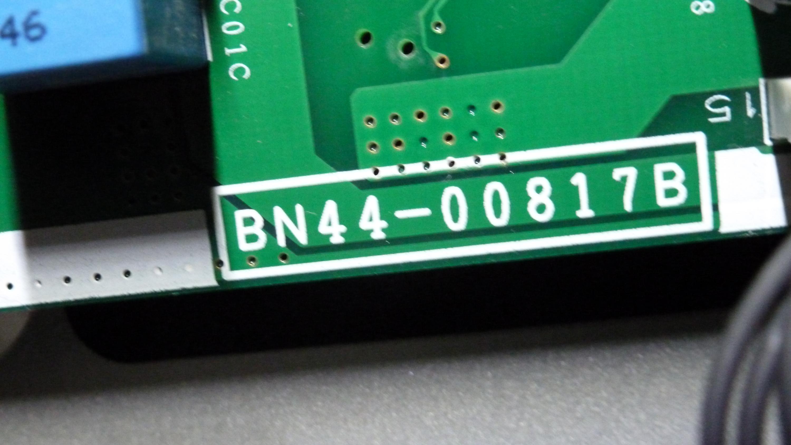

                    • totof
                      • Feb 2017
                      • 169
                      • france
                      #70
                      OL in ohm mode on multimeter. No short cut.
                      I do see a backlight operation test in your training pdf from the first post.
                      Yes the backlighting works but it turns off immediately (<0.2 sec) as soon as the OCB cable is plugged in.
                      The P_DIM1..16 signals from TCON board falls to 0,36V, BL_ON is still good (4,7V)
                      The Tcon test works well (see post #22) but only when ocb is not connected

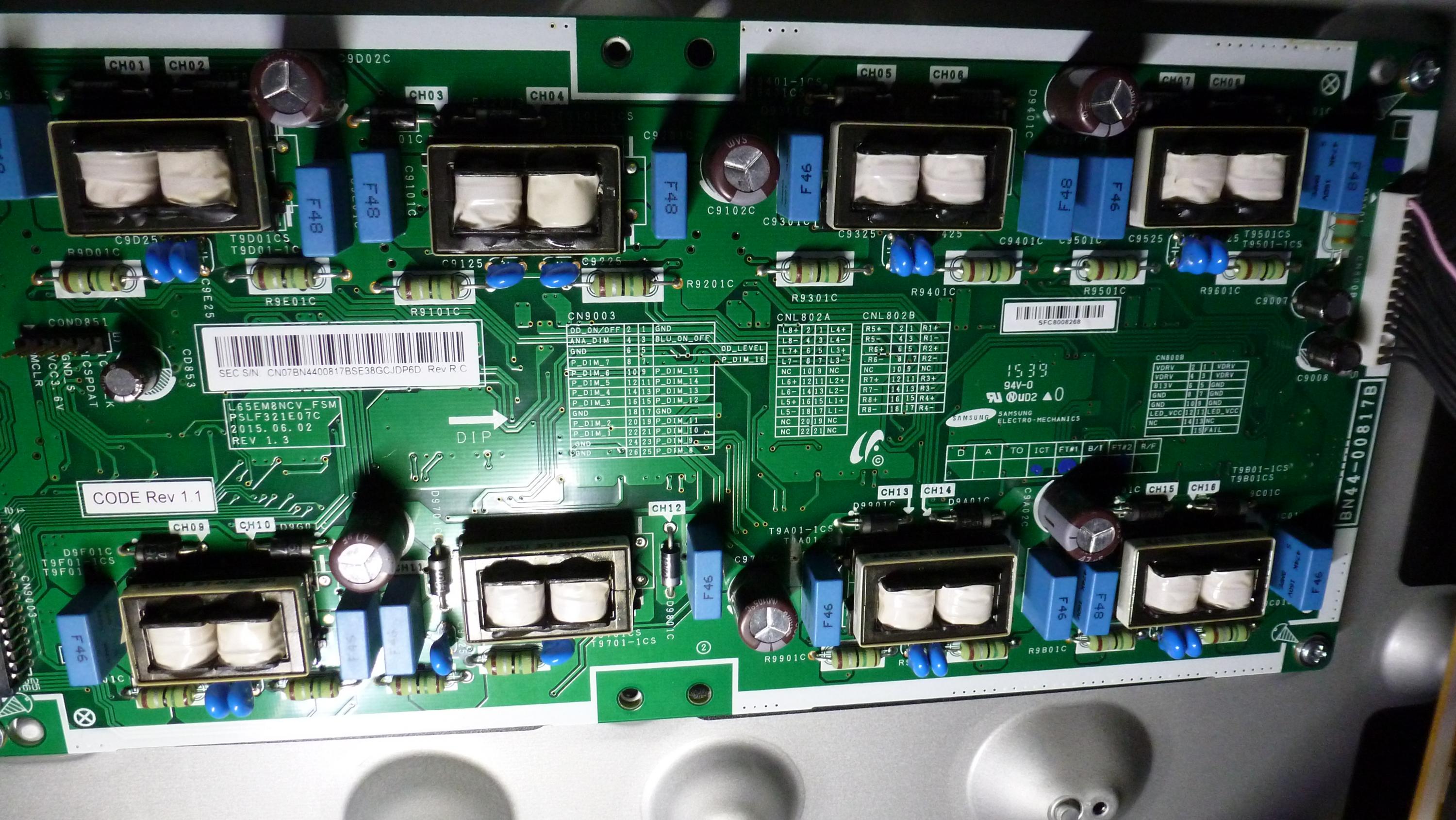

                        My backlighting control board is not exactly the same as that in the document on post #1, the connectors are the same but the components are different.
                        At the terminals of the 16 diodes I measure 59V on one side and 20V on the other with the reference on the chassis.

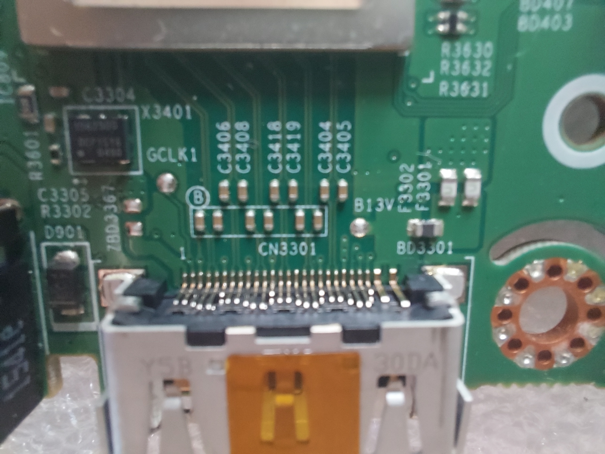

                                      • totof
                                        • Feb 2017
                                        • 169
                                        • france
                                        #79
                                        Now read, check the other similar capacitors in the area, leave them in circuit, DO they also show OL??
                                        Last week-end I have checked all capacitors on the data lanes of the ocb cable and all are good (100 nF). I have checked this capacitors on main board side and on ocd side.
                                        Attached photo of the OCB board to the connector to the motherboard
