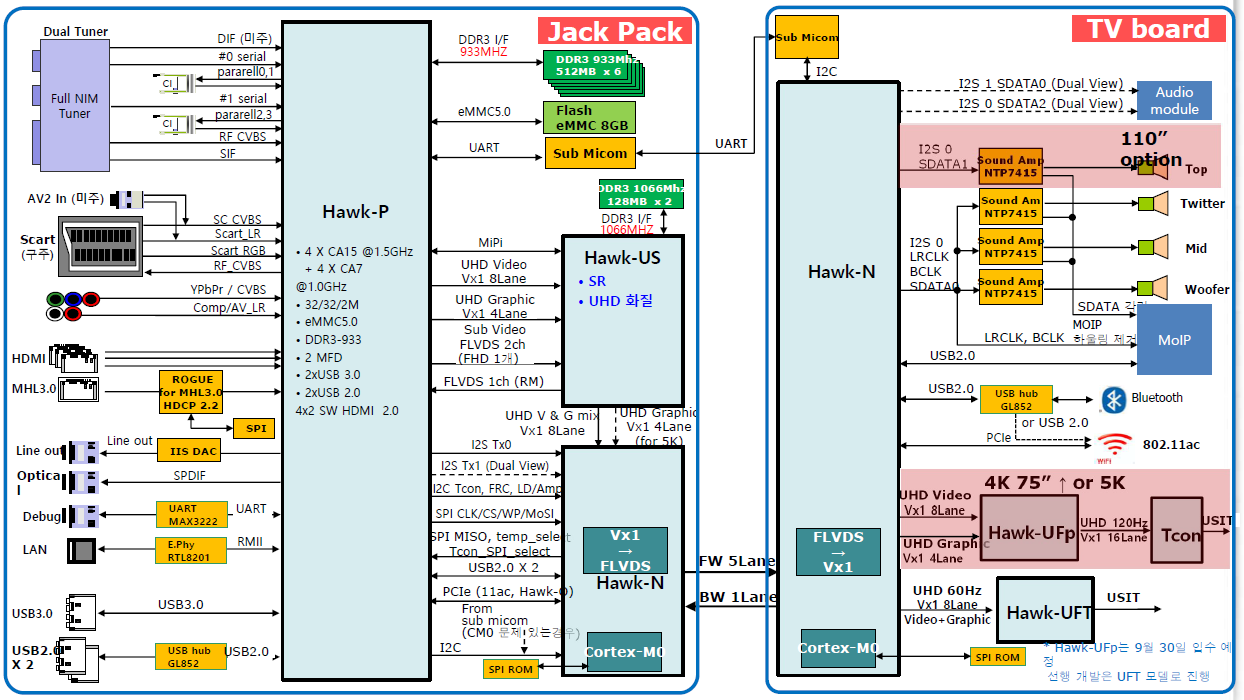

      Re: EU55JS9000T black screen and sound good
      Originally posted by Davi.p
      I have few time now to read back all, but since inductors shows no apparent power supply problems, and the hawk p that is the main processor i think, and it is heating a bit, then probably there is cpu soldering problem, i think it is not sending image to the tcon, the tcon that controls backlight on the basis of the image content, sends an almost black signal level to it (see back the 0,04v on p dim)..
      Yes, I also thought about that, a bit like a certain laptop motherboard. This could be any component on the chain (Hawk-P, Hawk-US or Hawk-N)
      The only thing that could make me think that it is something else is that the backlighting is cut off immediately after connecting the cable while the Hawk components have just been powered and are not yet initialized and operational.

                #87
                Lotas, first post states sound is good, freetnt tv is audible, so no software problem for me...
                as per diagram in post 82 Hawk N is responsible of driving TCON and therefore backlight levels, but there is also an SPI flash memory connected to it that can be polluted..

                  #88
                  So what's up, is it solved or what?
                  No it's not solved (unfortunately)
                  The TV works well, I can hear the sound from the TV (TNT tuner source). The sound comes about 10 seconds after plugging in the OCB cable.
                  So I don't think it's a firmware issue.

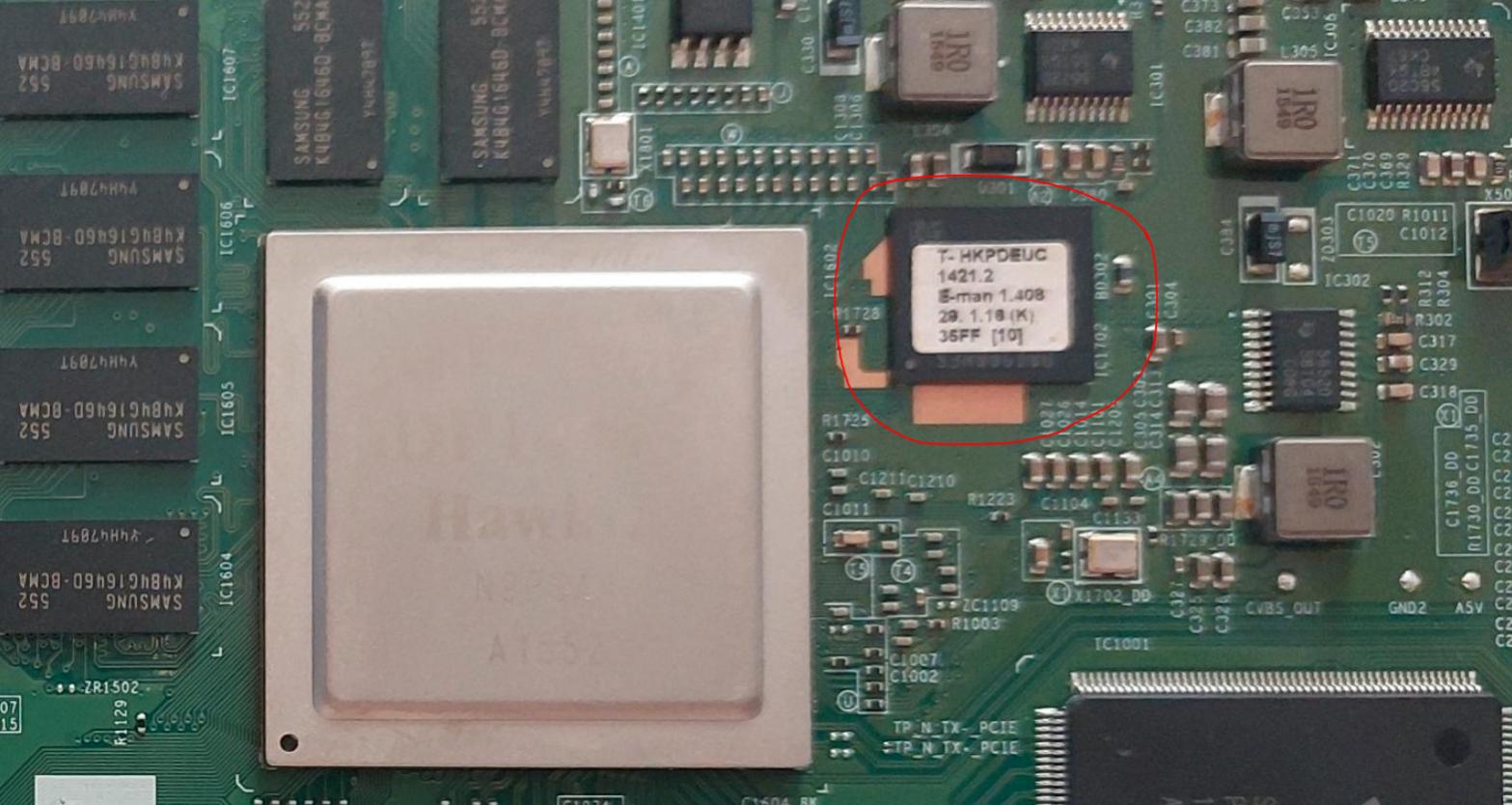

                            Here is the dump of the SPI flash of the OCB card.
                            Maybe one day it will be useful to someone on this forum.

                                #95
                                your document speaks about 2 spi roms, to be aware of which one to process..
                                Yes there is also a EEPROM on the OCB board and a SPI on the TV mainboard.
                                Here are the dumps of these CI.
                                A lot of 00 on the mainboard TV SPI.

                                  i watched better your block diagram, i see now the separation Ocb/back board, things short, i suspect bad ocb to tv connector solderings.. reflow them all with little new tin.. both ocb & tv sides
