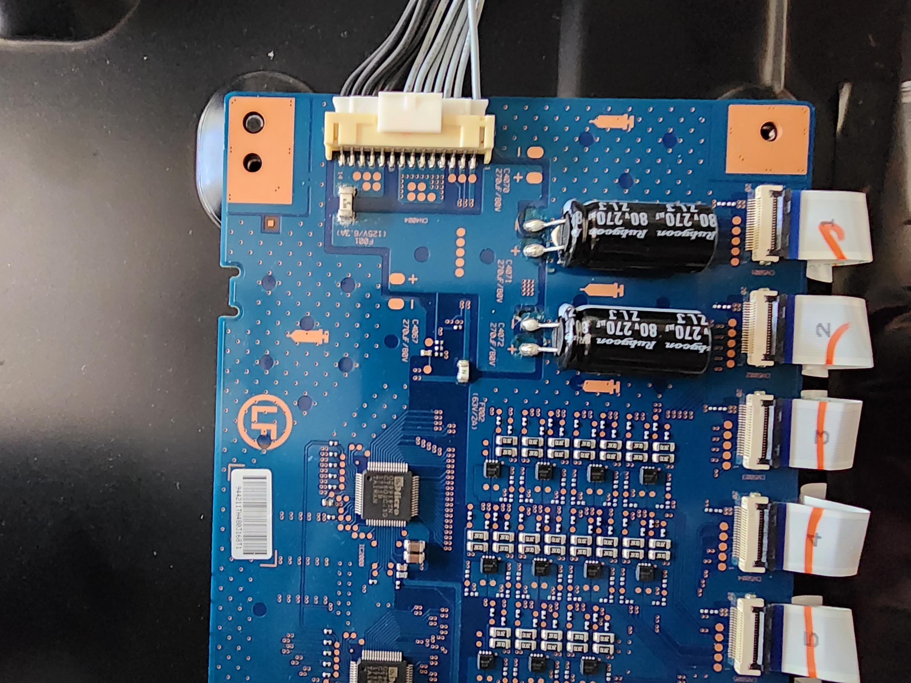

    Picked up a $4000 2018 TV and it's blinking 6x red. A search says something with backlights or led drivers board. This is my first time with such a complex TV. It's got 2 power boards, led drivers, tcon, main it's crazy lol.
    So I check voltages to main, all fine. 12.47v. I hit power and the BL_ON goes to 3.5V shortly and will kick off and red light flashes. Power board looks to be okay, but there is 2 power boards lol. 12V is at least hitting the second power board.
    I'm gonna test everything but how do I even test the LEDs on this thing without taking it all apart? Usually it's a wire going to lights, this has 12 ribbons. Can led tester show me if these work? Any help would be appreciated.

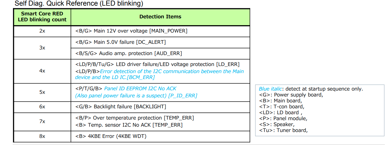

      • Storyteller12
        • Jun 2020
        • 624
        Re: Sony xbr-75x900f 6 red blink
        6 blinks on Sony TVs is bad backlights. Have to take it apart and replace them
            SONY XBR-75X9*F GN4TR CHASSIS "6" - error.

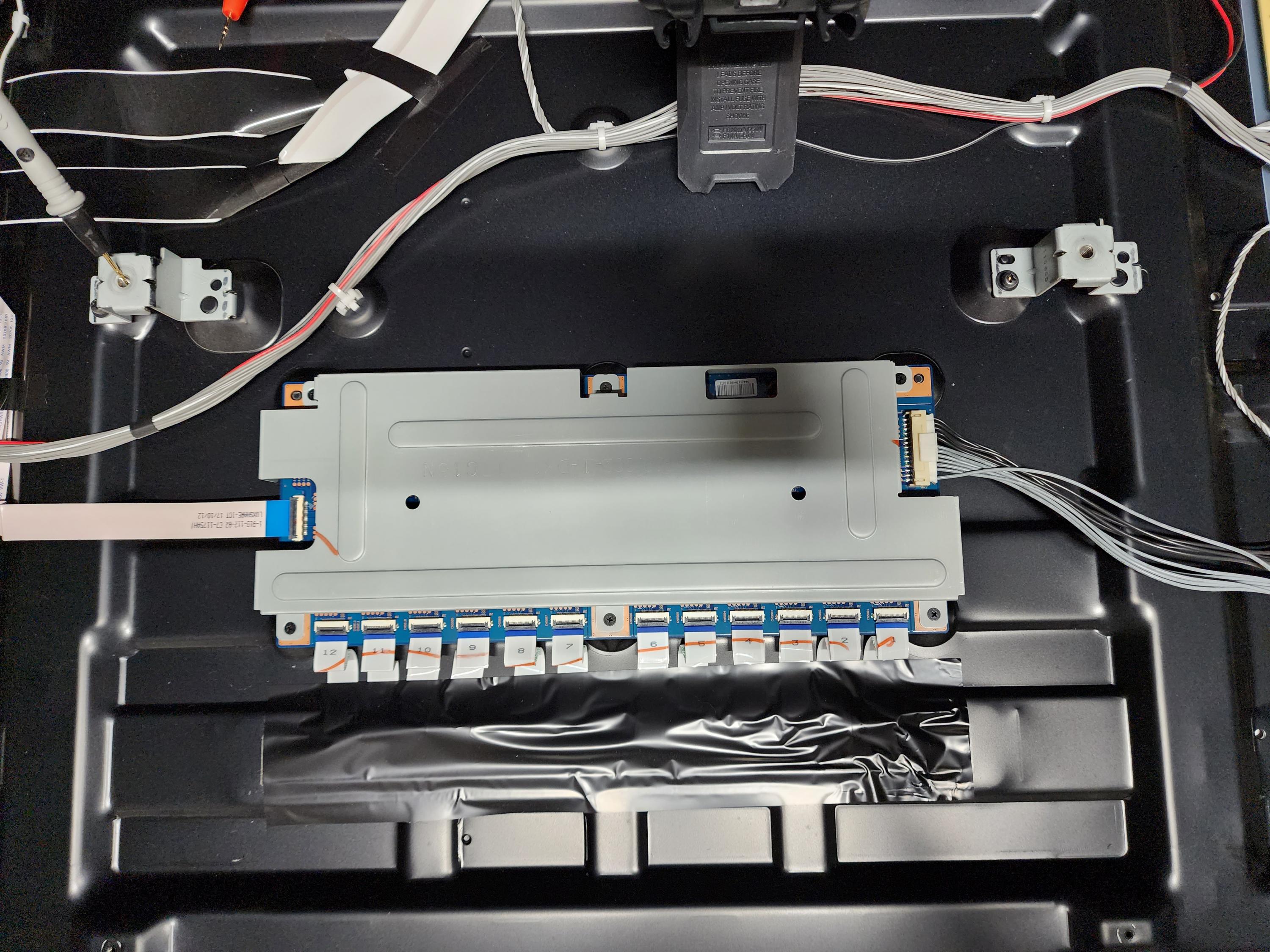

                I've torn apart quite a few. I'm considering replacing a single LED or all of them.. all is $110 though. Although the 75s are very worrisome when taking the screen off. I did it 3x and no break yet but man it don't feel stable.
                I read in another post some guy tried a single LED on these sonys and it wouldn't accept it.. so probably gonna go new route. But will report fix when it happens

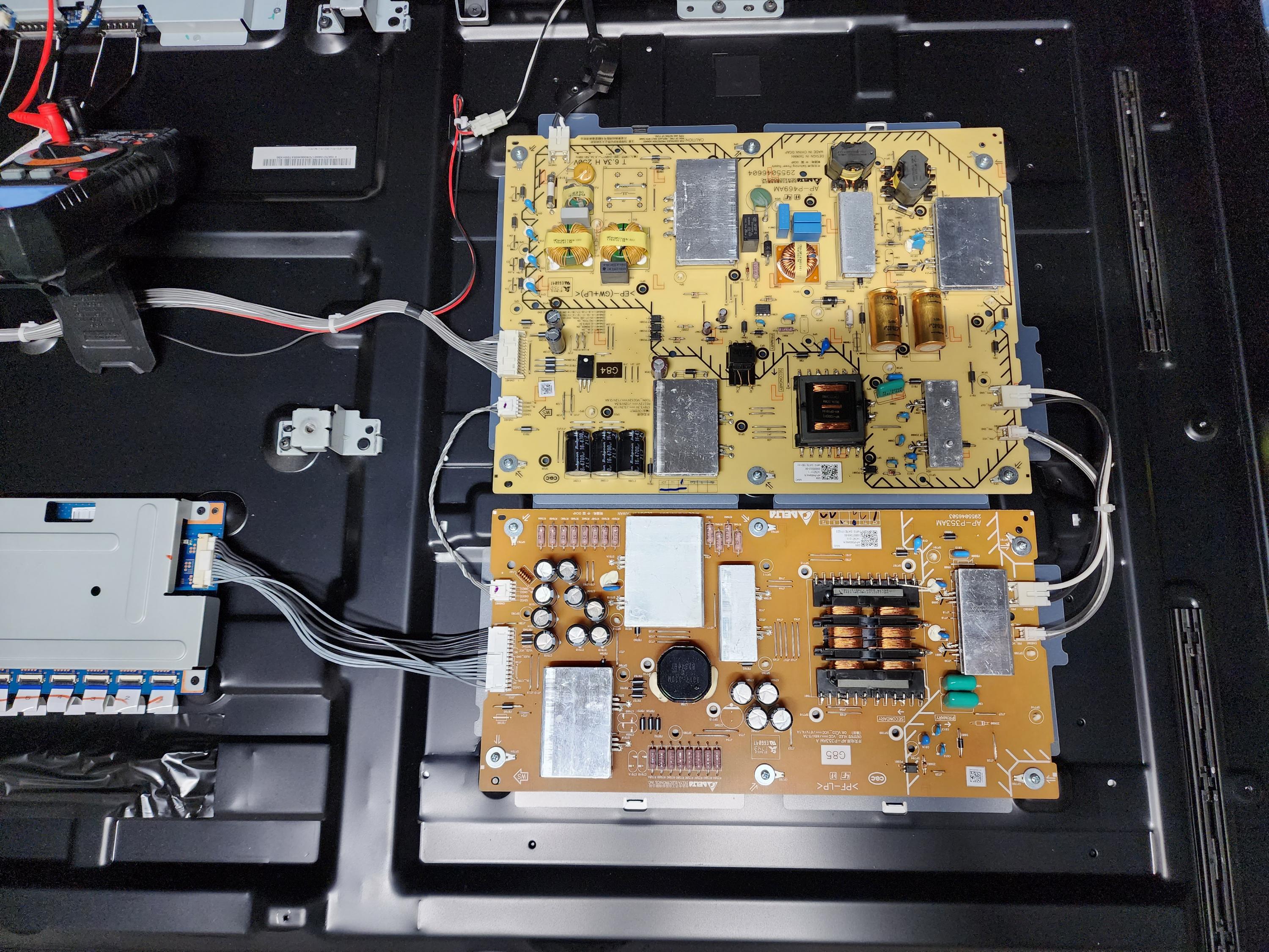

                        I suspect in this type of set leds hardly can fail, the smaller power board is the led power board, i see it takes pfc tension from main psb and transforms it with the big transformer to i guess a smaller tension, check first in the early seconds of tv on the output voltage of that board, check it also on the blue board after the fuse, on that there is i guess also a micro controller, the software on it can be failed also, getting apart so a big tv for testing leds is high risky, all tests on boards are mandatory before.. get the service manual!
                            I can do that, but at what test points? Sorry this additional board is confusing to me. I'm self learning all of this (with this group and internet). Am I looking for voltages coming from main PSU to the LED PSU? There is 2 sets of wires going to it. Or the voltages coming from LED PSU to the LED driver board? Sorry for all the questions.. but I'll try and mess with all voltages I see.

                            • Davi.p
                              Hobbist
                              • Sep 2009
                              • 4258
                              • Italy - Milan
                              the output voltage of the led psu.. photograph also close the ARM cpu on the blue board..

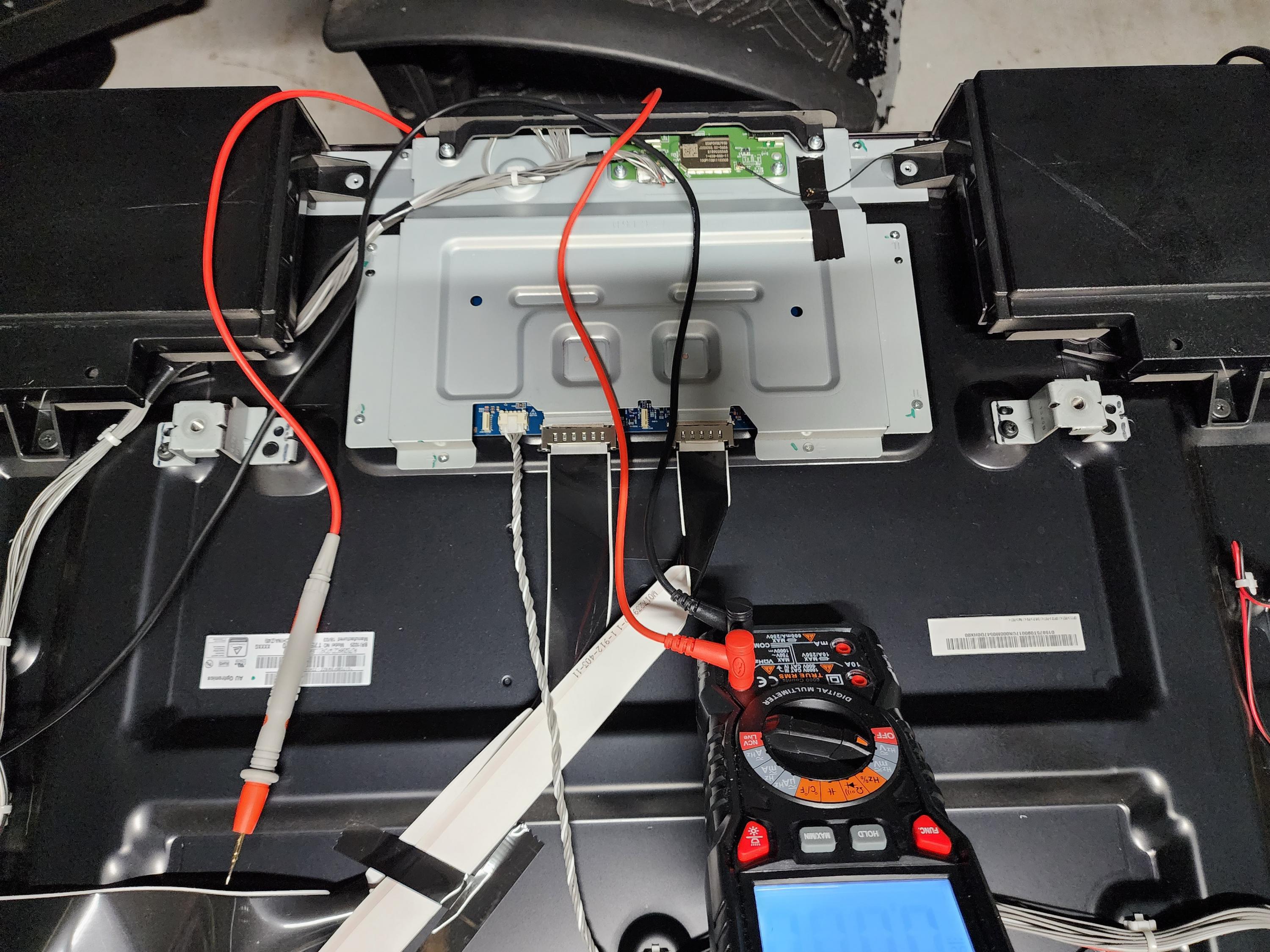

                                    Yes actually and when I grounded it from LED driver PSU to main PSU I got it then to blink 4x. When I did main PSU to LED PSU It stayed 6 blink.
                                    I cannot also get a voltage on the LED driver at the fuse at all. I do get a yellow light on the driver that lights up temporarily and a red one that flashes 3x stops then 3x occasionally

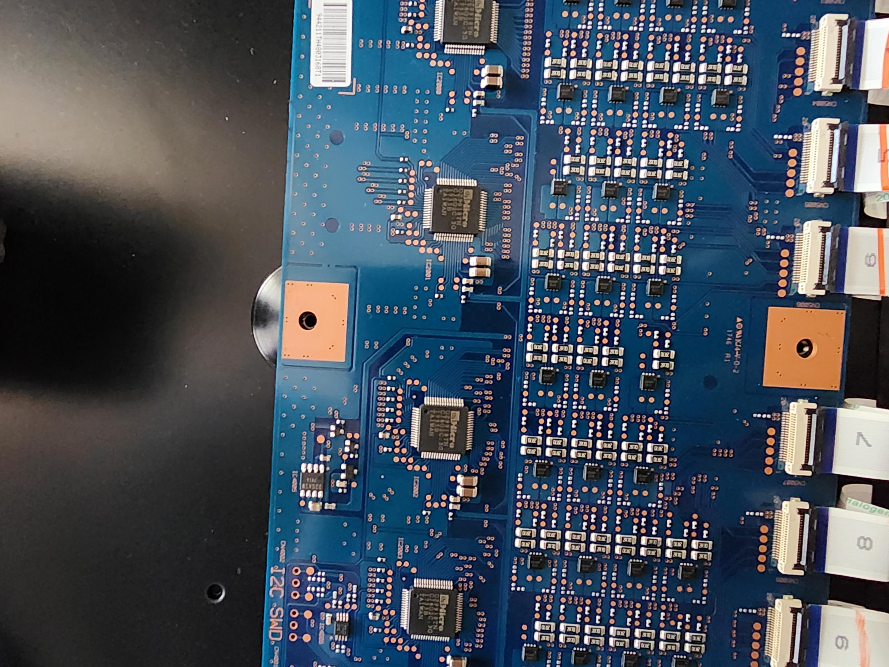

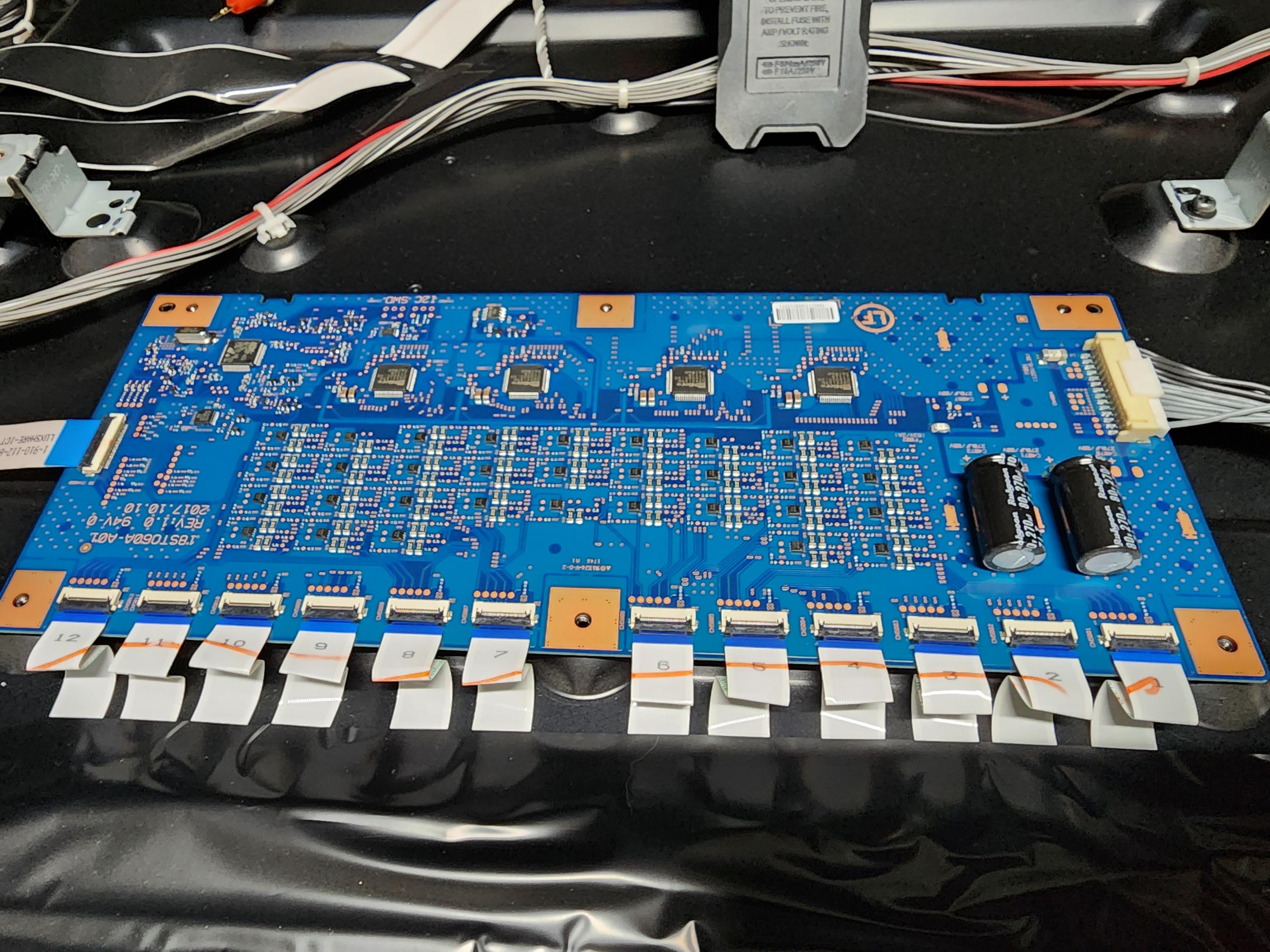

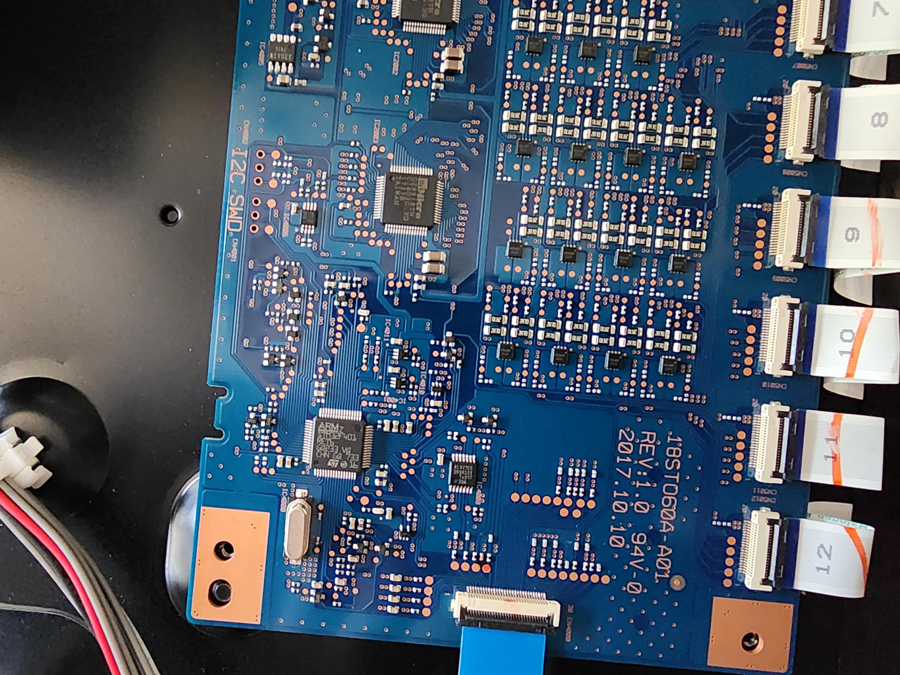

                                    • EazyBone
                                      • Jun 2023
                                      • 1303
                                      • United states
                                      Here's blue board pics
                                      • Davi.p
                                        Hobbist
                                        • Sep 2009
                                        • 4258
                                        • Italy - Milan
                                        Repeat... check the led psu output in the early seconds after power up...
                                        the STM32 cpu can be programmed with a big free software from ST website and a cheap i2c adapter or a ch341a (don't remember), but it's quite hard and is also hard find firmware.. the power on the blue board must be checked in early seconds!!
