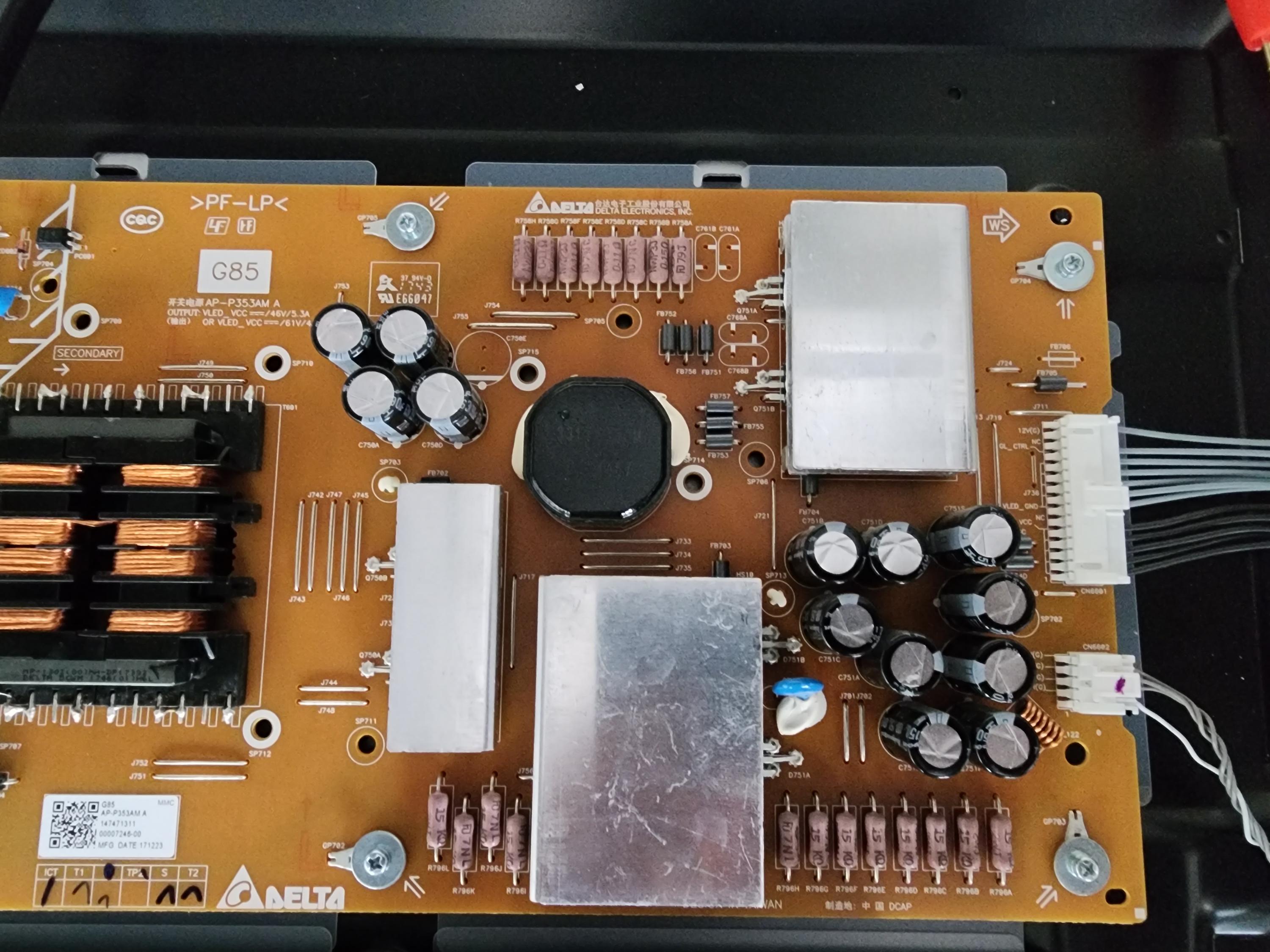

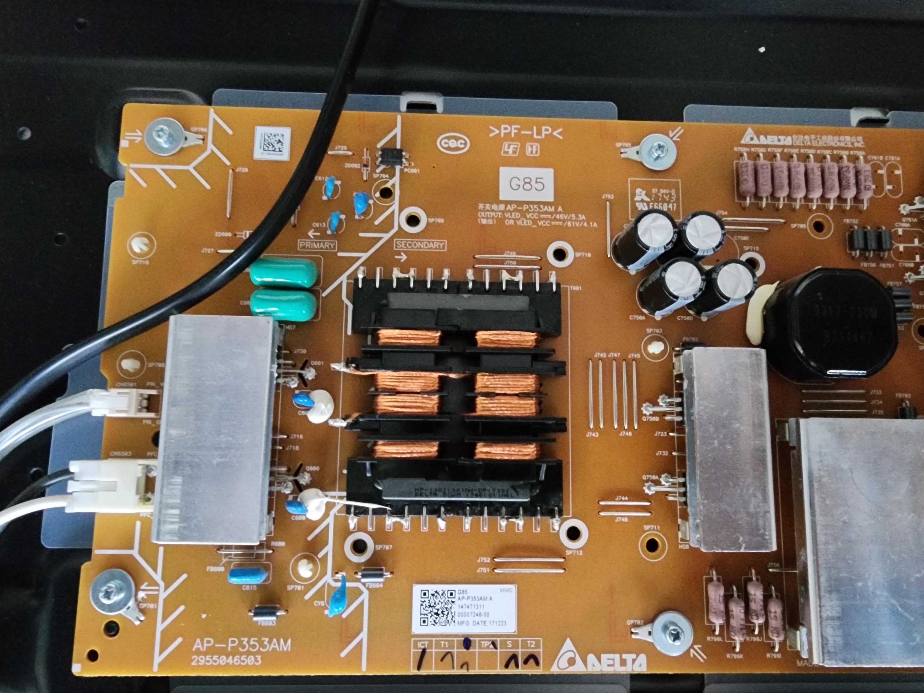

      Repeat... check the led psu output in the early seconds after power up...
      the STM32 cpu can be programmed with a big free software from ST website and a cheap i2c adapter or a ch341a (don't remember), but it's quite hard and is also hard find firmware.. the power on the blue board must be checked in early seconds!!
      So the only voltage that comes out of the PSU LED is 12 V. I plug in the TV and 12 goes to 12 and immediately starts dropping. I then hit power and 12 V goes to 12.74 and stays consistent for like 5-8 seconds and then drops to zero again. No voltage ever hits the fuse of the driver board. Randomly I will get like .050 volts and it'll drop again. But never over .050 so nothing is happening. But the driver board does get 12v. Also pins j752/51/49 etc etc get 33V consistent during the time where 12V is consistent then drops at the same time.
      https://youtu.be/piuV_mBrGv8?si=MTD6fjHgTXEd88Hm
      If I unplug the LED driver from the main board and tcon cables the 12 V stays consistent to LED driver and red and yellow LEDs on driver board flash repeatedly and never shuts down. Still no voltage to the LED driver besides the 12 V and backlights do not come on. But the TV turned on and has sound! But no backlight. So are we on the right track with backlights still? Lol

        The led psu (i call it psb.. however..) is a flyback, forward or similar power supply followed by a 12v dc to +vled boost ps, where +vled is probably about 60/70v (see the electrolitics rated 80v on blue board), depends on the BL leds organization to know how probably them are damaged, since storyteller tells leds are 12v and the basic average voltage is more than 12v, then there are many leds in series, but anyway is somehow a local dimming set, so probably some leds are bad.. also 12v leds are not the best thing as reliability.. since is a local dimming i don't see the reason why a group of leds with a short cannot be isolated.. and the led bars how them are? Probably many small bars, must be checked one by one..

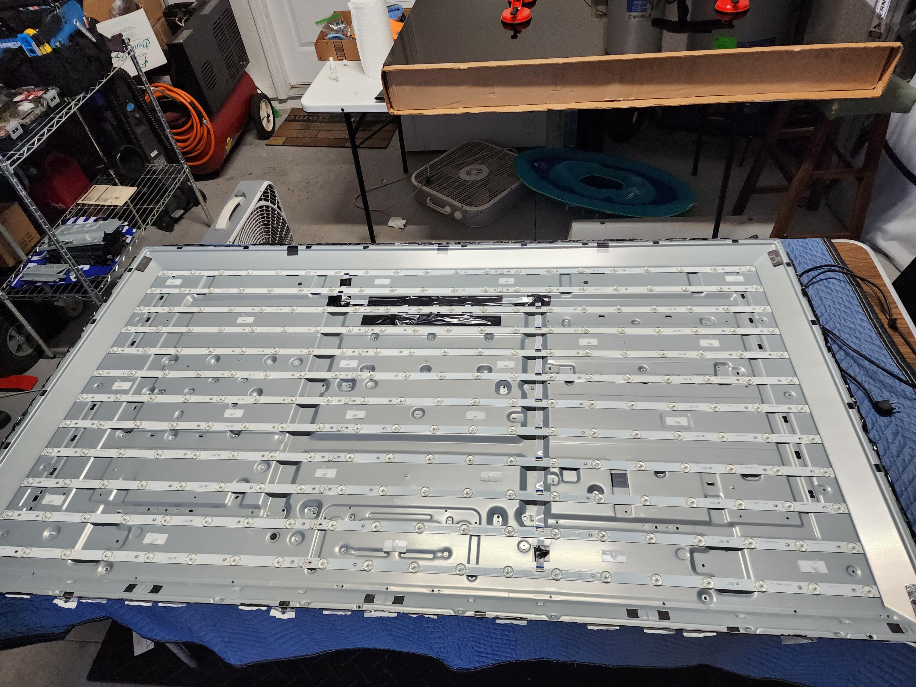

            Well here they are in glory. I checked them all with LED tester, and I can only get 4 to light up at once lol this TV is a beast on power. I have not found a bad LED with the tester. They all light up. I get the LEDs today. Is there something I should do to test them further..? Cause shiiiiit.
            Also this is the worst TV I have ever taken apart. It took 2 friggin hours easily and everything is taped down or glued down. Literally everything. It has screws holding the screws in place. It had glue holding the glue down, and tape holding the tape down. Absolutely nasty TV. I had to write a book on how to take it apart so that I can do it in reverse.
            Thinking I'm just going to replace them all anyways since I got the code and I have them.. but what is y'all's thoughts. There's like 200 lights and all are 12v ����������

              Re: Sony xbr-75x900f 6 red blink
              i don't know why so long discuss lead over here and allot of idea..
              you have DM test one by one with Diode mode.... one direction will lit dim.. and reserve way check if there are ziner reading.... if yes... the tester will not discover open or shorted ziner at LED

                my opinion if you were sure of bad leds so an huge replacement was possible, but this way i would personally try to find a replacement blue board..

                  Not sure if I'm doing something wrong but diode mode won't light any of these at all. And when you say ziner, do you mean zener? I am trying to Google ziner and don't find anything. Reverse way zener, as in ohm resistance?
                  When I use diode mode negative to negative positive to positive nothing lights up and just says OL
                  And davi, I may need a replacement blue, but I already bought these lights and I'm not gonna open it a second time so they gonna go in.

                            Actually many of them read below .5 several read .258 only a couple were up to .75.
                            Interesting. Okay well I have replaced all of them anyways as I think it'll just be better since I ordered them anyway. Putting this beast back together. Will share results when done
