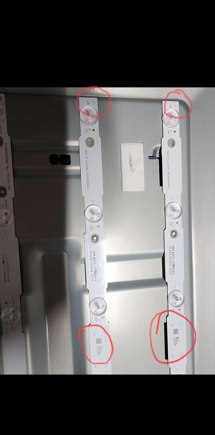

                    #89
                    Re: Sony xbr-75x900f 6 red blink

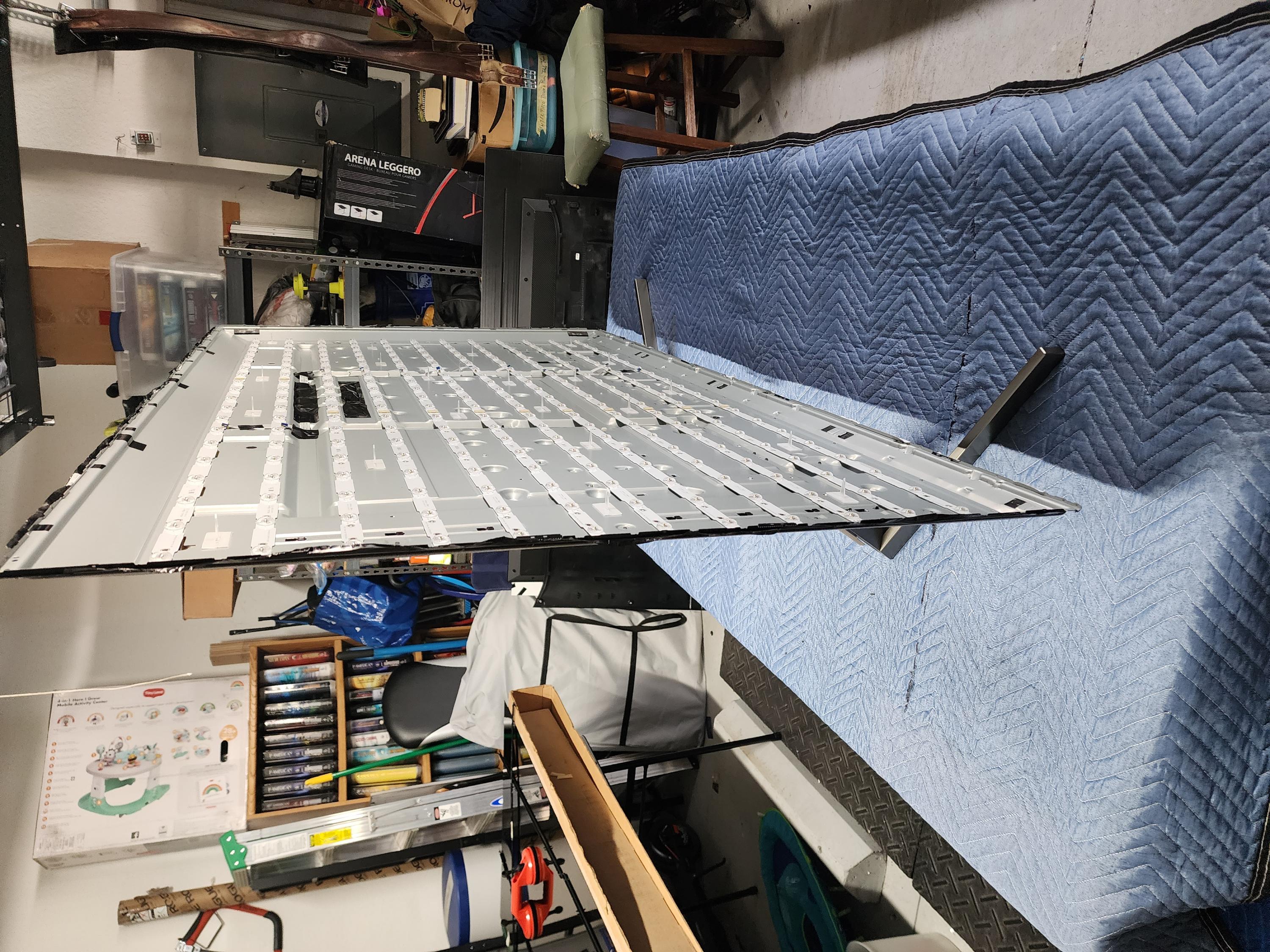

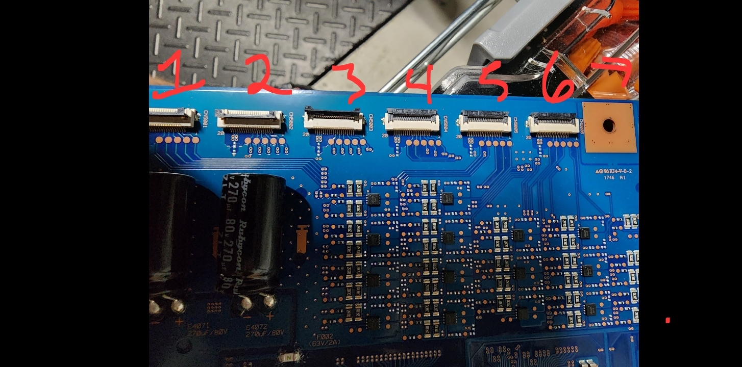

                    Okay diah, I believe you were correct. It looks like these have an order to go in. Problem is I didn't copy the order from the original ones and this doesn't make any damn sense at all. Each side has different numbers and I need to decode the order. Maybe you can help. So each one has a labeled number but some are duplicates. The only other difference is a different number on the stick so I will put right side with number and left side with numbers. Help if anyone can
                    Right side
                    1-709
                    1-835
                    2-710
                    2-836
                    3-837
                    4-838
                    6-714
                    7-715
                    8-716
                    8-887
                    9-888
                    9-717
                    Left side
                    1-738
                    2-737
                    3-547
                    4-735
                    6-733
                    6-661
                    7-732
                    7-660
                    8-731
                    8-659
                    9-730
                    9-658
                    The cables go from the bottom to the top. The bottom cable is 1 and it goes up to number 10 then the last two top cables (from LED driver) are 11 and 12 but they are flipped over. I do not have a picture (I didn't know this was a thing) other then the one shown from original LEDs.
                    How in the hell do I figure this out??? Anyone

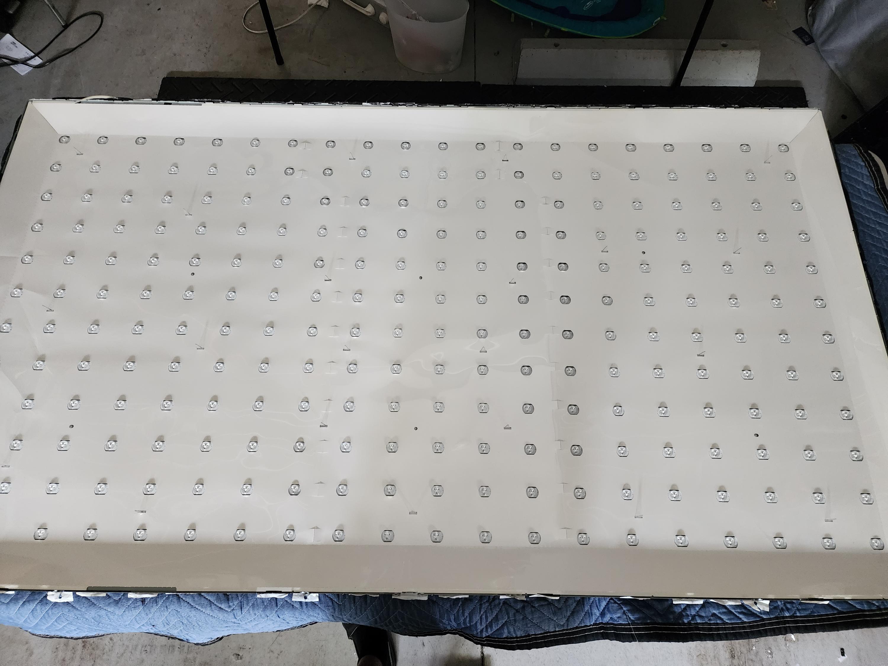

                    • EazyBone
                      • Jun 2023
                      • 1353
                      • United states
                      #90
                      This might help to help me? Trying to read myself

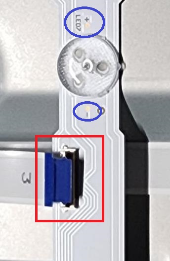

                              #94

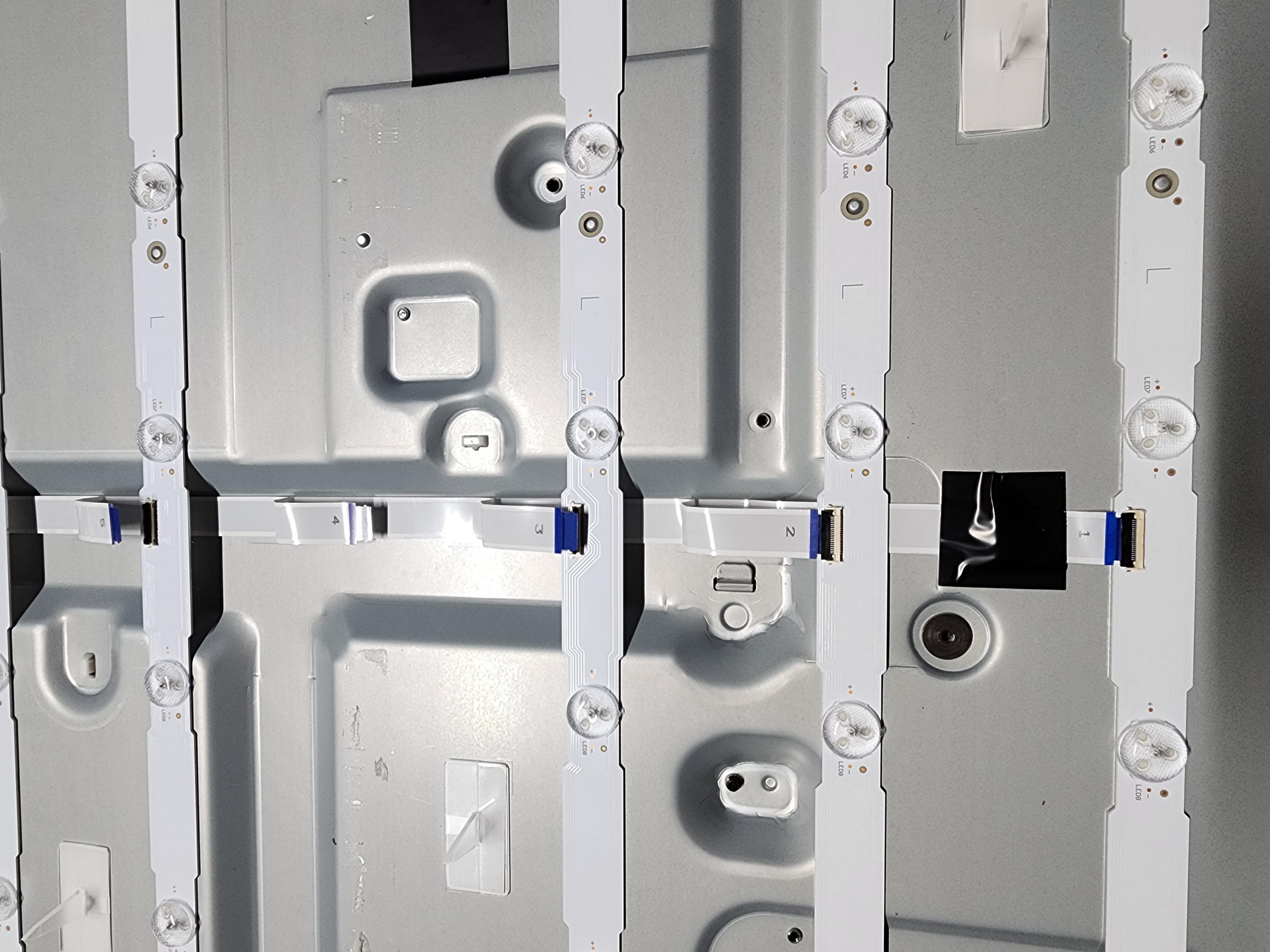

                              you make it over here like Salad ..LOL
                              take A4 paper and drowing the left strips and right one too to show the lines on the strips ( Red color )
                              1- check if all left side are identical and right side too.
                              2- follow the line to check the last LED unit + an which pins at socket goes. as well the the first LED unit - an which pin goes. do the same all LED + - ( blue color )on one strip complete left and right... you will understand how the LEDs on one strip divided as groups.
                              also please show me the white paper reflector sheet complete to see the hols on it
                              • Diah
                                • Feb 2013
                                • 6437
                                #95
                                do you have 20LED at each strip L&R, its means to me as you have 5 LED+ so each 4 LED are one group, V round 12V in total.. not as some where i read written 12V LED LOL
                                take out the strips 11 12 the flipped One. and let them in connected as other ( doesn't matter how they will be even if out side the chassis ),,, then turn on the set let see what will happen

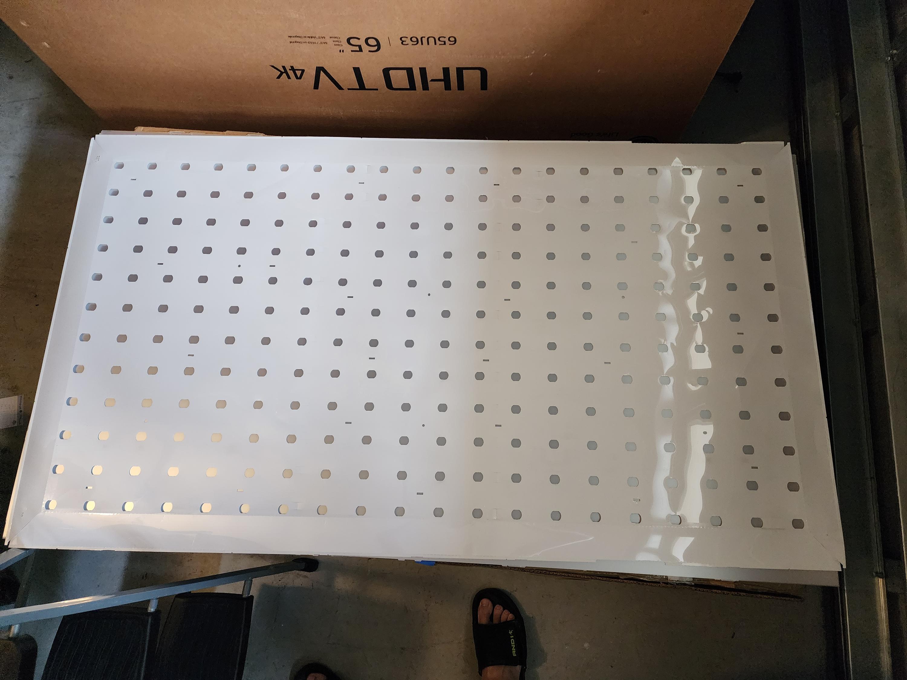

                                    #97
                                    Originally posted by EazyBone
                                    Will do this later, the seller says order doesn't matter at all and the numbers are just random batch numbers. Will check this later!
                                    it make no sense for me.. 2 strips flipped - &+ , however the LED driver boards circuit are same as other 5 LED+
                                    let see the reflector sheet the holes on it will tell us more

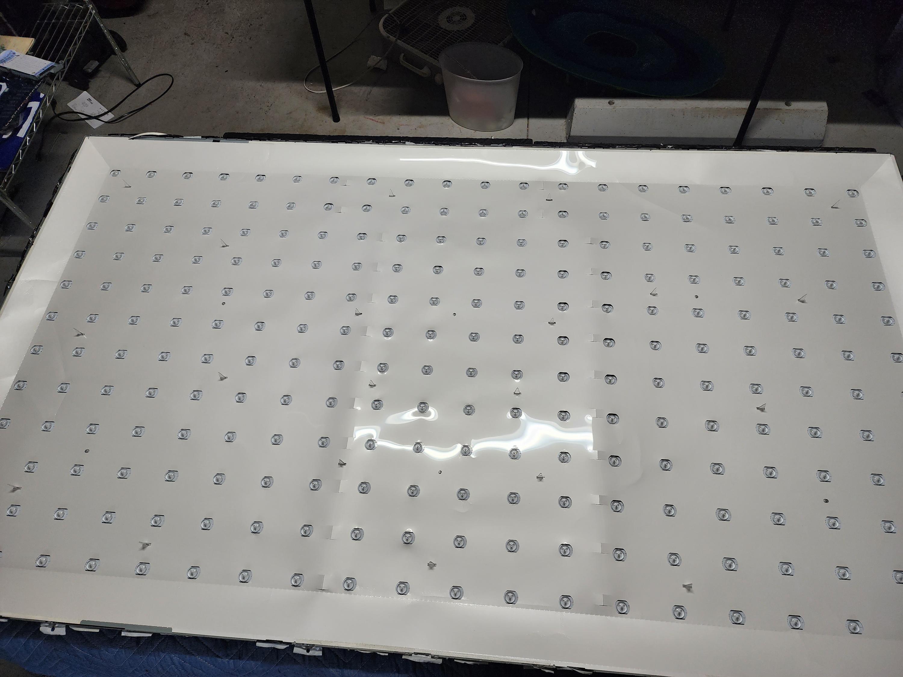

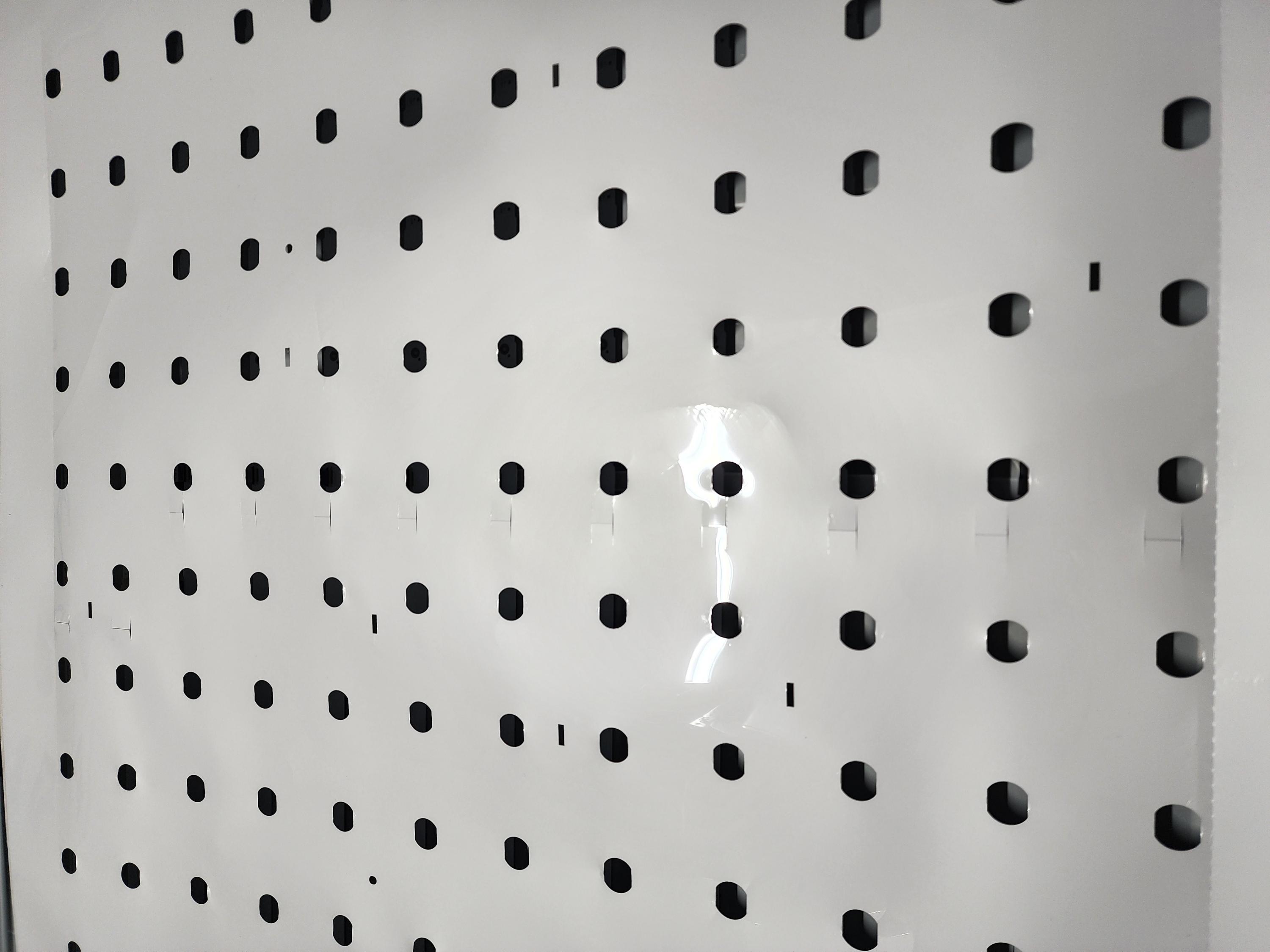

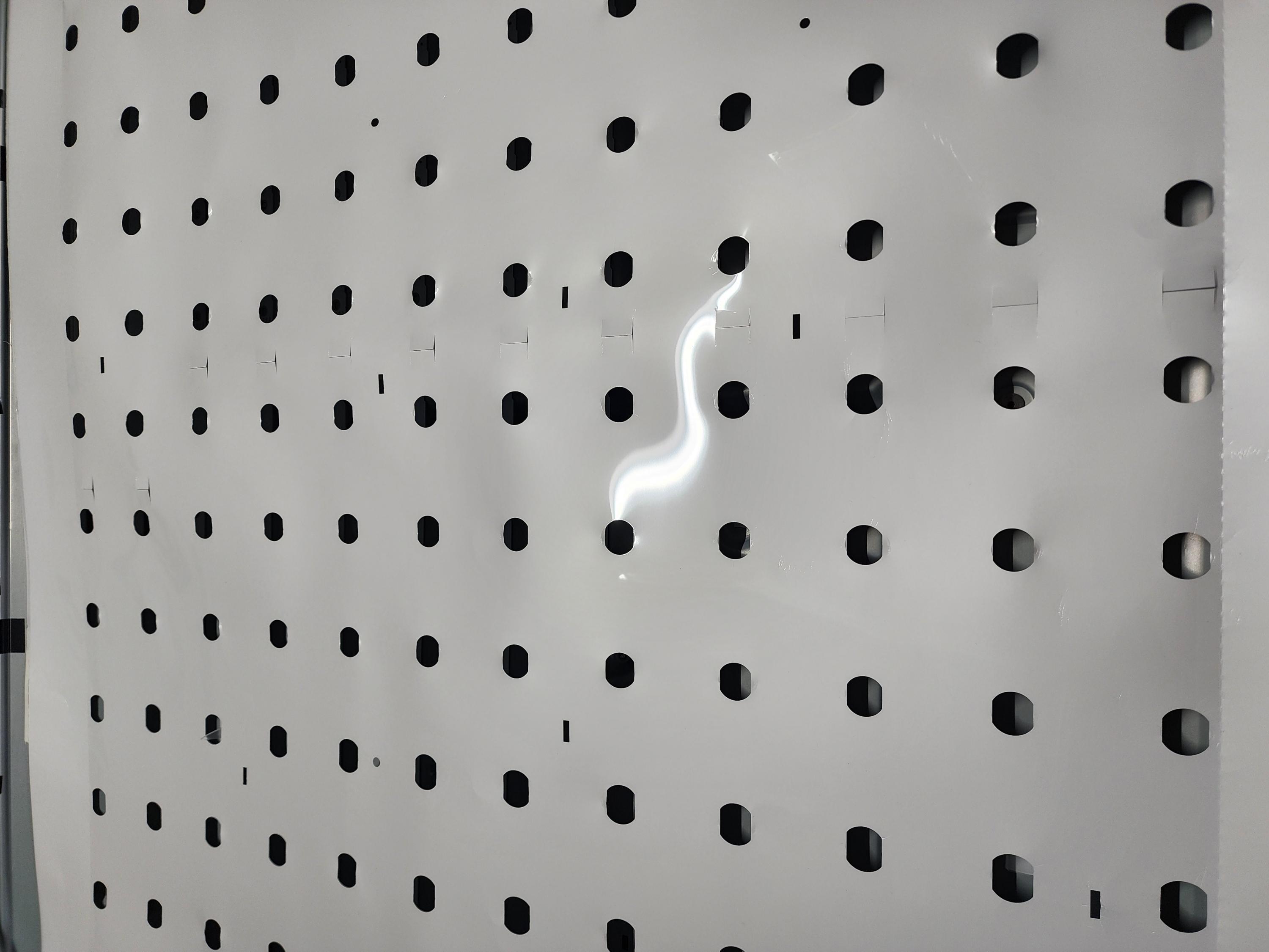

                                    • EazyBone
                                      • Jun 2023
                                      • 1353
                                      • United states
                                      #98

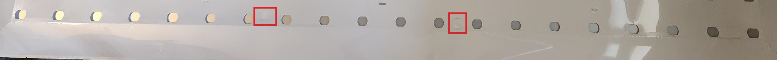

                                      Here's quick pic
                                      • Diah
                                        • Feb 2013
                                        • 6437
                                        #99
                                        Here's quick pic
                                        so 1- you have the standing leg still in chassis mounted... how it come and the sheet out ??? all of them should be out to let the sheet sitting and legs standing will tight the sheep in place
                                        2- however the photo not good enough.. but marked the 2 hols on one strips line... one for cable sockets and other for L & R joined socket..
                                        with hols position you will know which are the top and down... and how the strips should mounted.

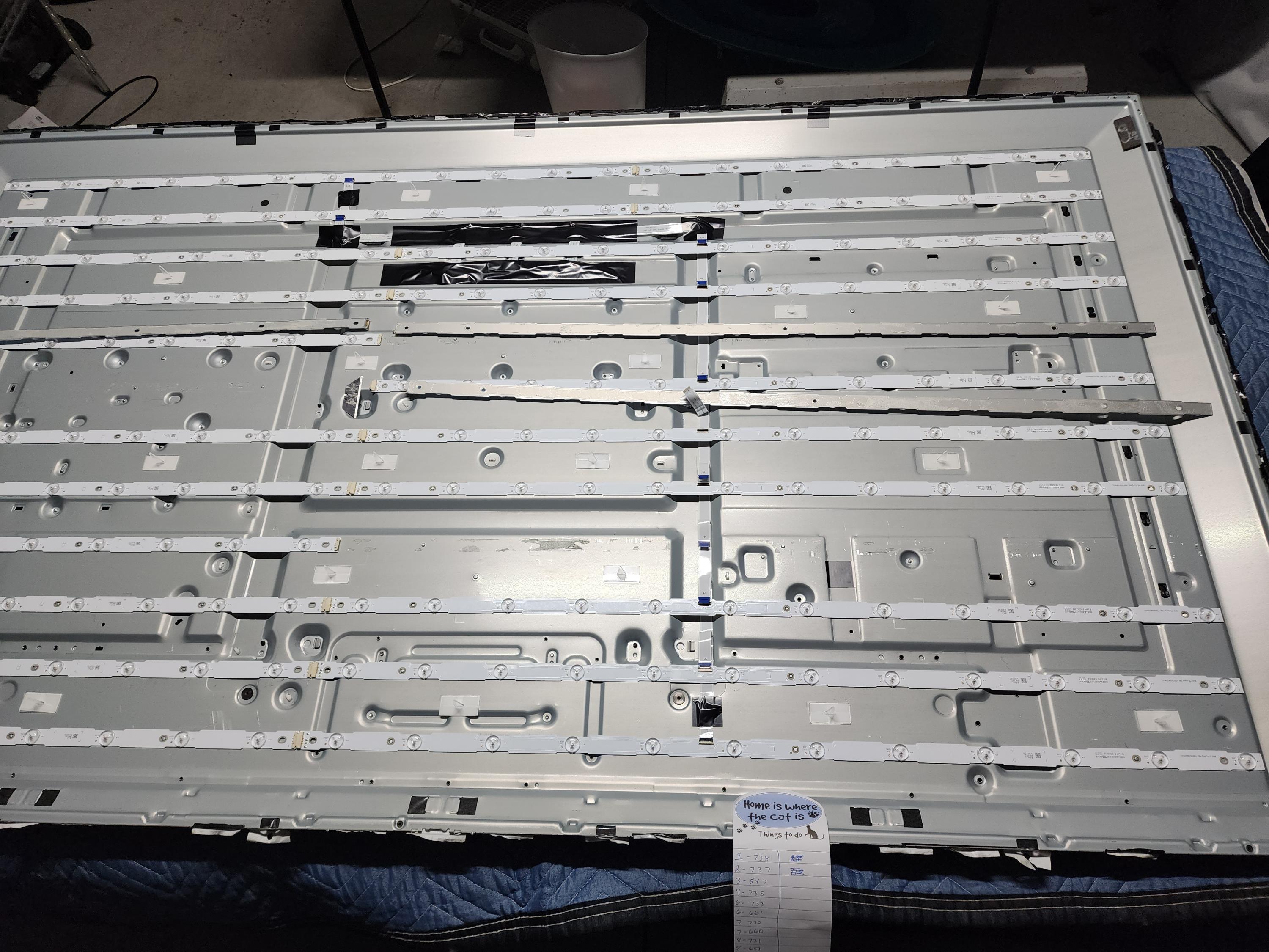

                                        • EazyBone
                                          • Jun 2023
                                          • 1353
                                          • United states
                                          #100
                                          Here's more pics, the lights appear to be all the same lights. There is just left side and right side. Everything looks normal and manufacturer says they are all the same, the numbers don't mean anything apparently. The sheet only has a sticky tape around all the edges, other then that it just lays flat down and doesn't move.
                                          And yes one for cable soc and one for l and r joined.
                                          I have TV up on legs now so I have access to both sides at once.
