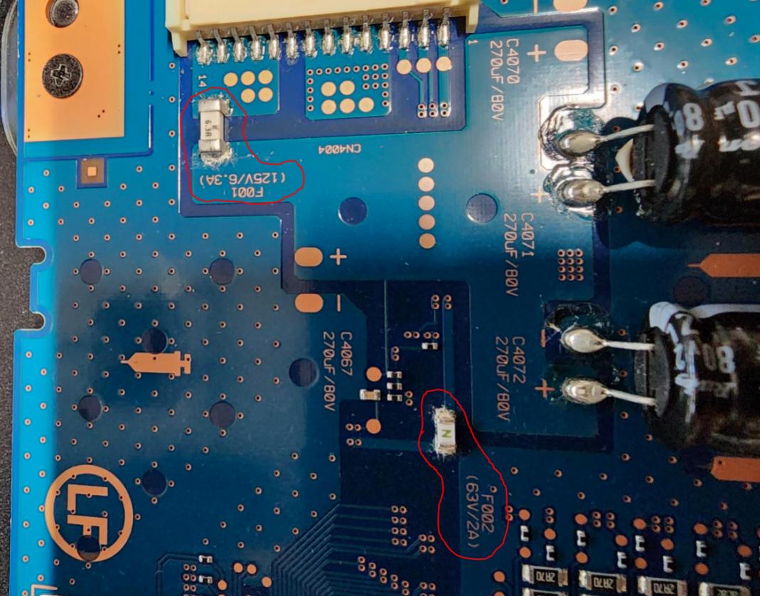

                Is this N thing a fuse also? Looks like one to me, no continuity on it.

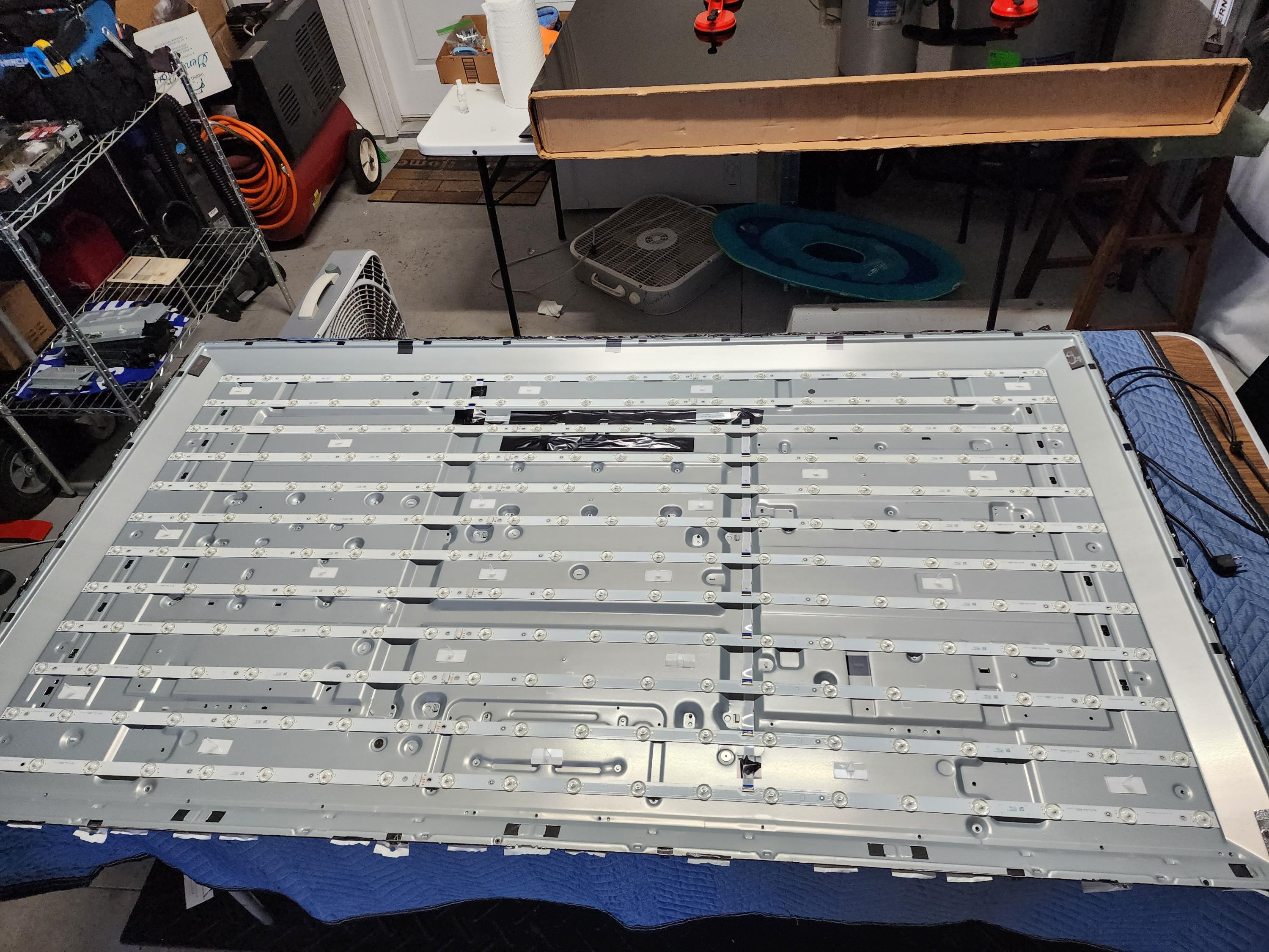

                    Have you replaced the backlights with new strips?
                    If the screen is still out you can unplug the lvds cable going to the blue board and power up the tv. It should cycle the backlights in a test pattern. If backlights are all good they stay lit after the test. If bad they will cut off after test.
                    I usually record a video of the test pattern so I can watch and see what led is not working. Usually it’s only 1 led that causes the error.
                    Sonys are very finicky with the voltage and current the leds draw. I tried to temporarily wire 4 3v leds to test the one light out and still got the error untill I replaced with 1 12v led for Sony TVs

                        Re: Sony xbr-75x900f 6 red blink
                        Backlights are new strips. New ones and old ones all tested fine with LED tester. When I tested them all with LED tester they were all working properly (but LED tester as people said may be unreliable) but they all lit up. Replaced them anyways just because.
                        And story, do you mean the lvds cable from main to LED driver? Because I've done that and nothing happens different. The LEDs never get power. No voltage ever turns on from the LED PSU ever.

                          #52
                          I think that N is a fuse, that would explain that board being dead.

                            #53
                            Also Sony, I watched that video, looks like he is replacing the IC for the main board ? DPS board? I can't Google what that stands for but I found what appeared to be in that video and tested the caps and they were all good
                            Ok, looks like it's the sub powerboard.

                              #54
                              If it is a fuse, it has no continuity. And could have just been the problem the whole time lol.
                              Also no matter what kind of connections etc I disconnect or any variation of cable disconnection the power board always throws the BL err 3.3 volts no matter what. I have even grounded it per the video and it doesn't have the error then, but it still doesn't work.
                              Diah I have tried all those cables and combinations of those cables and nothing changes. But like I said that N component which may be a fuse has no continuity.

                              • Diah
                                • Feb 2013
                                • 6335
                                #55
                                are you sure installed the replacement LED in correct order... if you look on the old one the end and abegin of the strips how many lines you have... 4 line mean they will work only in exact order... like Hisense... one group not only at same place one or 2 LED from other strips will light on too
                                so gow us please the strips end of the old one

                                  Think it's got to be a fuse, they are designated F or N, only other N designation I know of is a resistor network component and that sure doesn't look like one of those.
                                  • lotas
                                    • Jan 2016
                                    • 4451
                                    • Russia
                                    #57
                                    "N" - fuse 2A

                                      #58
                                      LOL, thanks Lotus, I didn't see that label over there.

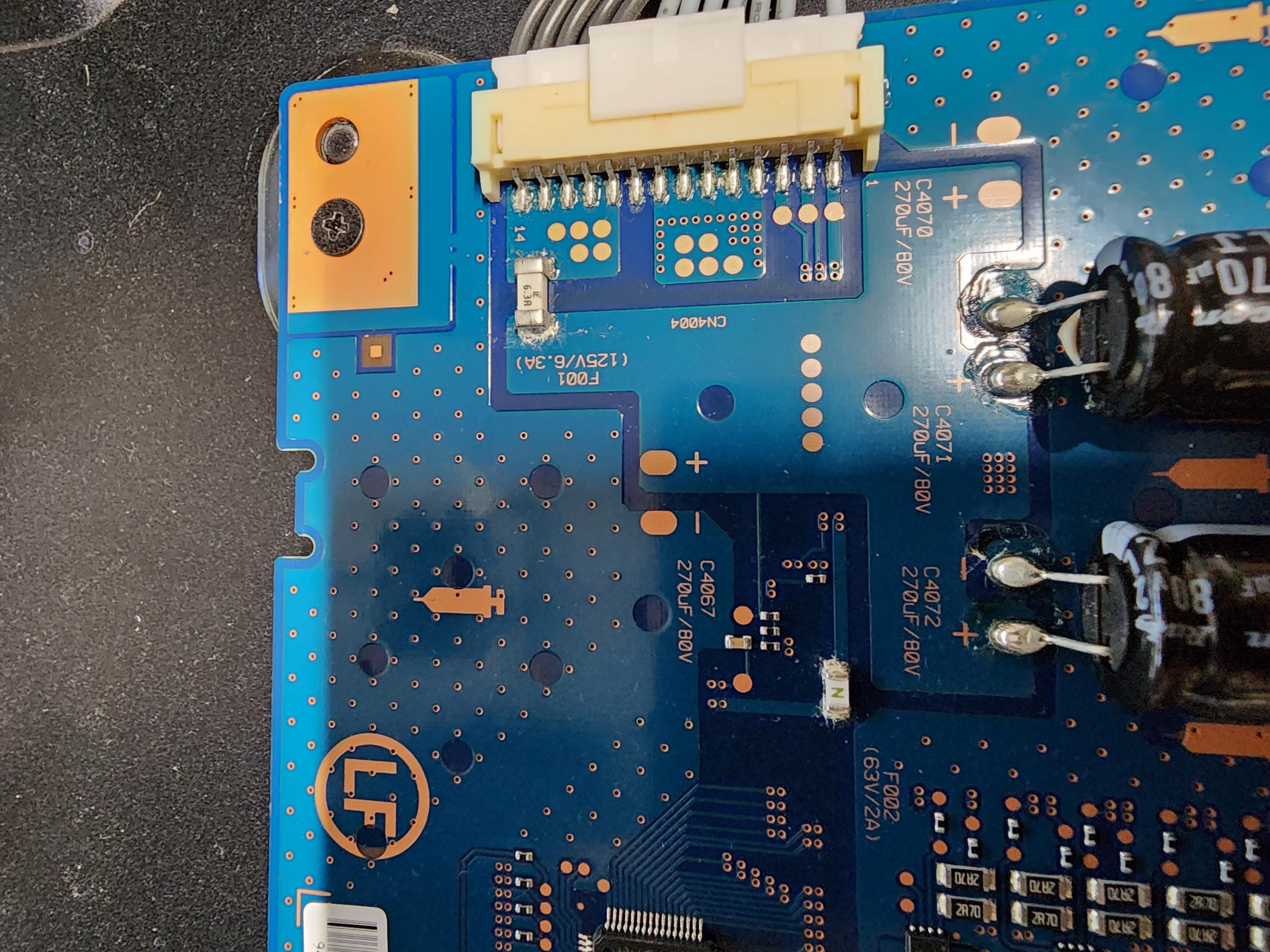

                                        #59
                                        Man I amaze myself sometimes. That N fuse is good. The solder joints are all messed up and wasn't making good contact. It now reads fine. Blowing my mind here.
                                        Uh diah, I don't have that anymore I tossed them since they were all messed up. None of the strips were different that I know of, they all looked exactly the same. They all also were tested and in-between connects too to see that they would light up. I have no idea how to test them from the ribbon cables driver side.
                                        So the answer is I am unsure if they have it.
                                        Here is only pic I have, would you be able to see the end of it from that pic?

                                          #60
                                          Check all the solder. Do you have voltage on your blue board now, going in and out?
