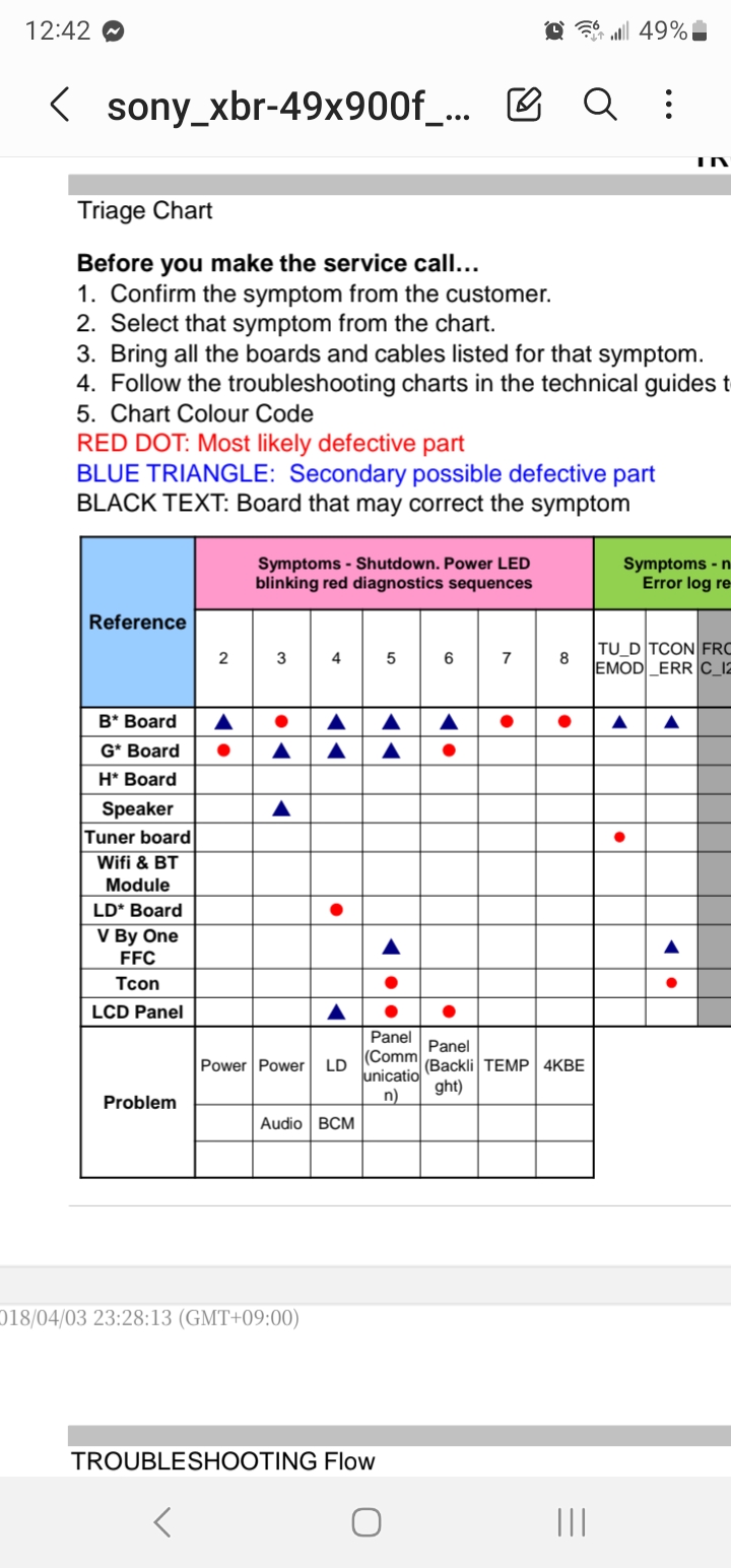

    the persistance of 6 blinks is either bad strips or bad backlight circuit, but i guess is the first, so why don't try the same my advice?
    Thanks...I tested the strips before install and they all worked, so as we in America would say: I assume they are good.. So now I need to figure out, per your advice, how to test the backlight circuit that you mention.
    I am a novice to this, although I have experience in computer repair. I am also reading a Sony Training Manual: AZ1L Direct View LCD Television Chassis Course: CTV for ideas,

      6 blinks was not bad LEDs for my Sony. It's bad power board. I tested all lights before removing and they all worked. I replaced anyways because of comments stating it's bad LEDs. New LEDs all worked and still 6 blinks. It states power board for my TV. My TV had 2 power boards. I would look more closely at that because this advice led me astray also.
      Says most likely power board or panel. Then says replace main board. This is for 900f though so I'd look into that. The new problem you have well I don't know. Just do due diligence into PSU checking

        A normal backlight tester is not good enough to test leds with small leakage, if you think i'm saying stupid things i don't know what to do, if you want my help you can simply follow my advices, testing a psb is not as easy as my test.. anyway if you know the ohm's law and you are rich in power resistors arsenal you can put some and simulate the leds, hoping you have psb specs
            I appreciate your assistance, I DO NOT THINK you are saying stupid things, never said that or inferred it!
            I'm very handy, but know little about the actual fine testing methods you describe.
