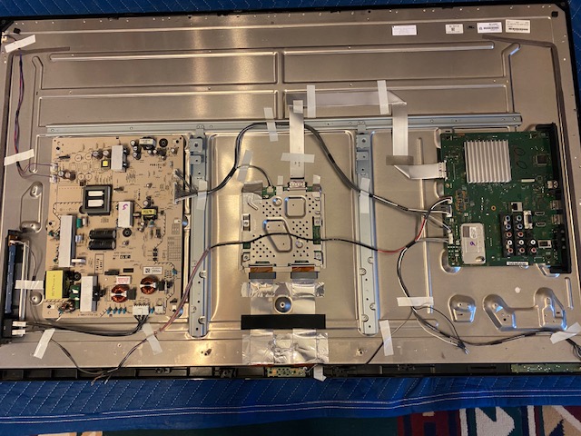

    Hello all, yes I am new here and appreciate any assistance in troubleshooting this TV. Picked it up from my son last night, turn it on and all you get is the blinking red 6 times light.

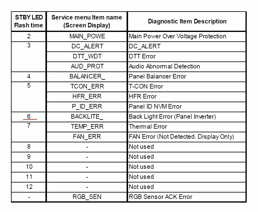

    I have begun looking at the Sony Troubleshooting manual that I found in a post here. Initially one would think that its the backlight but in the the troubleshooting guide page 16, it states that (6X blinking) is caused by a failure of the converter circuit. Replacement of the power supply board is necessary.
    The flowchart on page 17 indicates that it would be the GE2B board.
    So as a novice, I am sure that Sony's have known issues and regular cut to the chase malfunctions. So I am seeking any guidance into leading me to the issue with this TV. I have yet to open it and look for any obvious issues on the board, so any help would be appreciated.

    So here is exactly what it does. Tv turns on, Sony logo appears then disappears. Starts again, Sony logo appears, then disappears for the second time and TV then blinks 6 red lights.

      Try a simple reset, unplug tv for 5 minutes, press and hold the power button on tv for 30 seconds, plug tv back in and try it, probably won't fix but easy enough to try, could be bad backlight/s or backlight driver. There's a few things to try there: https://automatelife.net/sony-tv-red...nking-6-times/

          bad leds
            Re: Sony KDL-46EX700
            Code error "6".
              OK so 4 new led strips is what I am hearing you guys say.

                      So after replacing the 4 LED's, this is what I have now, comes on show this and goes blank. 6 blinks red light

                            SO I had a bad flex cable connection. The screen is normal again, but TV still turns on then quickly off. I am seeing some kits on ebay that have transistors and resistor that claim should fix this kind of issue. Or I can buy a used power board with 30 day warranty shipped for less than 50.00 bucks.

                                      Warmed the board, no change. Turn power switch to ECO, hear relay click, push power button: Green light comes on, Sony logo briefly appears and goes away. Cycles once again, then red light on front comes on, then blinks 6 times.
