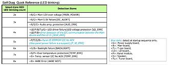

    Sony KD-49XF9005 it power up to android boot screen and turns off immediately with continuously 4 red blinks

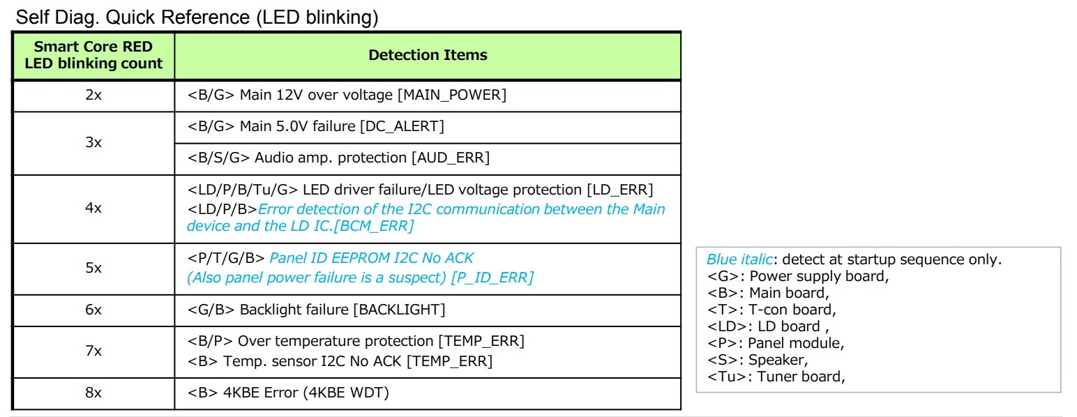

      I2C communication

        thanks for reply but i know its a backlight error
        i only need to know where to find a (BACKLIGHT ERR) PIN in the board connector to solder it to the ground for bypass the protection of the backlight failure

          if you add some clear pictures it will be easier to help you

            Here you go:
            https://ibb.co/5g4rhk2V
            (pin #27 on LD board - connector that goes to MB)

                sorry brothers for the my late response..i know my post is missing pictures that is bcs i'm not in the place where i have the tv...
                anyway thank you tiki66 for your response,it works for me and tv works greatly either​
