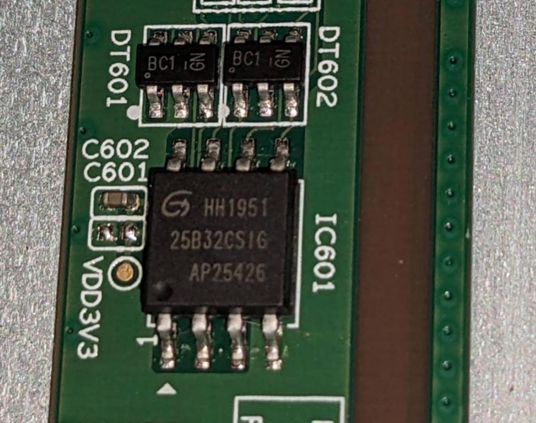

Samsung QN75Q60TAF Boot Loop fixed but no picture

    Re: Samsung QN75Q60TAF Boot Loop fixed but no picture
    Leave it off and remove the other one.

      Originally posted by Nicktronic
      Diah, I removed IC601 and everything else connected normally, mask removed and the boot loop is gone. The TV boots up, I hear the little samsung jingle and no picture.
      write the label No of this IC
      • lotas
        • Jan 2016
        • 4859
        • Russia
        #63
        Originally posted by diah
        write the label no of this ic
        gd25b32csig
        • Diah
          • Feb 2013
          • 6562
          #64
          Originally posted by lotas
          gd25b32csig
          GD25B32C I/O NOR Flash..
          he need first to check with Diode mode between pin 8 VCC and pin 4 GND

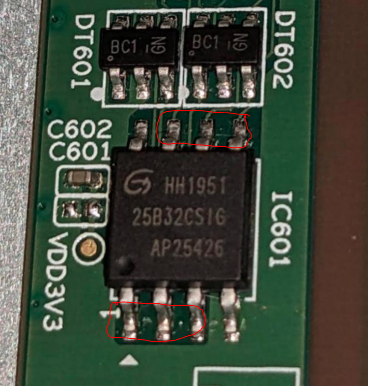

          • Nicktronic
            • Mar 2023
            • 247
            #65
            1.727 VDC - Neg lead on 4, Pos lead on 8
            0.557 VDC - Pos lead on 4, Neg lead on 8
            No beeps
            • Diah
              • Feb 2013
              • 6562
              #66
              No beeps
              its low to me..
              try to dump it hope yours programmer can read it.
              if it did... mean good sign

                      • lotas
                        • Jan 2016
                        • 4859
                        • Russia
                        #71
                        What is the resistance on these pins (1,2,3,5,6,7) relative to 4 pin. (GND) without ic601?
                        • Nicktronic
                          • Mar 2023
                          • 247
                          #72
                          They are all open to GND
                          • Diah
                            • Feb 2013
                            • 6562
                            #73
                            don't take any parts out from the boards... buy cheap programmer and test the NOR you get it out
