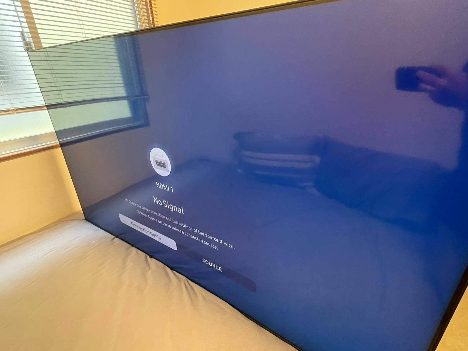

                #187
                Re: Samsung QN75Q60TAF Boot Loop fixed but no picture
                Originally posted by lotas
                Remove DT601 and DT602 and all of them are not needed, they cause more problems.
                After removal, check to turn on the TV without spi and 601, 602.
                No difference, boots up, samsung jingle, backlights on, no picture

                      #190
                      Installed both the new SPI flash and the diode packs. Same result. I'm done with this TV, it's going to the recycling depot.

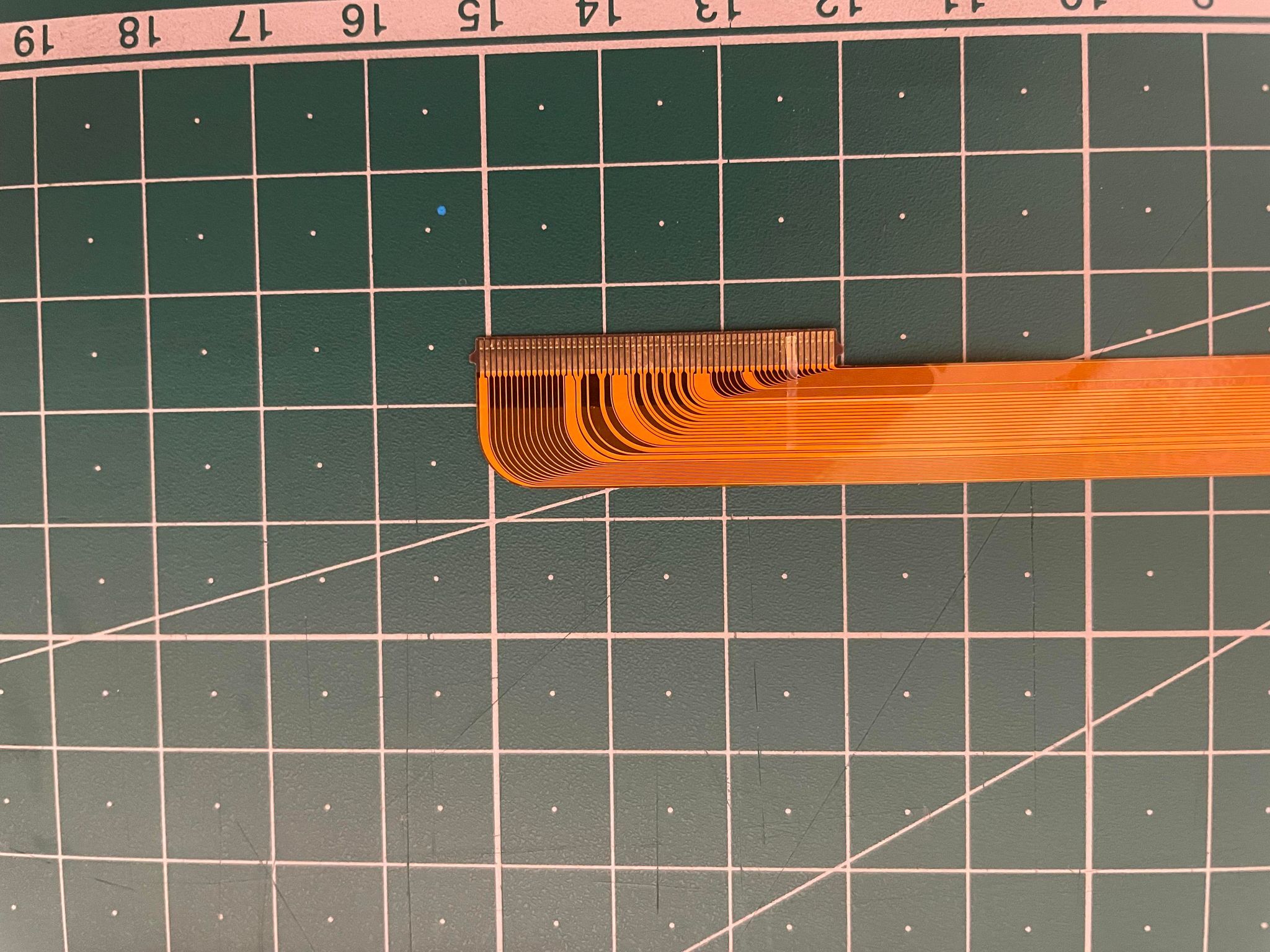

                              #194
                              I also have the Boot Loop issue with this exact same TV, the QN75Q60TAF. After reading through this forum and the "SAMSUNG UN50TU8000F rebooting, backlight ok. No 12v to panel boards" forum, I got the TV to turn on with image and everything, but a bunch a reddish horizontal lines display on the screen. The lines are not too noticeable, but they still affect the quality of the image.
                              I was able to fix the Boot Loop by masking pins 7-8 on the flex cable that connects to the right side buffer board, but I can't get rid of those reddish horizontal lines on the display. I have tried checking all the caps with a multimeter, I have tried injecting voltage into the board to find a short, and I have tried to follow the rails to find the issue. Unfortunately, I haven't been successful.
                              I would also like to mention that I don't have a lot of experience troubleshooting electronics, but I have a solid foundation in electrical systems. I have also tried to find the schematic for this TV, but I have been unsuccessful.
                              Any information that helps me solve this problem would be greatly appreciated.

                                #195
                                did you trace the pins 7,8 where they go... to the end of buffer boards.. there may ESD diode shorted
                                also with out this U ribbon cable you will have 3/4 screen... did the line remain showing or disappear

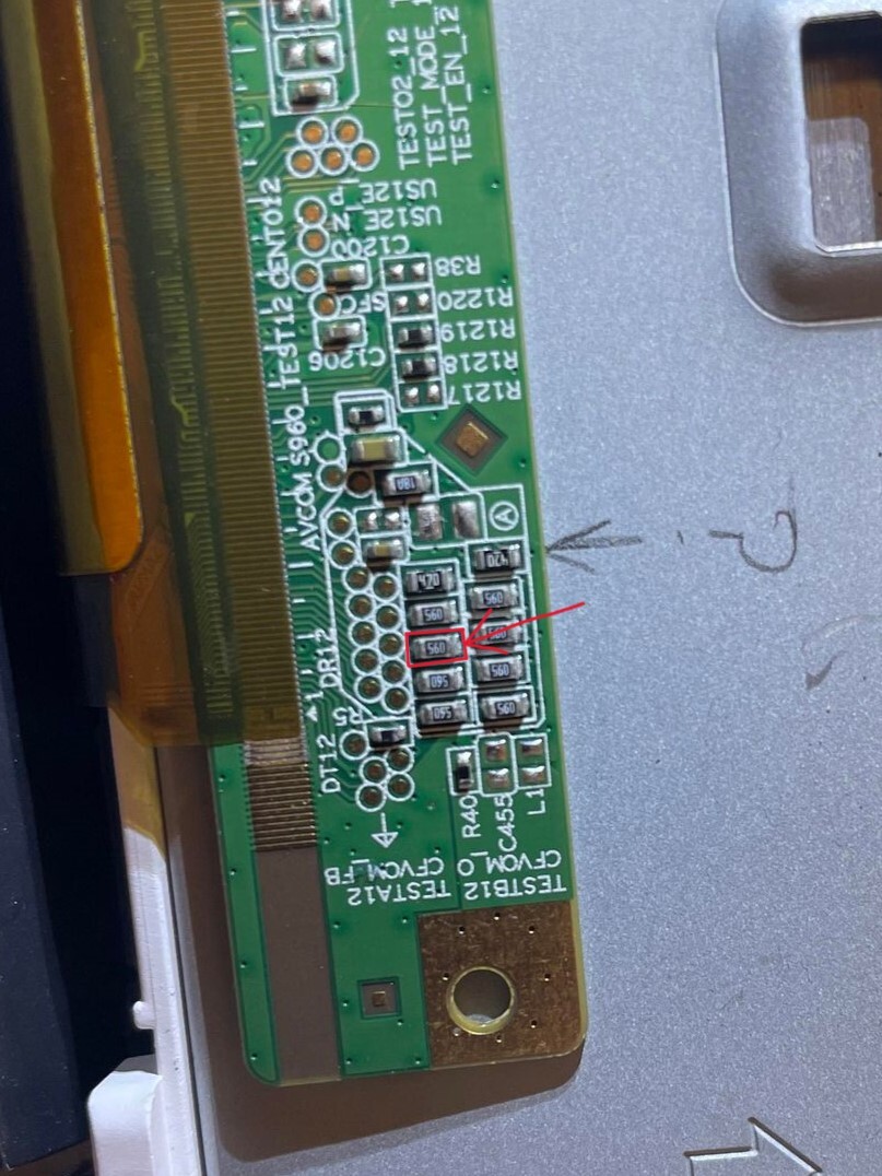

                                  I was able to isolate the issue down to pin 7 specifically, and I was able to trace it down to a 56-ohms resistor at the end of the buffer board. You can see the resistor in the picture attached marked with red, and pin 7 is connected to the side pointed by the arrow. I checked ohms across the resistor and it reads good.
                                  I tried to find where the other side of the resistor led, but I wasn't successful. Also, I did as suggested and disconnected the U ribbon cable, and the lines disappeared that time.
                                  I am not sure if I should try to re-flow/replace that resistor, or go down another route. Thanks for the suggestions.
                                    the other end of the R going to the gate Transistor in display which it seem shorted as know issue with this model.
                                    but i would suggest trying to remove yours mask on the U ribbon cable.. and just release one legs of this R then see if the screen come clean.
