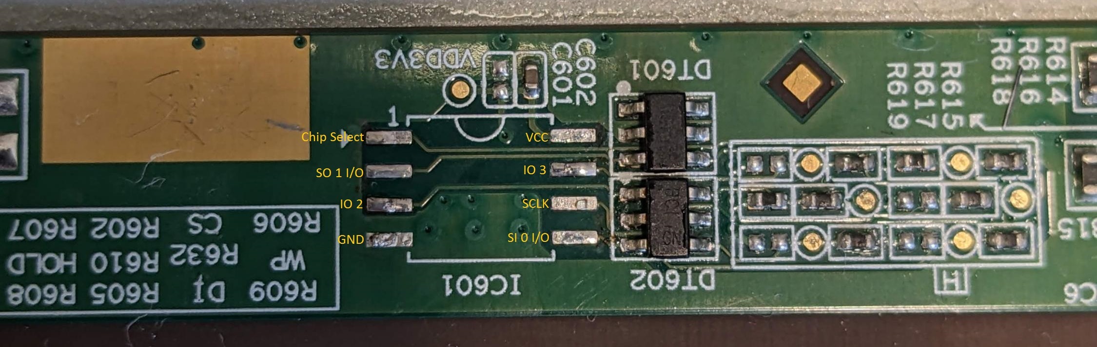

    Re: Samsung QN75Q60TAF Boot Loop fixed but no picture
    Originally posted by Diah

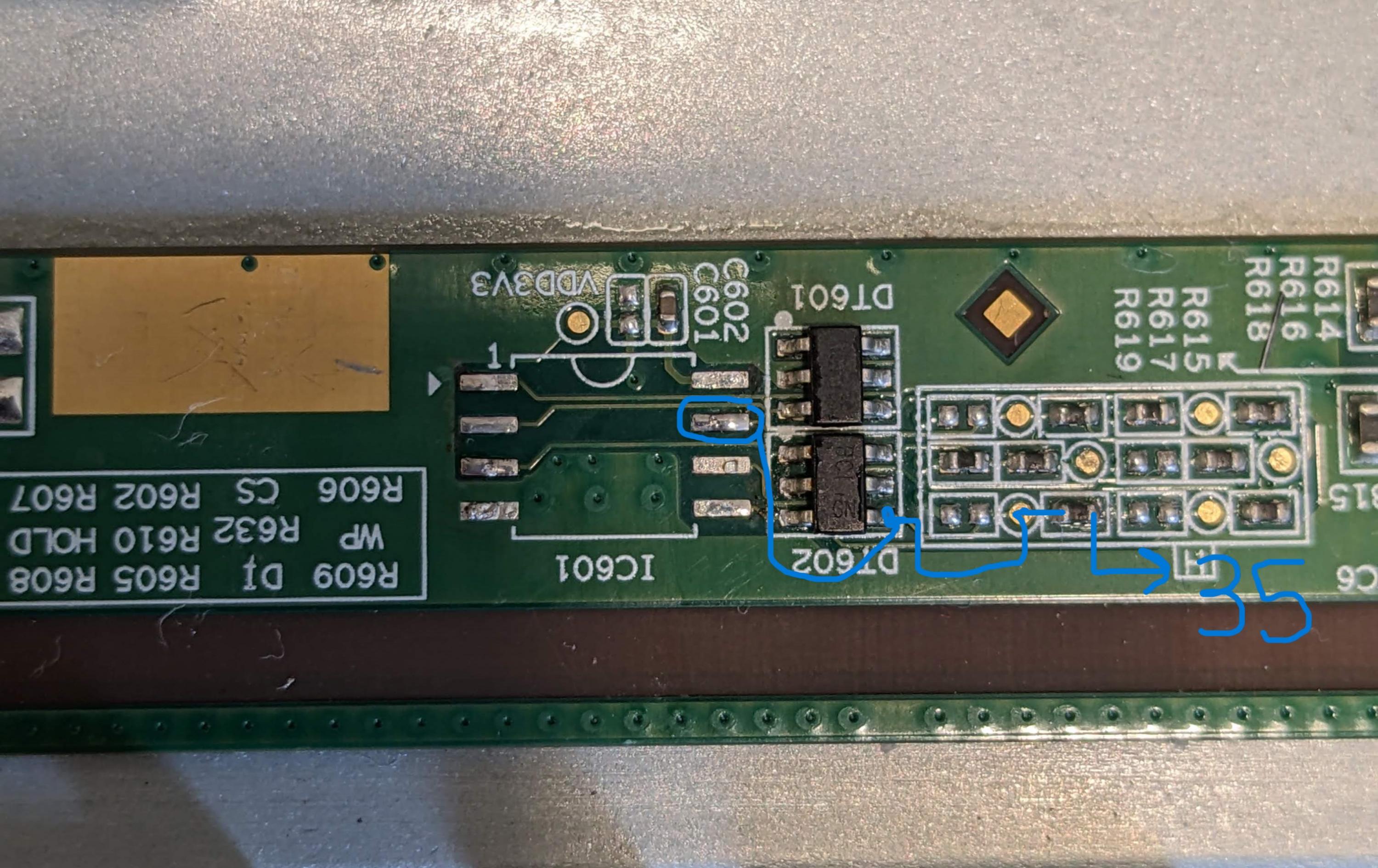

    check pin 6 of ic where it go .. did it had contact at any lvds socket
    See picture. It goes through a 47.5 ohm resistor and directly to Pin 35.

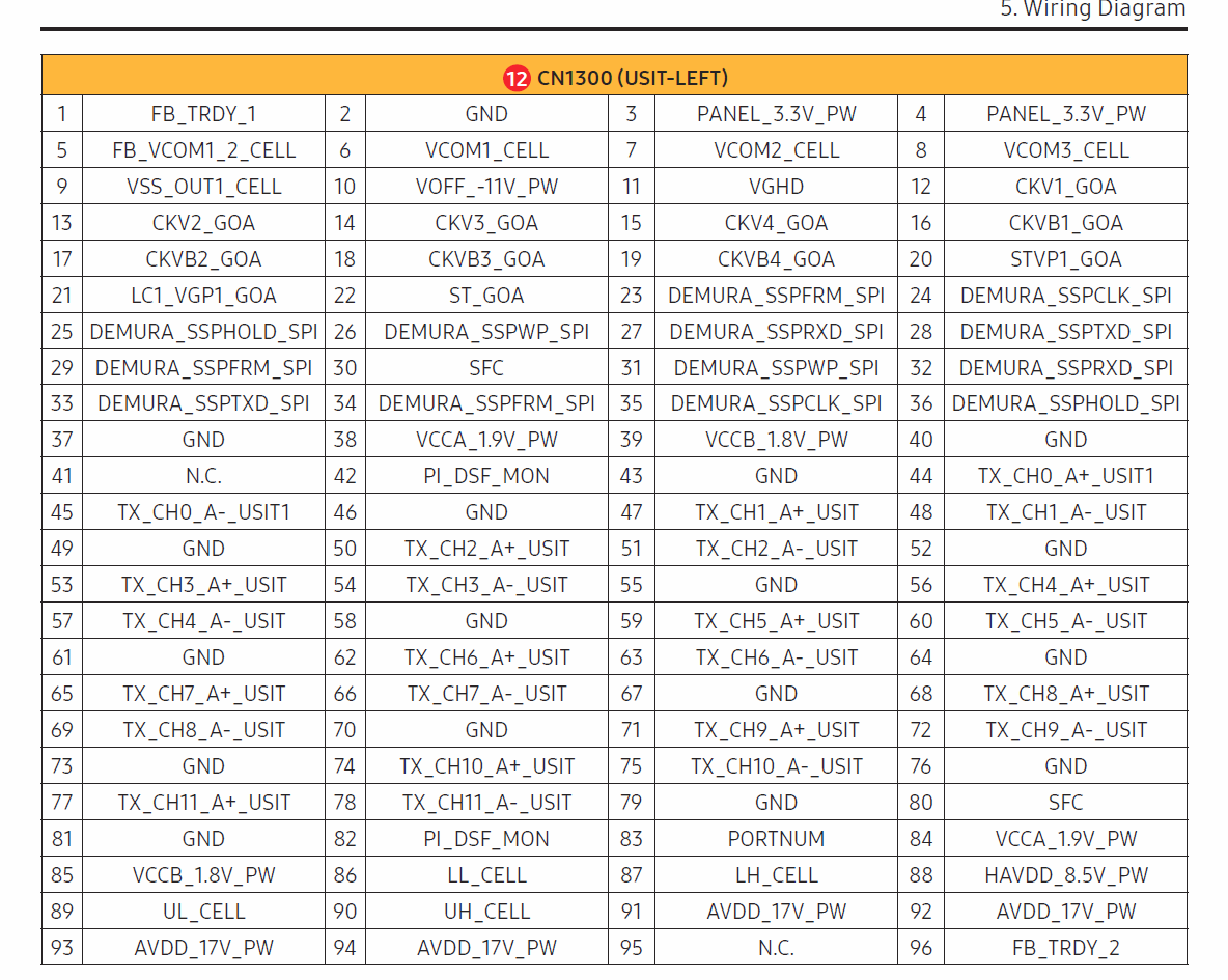

      Wiring Diagram

        #103
        Originally posted by lotas

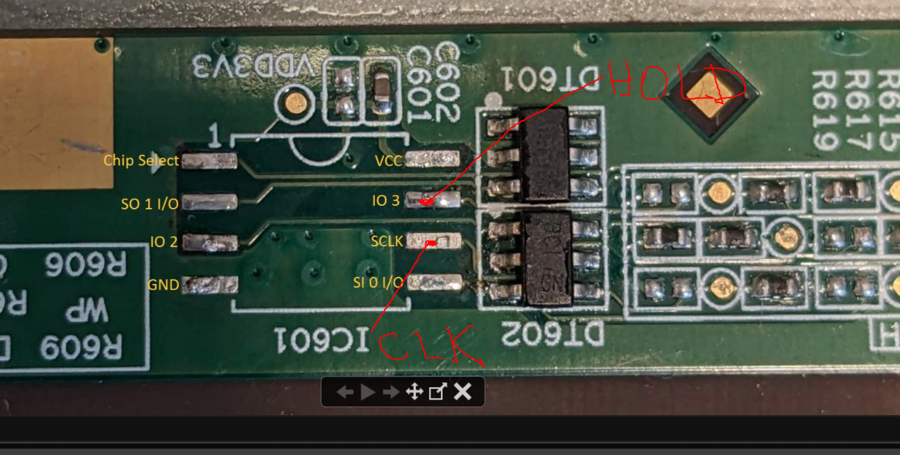

        All of these 6 pins go through the protection diodes and out to the control points.
        i don't think so... NO 6 SCLK had nothings to do with any protection
        output 0 and 1 yes each go to DT

            #105
            I will not argue, I tell it like it is.
            • Diah
              • Feb 2013
              • 6593
              #106
              LOL nothings to argue,, they are 2 channel Horizontal and Vertical. because the LVDS Single. IC had 8 pins. 2 GND & VCC and 4pins for data 2 for each channel. left 2 SCLK and chip select they go to test point not for any of DT

                #107
                Go ahead and test that resistor you mention there, see if the ohms are any or much different than the rest in that box there and maybe test some of the other similar resistors on other parts of the board, see what you get.

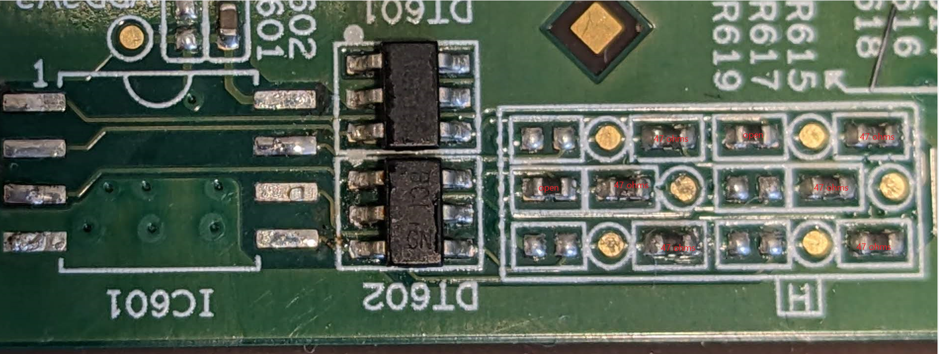

                  #108
                  Wiring Diagram

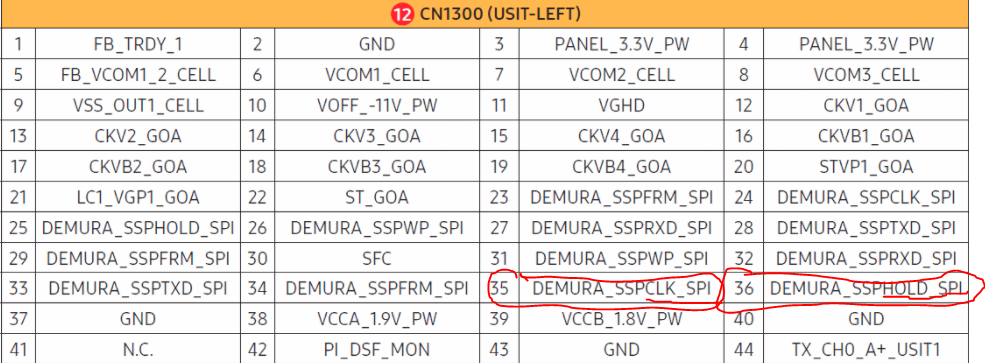

                  Yes, it's actually pins 61 and 62. I counted from the wrong end of the connector originally. So 35=62 and 36=61. Sorry about that..
                  • Nicktronic
                    • Mar 2023
                    • 247
                    #109
                    Tested all resistors, see picture. Two open.....

                      #110
                      They can be at 10kOm (pull-up to 3.3v), and at 47 Om they are through (6 lines, 6pin)

                        #111
                        Yes, they are 4.68Kohm, sorry, they are not open.

                            #113
                            i think this statement of you wrong or the diagram belong to other chassis
                            any way.. since now the NOR out of the circuit. please compare in Diode mode DT601 602 specialty the reading of Pins 1 & 3 for each against them self and to other pins . also at reserve probe. to make it easy each time to measure write down where are the + & -

                                #115
                                This wiring diagram is correct, it is from this chassis (from this model).
                                • lotas
                                  • Jan 2016
                                  • 4880
                                  • Russia
                                  #116
                                  Check if these pins match (6 pin(clk) with 35pin and 7pin(hold) with 36pin)
                                  These pins can be passed through 47 ohm resistors.

                                    #117
                                    I've already confirmed pin 6 (clk) and i will confirm pin7 (hold) tonight

                                      If the wiring diagram @lotas provided is correct, then I believe we are dealing with pins 61 and 62, I've indicated this in the picture

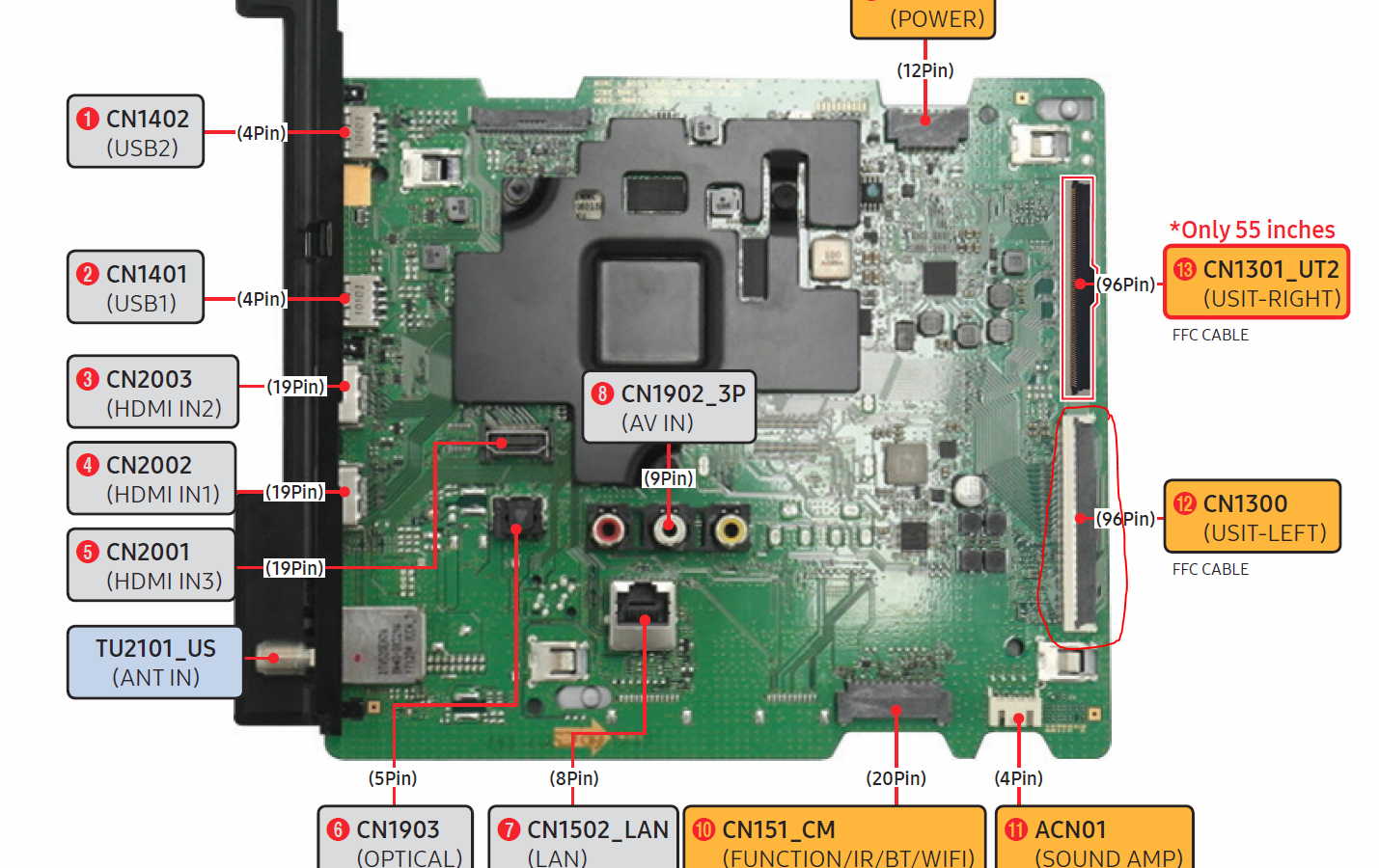

                                        This is the schematic that I posted the motherboard pinouts, not the panel strips.

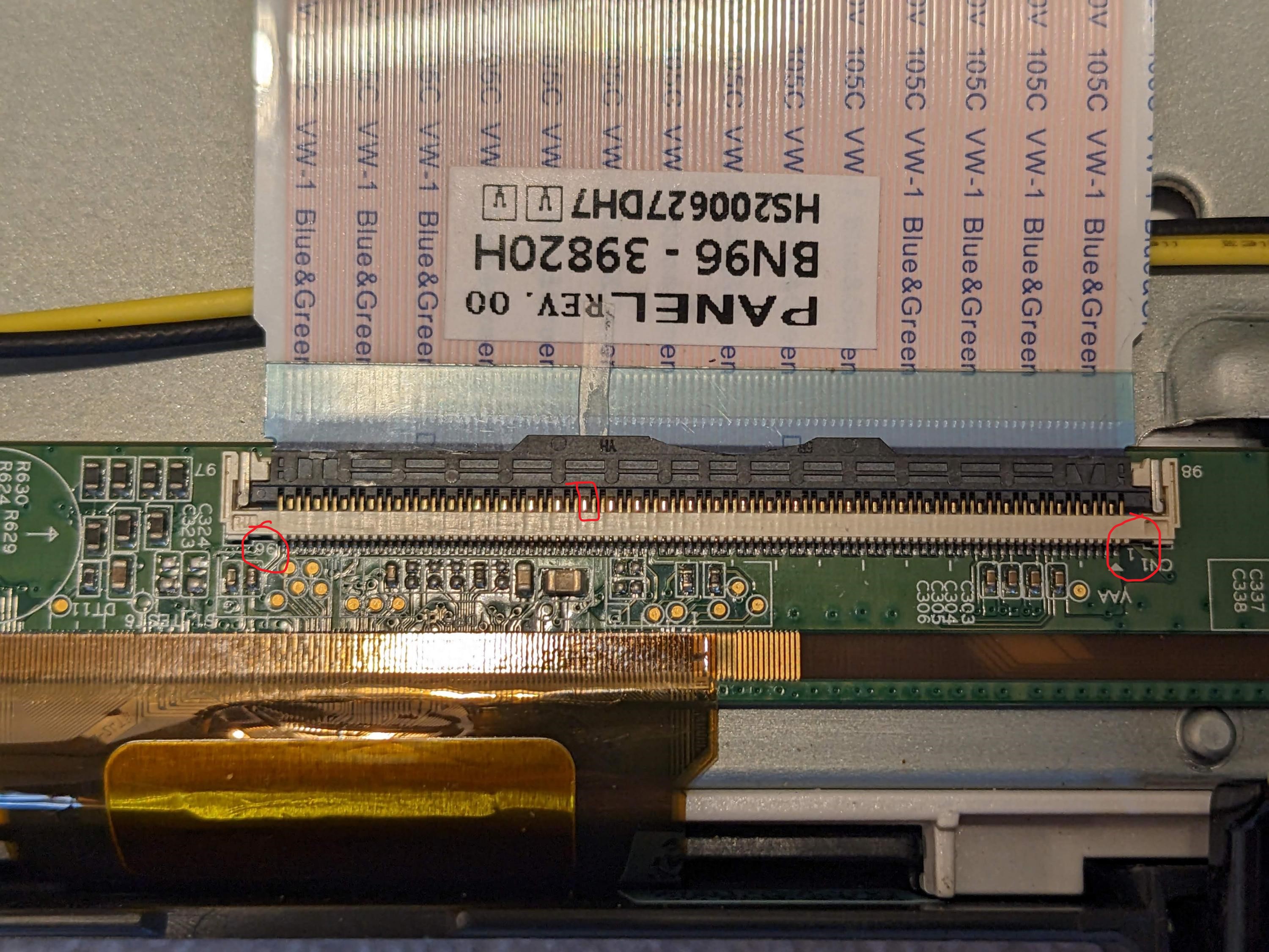

                                        Panel bar 1pin - goes to the motherboard on 96 pin, and 96pin goes to 1 pin (mirror).
