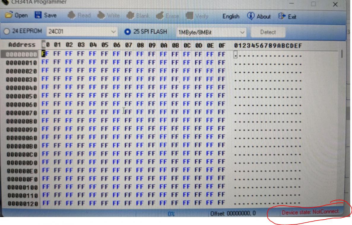

          I got the CH341 programmer, did the 3.3V mod and soldered the SPI Flash to the daughter board. I downloaded and installed the drivers for the CH341. I tried using Neo Programmer software but GD25B32CSIG was not in their list and auto detect did not work.
          Does anybody have a suggestion of what program to use with the CH341?

            Re: Samsung QN75Q60TAF Boot Loop fixed but no picture
            use this auto detect
            or this in attachment... GIGADEVICE your chip

              If the Spi Flash chip is short, then not one programmer, not one program will detect it.

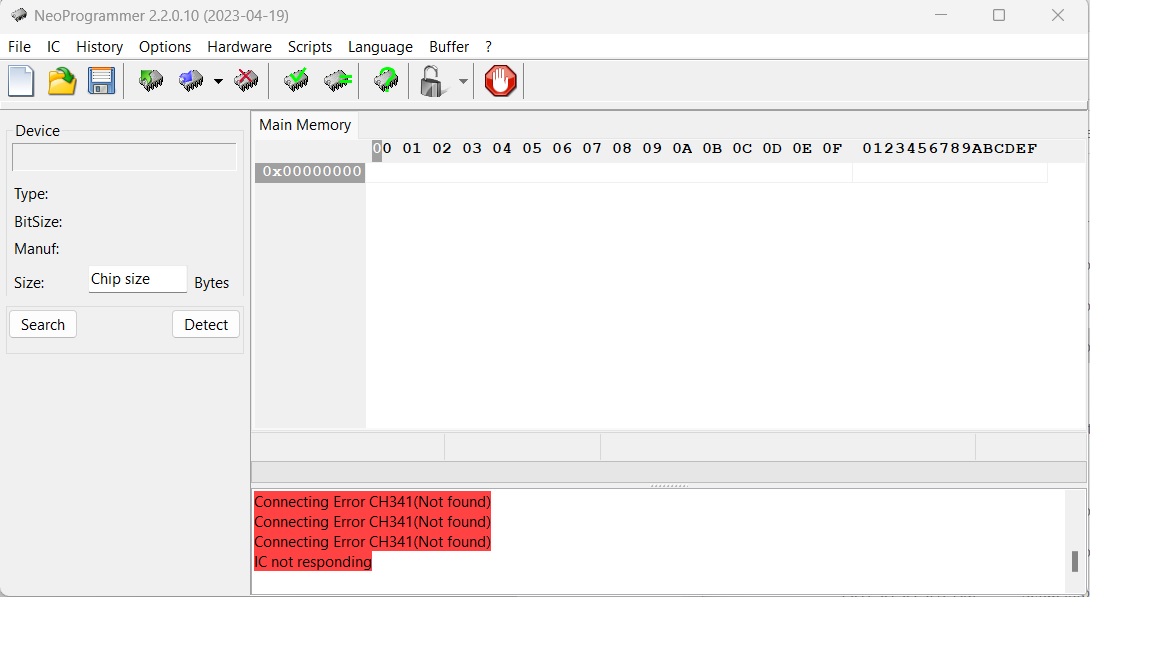

                      Tried with your program, still nothing but I want you to confirm I have the CH341 configured properly. I received a jumper that I did not use.
                        The program does not see your programmer, if the chip is short, as I already wrote, then it shortens the power supply of the programmer, remove the chip and start the program again.

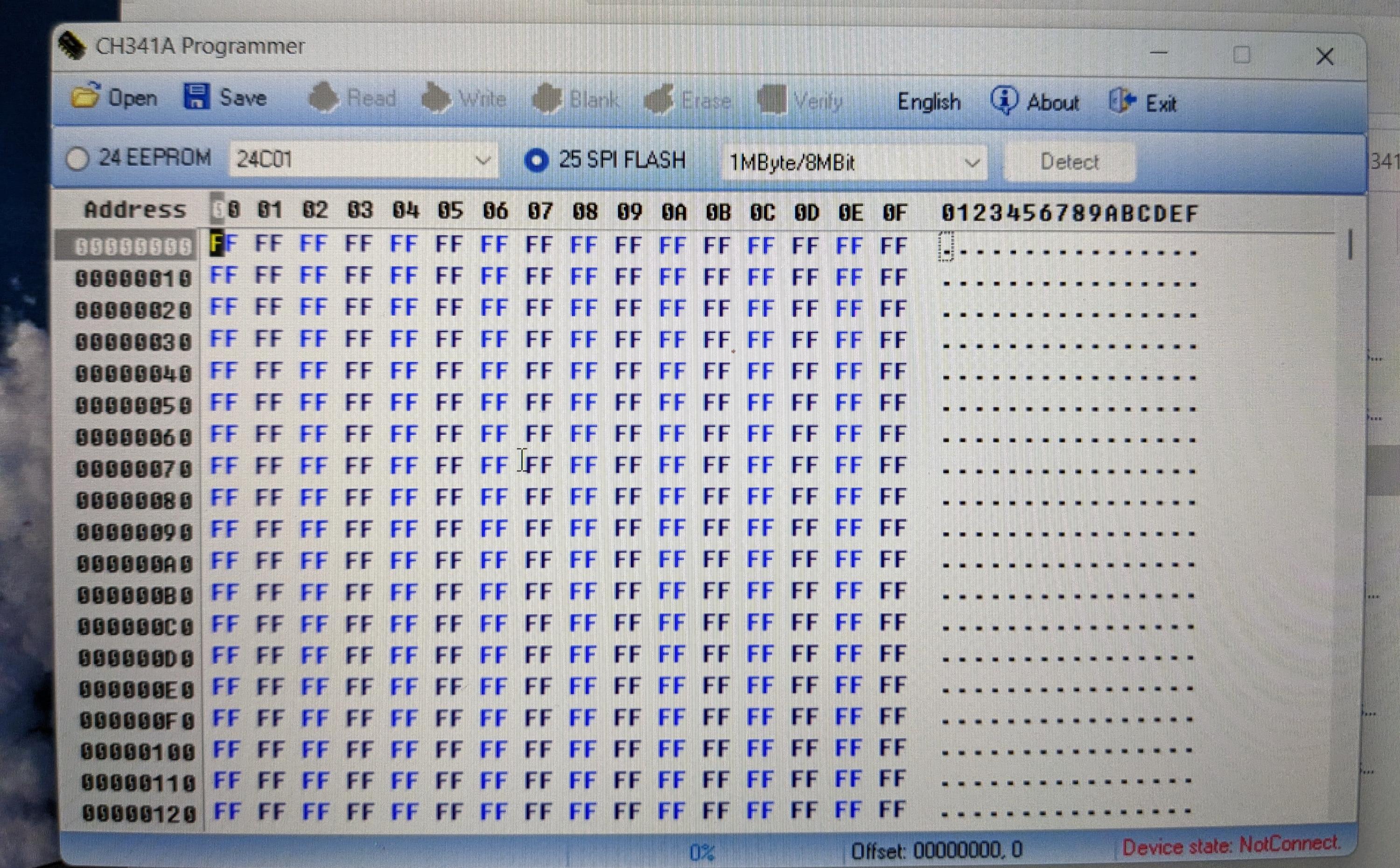

                              Same message with spi flash removed. No connect. I want know if the CH341 is configured properly....do i need to use the jumper? There are no instructions
                                See in neo programmer, with SPI Flash removed and just the CH341 plugged in, it says cannot connect to CH341 and I don't know why.
                                  The drivers were installed correctly, it is determined in the device manager, the jumper is not needed here, it is for 5v.
                                    Ok, I aslo did this mod; lift pin 28 of ch341 and jumper to 3.3V tab of regulator and also jumper to pin 9 of ch341. Should i have done this? I'm reading information now that says it was wrong to do that.

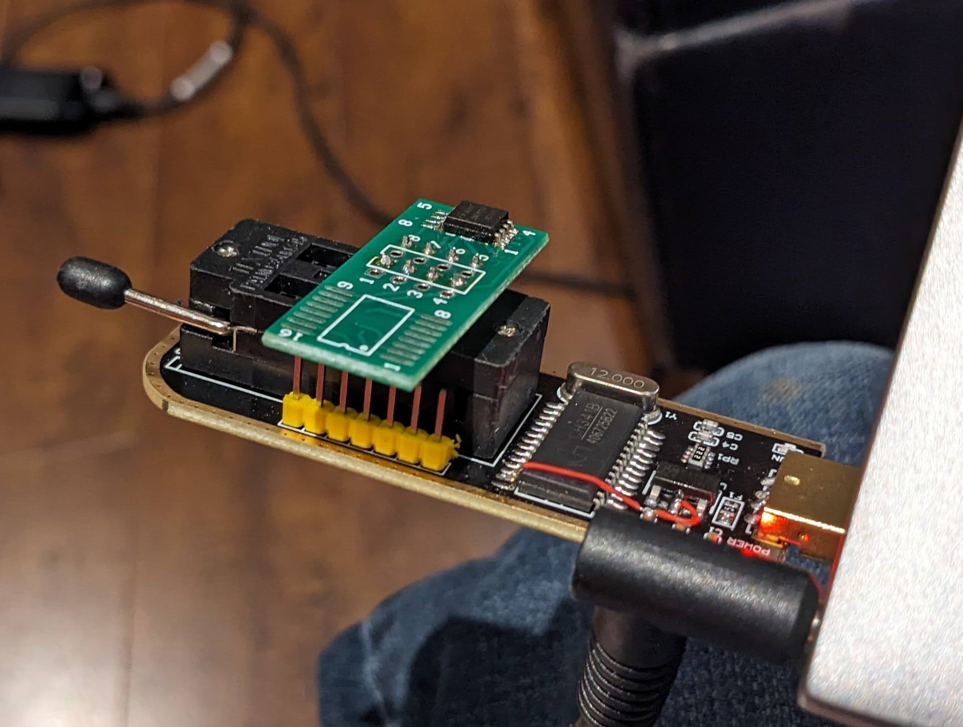

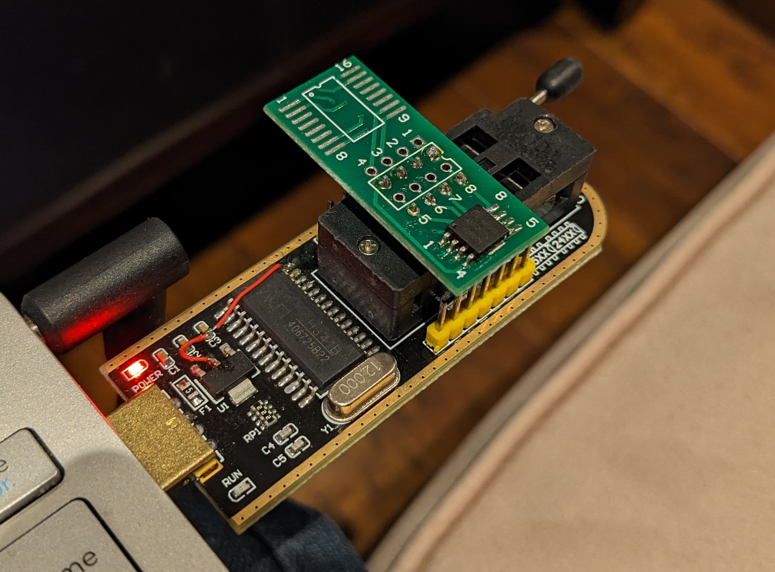

                                        • lotas
                                          • Jan 2016
                                          • 4900
                                          • Russia
                                          #160
                                          !!! DO NOT CONNECT 3.3V TO PIN 9 OF CH341 otherwise the CH341 will burn in 5.0v selection. !!!
