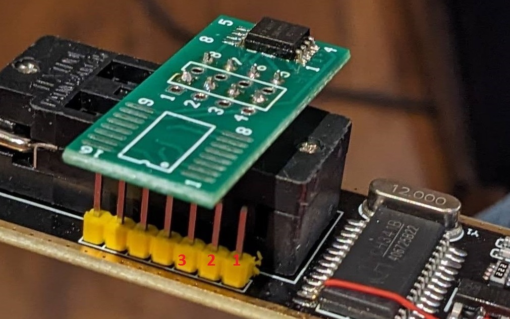

    !!! DO NOT CONNECT 3.3V TO PIN 9 OF CH341 otherwise the CH341 will burn in 5.0v selection. !!!
    Did you install a jumper when setting 9 pin to 3.3v?
    Yup, as the many sites and videos said to do. Crappy, so what does that mean? It will output 5 V to VCC of the SPI flash?

      #162
      Re: Samsung QN75Q60TAF Boot Loop fixed but no picture
      Without a jumper it gives out 3.3v (for spi flash), with a jumper it gives out 5v (for eeprom 24Cxxx), but if you make a mod (with 9 pin, only for spi, then it is absolutely impossible to put a jumper). 5v then goes to 9 pin and that's it - the chip itself burns out.
      It was necessary to do the mod only with power at 3.3v without a jumper for 9 pin.

        #163
        1- yours jumper the red wire enough don't do any more
        2- use the program i later attached at my post #145
        3- be sure the PCB of the chip sitting on the programmer pin 1 on 1

          #164
          yours photo
          you should put the yellow jumper clip on pin 1 & 2 this is programmer.... and if you want to use the adapter as serial for log dump the jumper need to be at pin 2 & 3

                  #168
                  Originally posted by Nicktronic
                  Hmmm, @diah says use the jumper, @lotas says do not use the jumper lol. What do i do!?? At this point, I've tried all combinations and no luck. SPI is likely dead and if @lotas is right, the CH341 is dead. :S
                  lotas talking on pin 9 of the IC dont connect it to 3.3V as some idiot on internet say... and he is correct dont .. just the red wire you did enough.
                  i am talking on jumper pins 123 .... take look downside its printed pin 1-2 programmer pin 2-3 TTL also you need to short pin 1-2 with jumper
                  • Nicktronic
                    • Mar 2023
                    • 247

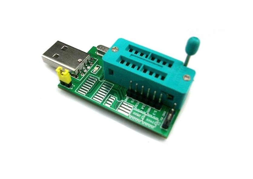

                      So I bought another CH341A just in case i bricked the one i have like @lotas suggested.
                      Now, when I get the new one, DO I NEED TO DO THE MOD (lift pin 28 of CH341 and run mod wire from pin 28 to the middle pin of 3.3V regulator)? From the datasheet of the SPI, I see it cannot handle 5V.

                            #173
                            Yes, it's better to make this mod, because the chip itself will already be powered not by 5v, but by 3.3v and, accordingly, the signal lines between spi will also be at 3.3v, this is with a green board programmer CH341A (old revision) mod does not need to be done, everything is fine there , but it is better to make a programmer with a black board.

                              #174
                              For such a "green" mod is not needed. 28 pin is powered by 3.3v.
