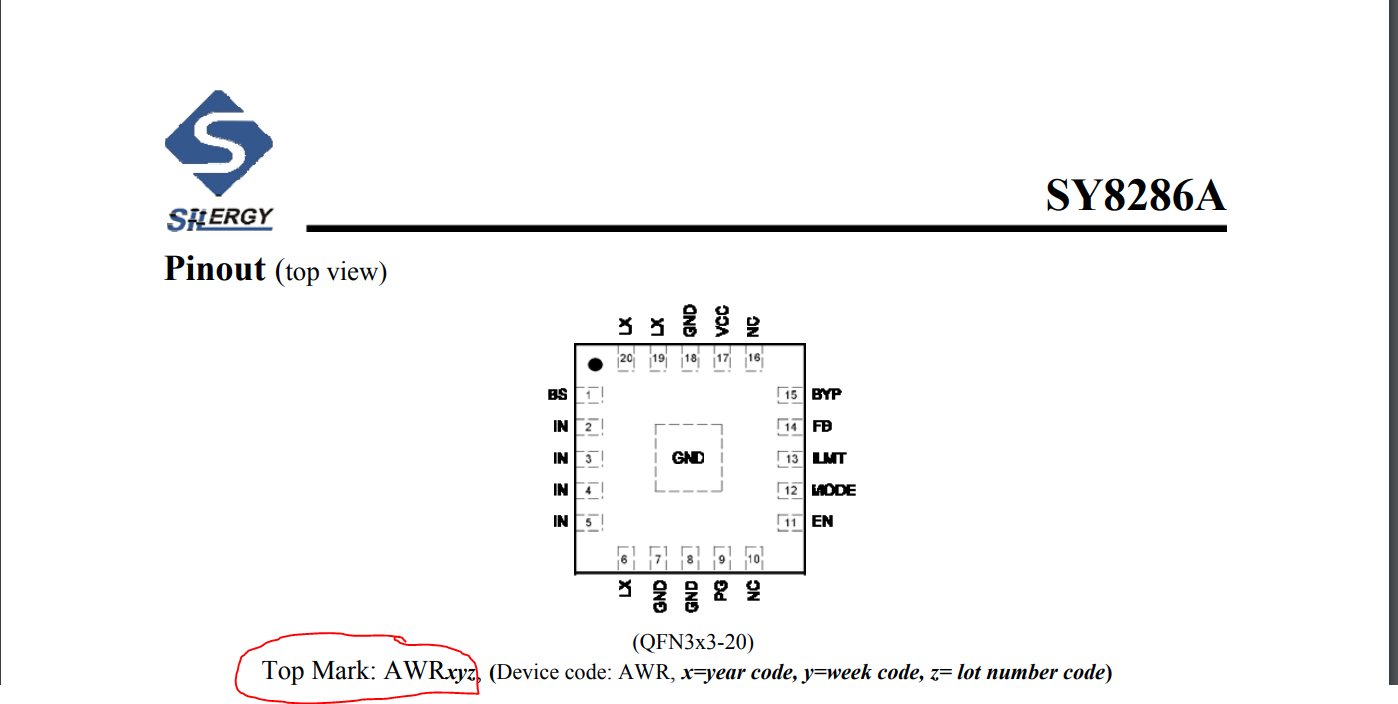

                                    Mine is just 20pin QFN with "AWRCDE" marking.
                                    More interesting to this thread is OP's DC/DC in post #20. Looks like N12R. Google also didn't find anything.
                                    But probably just for curiosity as OPs circuit seems to be working fine and mine seem stuck on dead eMMC in another thread haha.

                                      #58
                                      Re: Samsung QN75Q60TAF Boot Loop fixed but no picture
                                      AWRCDE - AWRxxx - SY8286A
                                      • howardc64
                                        • Jun 2017
                                        • 654
                                        #59
                                        Thank you! satisfies the curiosity haha. Will stop thread jacking now :P
