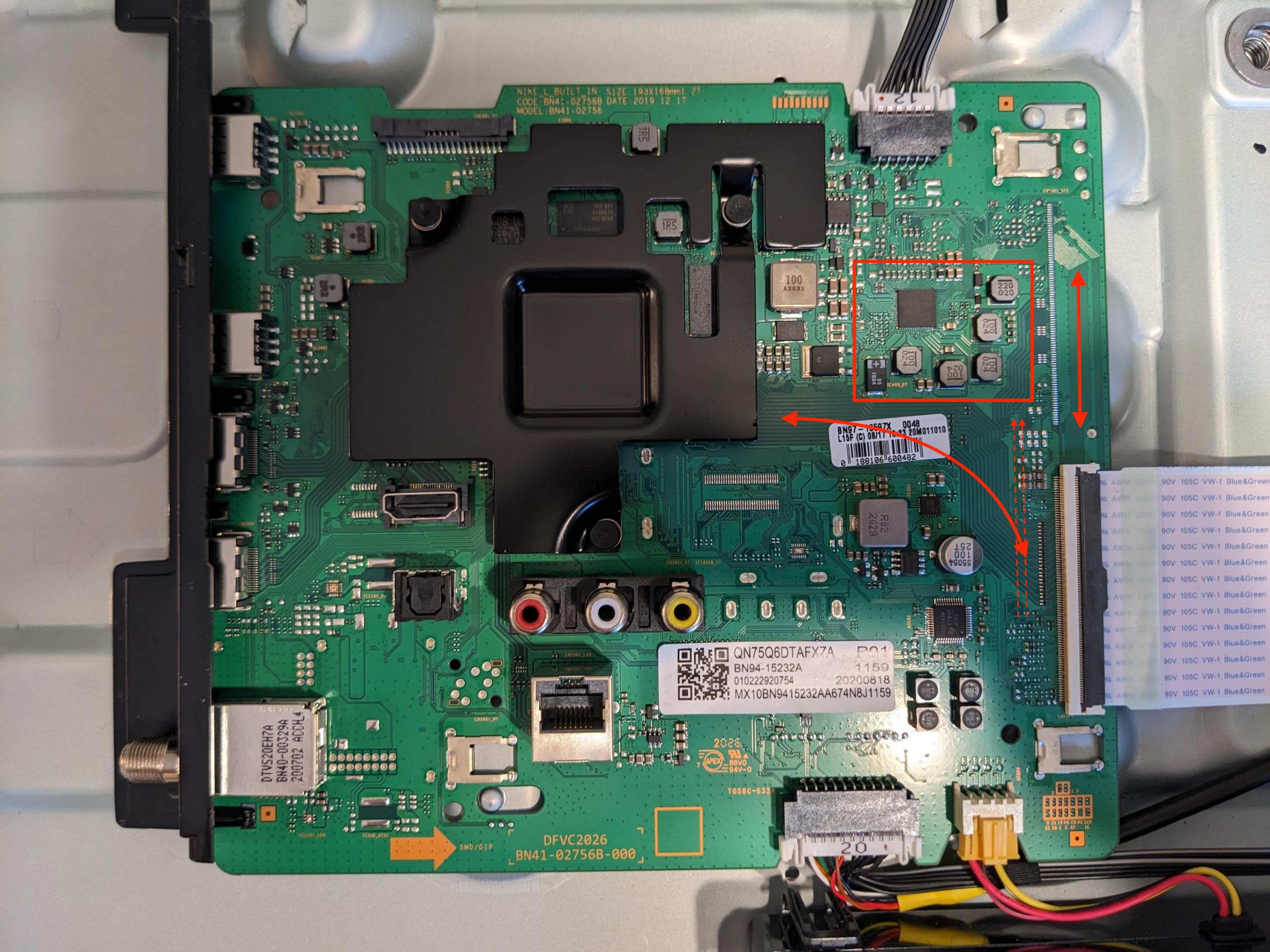

            Here are some steps
            Confirm test point shorts
            In post #14, you traced masked off pins 35/36 to test points on the board. This is likely a shorted rail. Since you masked off these pins, no voltage is sent to these rails from main board and so TV continues to operate. But of course some power section is lost to the buffer board/panel
            Put positive multimeter tip on the test point and negative on ground (TV metal chassis that boards mounts on (usually many GND pathways from buffer boards to chassis) or some of the open copper rectangles on the buffer boards which are usually also GND and read the resistance. Maybe you will see 12ohm again like post #23.
            If short on buffer boards, which one?
            If there is a short on the buffer board, then need to determine which one. First, can you post a pic of the entire back of the TV? Looks like you have 1x main board to buffer board flex cable. I'm guessing for a 75" TV, there are 4x buffer boards and 3x dark orange colored flex that join them. Your short could be on any of the 4 buffer boards as voltage rails goes to all of them.
            To find out which buffer board has the short. First confirm the short on a particular buffer board, then remove the flex to other buffer boards/main and check the short again against the GND on the buffer board. If disappears, then short is on other boards. If remain, then its this one. Probably check all 4 buffer boards in this manner.
            Which component is shorted on the buffer board?
            This requires even more skill and experience as there are many components and usually multiple caps on every voltage rail. Pros inject voltage (need to estimate how much voltage and max current limit given the circuit) by bench power supply and use a thermal imager (and often a macro lens + video recording) to quickly which component heats up first. There are other ways... by touch, evaporating rate of isopropyl alcohol etc.
            Lets confirm you have short on the buffer boards and which one first.
            Probably can skip the main board for now, The R82 is an inductor and just a loop of wires so it will read continuous. Anyway, its next to TI TAS5749M which google says is an audio IC and your speaker connectors are just below that.
            Here is a annotated pic of your main. The red rectangle is where all the voltages for the LCD panel comes from. Rectangular chip in the middle takes 12v from PSU and generates all the voltages for the LCD (vgh ~= 20v+, vgl ~= -10v, vcom ~<= 10v) so don't go probing around the tight pitch pins around this chip. The octagons are inductors and they will probably read the voltages I gave you above (+ probe on either side of inductor, - probe on TV chassis GND). vgh/vgl/vcom are used to turn each TFT (thin film transistor) at each subpixel (R,G,B) and turn the LCD polarizer to allow the backlight through. Panel buffer boards usually also get 3.3v to run various digital logic chips.
            The solid red arrows shows traces going to the SOC under the heatsink (pixel data) and traces towards the rectangular section (where LCD power supply is)
            The dash red arrow is probably where the pin 35/36 trace points continue.. making their way towards the LCD panel power supply section.
            Anyway, probably focus on finding the short in buffer board now.

                    #29
                    Re: Samsung QN75Q60TAF Boot Loop fixed but no picture
                    Checked every single capacitor on the buffer boards. No shorts that I can find. That means it's in the panel then, correct? Isolating the VDD (35/36) just removed the ability for the short to affect the VDD supply right? So beyond capacitors, what? Anything?

                            keep the mask on 35 & 36.. turn on and measure the V on them at MB side

                                  @howardc64, the 12 ohms was measured on the main board, i believe you mentioned R89 earlier being an inductor. It was all caps around that.
                                  @diah, mask on, 35/36 at MB side is 3.272VDC on both pins to gnd
