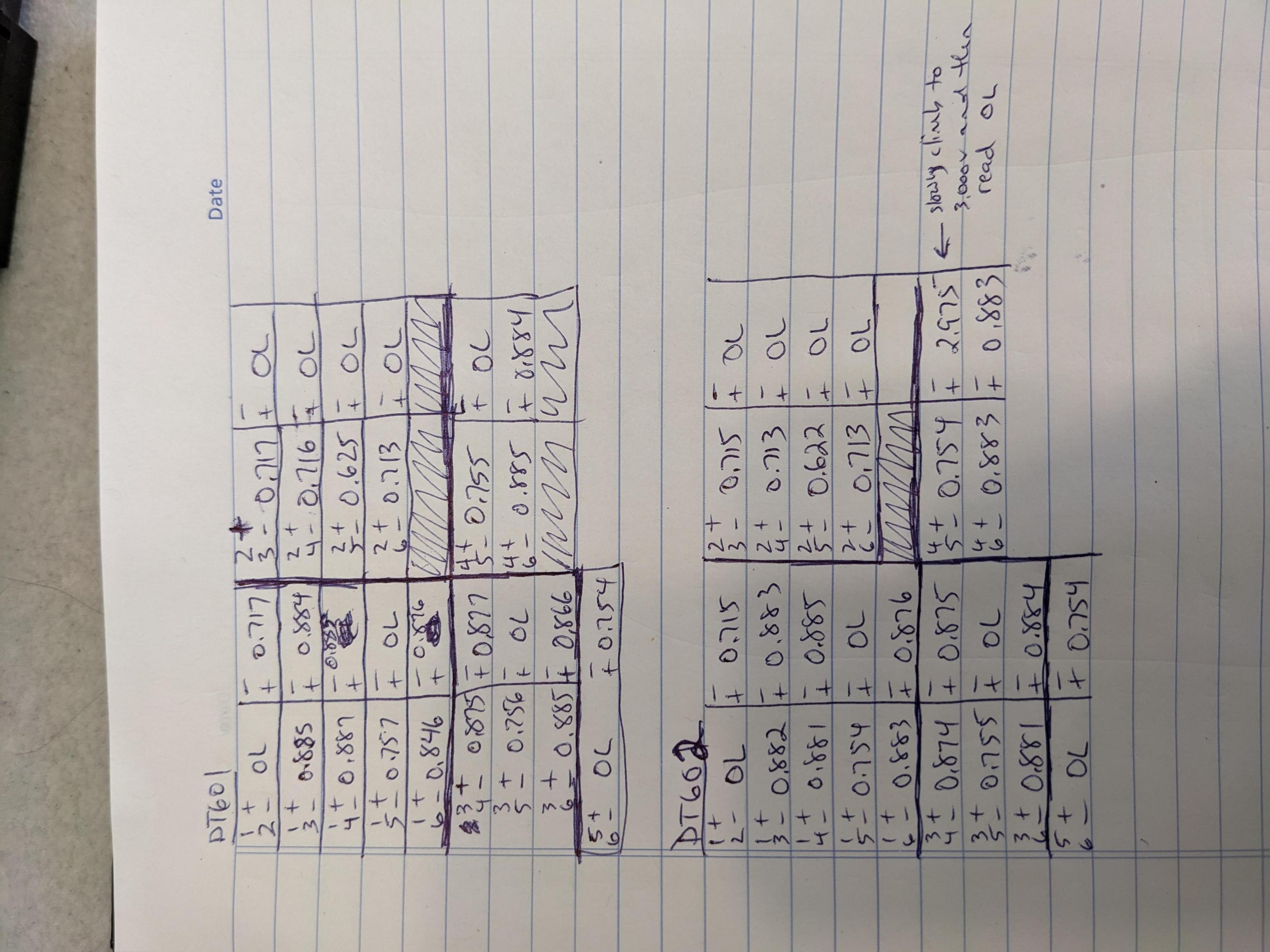

              I'm trying to do everything you all are saying. I did a whole bunch of checks of the diode packs like @diah asked for in post #113. I can also remove the packs, but just so i'm clear, it is possible to get a picture with the spi flash and diode packs removed?

                  The SPI Flash is currently removed. Do i need to re-install it for the panel to "potentially" work?

                        Ok, so looks like your spi flash is junk, so you need a new one, spi flash might hold firmware, so probably no sense trying to get tv going til you get new spi flash, did anyone look up the datasheet, will probably tell you if you need to program it or not, then with fixed spi try tv, if still problem then by all means remove both those diode assemblies on panel driver board.

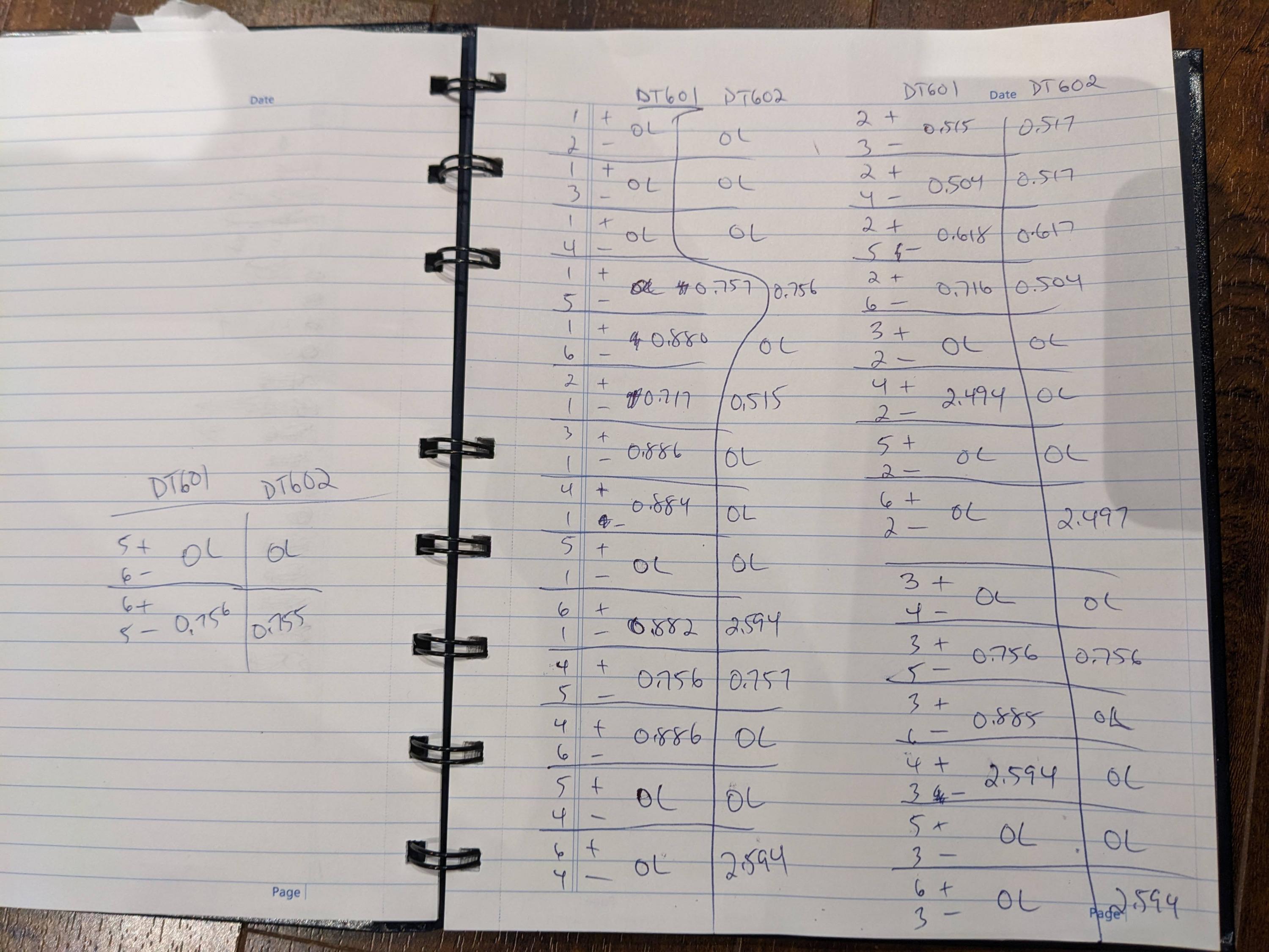

                          #132
                          Re: Samsung QN75Q60TAF Boot Loop fixed but no picture
                          why you are hurry by judgments... troubleshooting need steps one by one..
                          my suggest don't remove any further parts and i did write this.
                          where are the result of my asking in POST #66 ???
                          where are the Value list of my asking post #113 ???
                          do you understand why i wrote this #POST ...???

                            #133
                            Agreed step by step is best, he can't do 66, no programmer yet, and 113 he said will do in post 114 but must have forgot??

                                #135
                                See photo for response to post #113. Don't have the programmer yet, but I can't find the SPI Flash that I removed.....my family might've played with and lost it. I ordered a new one.

                                    #137
                                    are this reading while LVDS disconnected !!!!
                                    about the spi. if you don't find it or it damaged during talking it out... the new one will written by MB when there are correct boot / Operation.
                                    but you need to measure it pin the 8 & 4 in reserve way to compare with yours first check
                                    • Nicktronic

                                      LVDS was connected. You didn't specify in post #113, or I missed it somewhere else. You want me to take new readings with LVDS disconnected?

                                        i think i write before.. ""right now MB after remove IC601 boot correct BL okay...Sound OK and we should not back consider right now on MB""... it logic talk that after this test point our focus will be on Panel but as SOLO because this is measurements of Diode mode and R so we don't need MB interface with any reading.

                                          See attached....
