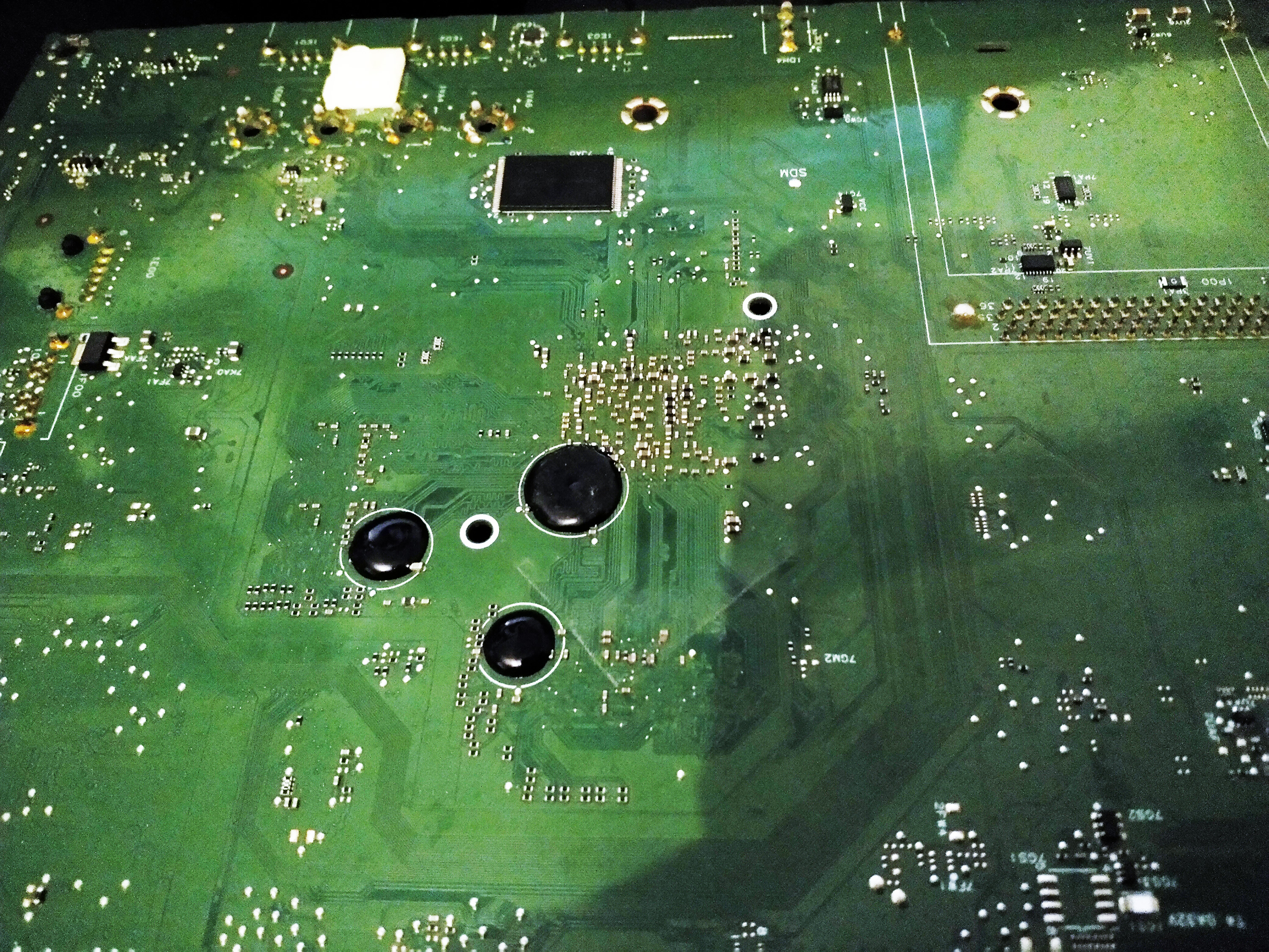

Philips 55PFL8008S/12 two blink error code
  • lotas
    • Jan 2016
    • 4752
    • Russia
    Re: Philips 55PFL8008S/12 two blink error code

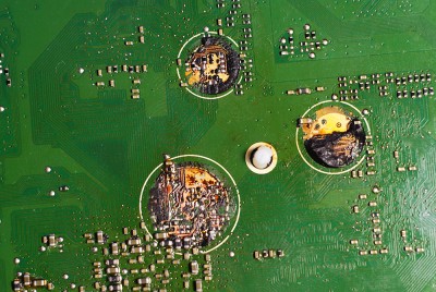

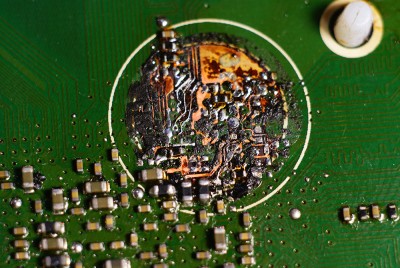

    Do you have such black drops on the back of the board?
      Reflowing is a short-term solution, the tin is porous and does not improve with heating. Reballing is the best solution if you want a good repair. Yes, there are motherboards that still work after a reflow after half a year, but most of them don't make it.

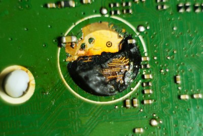

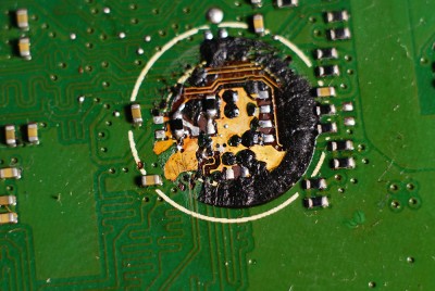

        But before reballing, you need to carefully remove this black compound, there are small solder balls inside it and when heated, the solder melts and closes inside the components (capacitors, resistors ...).

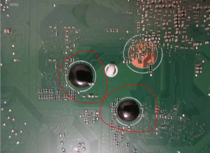

          Thank you for the great tips!
          Do you mean that the processor would be faulty after overheating or do you mean that the cooling must be fixed too? I don't have anything to lose (except otherwise fine TV) so I think I'll go with reflowing and better cooling and try my luck. Or do you have something better idea?
          Good to know! I didn't even think about those blobs deeply. And yes I do have three of them as shown in the picture. Do you have tips how to remove that black compound? I watched some videos in which they used hot air and careful scraping to remove it.
            Yes, you have to be very careful with these drops, you can damage the elements and tracks!

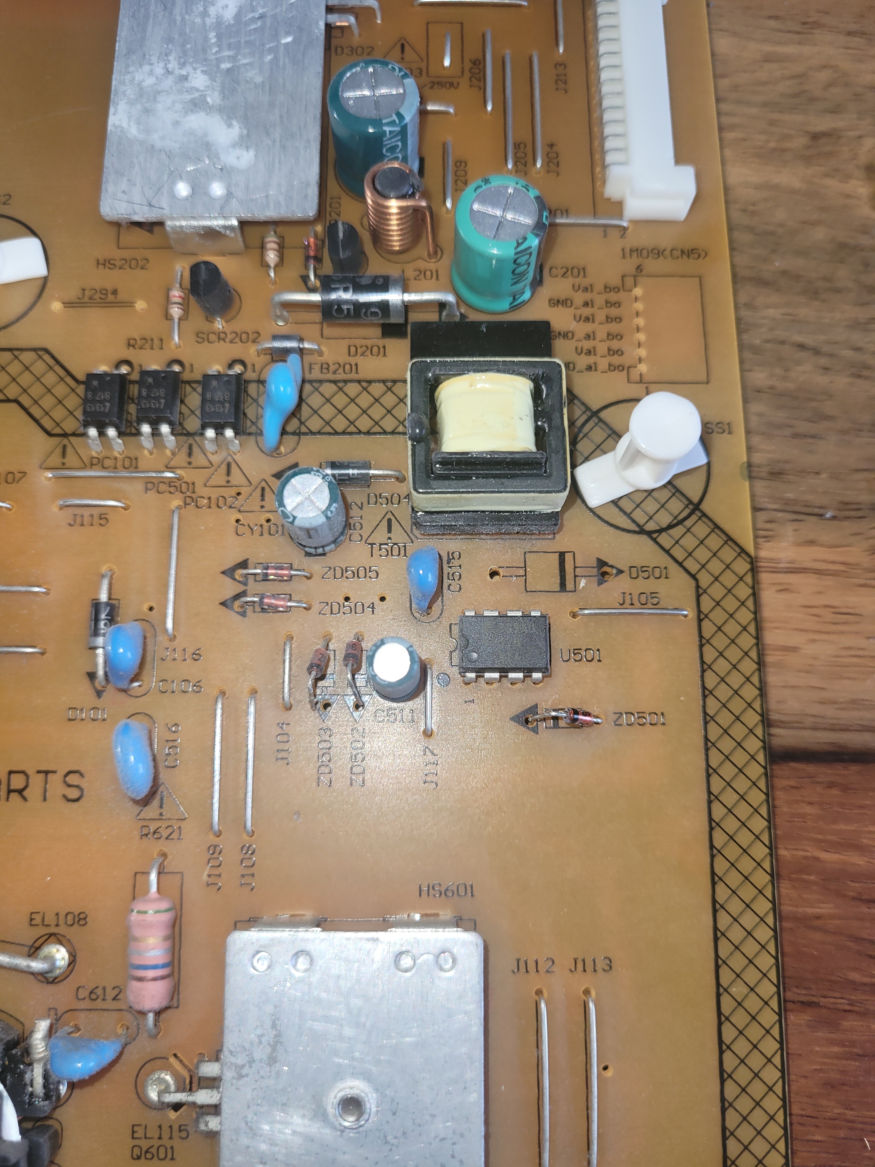

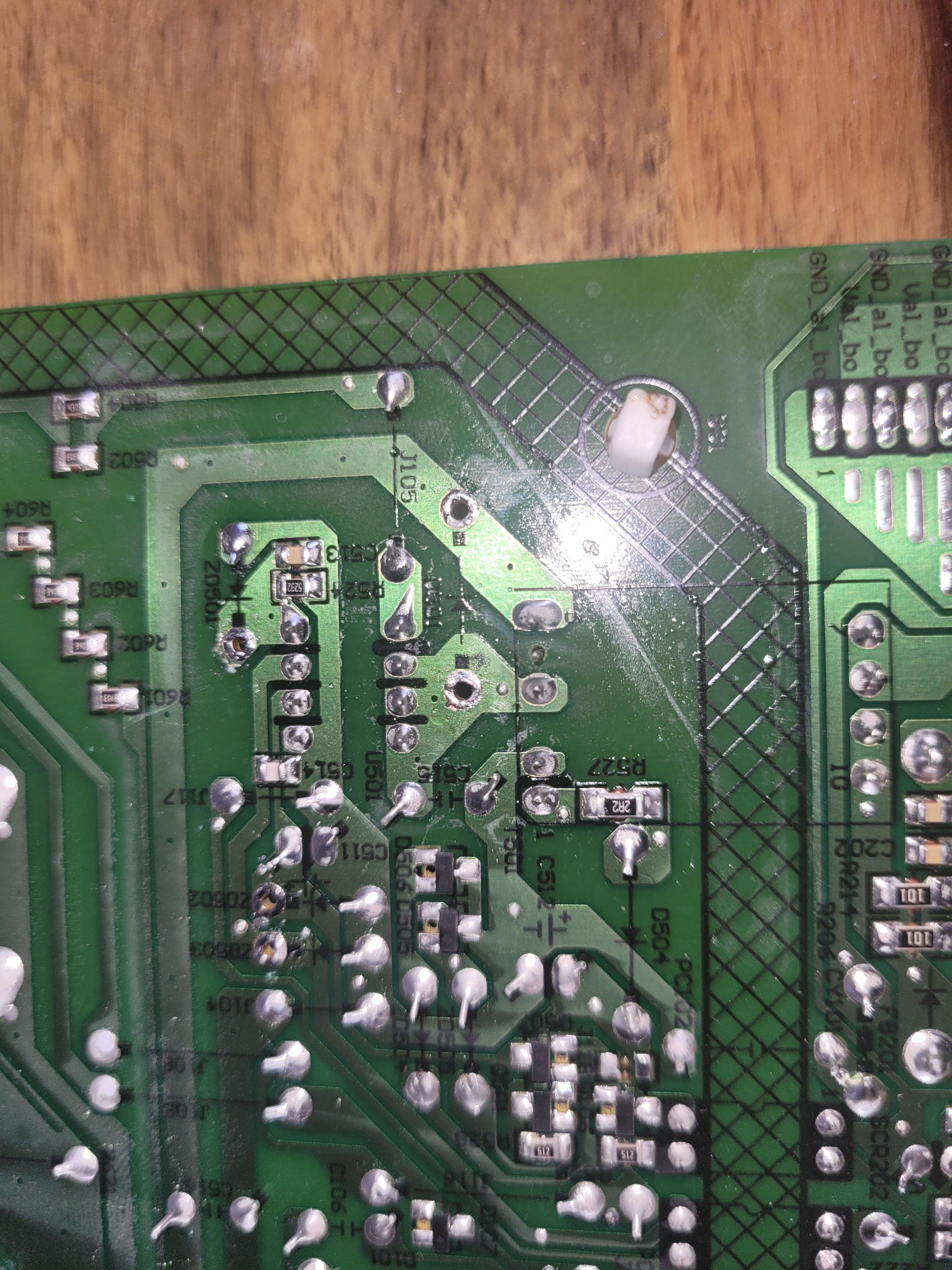

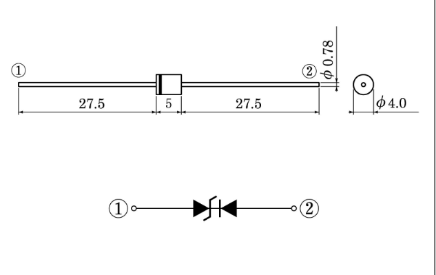

                          I'm trying to repair this TV totally dead D501(T2D34 diode) is showing as shorted in circuit and out
                          Zd501,zd504,zd505 shorted in circuit but out of circuit there fine so stuck on trying to trace what causing the fault any ideas

                            #33
                            Find the error on the mainboard, start the SDM and see how many times the LED flashes.

                              #34
                              Found T2D34 diode is shorted and B117H is also shorted
                              Ordering B117H but can't find T2D34 diode does anyone know and alternative ?

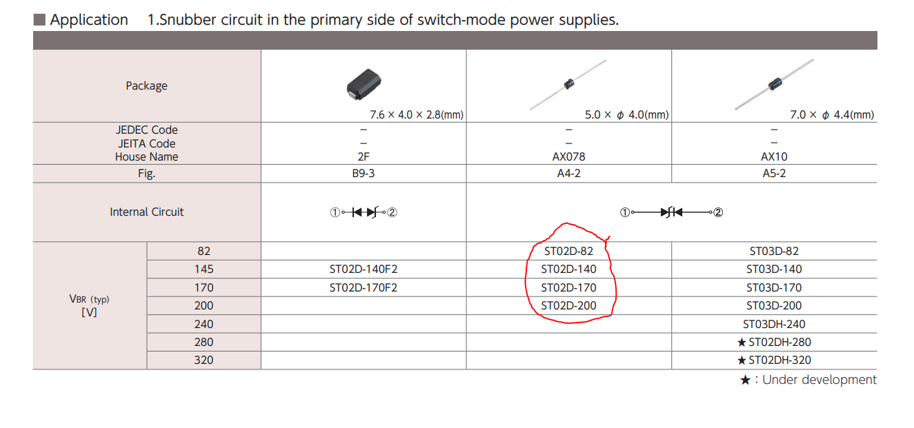

                                #35
                                And what's wrong with T2D34? It's not a simple diode, but a protective, bi-anode one, and you can't check it with a simple multimeter.

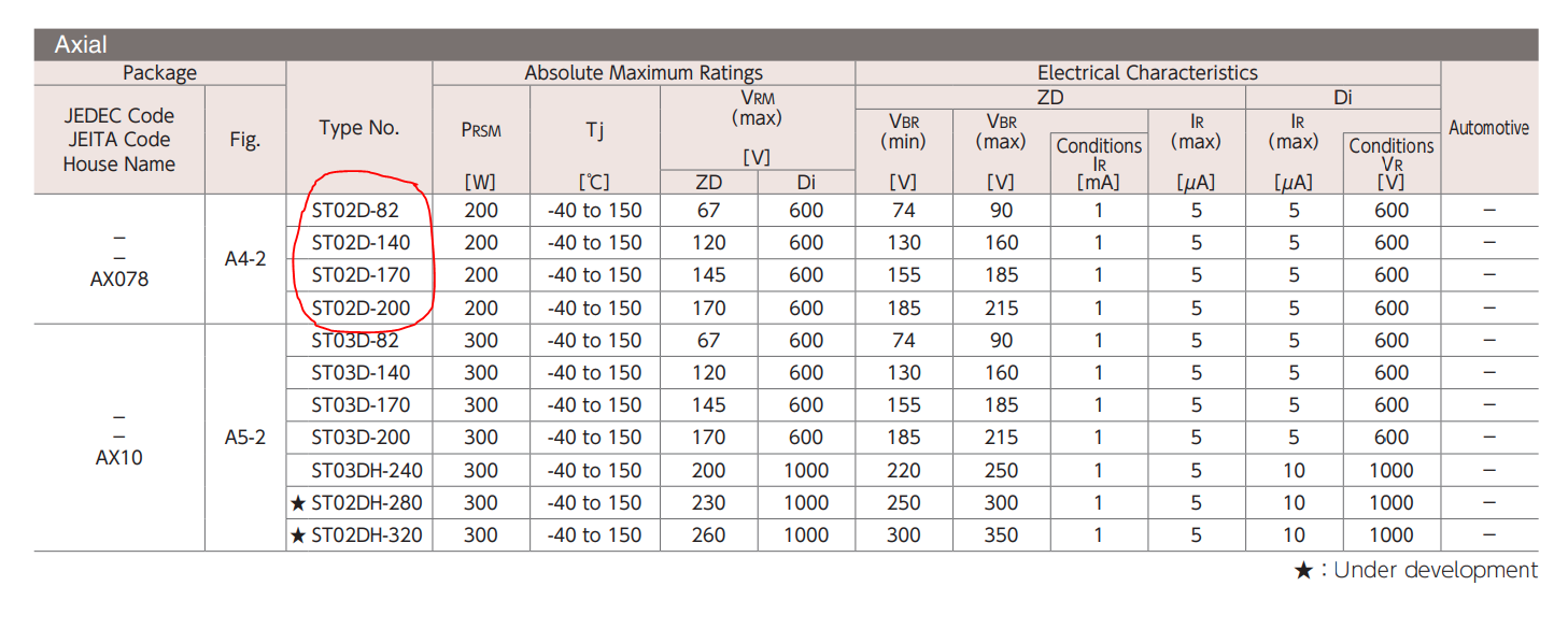

                                  #36
                                  Your diode belongs to the ST02D series, the exact name (voltage) depends on the marking, its marking depends on the color of the inscription on it.
                                  You can replace it with P6KE SERIES, but you need to know exactly what voltage you have.

                                    #37
                                    Just and update on this post replaced T2D34 diode and B117H TV now up and running
