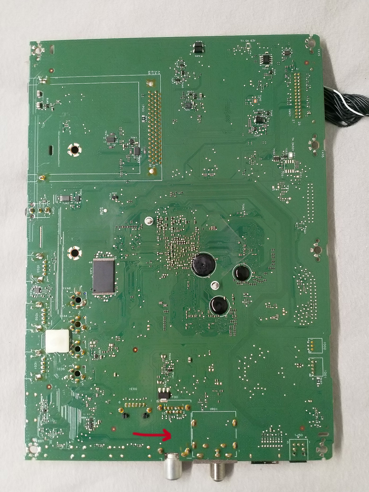

    Hi. This noob needs help with this TV.

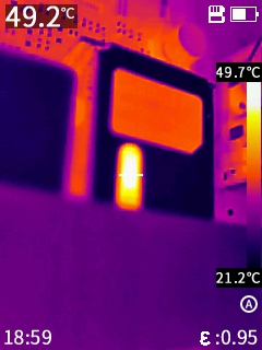

    Symptoms: TV haven't always turned on but when it has, it has been working normally. The TV was sitting in the storage for about an year and after that time for a few days it worked perfectly and turned on every time. But then it suddenly won't turn on anymore and just shows two blinks with standby light.
    I disassembled the back cover and examined the circuit boards. I didn't notice anything obvious with PCBs and components. I measured the voltage rails. In the connector that connects to logic board every voltage is present and correct. But in the connector that goes to the screen both 56.1 V rails measured only about 45 V.

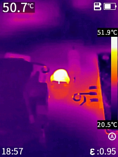

    Then I looked at the boards with my thermal camera. Two spots were getting quite hot pretty fast. They can be seen in my attachments. I also marked the "hot spots" in red in the pictures. Other component is in power supply board capacitor C612 221K 1KV. I remember measuring it and it's capacitance would be fine. The other component getting hot is in the logic board under the antenna connector's shield. It seems like a some kind of SMD chip. I couldn't examine it since I haven't removed the shield. But from the hole in the shield I could measure its temperature.

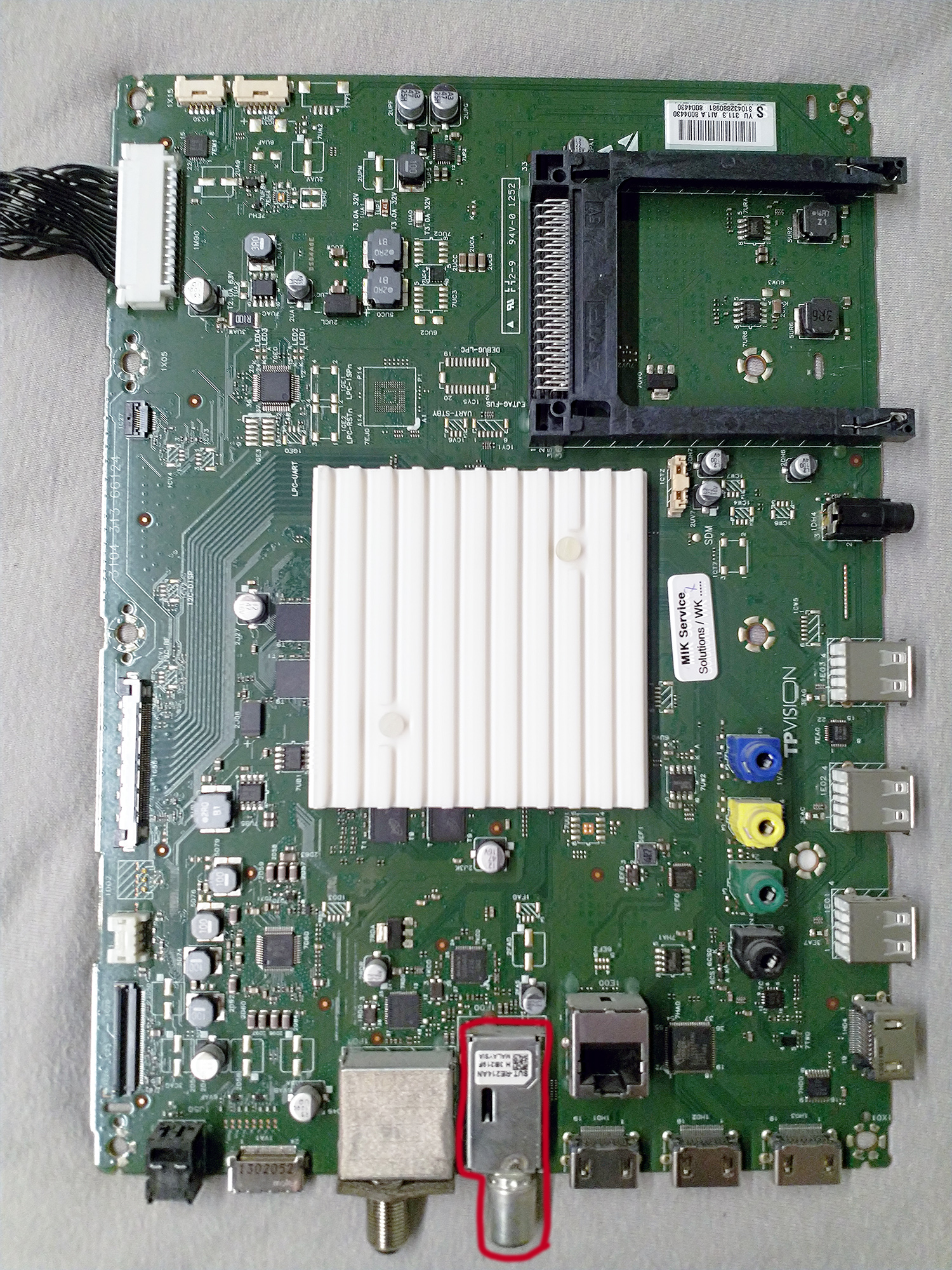

    Also the processor's(?) white large heatsink was getting warm but don't know how hot the chip itself was getting.
    I'm completely amateur with TV's and repairs. I have no idea what should I do next. Any help is greatly appreciated and thanks in advance for the kind wizards who might help me!

      This chassis is very capricious. First of all, you need to rebolt the processor and then you need to overwrite the nan flash with working software. If it works, you need to improve the cooling of the processor (under the white radiator). In my opinion, the cooling is not calculated right and that's where the problems come from

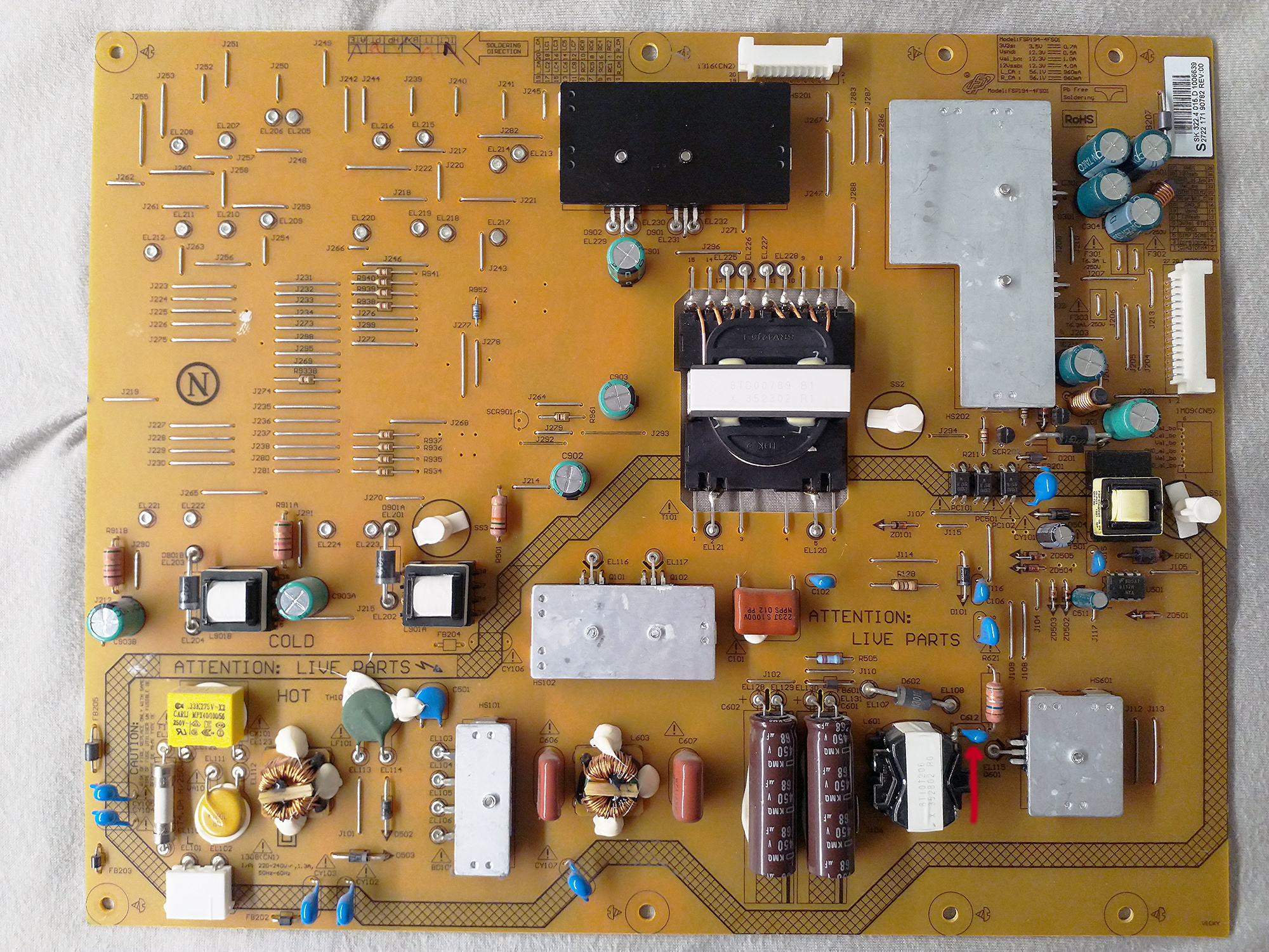

        That capacitor creates big problems in the Philips power supply. DO NOT START AGAIN. Replace the capacitor with another one of 2Kv.

          maybe try switching out the ceramic cap for one of those, see if it helps: https://www.ebay.com/sch/i.html?_fro...fLoc=2&_sop=15
              I'm sorry but have to ask what do you mean by rebolting the processor? Do you mean reflowing? I have no idea how to overwrite nan flash Can you give some information or guide me towards instructions?

                    Those lit up very well, which thermal camera do you have?
                    • Dvsr
                      • Oct 2022
                      • 15
                      • Finland
                      Re: Philips 55PFL8008S/12 two blink error code
                      I usually order a few of them in case anything goes wrong.
                      Same for me. I think they will order at least ten of those so they'll have them in stock too. I'll take few of them.
                      Yes, this camera is very sensitive! My camera is Guide IR PC210. I did quite a lot of research before acquiring. I found this one providing best bang for buck in a "budget" category (compared to professional cameras). I also have a macro lens so it can also be used to examine SMD components for example.

                          I received the caps and replaced the original 221 pF 1 kV with 221 pF 2 kV. I then connected all the connectors. When I plugged the TV in I noticed that things got worse. Almost instantly when I only plug the power cord the capacitors temperature starts to rise rapidly. But this time it goes up to over 90 °C... With the original cap it heated up to only about 60 °C.
                          And now the TV won't even start to show that error code.
                          I'm completely clueless what to do next.

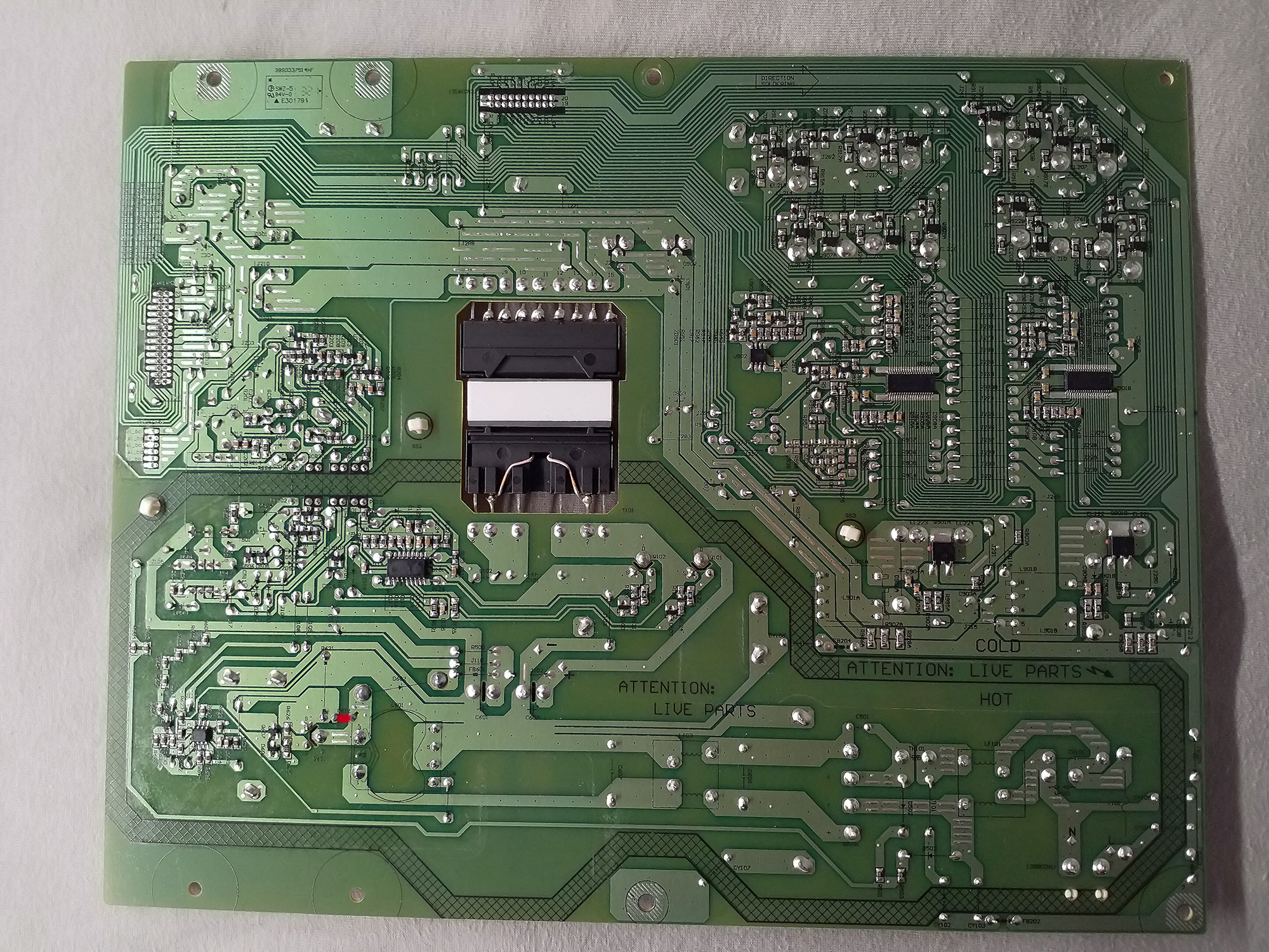

                            put back yours original 22iPF in place.. and rework soldering on the wholw back side... in case you don't have good magnifier to scope soldering points

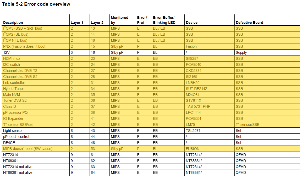

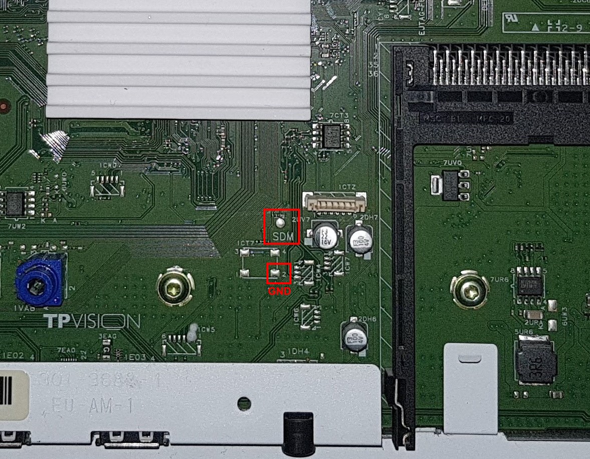

                              You might be following a red herring; the TV set is helpfully providing you an error code so why not investigate that clue instead.
                              The repeating two blinks means that you have a layer-1 error code 2.
                              If you take a look in table 5-2 in the service manual, you will see that they are all related to the system board ("SSB"):
                              This old model TV has a hardware SDM feature (see section 5.2.1 and figure 5-1), where you can force the TV to blink the more specific layer-2 error code by soldering a jumper wire from the SDM point to the nearest GND point on the system board:
                              When that's done, connect the mains power again and wait for the blinking to begin.
                              It can take several minutes before the blinking begins if the underlying problem is a fall to protection mode as described in the flowcharts in section 5.3, because the device will cycle through several reboot attempts before finally giving up and entering the protection mode, so just wait patiently.
                              The two digits of the layer-2 code will blink at two different speeds followed by a longer delay, then the two digits will repeat.
                              Another feature of the SDM mode is that it overrides the protection mode behaviour where most of the power rails are disabled.
                              Having SDM enabled leaves all power rails enabled while in protection mode, so they can all be measured correctly.
                              The most likely outcome is that you will get layer-2 error code 53, it's unfortunately a design error in this chassis, be it deliberate or accidental.
                              The main processor's heatsink is woefully undersized, which results in the BGA-type processor to heatwarp the PCB and over time some of the underlying pads on the PCB will disconnect from the processor.
                              The solution for this is two-fold:
                              1. The Fusion processor needs to be reflowed in the correct manner to regain contact with all the pads again.
                              2. The heatsink needs to be replaced with something bigger (it's a common form factor), and you need to make a ventilation hole in the plastic back chassis where the processor is located, as pioneered by Alpengeist, and you can see several successful examples of that here.
                              If you only reflow the processor and don't solve the underlying cause of the heatwarping, you will eventually end up in the same situation again, like this poor guy.
                              But you might have some other layer-2 error, so investigate it and let us know.

                                  I changed the old capacitor back and connected SDM to ground with a jumper wire. After waiting for a while the blinking started. And it was five short blinks and three fast ones. So you were right. While the TV was powered I measured voltages of the L_CA and R_CA pins in the connector which goes to the backlight(?) and it was still around 45 volts.
                                  Great thing that the faulty part was confirmed! But reflowing the processor is complicated thing for me. I have never reflown any chips especially this size. I only know the basics of that process. Any advice on that is greatly appreciated.
