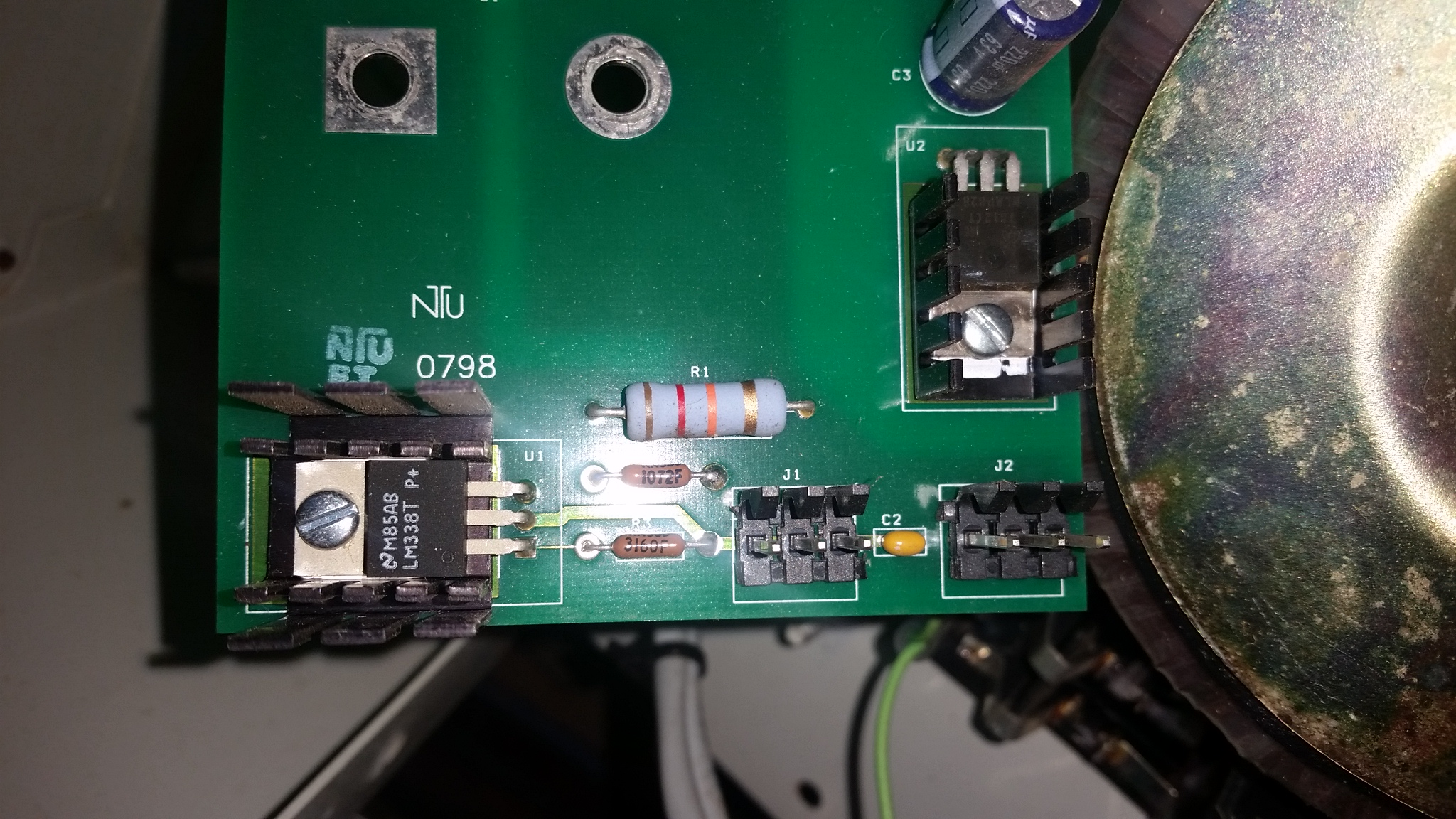

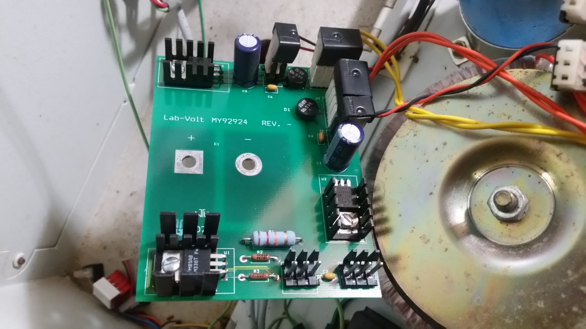

                            Re: Dc power supply in cnc not working
                            I would bite the bullet and get the $40 part because newer or cheaper parts are smaller and will not fit the PC board 22mm screw spacings.
                            Cornell Dubilier - CDE CGS482U075V3C 4,800uF 75VDC $39 at Mouser
                            I don't see the high current path from the cap (+) to the load. Would need more board pictures to see where the voltage loss is occurring. There might be a fuse, open-connection etc. which is what I'd be looking for.
                            The LM338 would be OK if the output measures 5VDC for the logic circuits. They might act as the master switch for the 42VDC, if there is a relay or something.
                            So far I don't see any 42VDC regulator and it could be unregulated if powering high current solenoids etc.

                              #74
                              Hi redwine
                              I didnt want to spend 50$ total inc shipping....however i did get lucky and found exact part number on ebay used
                              I typicslly eould never buy a used cap but sibce this one is so costly new i made an exception
                              I only paid $7.50 snd free ship... i wanted to buy this new one but its 1in taller..wouldnt fit https://www.ebay.com/itm/14409611372....c100167.m2940
                              It was the only one on ebay that matched part number and made in USA
                              Plus ...there is risk that the ps could be bad...so spending 50$ on a non returnable item could be 50$ out the window
                              And also no fuses in circuit....i measured 44v at big cap so the issue would be the lm338 or a diode in citcuit since thats all thats in between cap and output ....my only concern is if the lm338 is bad if some other component blew the lm338...will see what happens when i get the cap and lm338...both ordered

                                #75
                                Here are pics redwine
