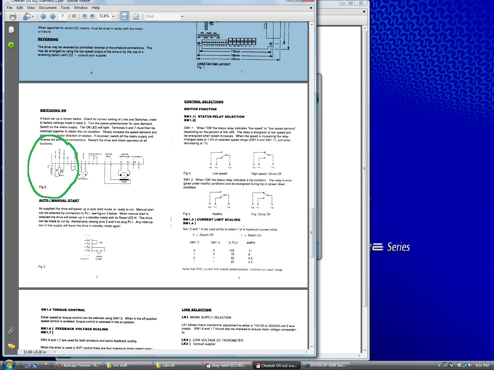

                          #52
                          Re: Dc power supply in cnc not working
                          Hi samsam
                          I hooked potentiometer up per manual and have dome same on otherc2 identical mschines with no issues
                          The LM338 is what the msnufscture used so i will replsce it...if it doesnt fix issue i will let u know
                          • shelby5041
                            • Feb 2009
                            • 1505
                            • united states of america usa
                            #53
                            potentiometer schematics per manual
                            • shelby5041
                              • Feb 2009
                              • 1505
                              #54
                              Update
                              Nevermind...this thread done
                              I put board bsck on to test voltage regulstor voltages and within 1minute the lsrge blue cap exploded .
                              Power supply is trash
                              Im not sure what i dod wrong as this machine is same as other 2 but i really messed it up and now its going to be a huge expense..i may just scrap the machine.
                              Whst could cause the huge blue csp to explode?

                                #55
                                connected backwards.
