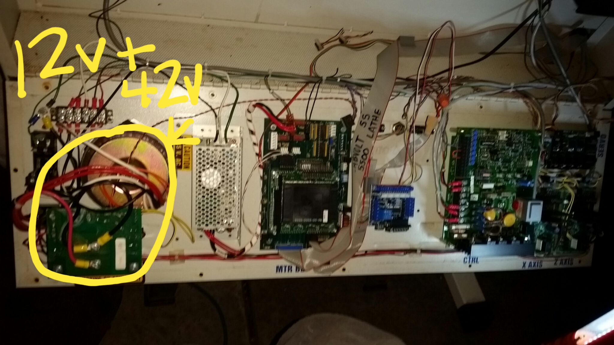

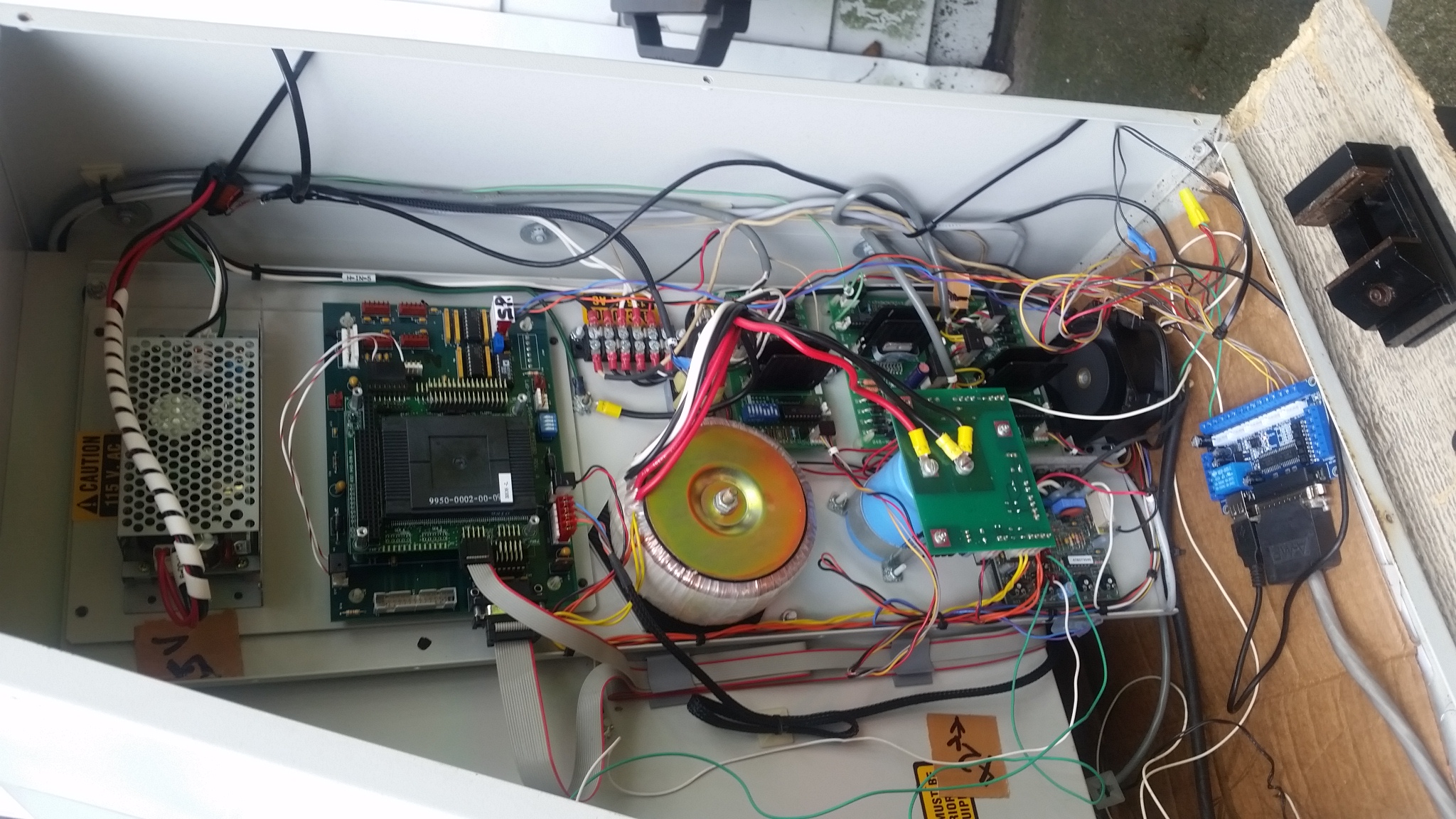

    Hi
    I hsve a cnc mill that uses a dc power supply that outputs 12vdc and 42vdc
    Last time i used machine no issues..about 1yr ago
    I used it today and i somehow dont have 42v output from ps...the 42v output is only measuring 1.4v
    12v output is good
    Can someone assist me?
    Due to design im not able to remove ps currently
    See photos...i have 3 machines use same ps i posted 2 pics for better views

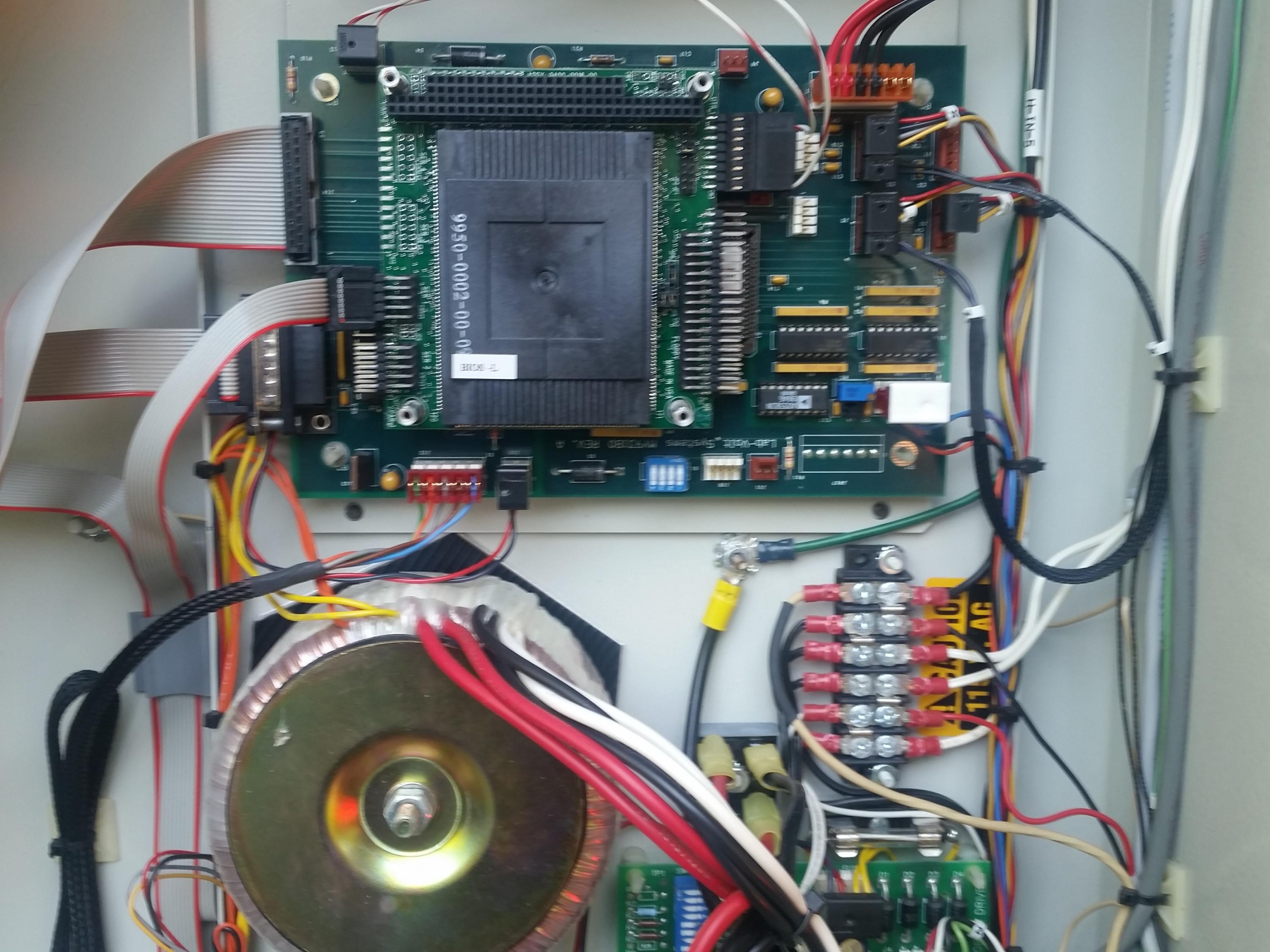

    Well, you'll need to do some tracing.
    Do you get voltage across the big capacitor at least?
    Looks like wire colors are reused quite frequently making it tough to trace wires without having the device in hand...

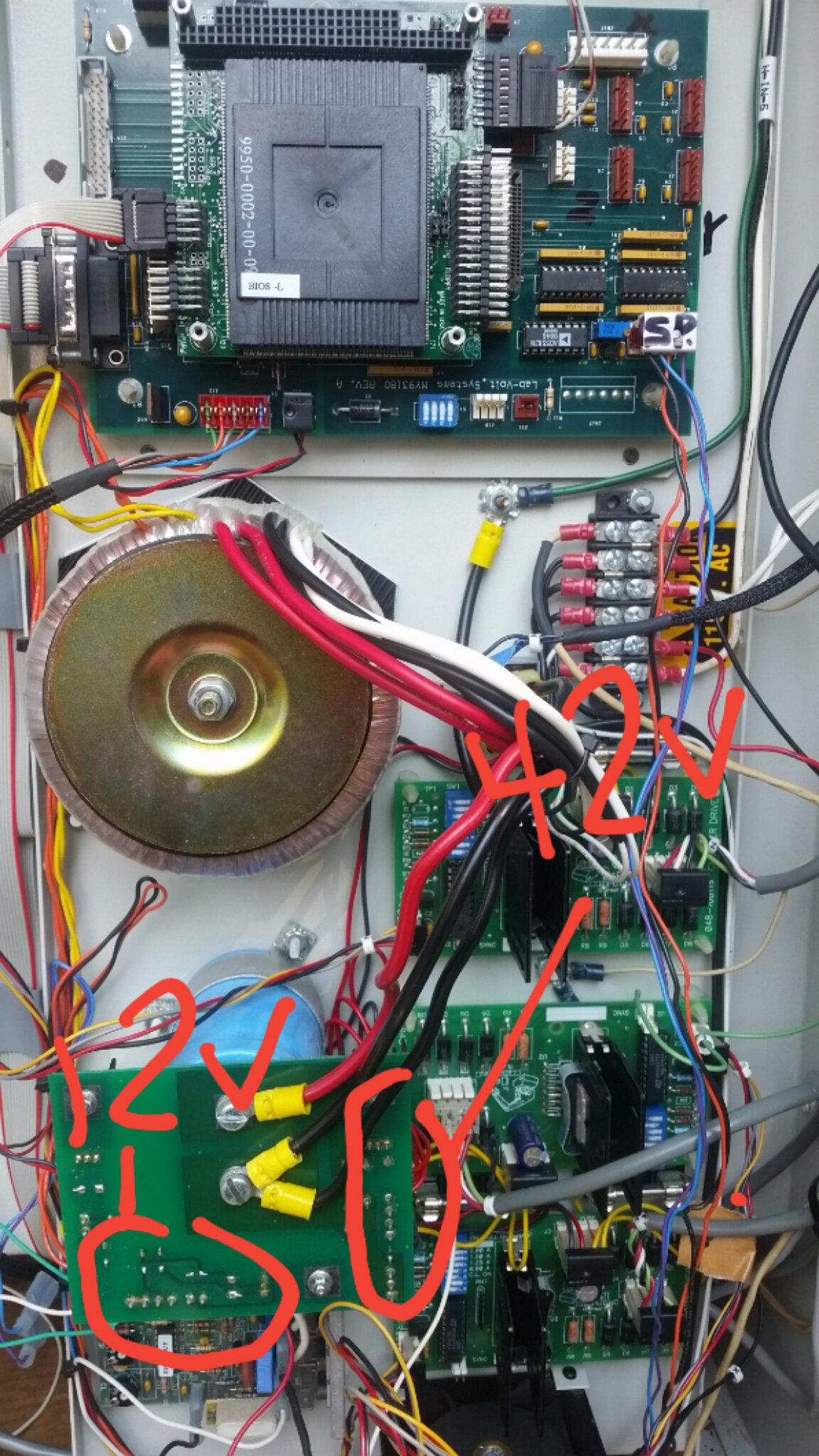

                      Thanks..the 12v and 42v both output on the board with the huge cap
                      Everything starts at the large donut shaped transformer

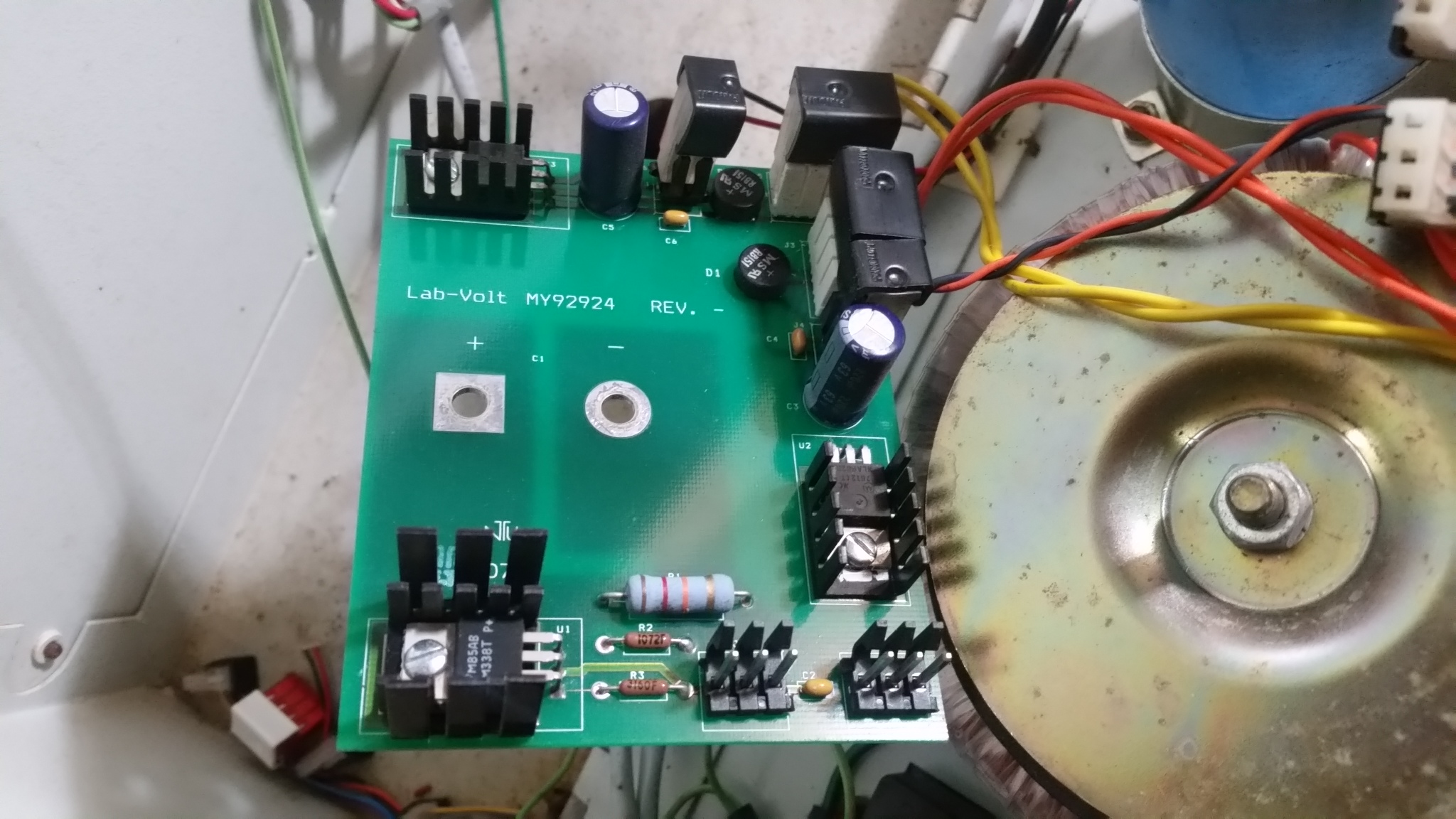

                              Maybe good news...i have 45v at large cap so that means trans and rectifier good
                              • shelby5041
                                • Feb 2009
                                • 1505
                                • united states of america usa
                                Re: Dc power supply in cnc not working
                                Here is pic
                                  • 31029
                                  that board looks almost new! even the molex pinstrips are the latest type!
                                    • Jul 2011
                                    • 6039
                                    Now the question is where are you losing the 42 volts at you need to trace the circuit on the board and see where you lost the voltage at
                                    • shelby5041
                                      • Feb 2009
                                      • 1505
                                      Lol...not new but high quality made in usa board
                                      25yrs old
                                      Its an old school board so im pretty confident its repairable
                                      • eccerr0r
                                        Solder Sloth
                                        • Nov 2012
                                        • 8701
                                        It looks like at this point all of the "transistors" on the board are indeed ICs. The 12V is using a 7812 IC and 42V *appears* to be regulated by a LM338 - which like the LM317 is actually limited to 33-ish volts. So this IC actually being operated out of range though it's valid to run it this way.
                                        So since the red and black wire terminals on the big blue capacitor is getting the 45-ish volts, you probably need to replace the LM338. These die readily when operating above 30V.
                                        That is if you don't have a short somewhere else which caused the LM338 to die in the first place. This is your #1 priority, then replace the LM338. Goes without saying, make sure the resistors didn't fuse but they should be allright.
