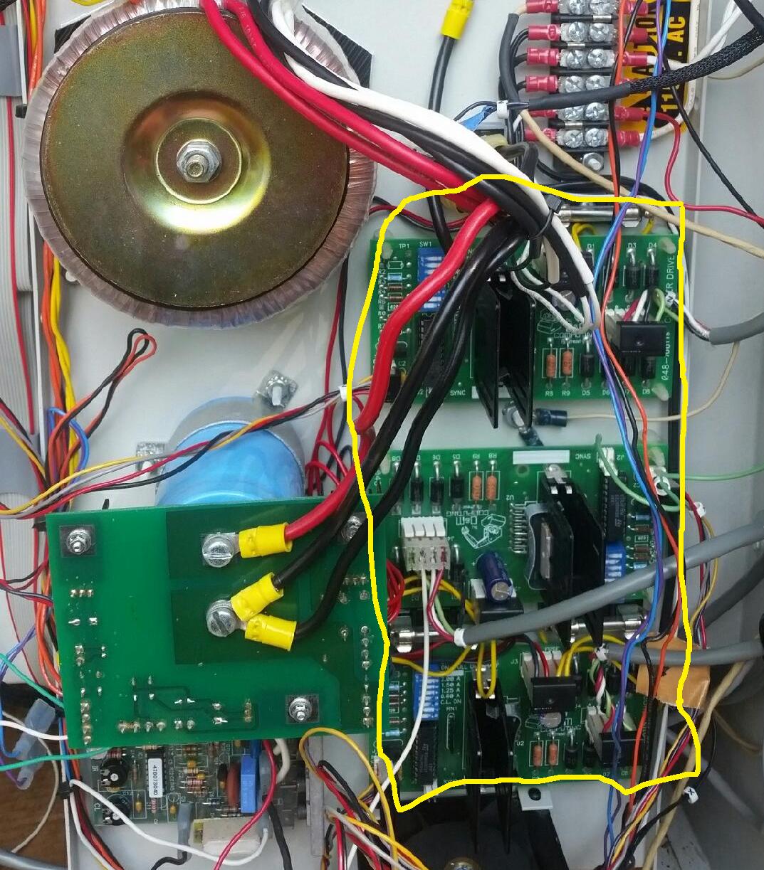

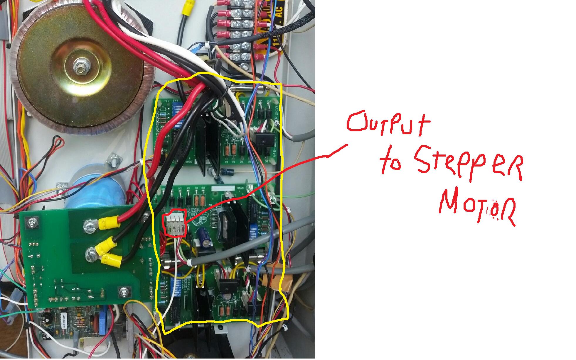

            #105
            Re: Dc power supply in cnc not working
            well my stepper driver boards do have 2A fuses on each of them and they did not blow
            this is just all so confusing as i may have multiple issues going on at same time or just a fluke that occurred
            there is no reason any of this should have happened as the last time i used the machine it worked fine
            a main fuse blowing and stepper driver board failing at this moment in time just doesnt make sense.and both may or may not even be related to each other....which makes it even harder to troubleshoot..although out of the 3 machines i already have had to repair 2 stepper driver boards all for same reason...failed L298 chip which is the output power/direction to the stepper motor
            these machines are very old about 25 years..on the last 1 i modified i did blow a driver board just from playing around with moving each axis...apparently these L298 chips are just failing due to age...
            i still need to find out why the voltage is going to 1.5v when i connect the c driver board to the stepper motor..maybe the stepper motor is bad.although ironically..(the stepper motor that is connected to the C board is new it was replaced last year due to it failing and never even used it other than testing) so it failing would make no sense at all...unless the almost failing driver board initially caused the stepper motor to fail or visa versa and now the driver board decided to fail completely?
            see photo i had from my other machine (all 3 machines are identical in electronics design and parts) ..in yellow are the 3 identical stepper driver boards that receive 42v from the big cap board. and as you can see each has a glass style fuse in the 42v input circuit before the board not within the board.
            im sorry i know this is hard to follow ..i talk in circles a lot lol

                    at least i got the big cap repalced and seems to be working ok
                    see the connection in red....thats the connection that causes to lose 42v at ps output
                    very odd
                    hope to figure it out..may be something odd yet simple.

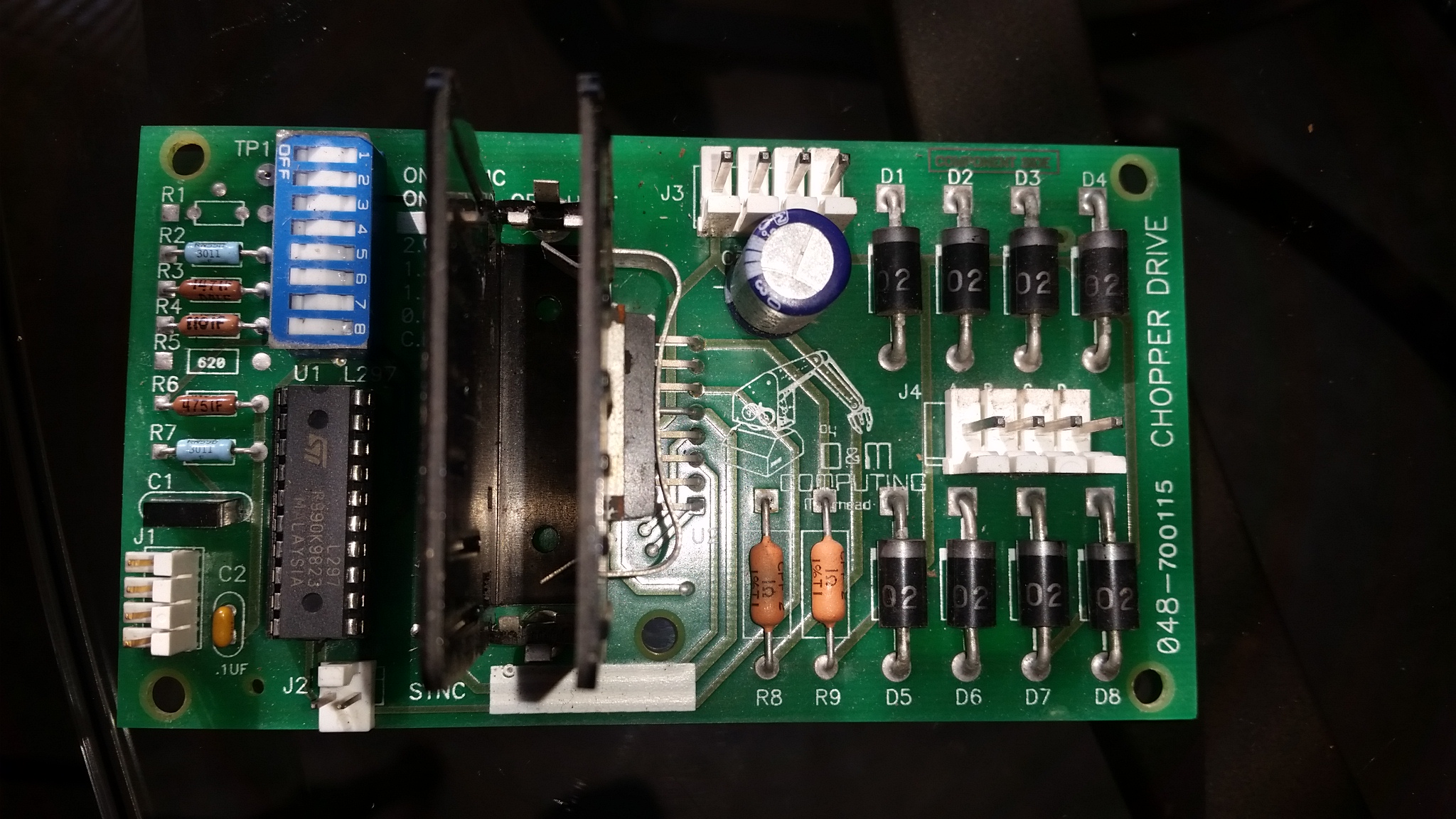

                                      Updste...i was pretty confident that stepper motor good so i connect suspect stepper to othet stepper driver and it works good
                                      The other 2 stepper motors work fine as long as the bad driver board is not connected to motor
                                      So im pretty sure its a bad driver board bad L298...like i said i think these are failing due to age and or environment...unheated garage can get to -10f some winters although specs say L298 can handle up to -40C so temp should not be issue..prob just age issue
                                      Here is a pic of board i just remove..im going to replace the L298 today..i bought several last year knowing this could be a constant issue since machines are so old..these boards are obsolete and can not be obtained anywhere..they can only be repaired..thankfully they are old school and all the componenets are replaceable....
                                      and dont laugh at how i replace the L298....i use an odd technique....since these boards are obsolete not avail i cant risk ruining it and since desoldering the multipin chip is not easy for me i just cut legs carefully with a small hacksaw blade and resolder in the new one on top of the orig legs...it doesnt look good but it works and reduces my risk or ruining several pads etc...

                                        Not much to the board in terms of what can be swapped - need to swap out the melted L298 or the whole board. Indeed the melted L298 will explain the short.
